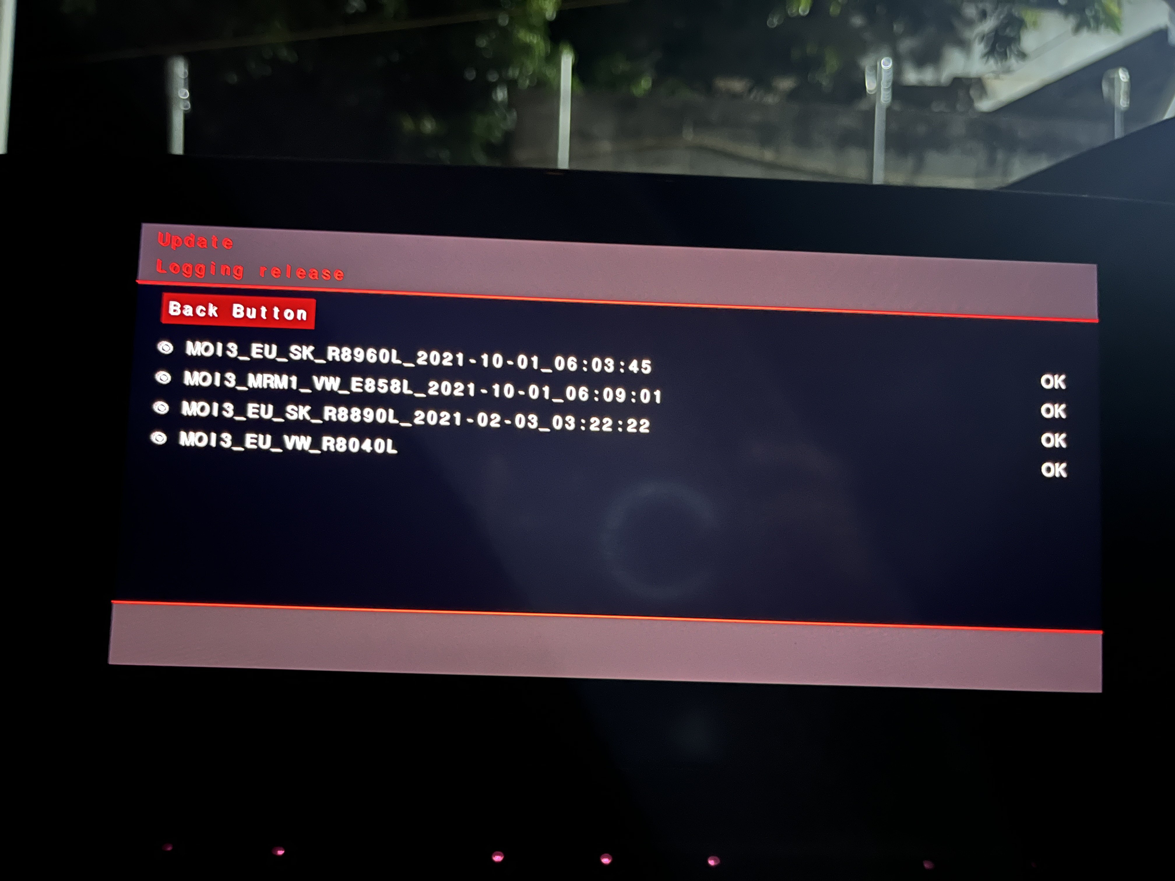

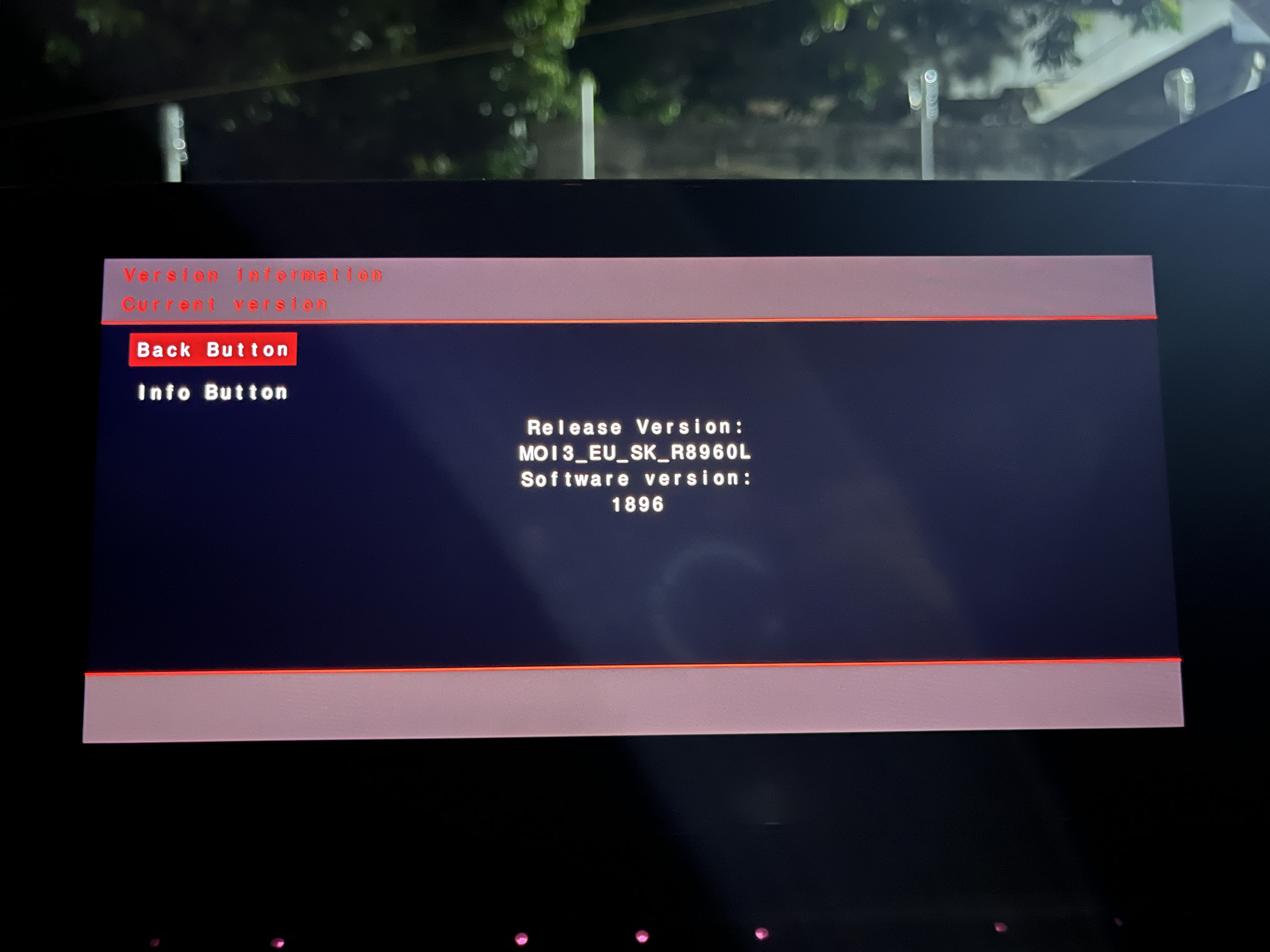

Hello guys, have you been able to update ? I have a MK4 vRS and MIB Helper is saying MOI3_EU_SK_R8030L is the latest. Currently I am on MOI3_EU_SK_R8960L. On MIBsolution, I can only find MOI3_EU_SK_R9410L. Also my wifi is disabled as in Mauritius, there are some features locked so I can't received OTAs. Need help !
Anyone else's voice control completely broken on 1985? Either pressing button on wheel or the "ok Laura" just shows the spinning wheel
@Ayeshen I’ve never been able to find the right model / train on mib helper. Someone on this thread had uploaded the ZIP around.
