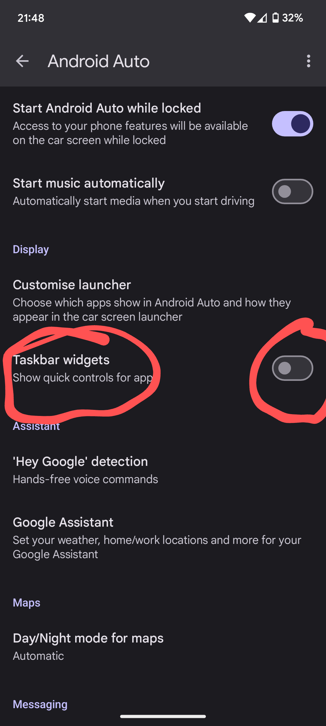

I've just got the 1985 update and it seems to me that Android Auto is bugged. The current behaviour seems to be how it was a couple of versions ago. My icons were down the side, which makes sense for a wider screen. They moved to the bottom. I toggled the option mentioning a taskbar which moved them back to the side again, but the behaviour of the app is the same as it was a couple of versions ago. When I tap either Spotify or Maps, they will go full screen. Before this latest update, whichever app I touched would take up 2/3 of the screen, as it should, since it's a wide screen. They would also swap sides to focus on the app you touched last. Any ideas how to revert this, or is it an actual bug?

I toggled that setting to get my icons back to the bottom, but the functionality regarding which app is in focus has changed, to what I seem to remember being how it used to work. Used to be able to tap the app that is taking up 1/3 of the screen and change it to 2/3, toggling between them with each tap. Difficult to explain and figure out if that's how anyone else's functions/functioned
With regard to the AA and the screen getting smaller, icons moving down to the bottom rather than on the side, etc.
I had that after upgrade and I found a setting in AA had been enabled that moved the icons, smaller screen, etc. I disabled widgets and it fixed all the issues I had. It was in Android Auto settings, not the Infotainment system settings.
On the phone, go to settings, apps android auto, additional settings in app and turn off widgets. Then restart the car.
