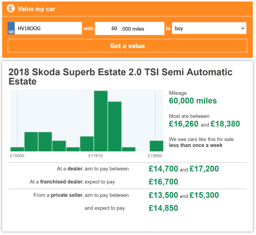

£16K for a 7 year-old car seems like quite a lot to me.
How old is your current car?
Look at the cost to change.
It's your money, and if it seems a good deal to you and you really like the car, then the opinions of other people don't really matter.
