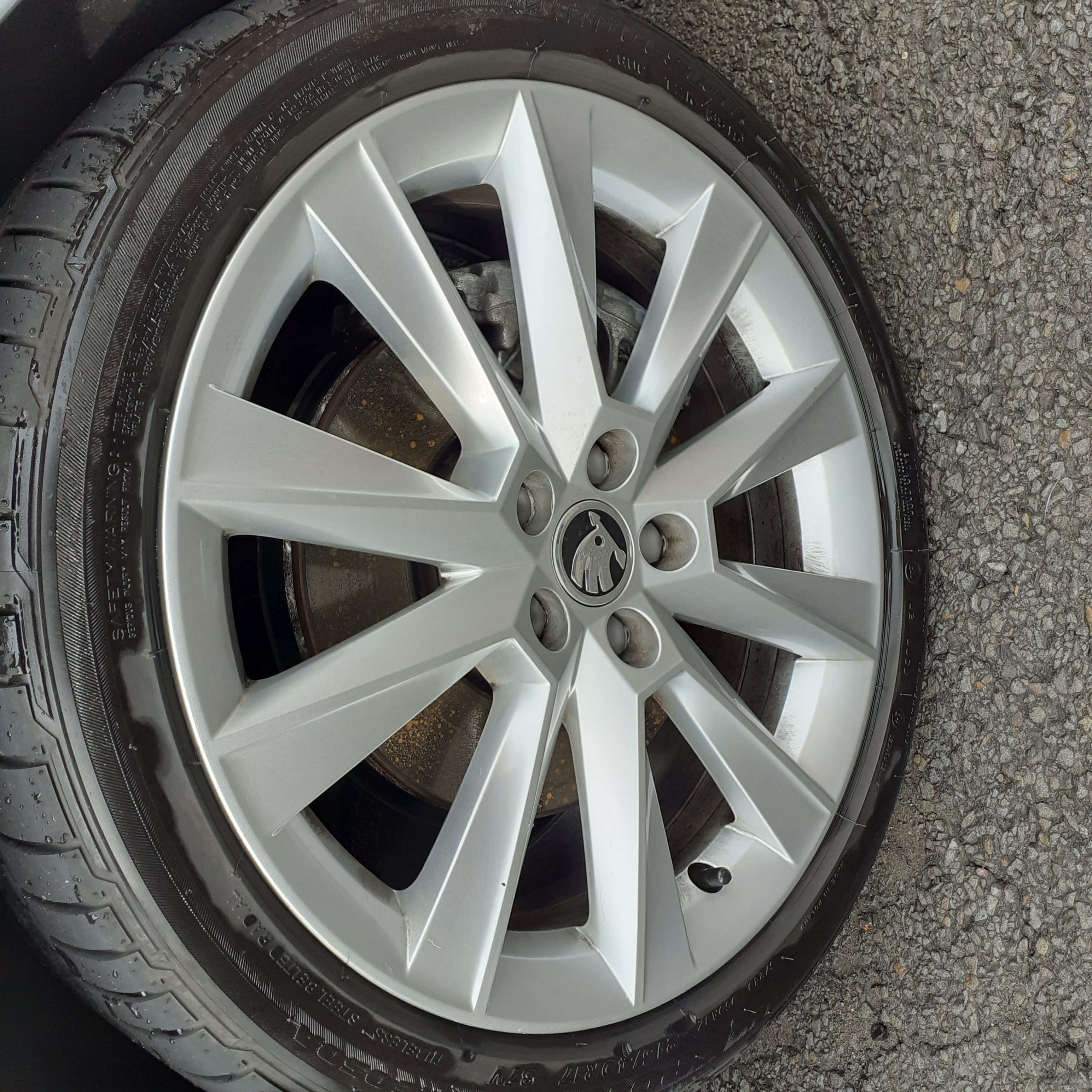

Alloy Wheel Type
Many thanks brilliant the weather with us has been really bad last few days heavy rain and tday really strong winds along with the rain so have't had a spare half hour to drop a wheel off but no need now great info many thanks it's so good when people know what they know, standard dealer answer was "pop the car in and we'll have a look" you can see the pounds rolling around before they give you an answer, i can now look around for a wheel to use for a spare instead of buying a brand new one thanks again much appreciated

Alloy Wheel Type
Just enquiring about an alloy wheel type for my MK3 Fabia SE L 1.0 TSI 2019, the car was supplied with the 17 inch brushed silver maetallic ally's from new and fitted with Bridgestone polenza tyres 215-40-17 I've looked on Skoda sites to what type they are but seem to be a strange one, the information states that they are a Stanton type but are 6.5 J where mine are 7J it also states that the 6.5 J was only fitted to the Skoda Radid and use 205-50 17 tyres so I'm a bit confused by this, could be wrong but not goinfg to shell out around £200 for a spare wheel, I have got a steel spare which is 185-60-15 and does fit car ok but wanted an alloy (it will fit in boot if jack carrier is dumped but wanted to get the correct alloy say of Ebay to keep for a spare, this is the said alloy any info would help thanks
