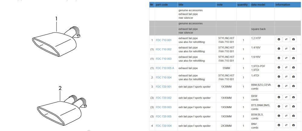

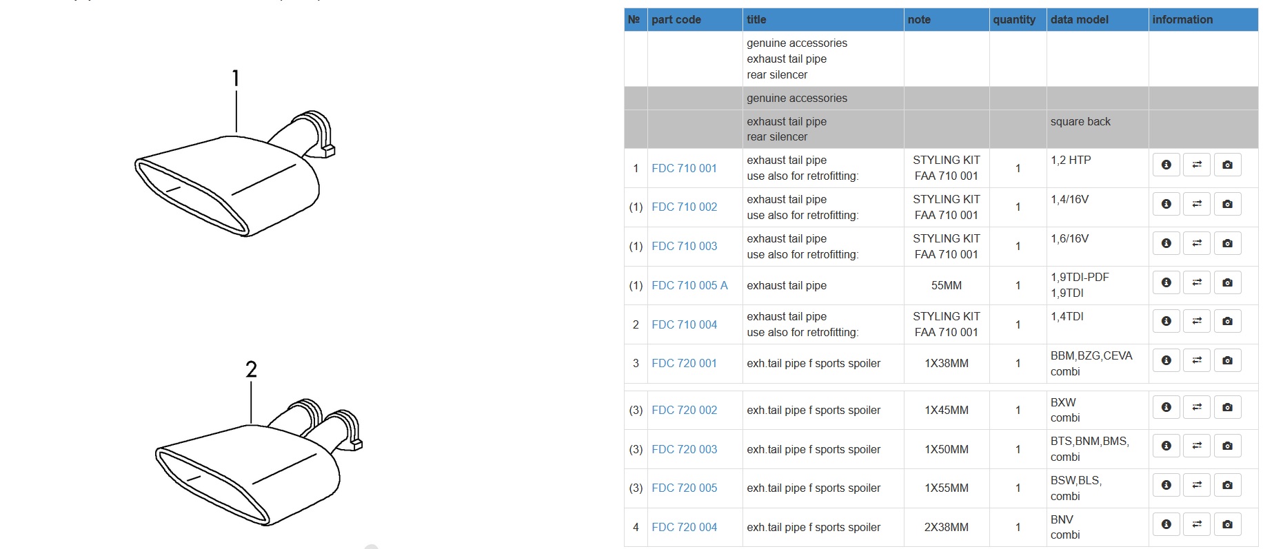

Fabia 2008 1.9 tdi sport rear back box
It's just a finisher trim / pipe fitted to the standard vehicles ordered depending on what engine you have.....
Are you trying to get one to replace one thats fubar, OR are you trying to get one so it looks like the Fabia sport one ?
