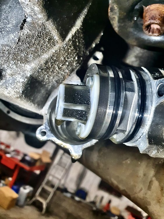

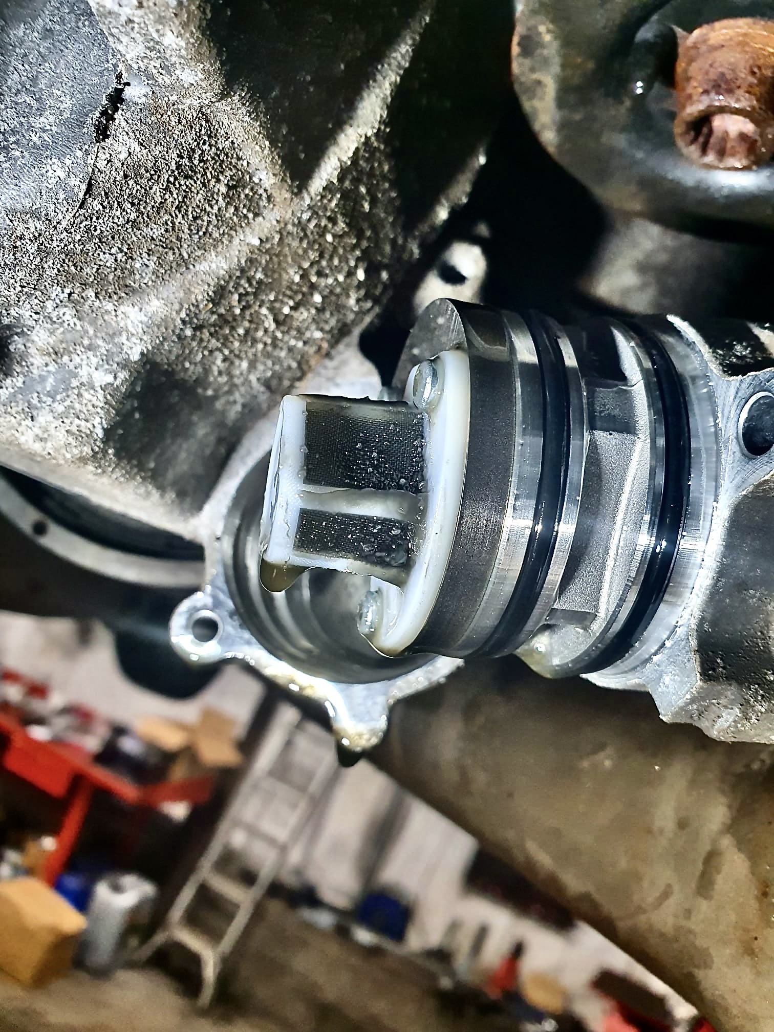

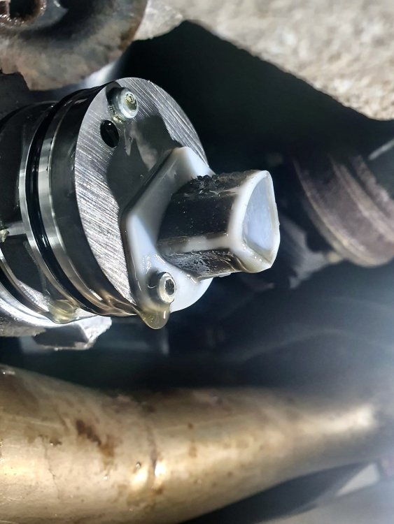

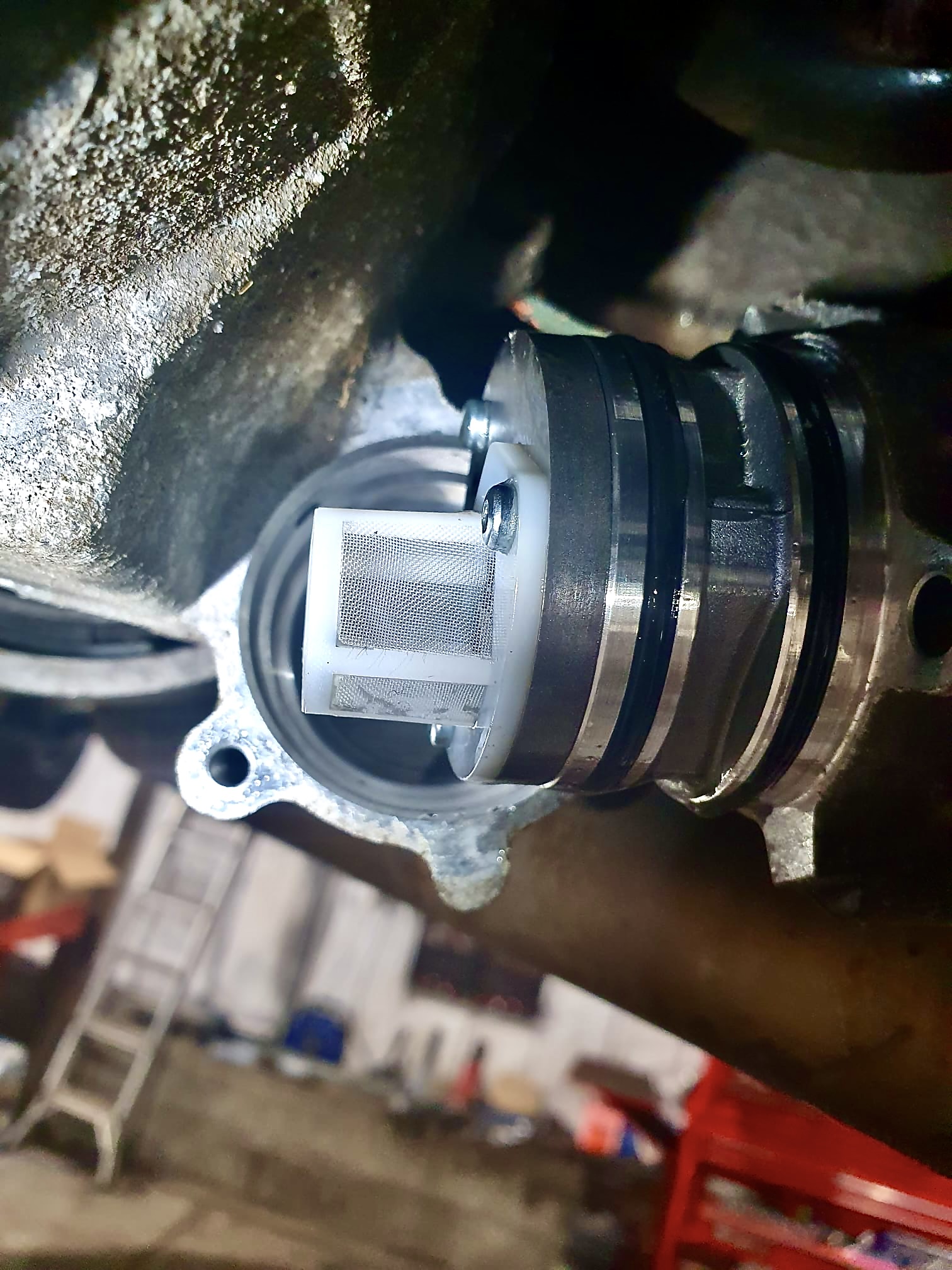

I recognise this is an old thread. However, by way of an update and because Haldex servicing is a continuing issue and probably will be until VAG recognise the need to do it properly, i.e changing the filter or cleaning the gauze strainer. These are before and after service pics of the Haldex 5 gauze strainer from my wife's Karoq 190 TDI at just over 2 years old and some 20k miles. I leave you to draw your own conclusions.

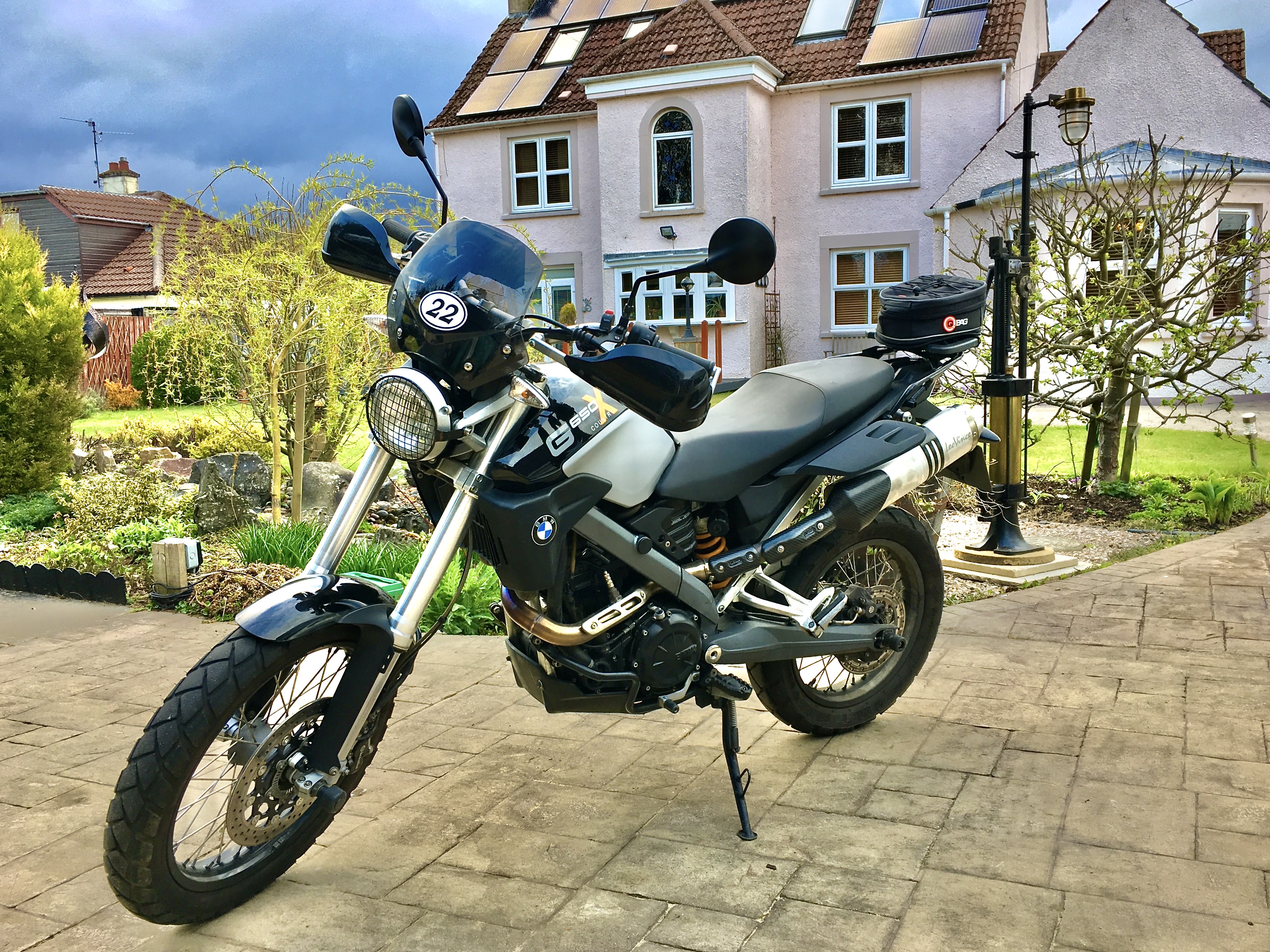

Yes, a 701, if you could find one, would require a full licence. They've stopped selling 701's, at least in the UK. Shame as I quite fancy one. I think the full licence is the way to go. I see far too many mature people doing their CBT and saying they're just going to get a wee 125 to begin on. I always suggest they should do Direct Access and then get at least a 500 cc bike. I do think that you want decent tyres, brakes, suspension and at least 50 bhp to keep yourself out of the gutter and out of trouble on today's roads. For me, it's analogous to buying a cheap guitar to learn on. You're more likely to put yourself off. Having said that, yes I am an old hooligan and passed my test in '75 on a Ducati 250cc single which I'd bought a couple of months before. These days, there's a tuned BMW R1200GS LC and a tuned BMW G650 X-Country in the garage. Actually, I think the X-Country could be the perfect beginner's bike, again, if you could find one. There are only 84 of them recorded by DVLA. However at only 150 kg with 53 bhp and 60 Nm it'll zip up to c 100 mph and return 60-70 mpg depending on how you ride it. Its soft, long-travel suspension is perfect for the state of our roads. You can ride over speed humps, if you must, with impunity. It reminds me of a quick, two wheeled 2CV in that respect. They only sold them here for three years, '07-'09 which partly explains their rarity. They do occasionally come up for sale, between £3.5k and £4.5k for a very good one. This is mine....
