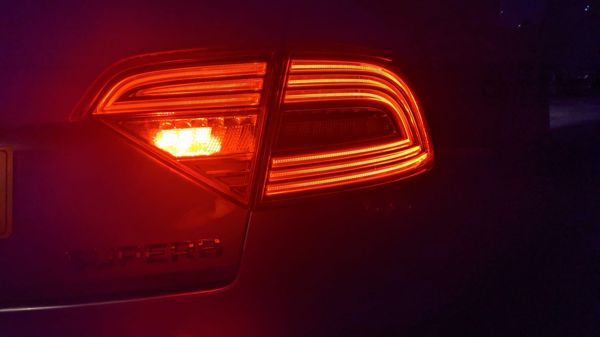

brake lights not working
Everything else on the dash working ok? Anything changed or other work been done?
Agreed after checking a circuit diagram
Re 2 - I'd start with hazard switch /relay (Is it in one unit as per some other Skoda's?) . This failed in a strange way a few years ago on my mkI Octavia. Also could this be an earthing issue?
