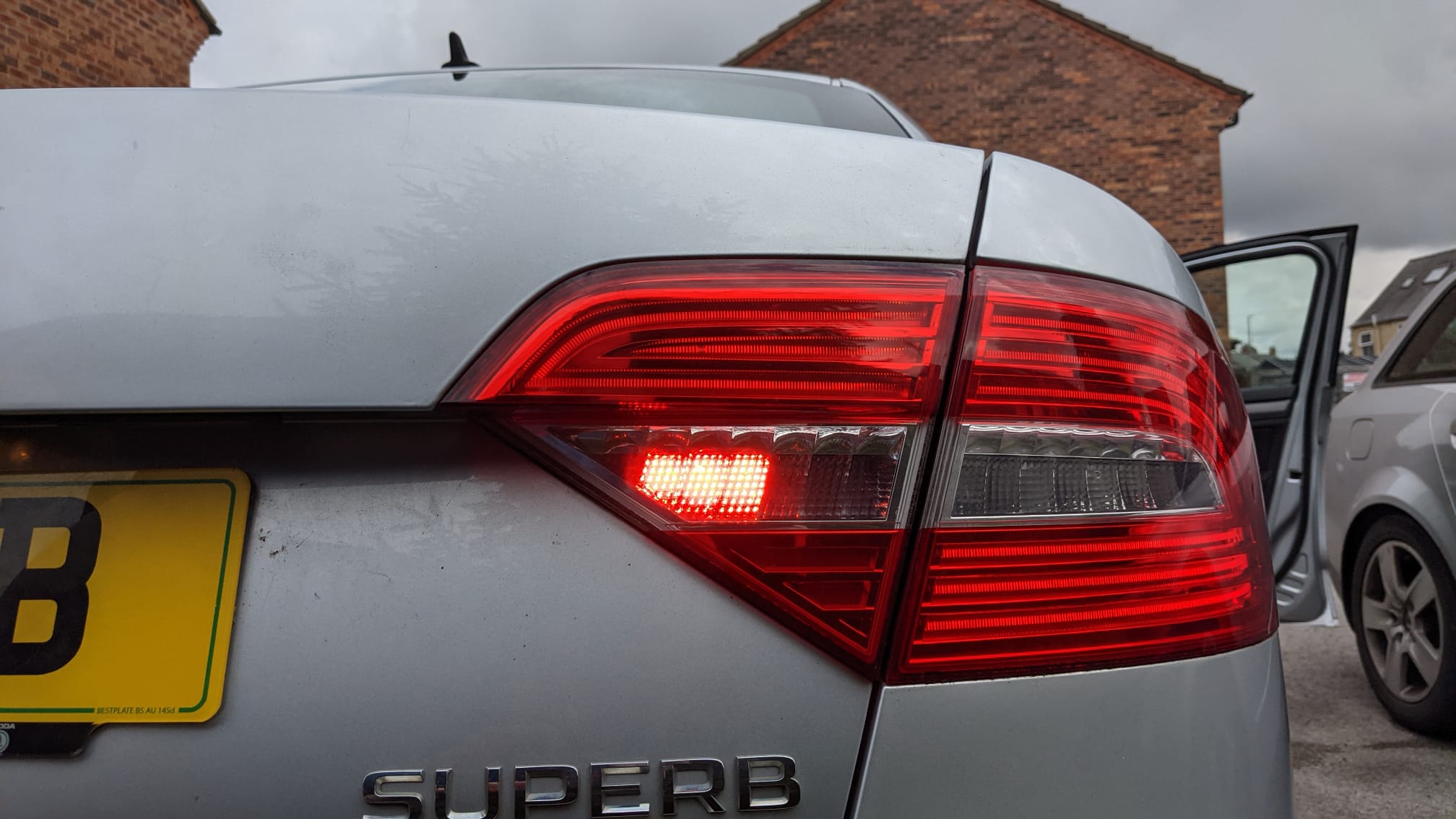

rear led fog light
Just checked on mine(also an led facelift twin door) and the fog light is on the right cluster - could this be the usual twindoor wiring fail? I suppose you'd expect a bulb fail warning but not sure if the led fog light is covered by that?
