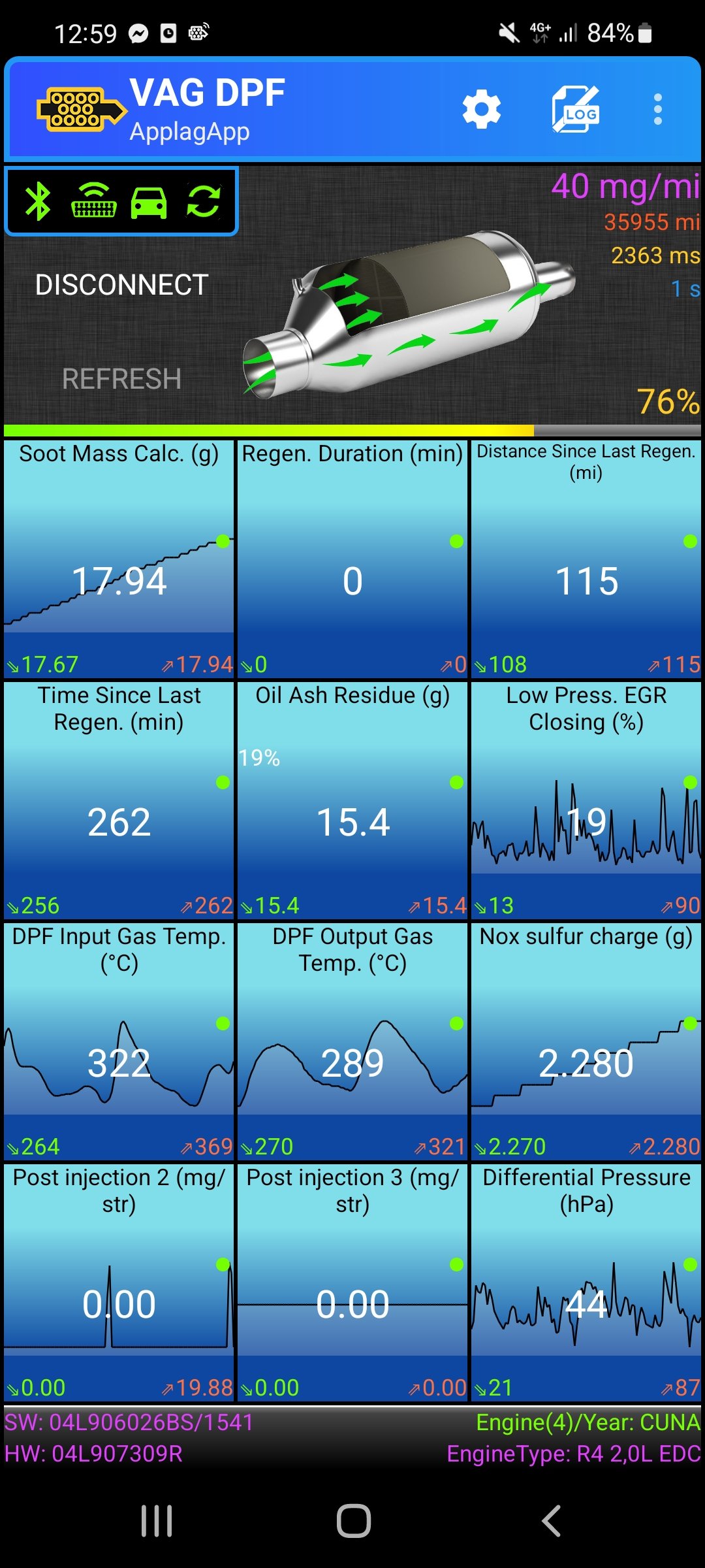

The charge is normal, the amount seems a little high as per Roottoot's post. What sort of distance are you getting between regens? I am currently getting around 170-200 miles between regens, I put that down to the colder weather and more short trips than normal as nothing appears out of the ordinary on VCDS. I also use the VAG DPF app, it gives some insight into what is happening and the health of the DPF on the move. The app is around £5 and a Bluetooth OBD can be purchased for around £10, which can then be used on other free apps to check data and fault codes.

In my experience, when the DPF is that blocked it needs to be removed and cleaned. VTECH DPF cleaner has worked well for me in the past. https://garagewire.co.uk/news/game-changing-dpf-cleaner-is-a-profitable-solution/ My DPF does a regen once it reaches around 22g, I think the threshold for the DPF light is 30g, anything north of 45g is replace the filter (based on EA228 Diesel), so worth checking the specs for yours.

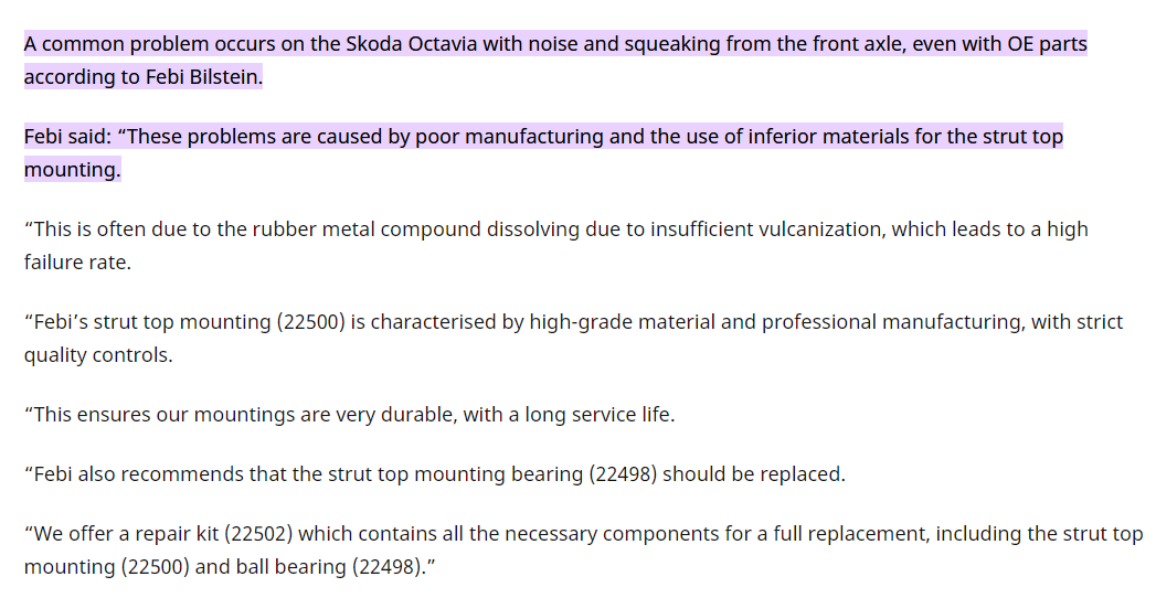

I have the same issue, I suspect it to be the top mount as everything else is okay visually and I can't find any excessive play in the joints. I've purchased the top mounts, bearings, drop links and shock absorbers (just in case) and will do both sides. In my opinion, it isn't worth buying cheap brands and only changing one side with something like suspension. There is an article online about Octavia top mounts, so could be part of what you are experiencing.
