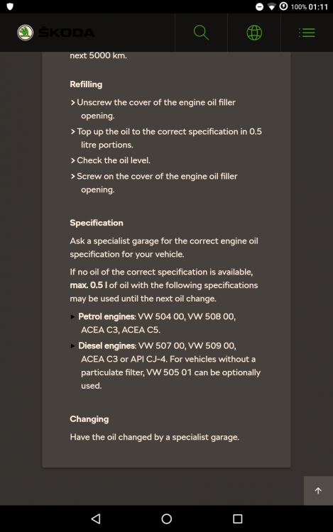

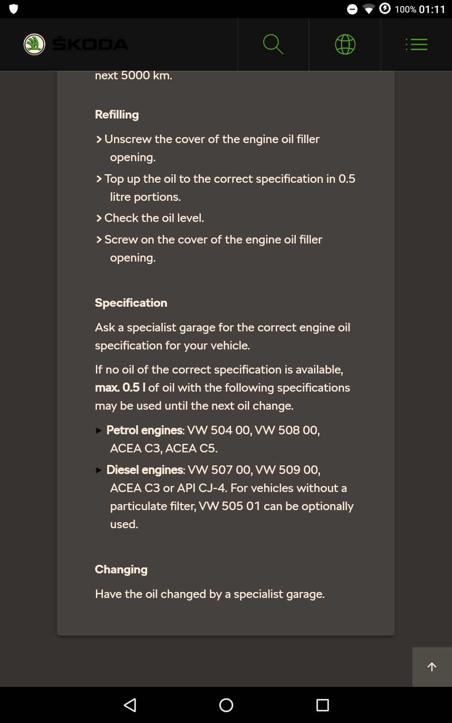

Your car is fitted with a particulate filter (GPFs were compulsory after June 2018 iirc), so your dealer may be using a totally unsuitable oil. Castrol pro 5w40 oils are 502.00 ACEA A3/B4 spec 1.5tsi with GPF calls for a 508.00 oil with low SAPS, 504.00 oils with a low SAPS may also be suitable (as a top up, not sure about service fill) I note that 502.00 is not listed as suitable in the owners manual (2019/11 build) https://digital-manual.skoda-auto.com/w/en_GB/ Even the castrol oil selector shows only their LL4 508.00 and LL3 504.00 oils are suitable. https://applications.castrol.com/oilselector/en_gb/c/recommendation?vehicleType=cars&manufacturer=skoda&model=karoq-nu7-(2017-)&modelType=karoq-1-5-tsi-(110-kw)-pf-(2018-)
