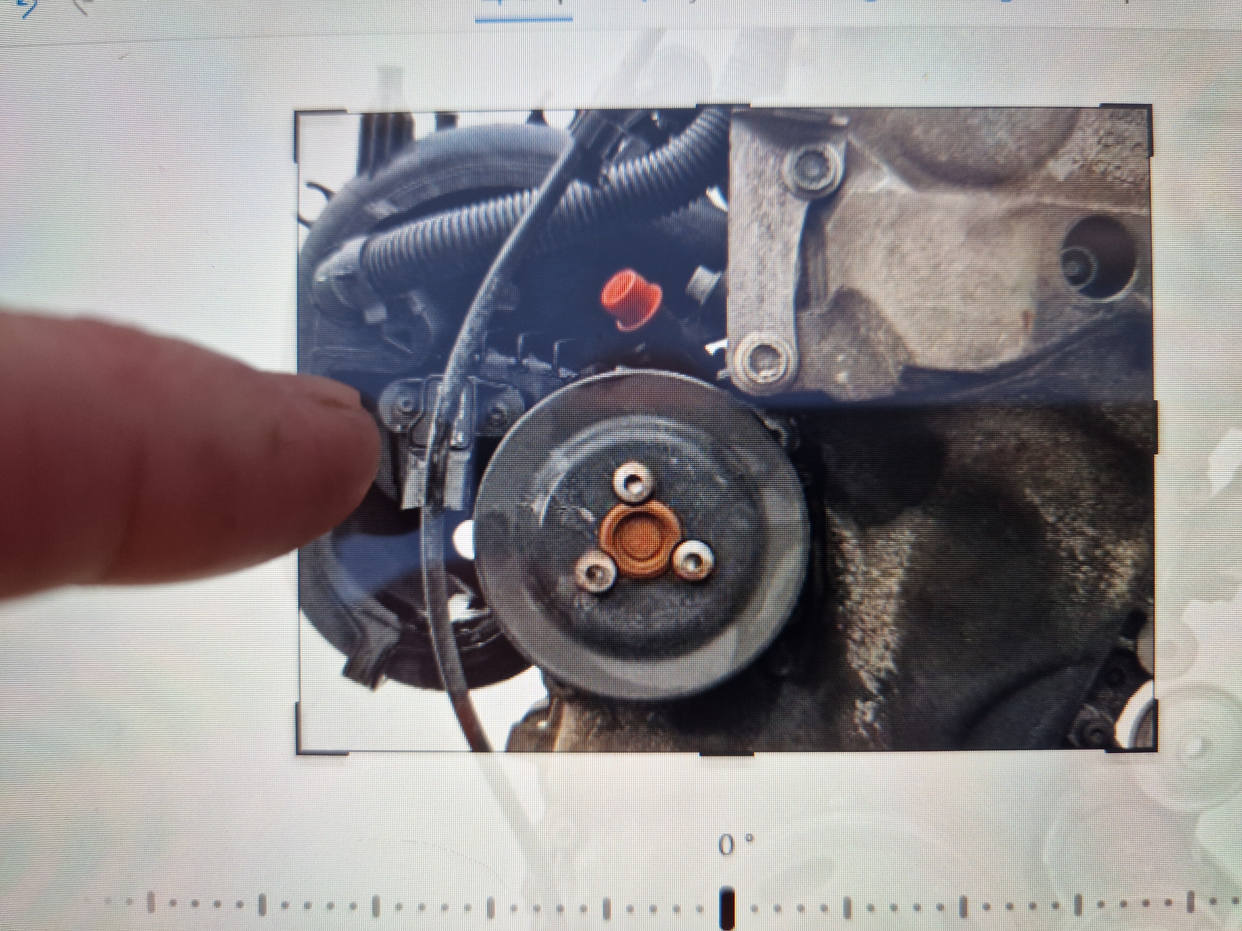

I think I can just about see the absence of such a 'fancy' pulley in that video, but a pic of the end of the shaft in the alt pulley would confirm either way. Must get around to fitting the one I bought, now that you mention it JR. 😁 Ours did more than twice that before having any significant issues, so hopefully nothing major.- Fabia MkII, Central locking stopped working
