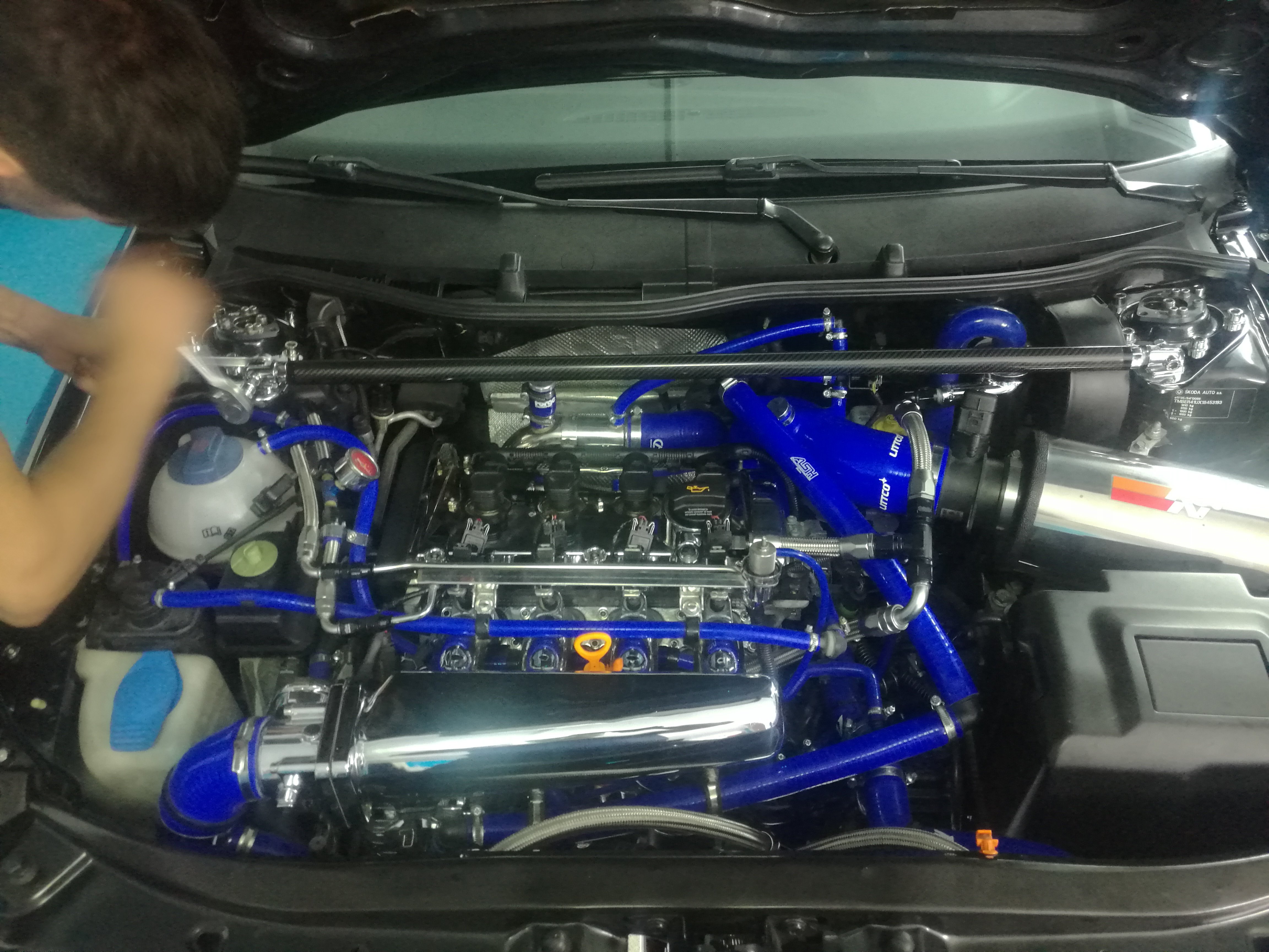

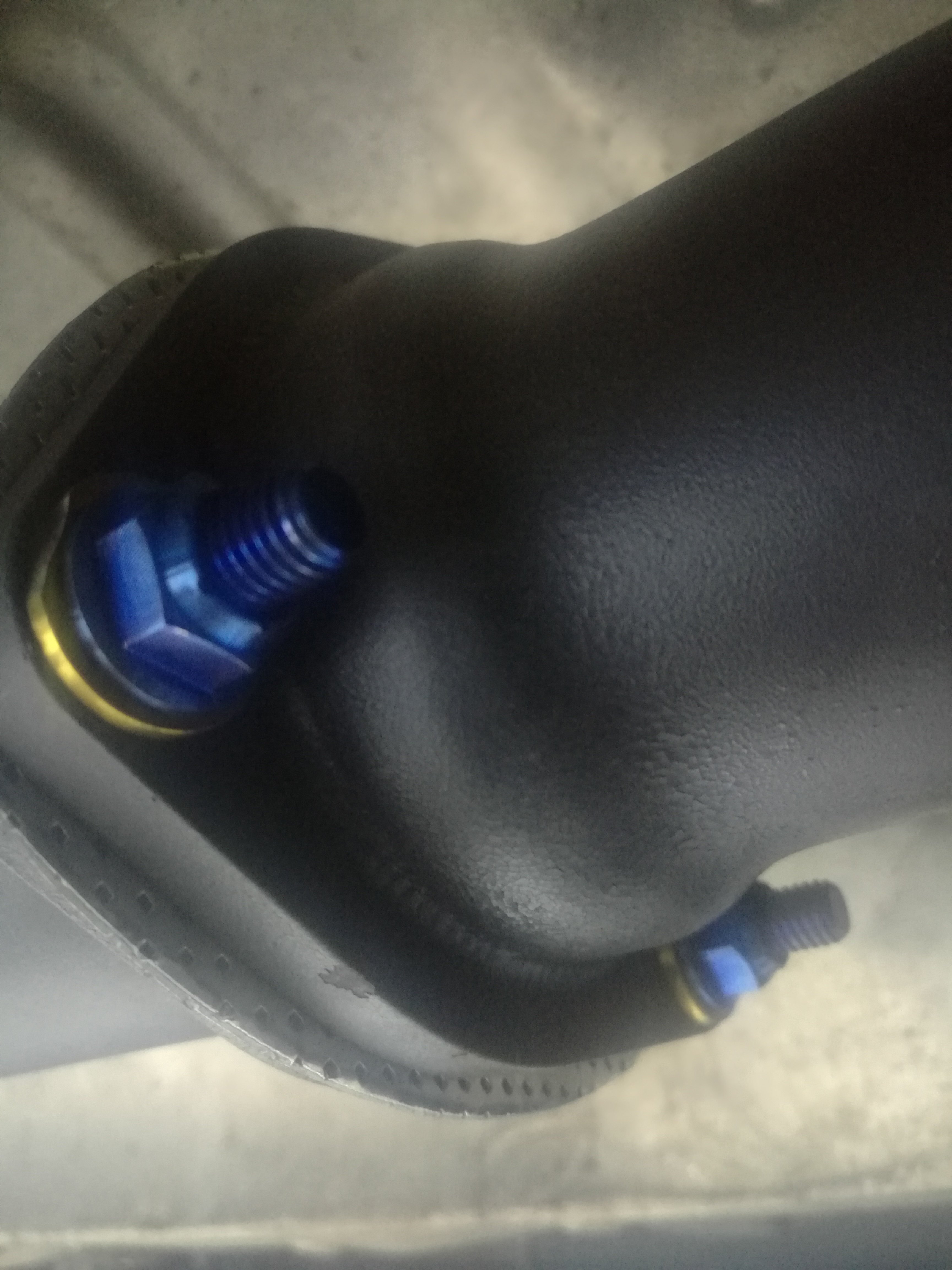

So I bought adjustable Mamba actuator with 5 additional Springs and 15psi one installed. I first testeed with manometer BBT one and than replaced it for Mamba and tested it also. Mamba bracket wasn't sittinh flat on the turbo and actuator shaft wasn't centered perfect so we remowed Mamba bracket and replaced it with BBT bracket from K300 together With Mamba actuator. Than it was sitting flat and shaft is centered now.
Edited by davojuri

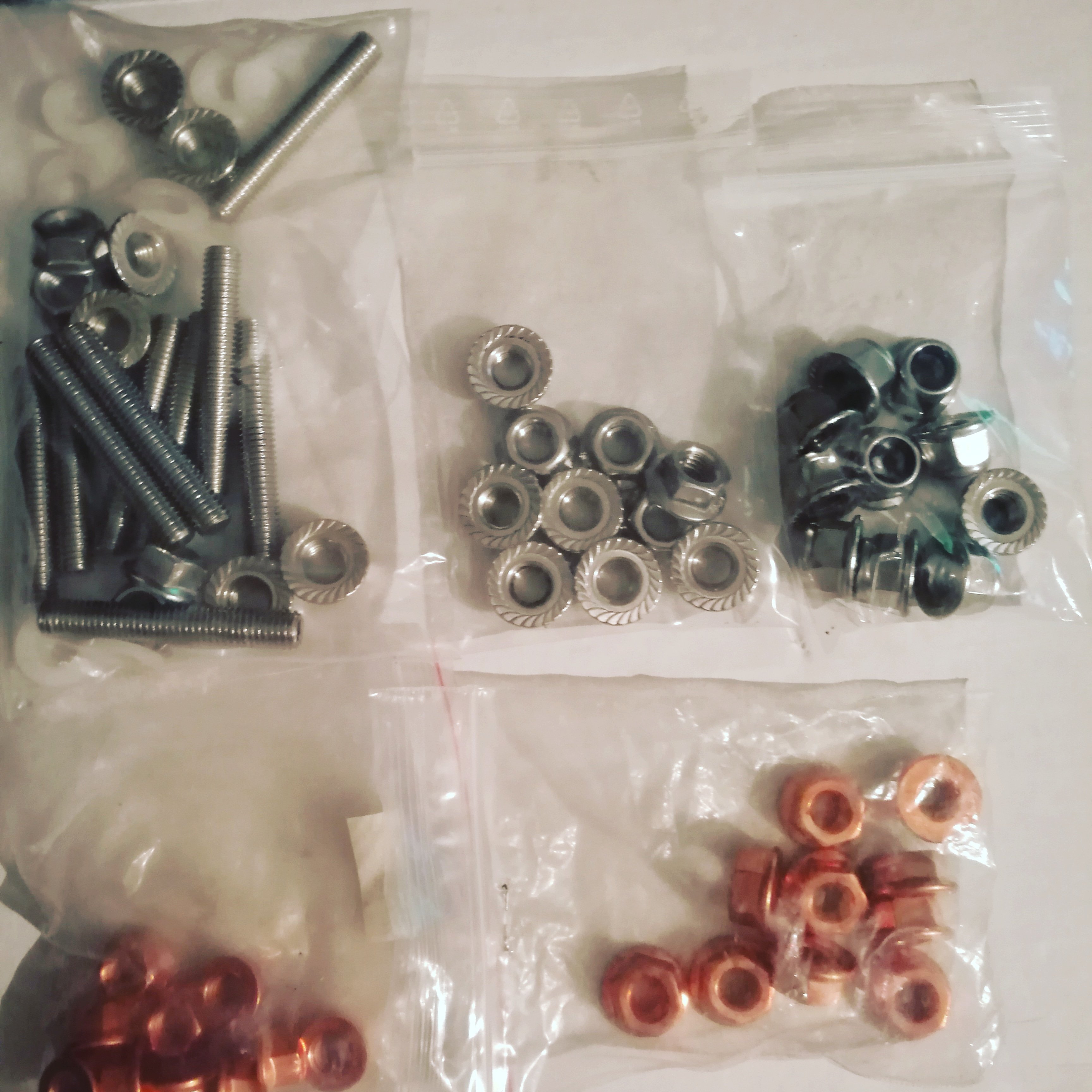

TIP was big pita to mount but with displaced water Line it was done. All New gasket,Bolts,studs,nuts and washers...

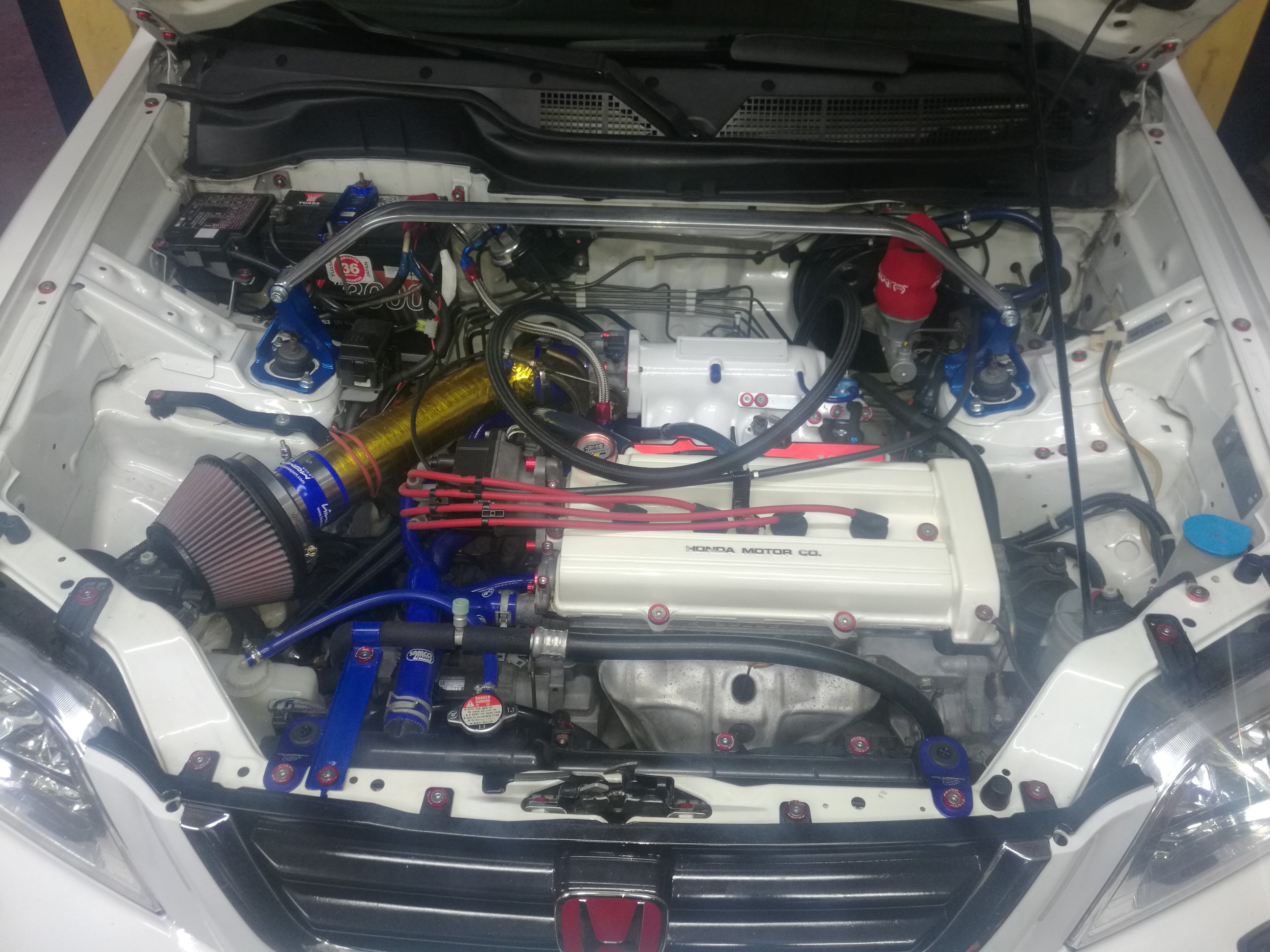

Did Mount New Cusco Strut bar on CRV

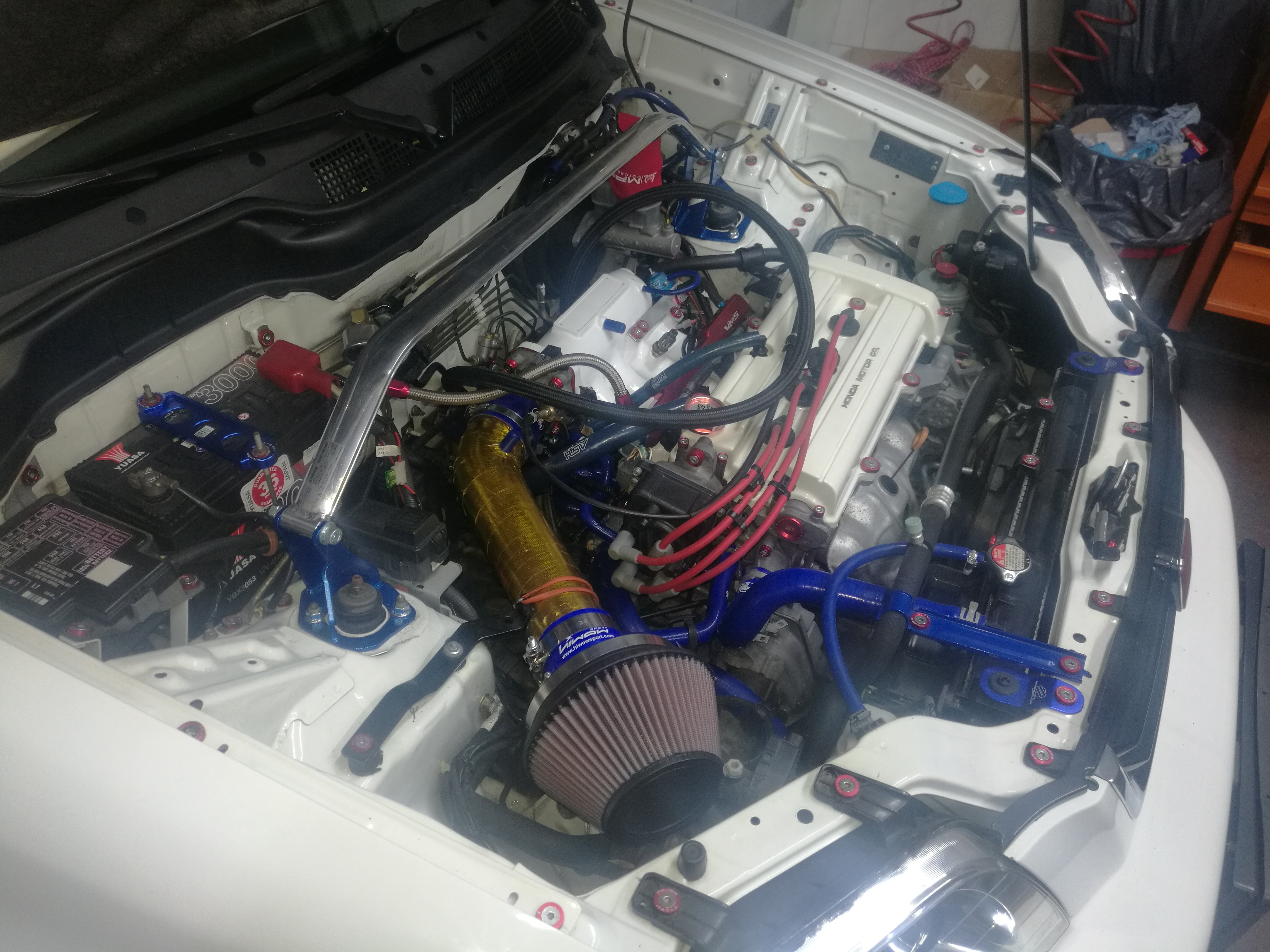

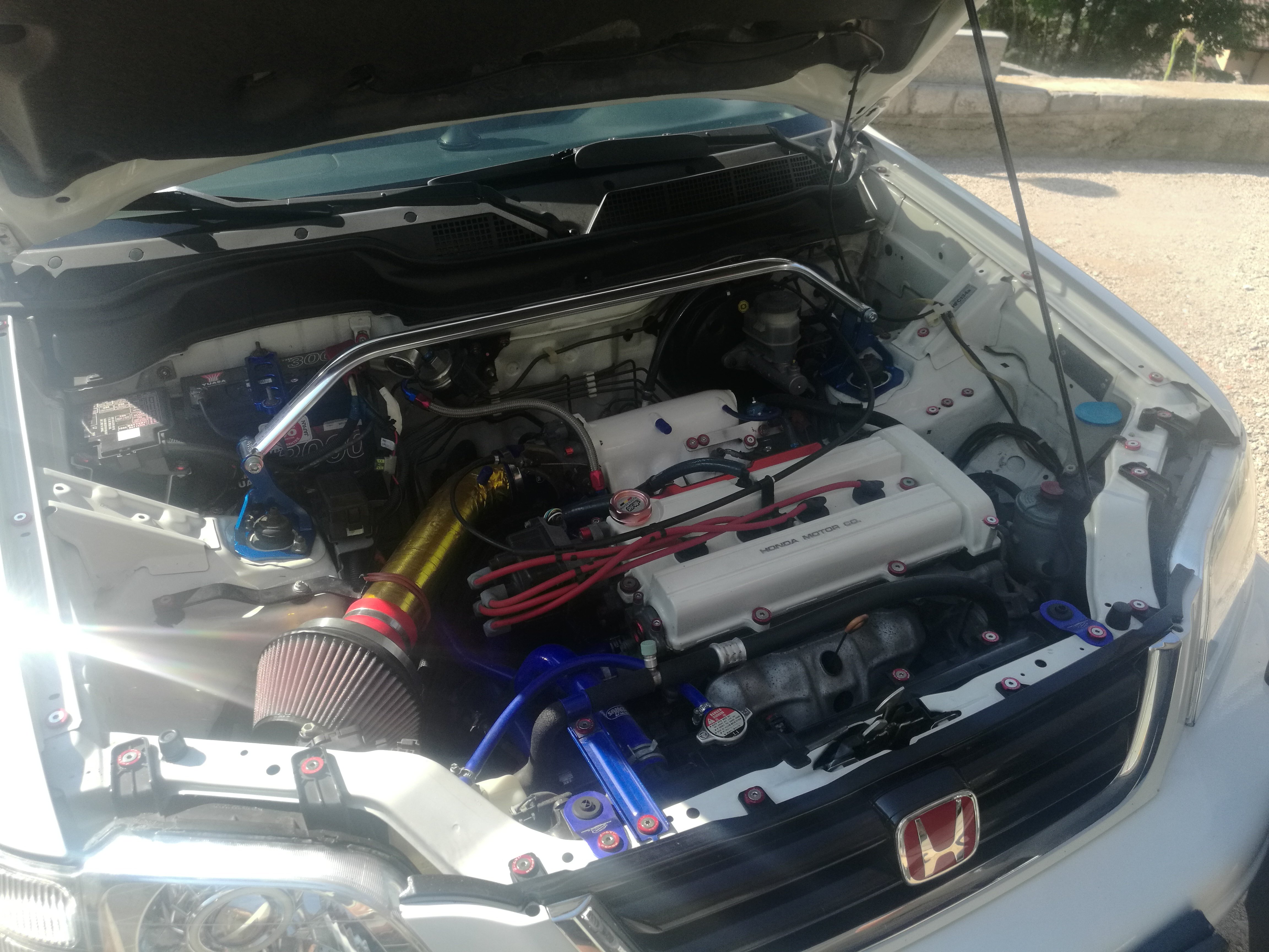

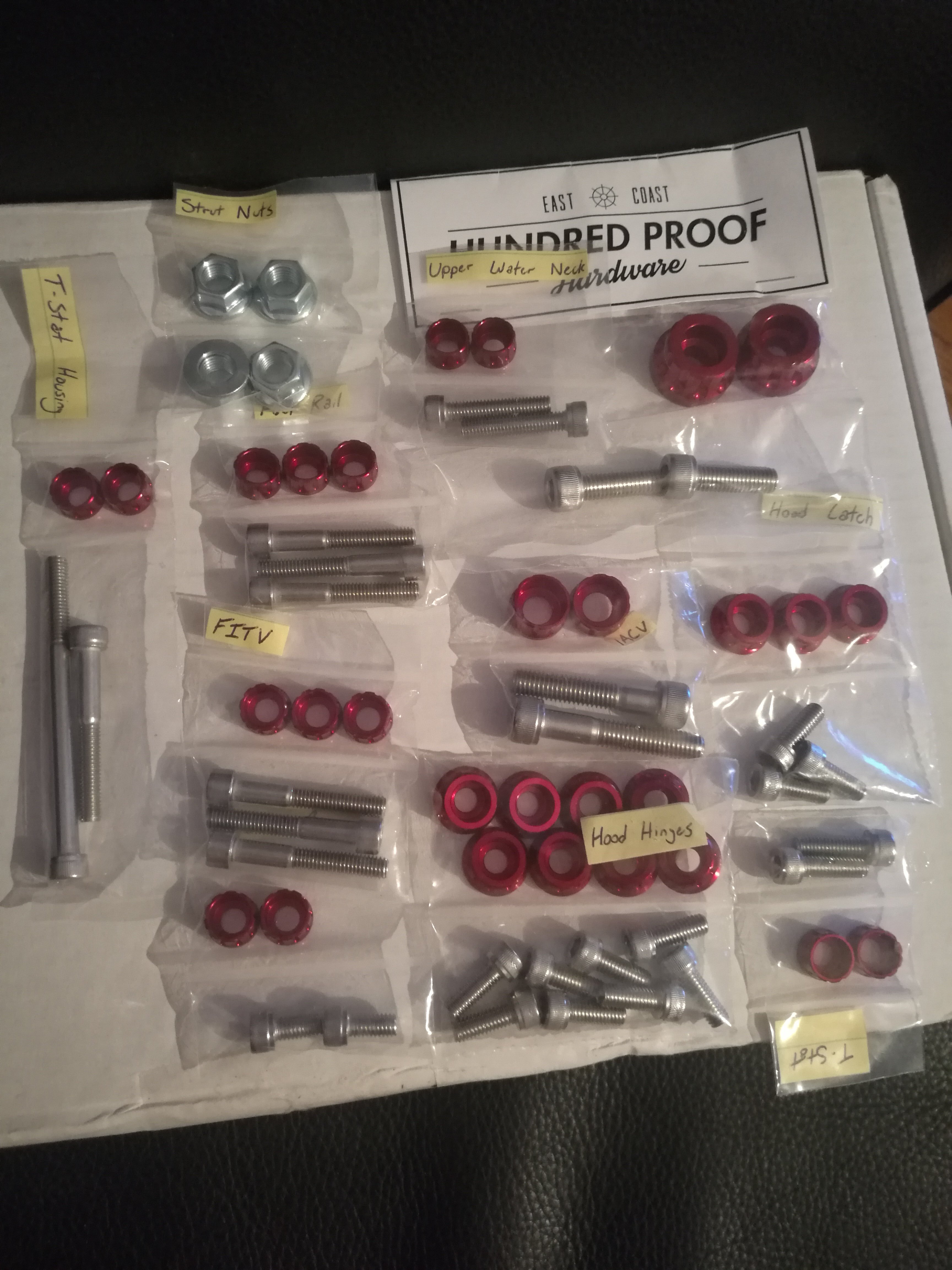

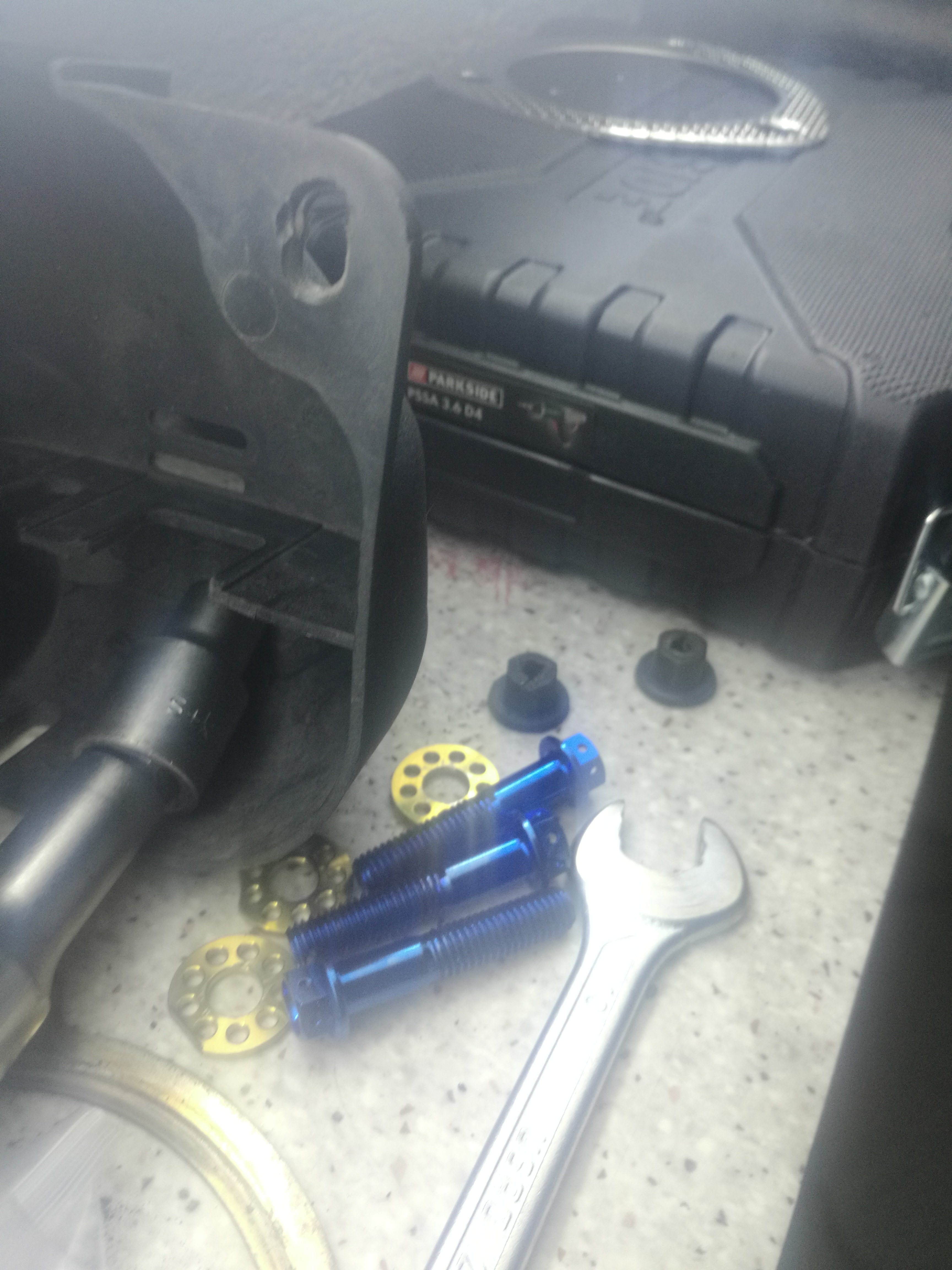

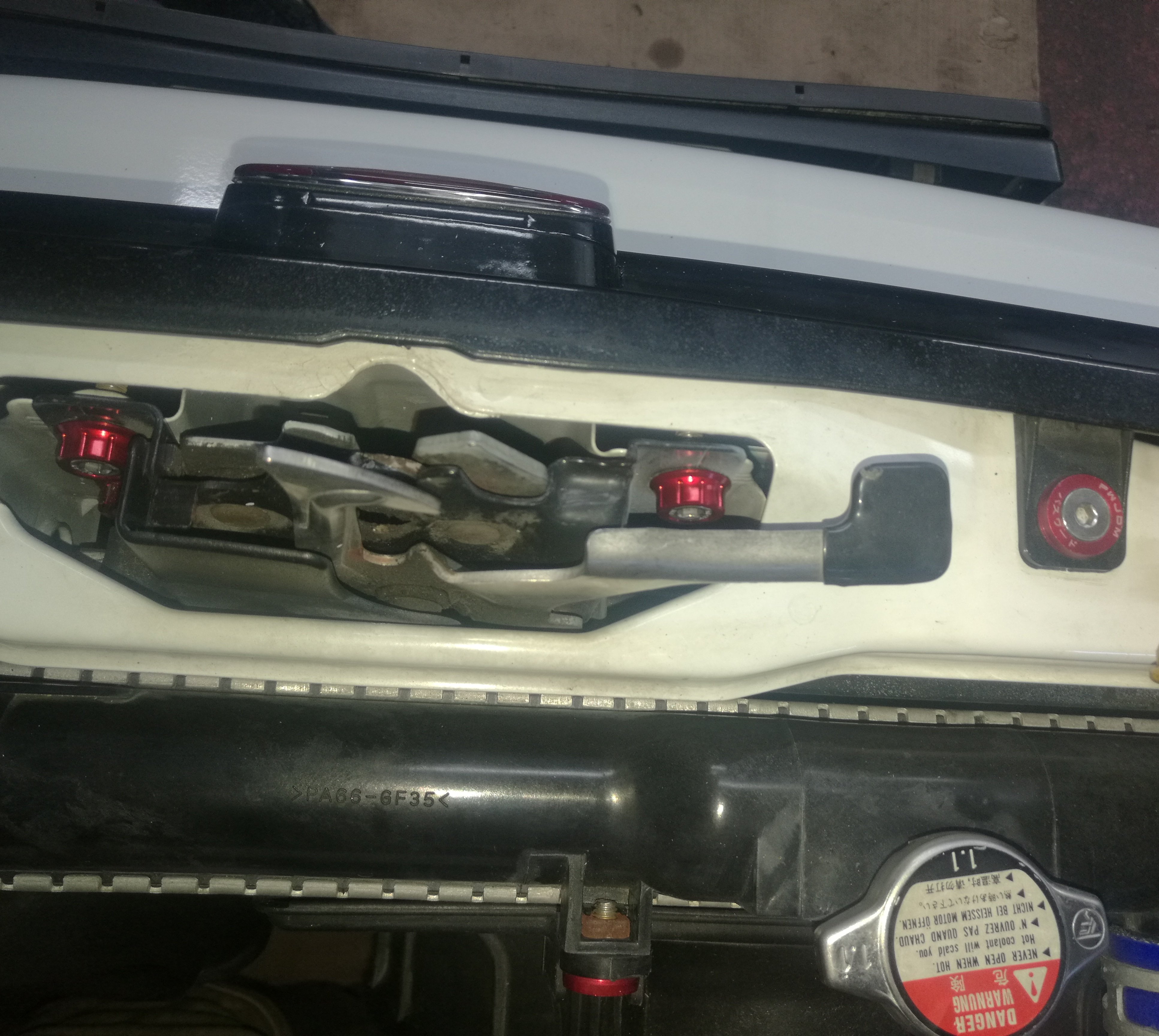

Will post some pics With New intake, Bolt washers and catch can install on my CRV.

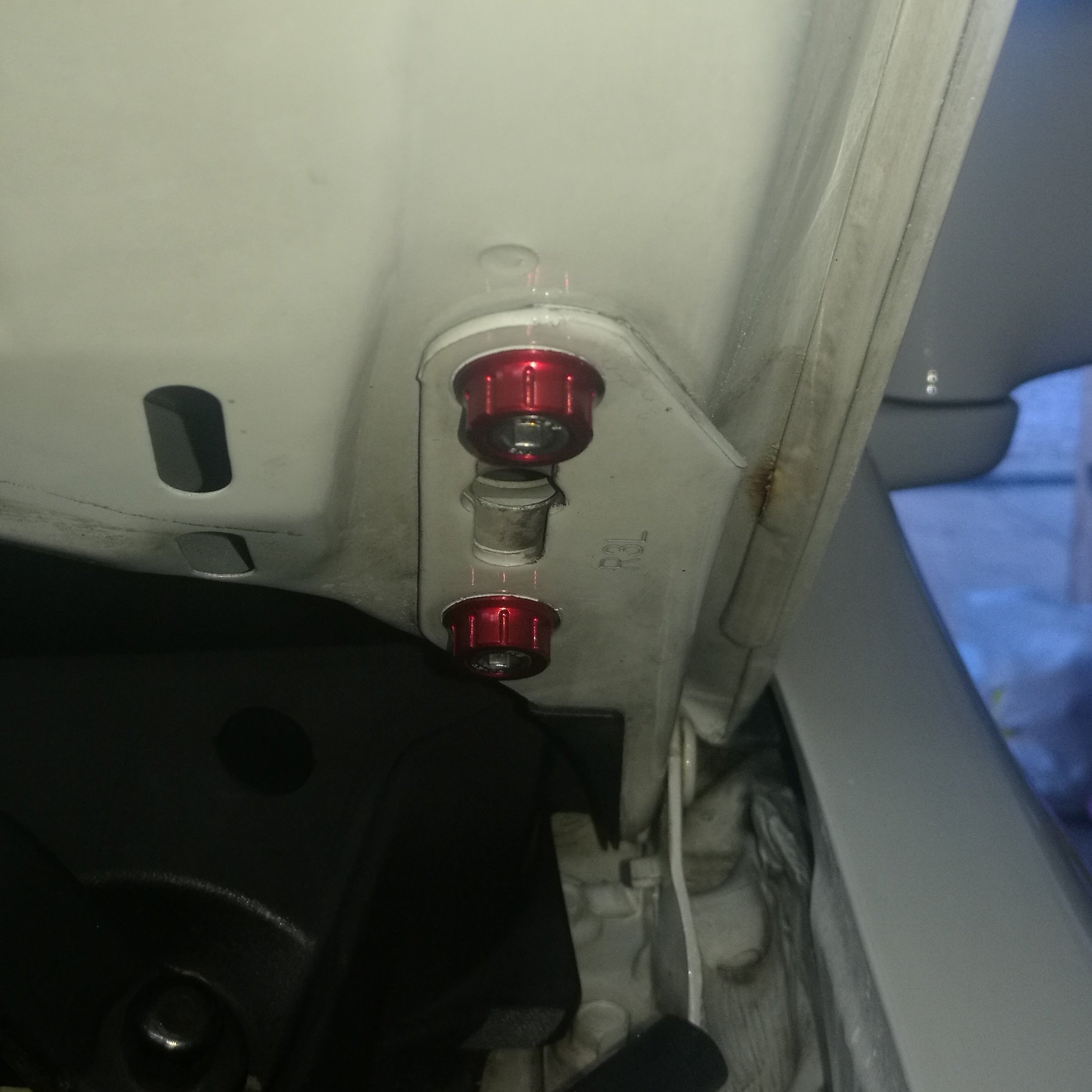

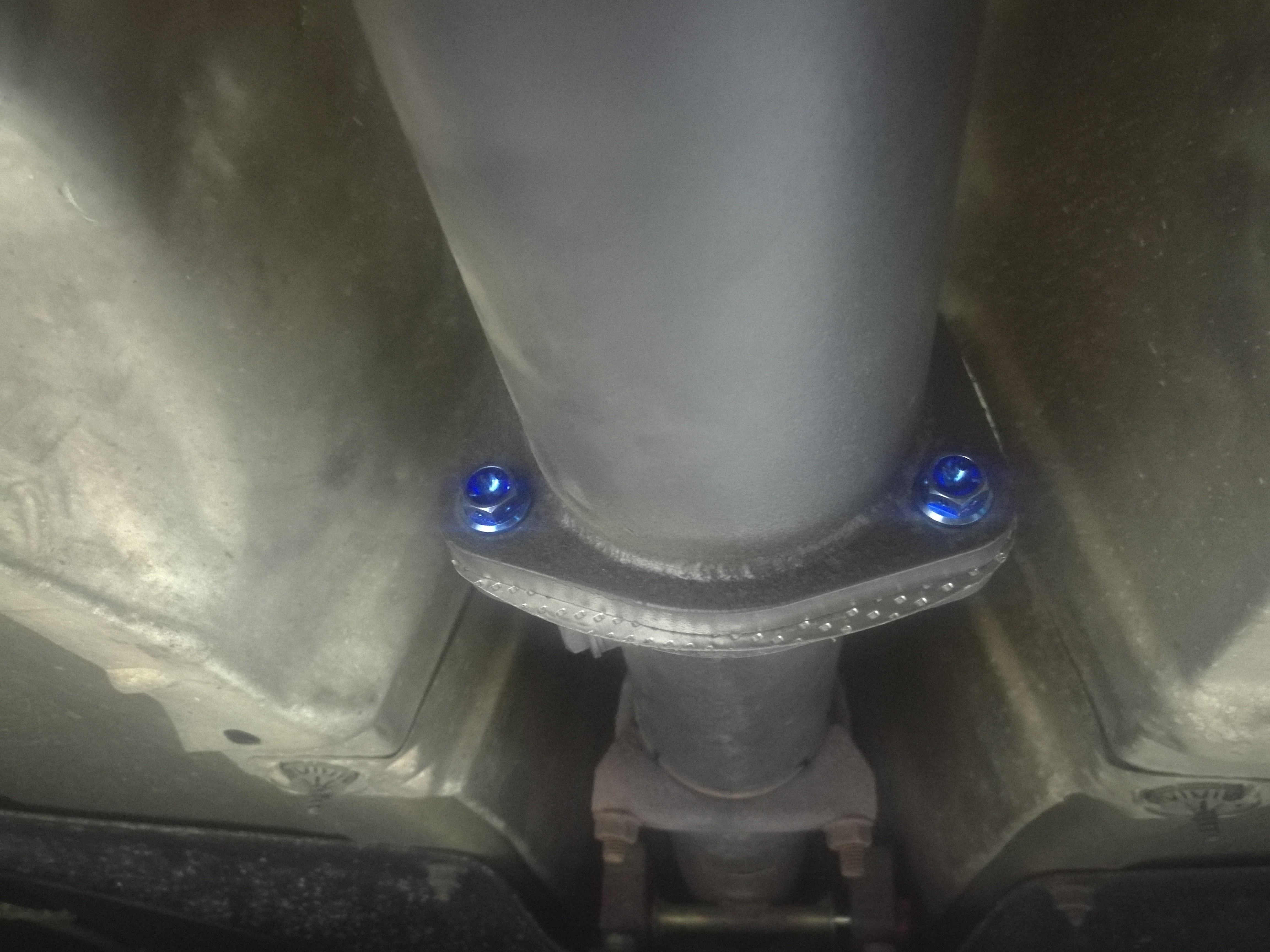

Some New stuff for CRV

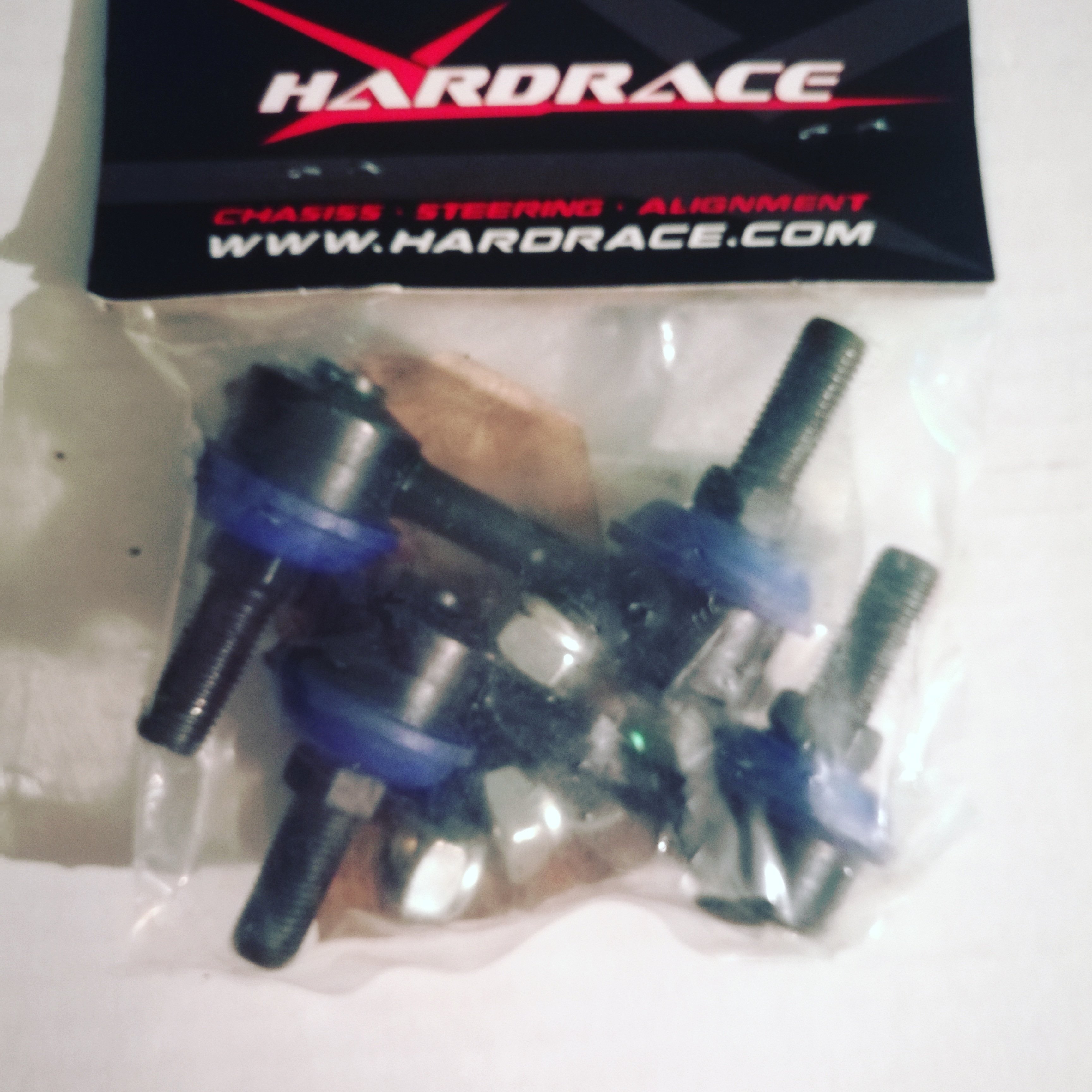

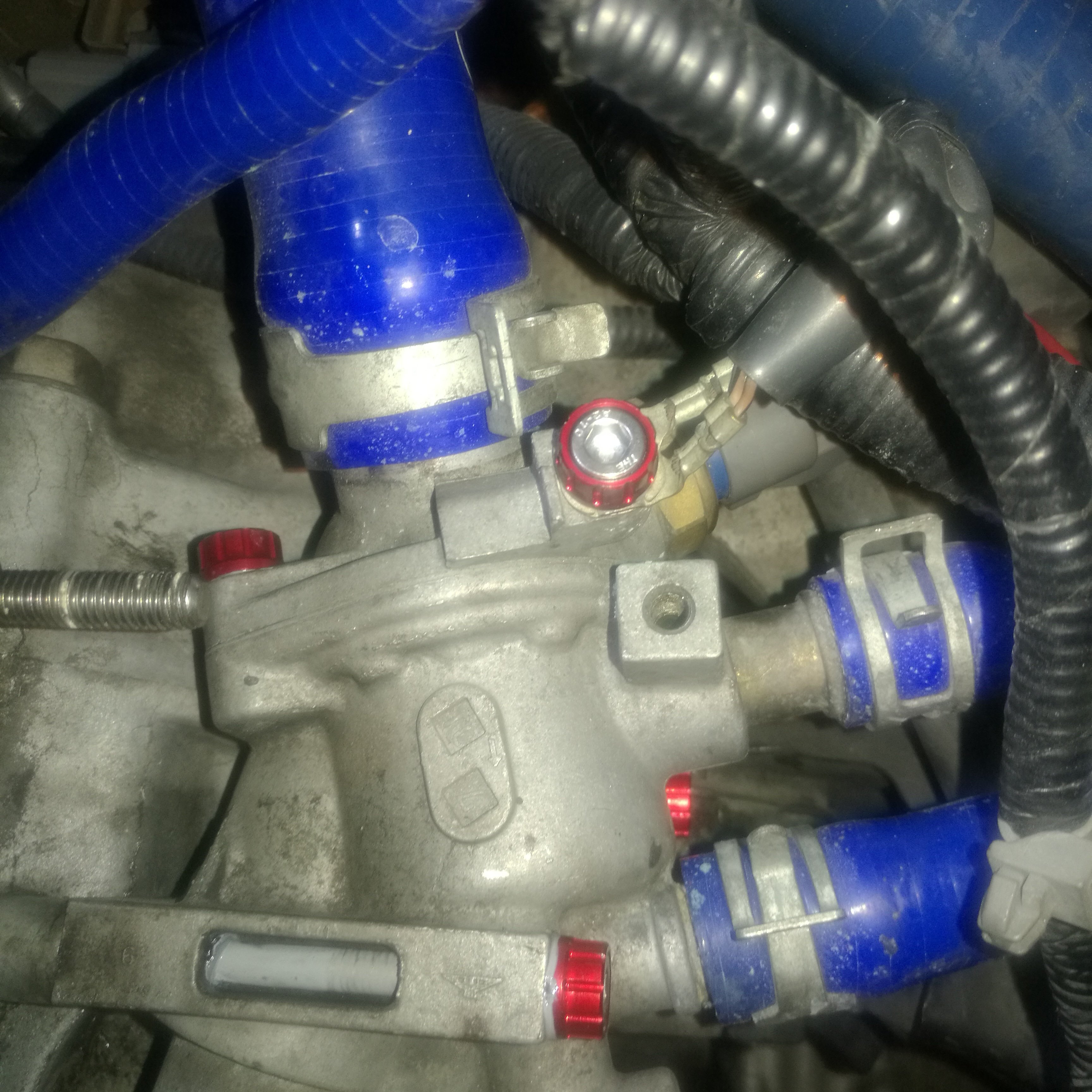

Some New bolts With red washers
Edited by davojuri

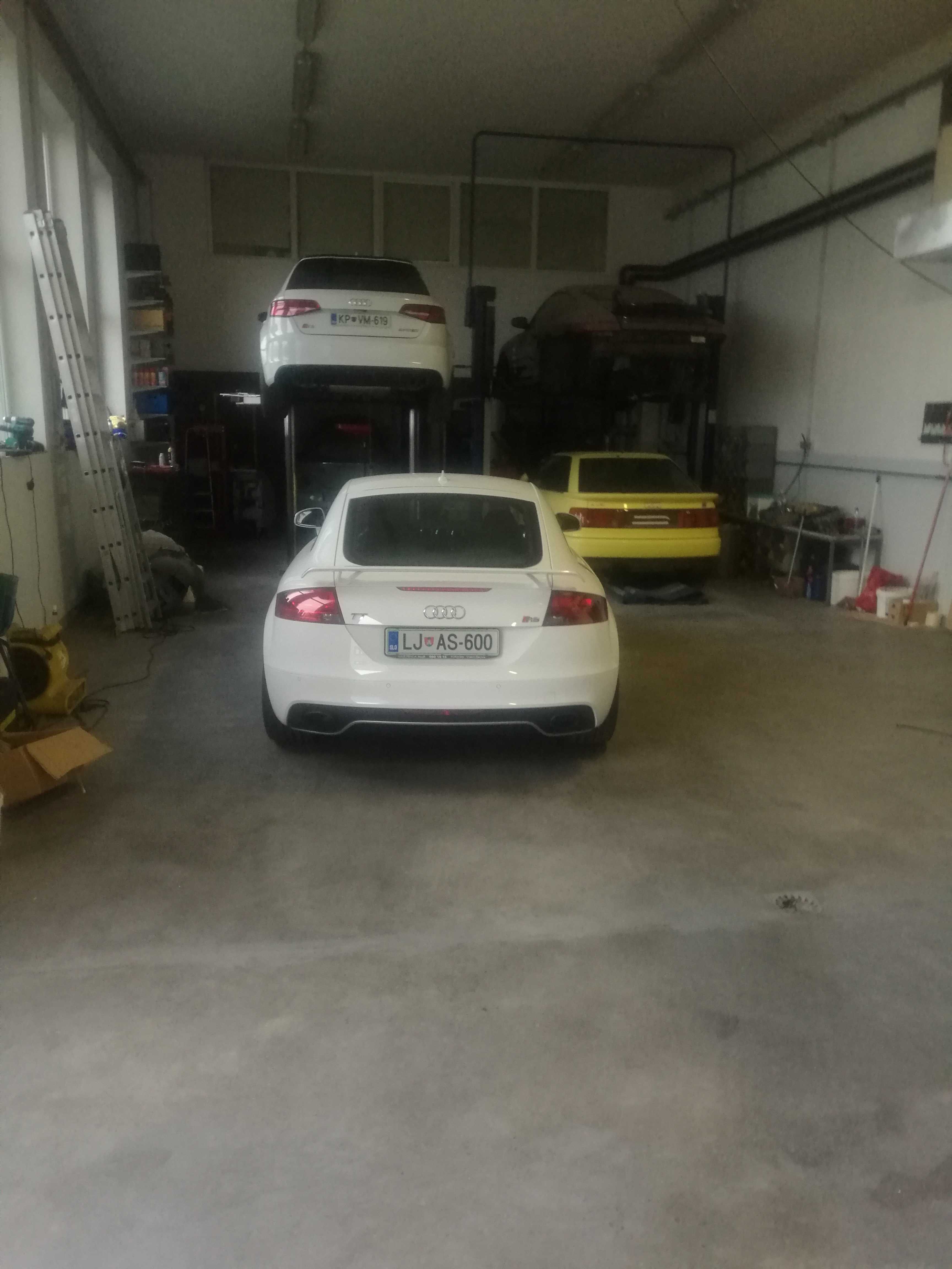

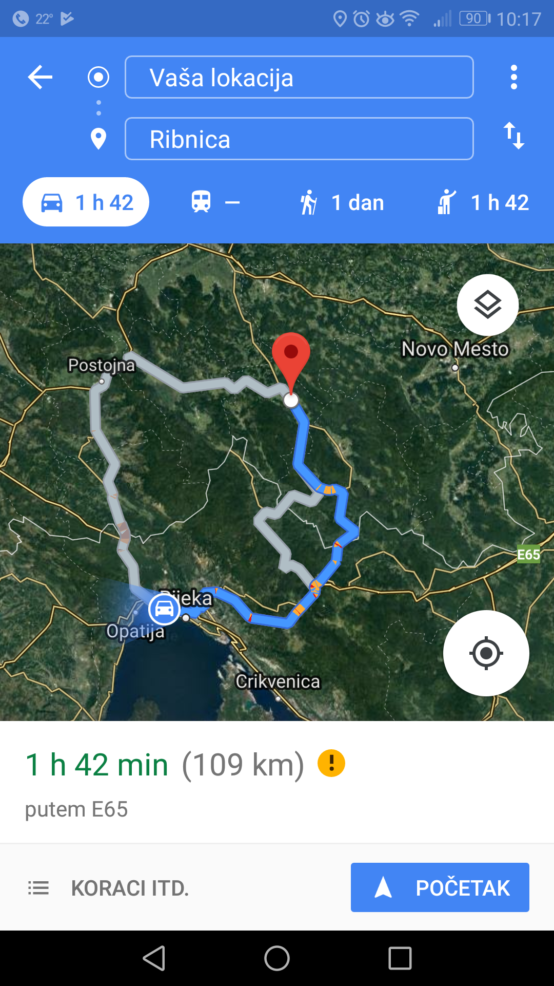

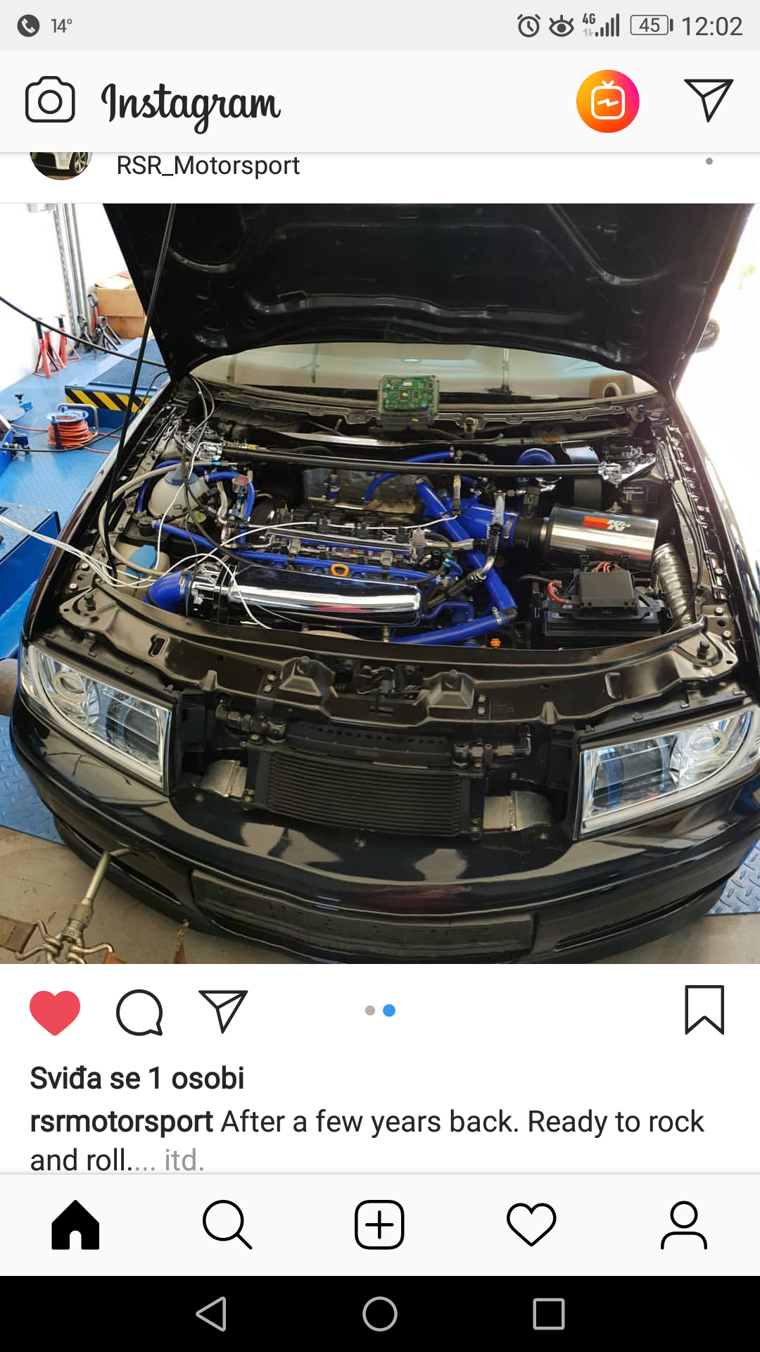

Truck is ready for transportation to www.rsrmotorsport.com at 15h today from Rijeka Croatia to Ribnica Slovenia.
Very excited:evilgrin:
Car has been delivered to www.rsrmotorsport.com
Next Saturday Will be dyno mapping.
Can't wait

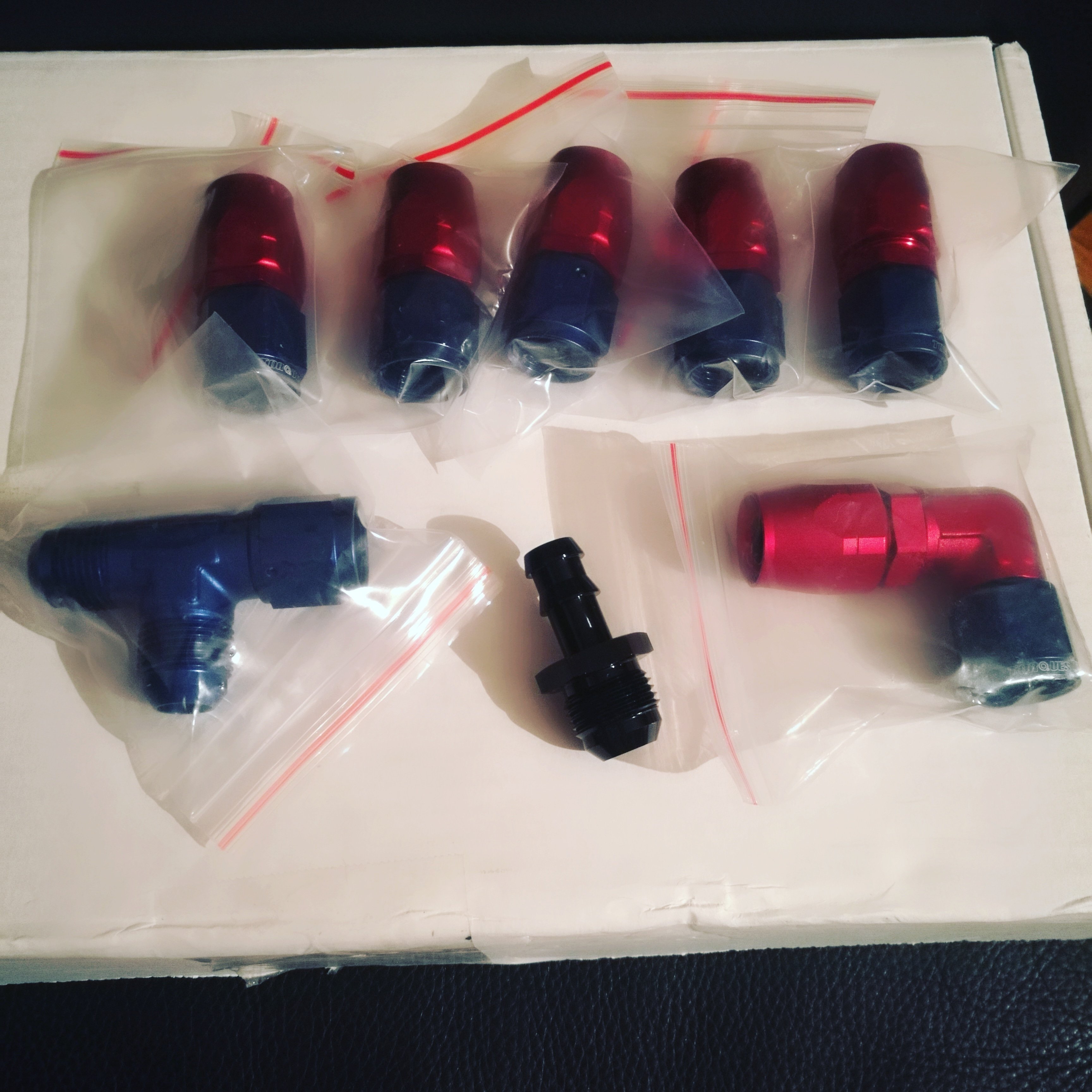

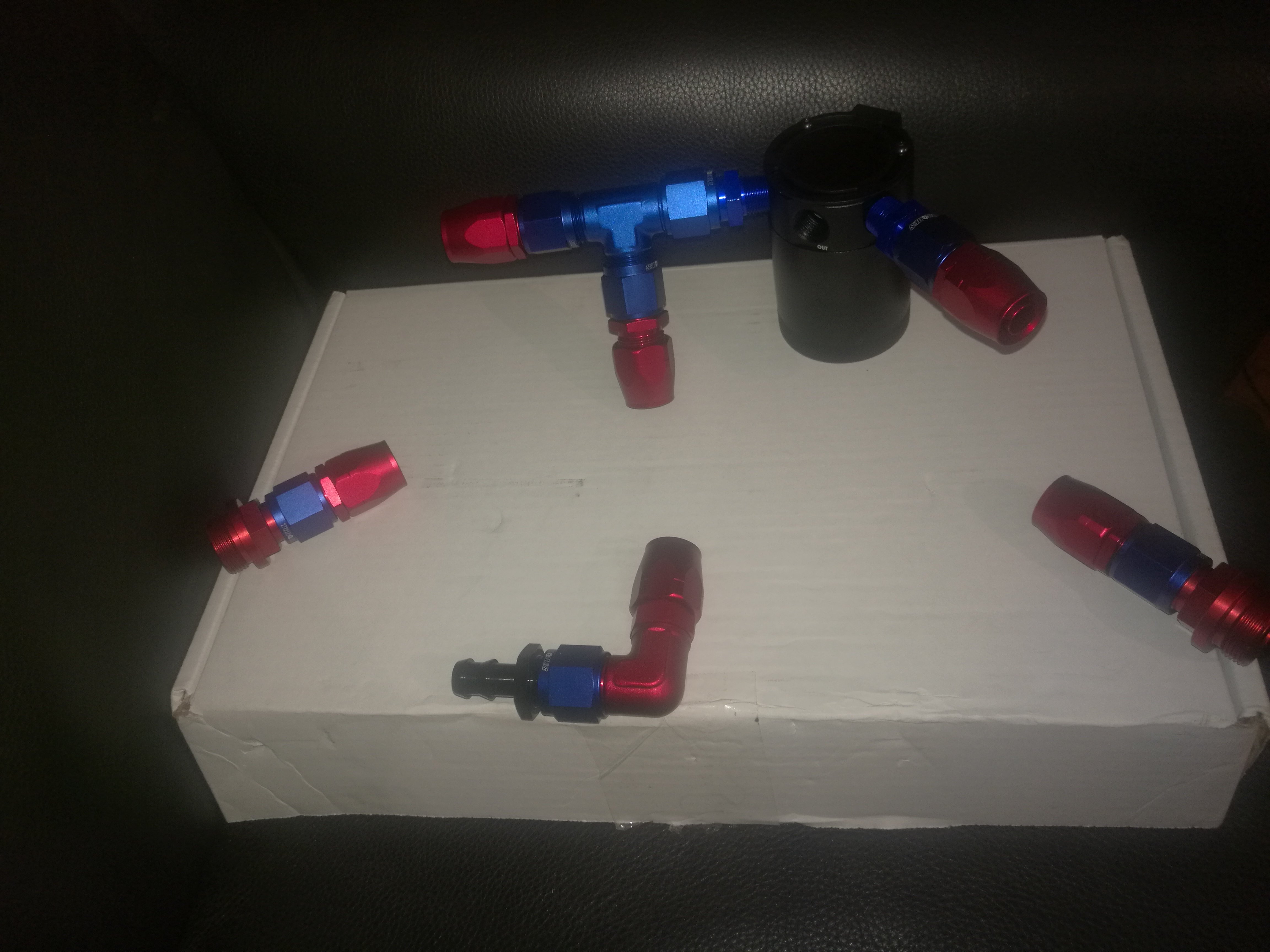

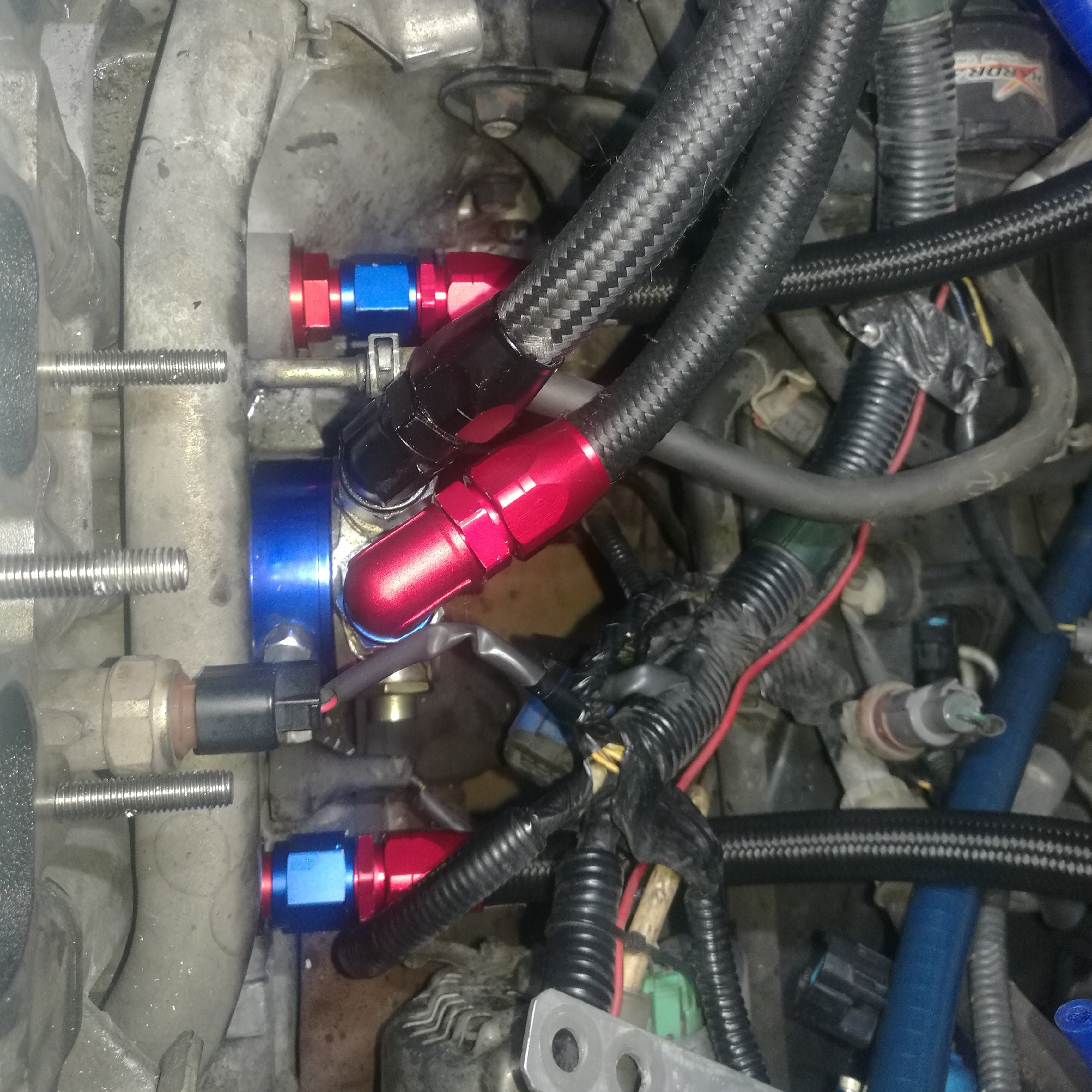

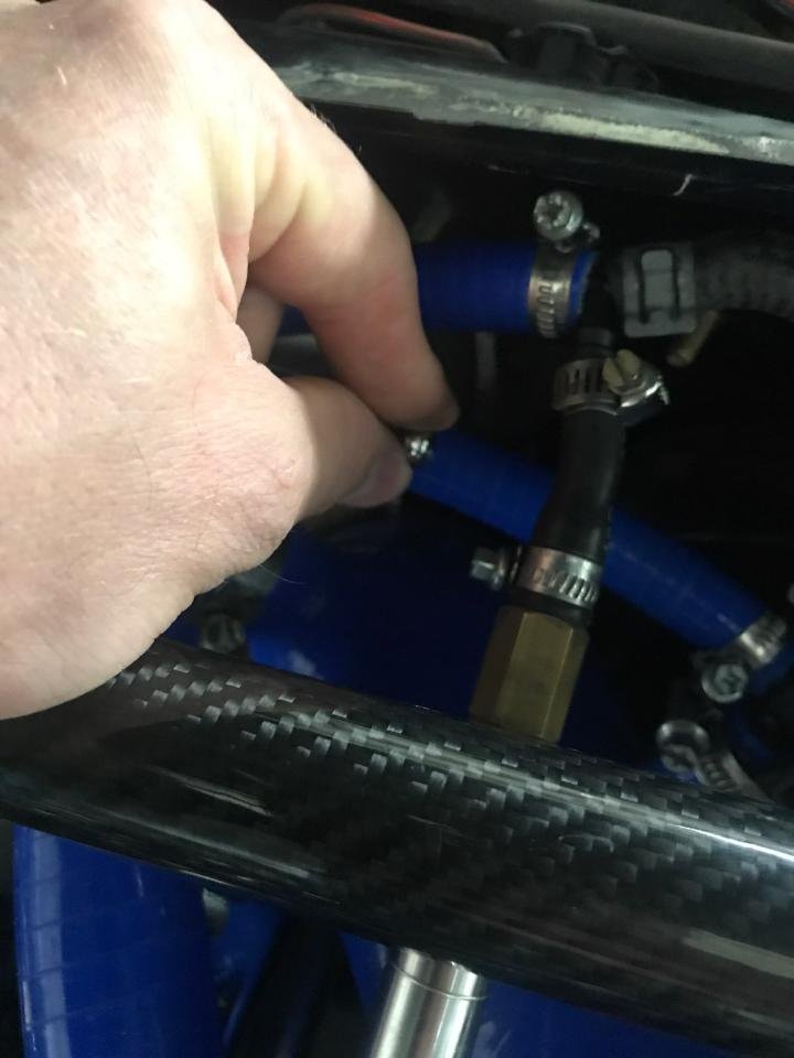

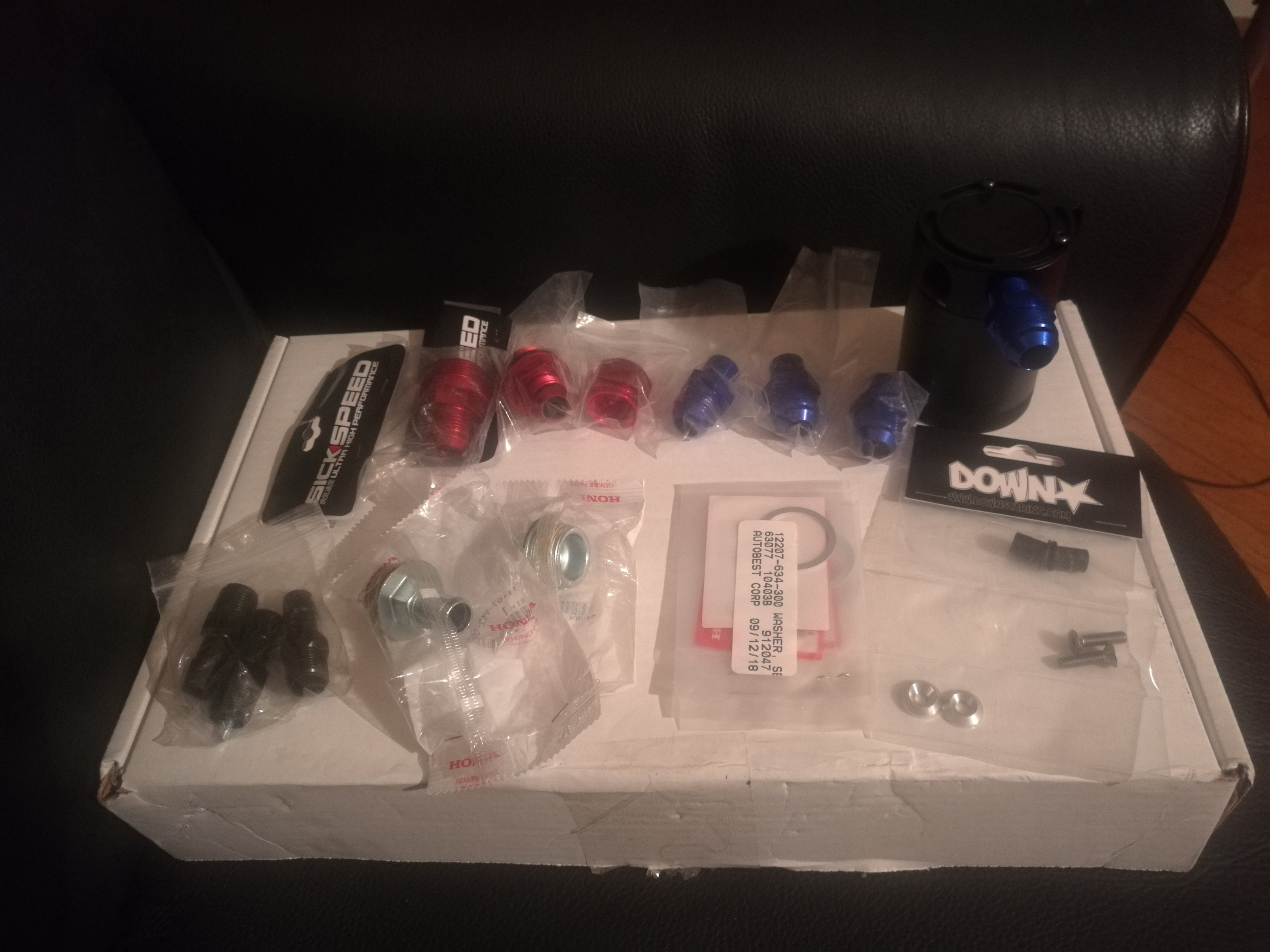

In the meanwhile all parts for CRV collected and Here is my planned catch can set up. Two lines comming from block breather - left and right and one from valve cover to T joint

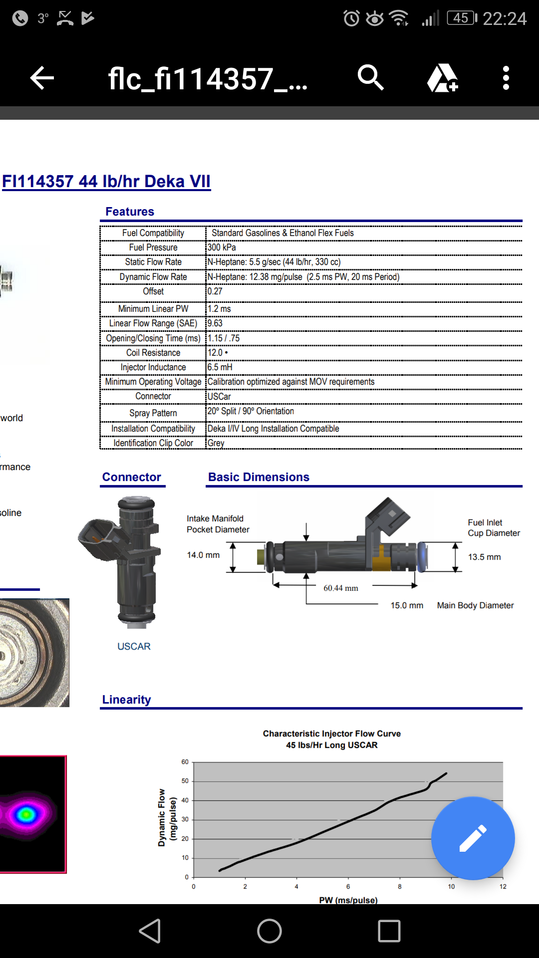

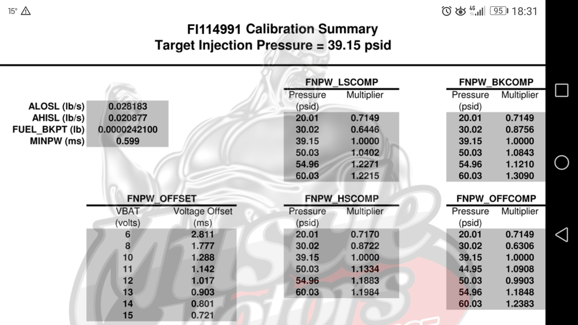

Hi guys
Need some help
Can't find such info Like here
For  my injectors Siemens Deka FI114357.
Do You have it or can get it or whom can I ask for???
Hope You can help?
Need it for mapping.
Found only this and it is not sufficient.
Regards
Davor
Edited by davojuri
In other words I need
1. flow n-heptan
and
2. battery offset
for Siemens Deka FI114357
HELP NEEDED
It should look Like this
Any help????

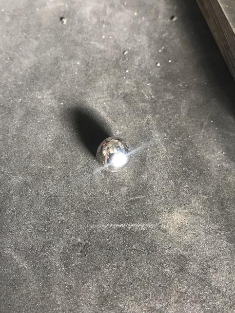

Action right now
My tuner just asked me what is this ball and where did it came from?
It was in hose that brings pressure to N75...and thus out of functioin!
Lucky me he has sensor on all possible places and found that error and saved engine. But bigest enigma is who,when and why did put it in that hose????
I have no idea? And I am Always present while working on my car.
