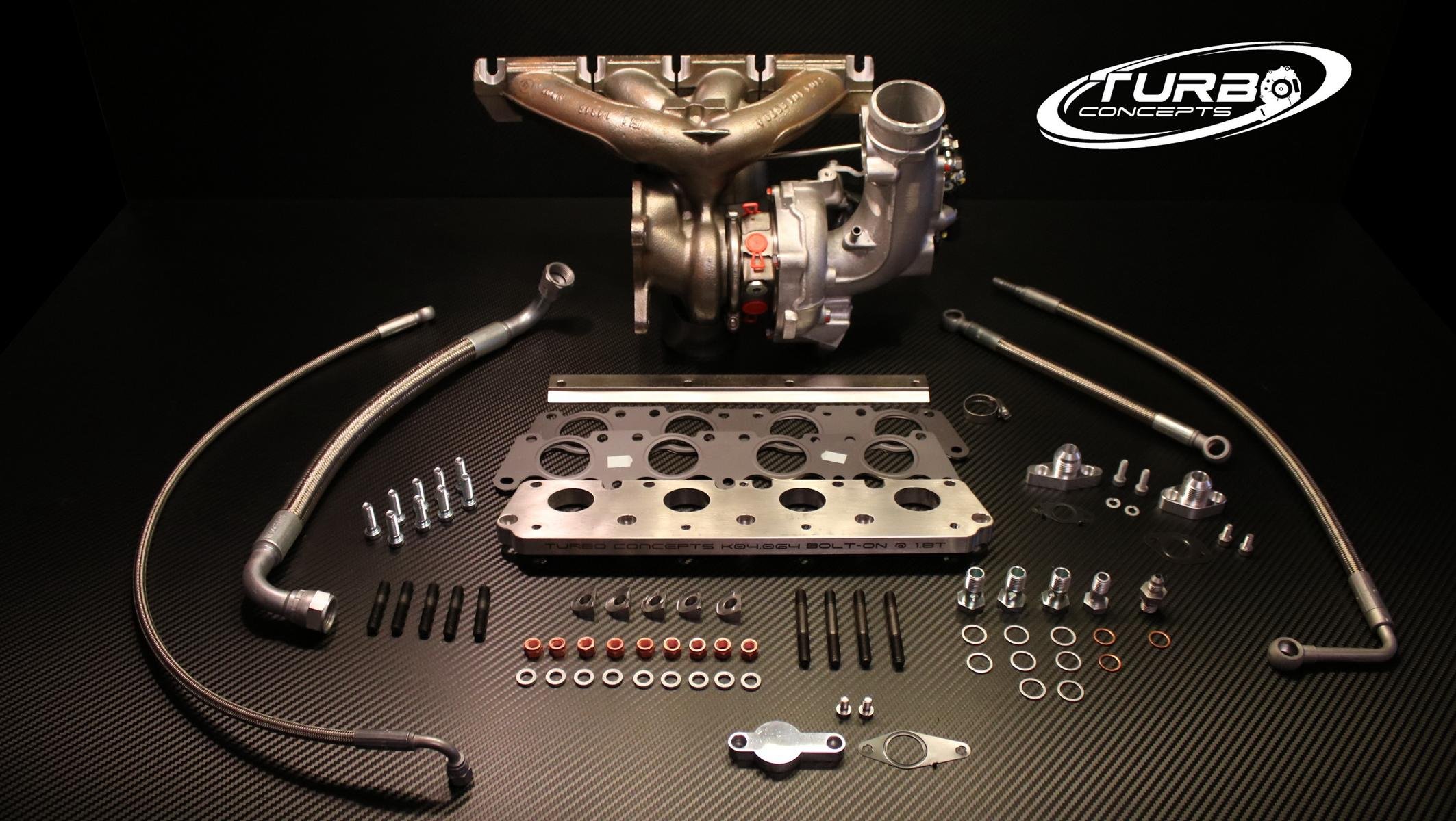

Than ofcourse forged blok and cnc head With K04-064 hybrid
https://www.turbo-concepts.de/Turbo-Technik/TC-Plus-X-RS-Upgrade-Lader/1.8T-Lader-Kits-quer-Motoren/293/K04.064-Turbo-Kruemmer-Kit-fuer-1.8T-quer?c=263

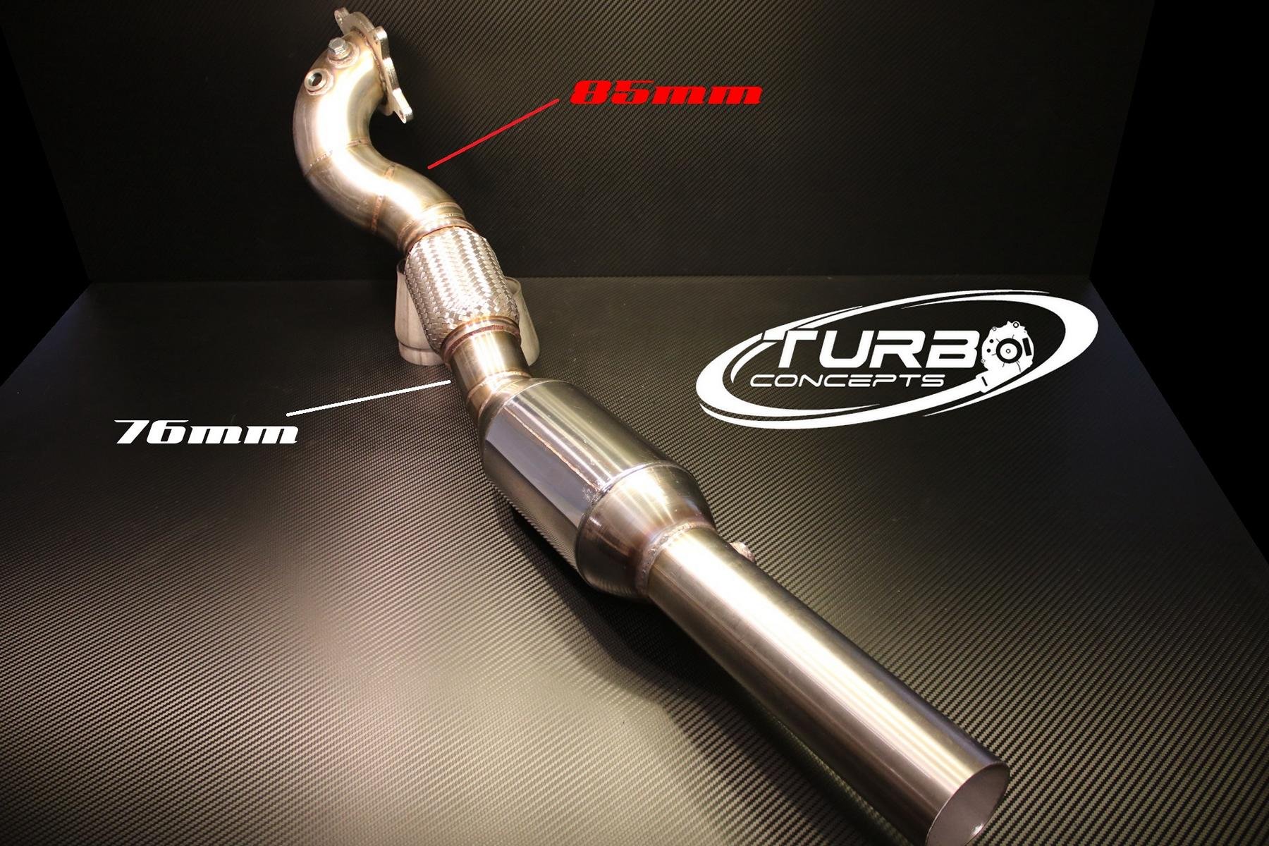

It Has Water/oil Lines,  DP, intake
and driveshaft 2.9stage

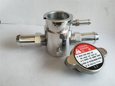

I found also overflow tank for WIC

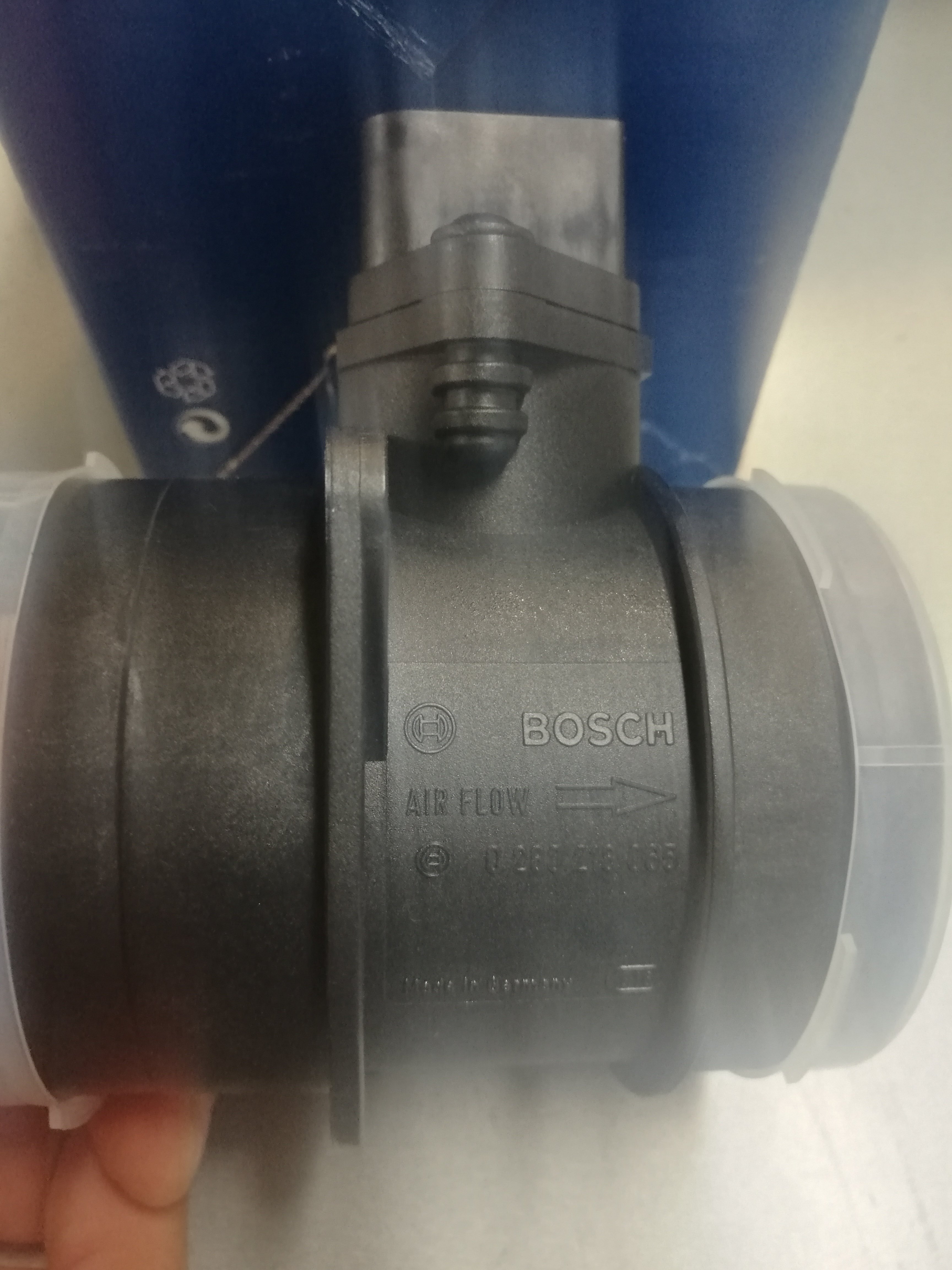

And now MAF out of function-ordered new Bosch one

Bought New MAF.
Today he should get it by post in Slovenia and hope, as Joo said, that it is the last problem in already long list of ones in this custom remap session

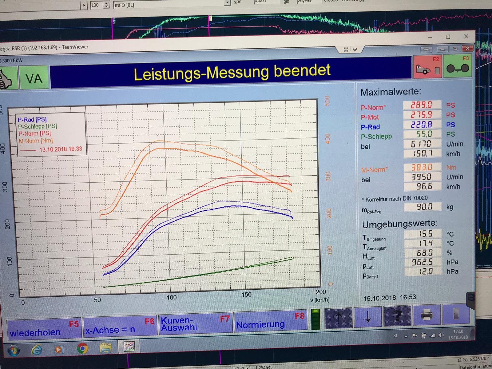

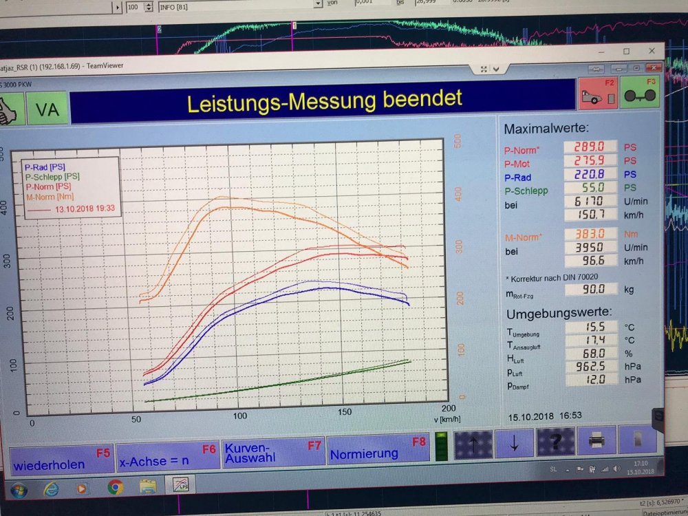

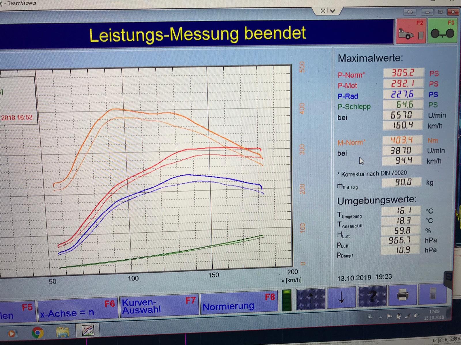

Here are the final numbers
Water cooled
305.2hp
403.4Nm
Forge FMIC
289hp
383Nm
Old figures With K04-001 were
269.5hp
375Nm
What is your opinion?

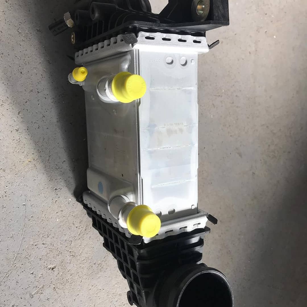

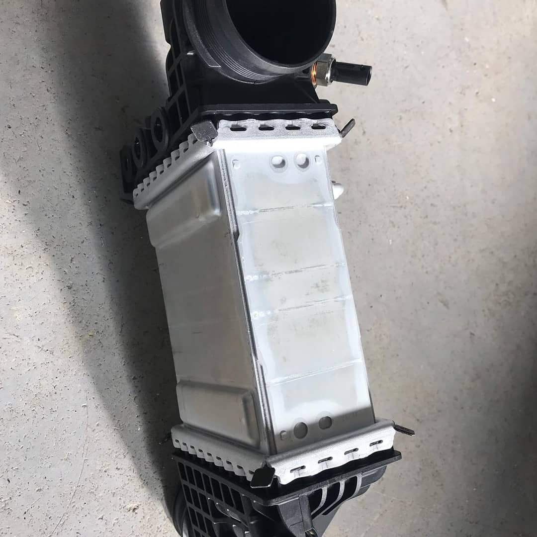

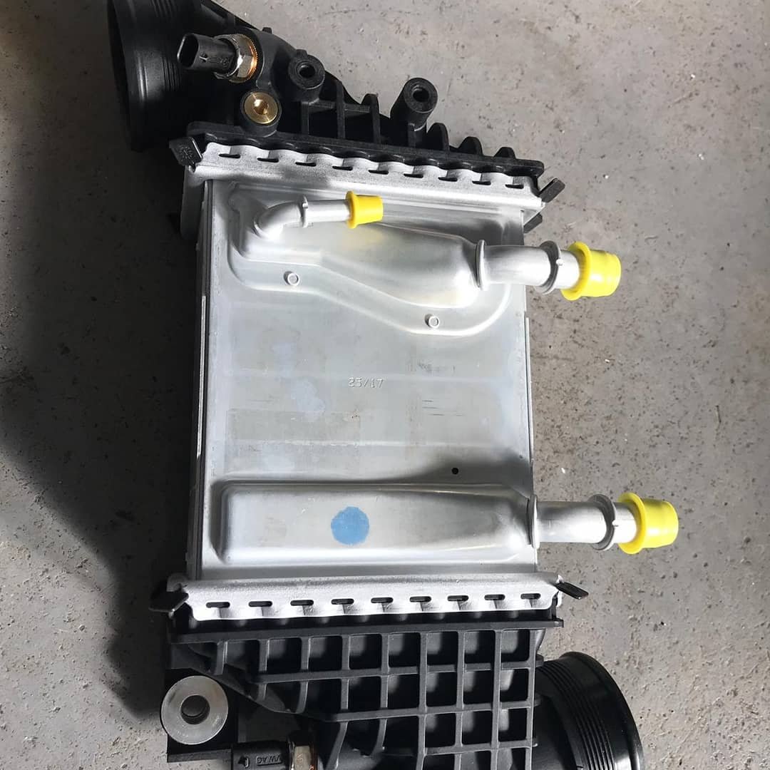

Yes. We defined the new wic which is almost the same in dimenssions Like OE SMIC, has two temperature sensors over which ecu (when connected to it) regulates how water pump works. He is waiting for prices from 8 companies for front Mount water cooler-heat exchanger because they are New and can be obtained only through official dealership  network which is 5x more expensive. So he is pulling his strings to get best Price together with latest technology water pump. New WIC on the pictures is 150eur

this really look interesting. so, it is SMIC, I see one more benefit from that, front water cooling will no longer be affected by FMIC, as air flow will be better.
is this water cooled by own water tank, or it is using water from cooling system? any link for already sorted?

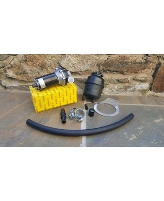

It is closed system,separated from the engine. Only thing that I still haven't solved is that question. Beside filler neck there should be a tank also. I found online only this one on the picture black bottle on the right. And yes better engine watter cooling because Free Space in front of water radiator. We Will see what Matjaž Says. He is not mentioning that and we all know that the tank when hot and when cold is not filled the same level. Fluid expands.
