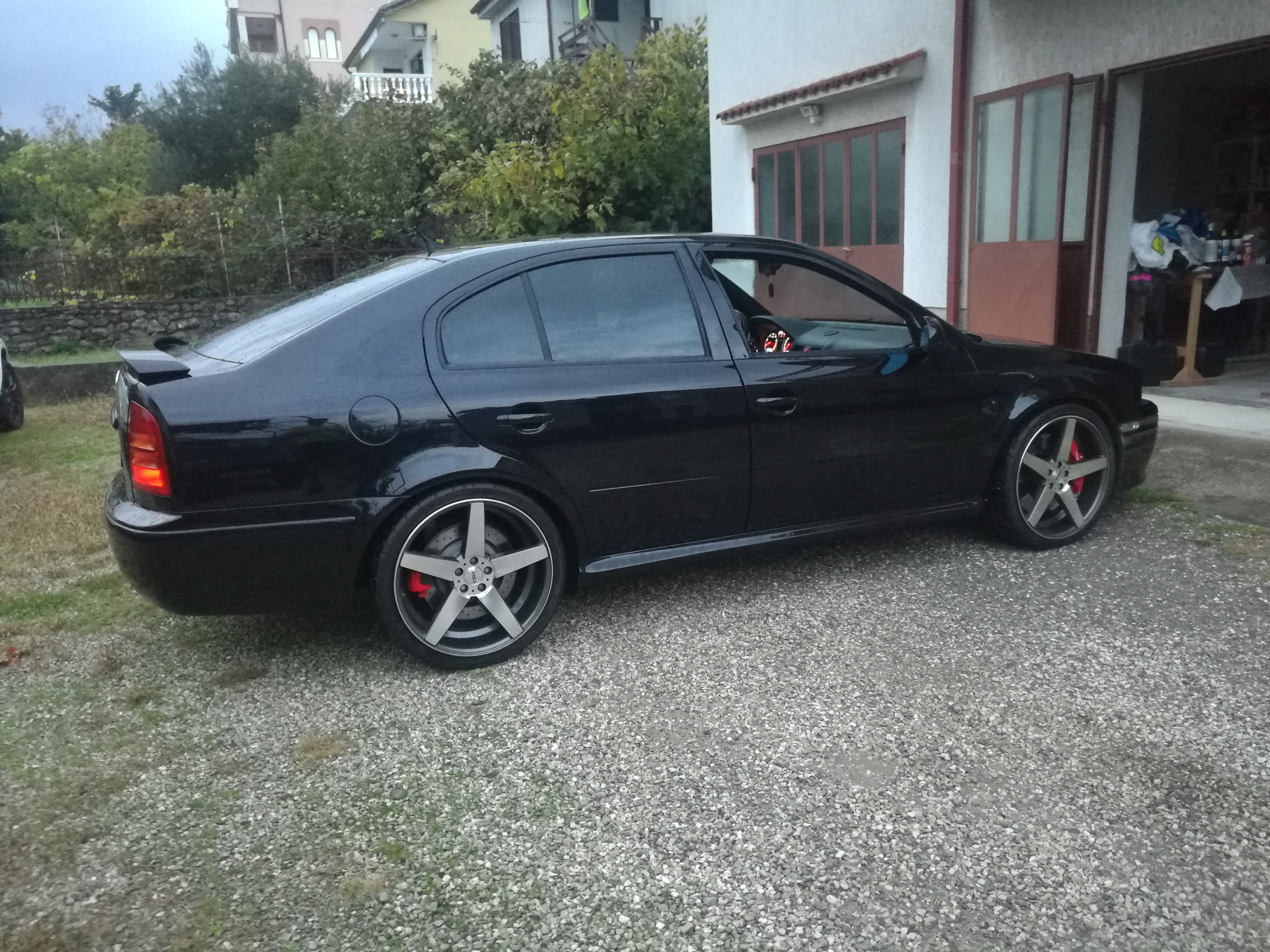

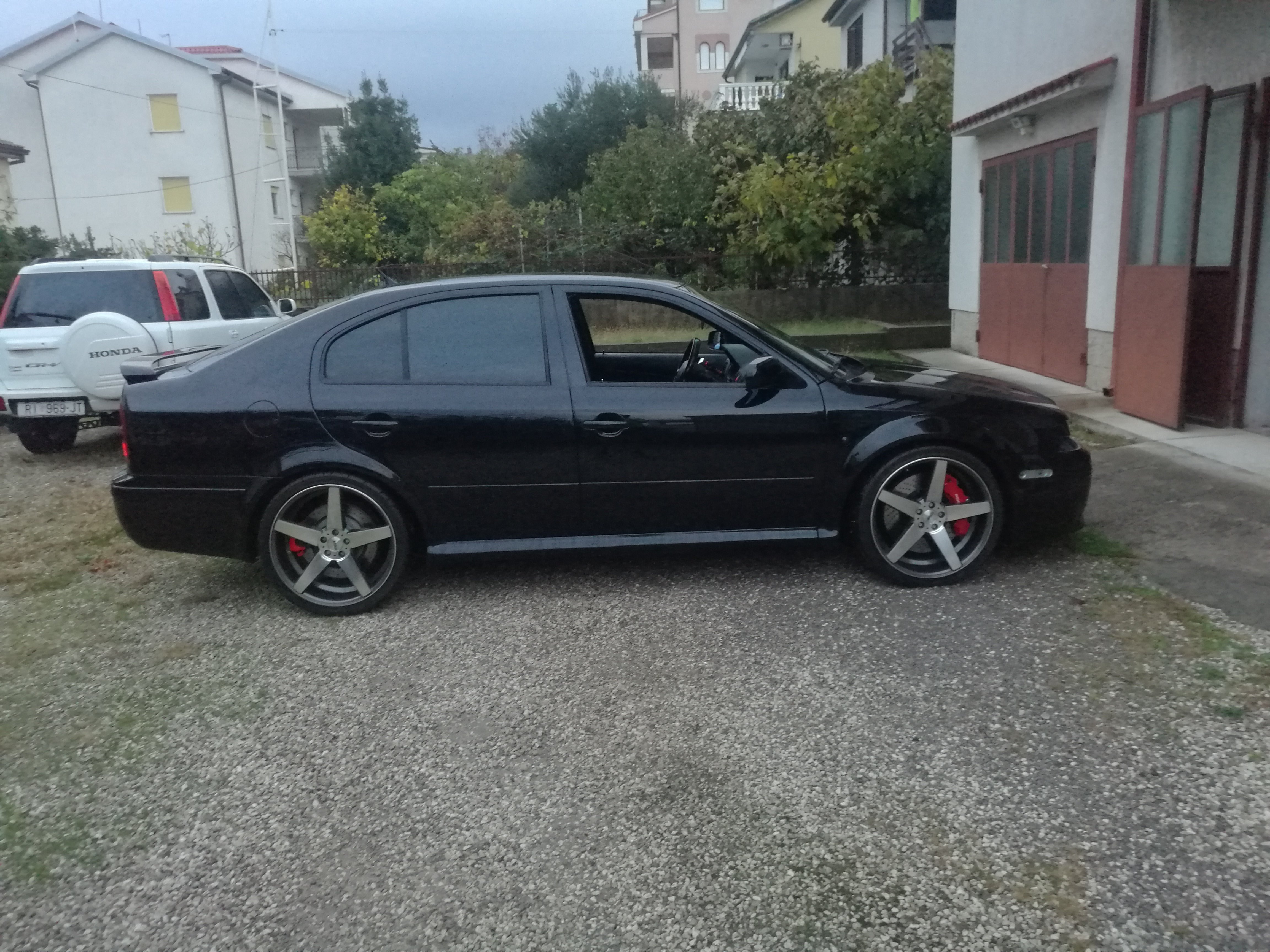

New Croatian VRS 236hp 19inches

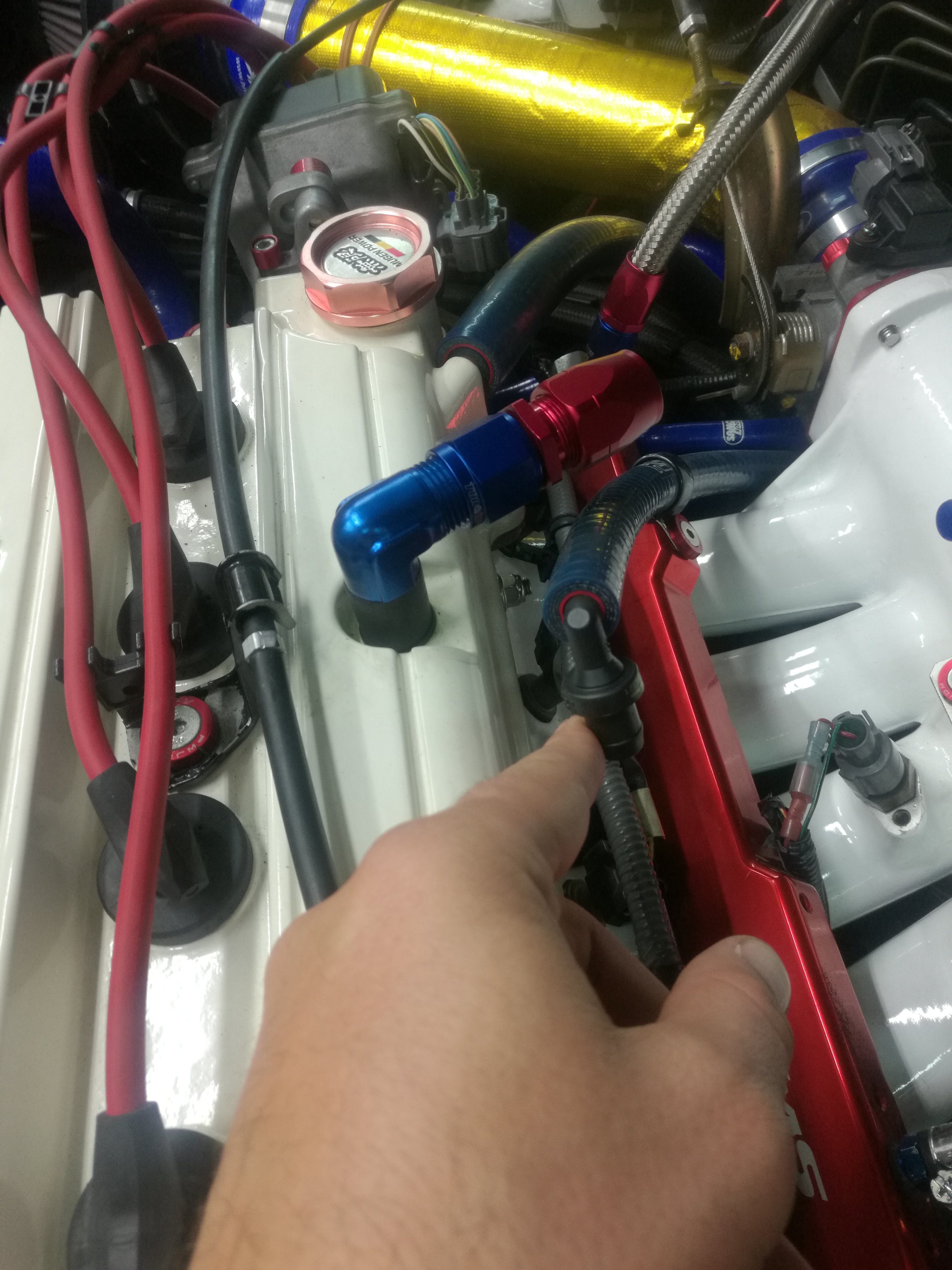

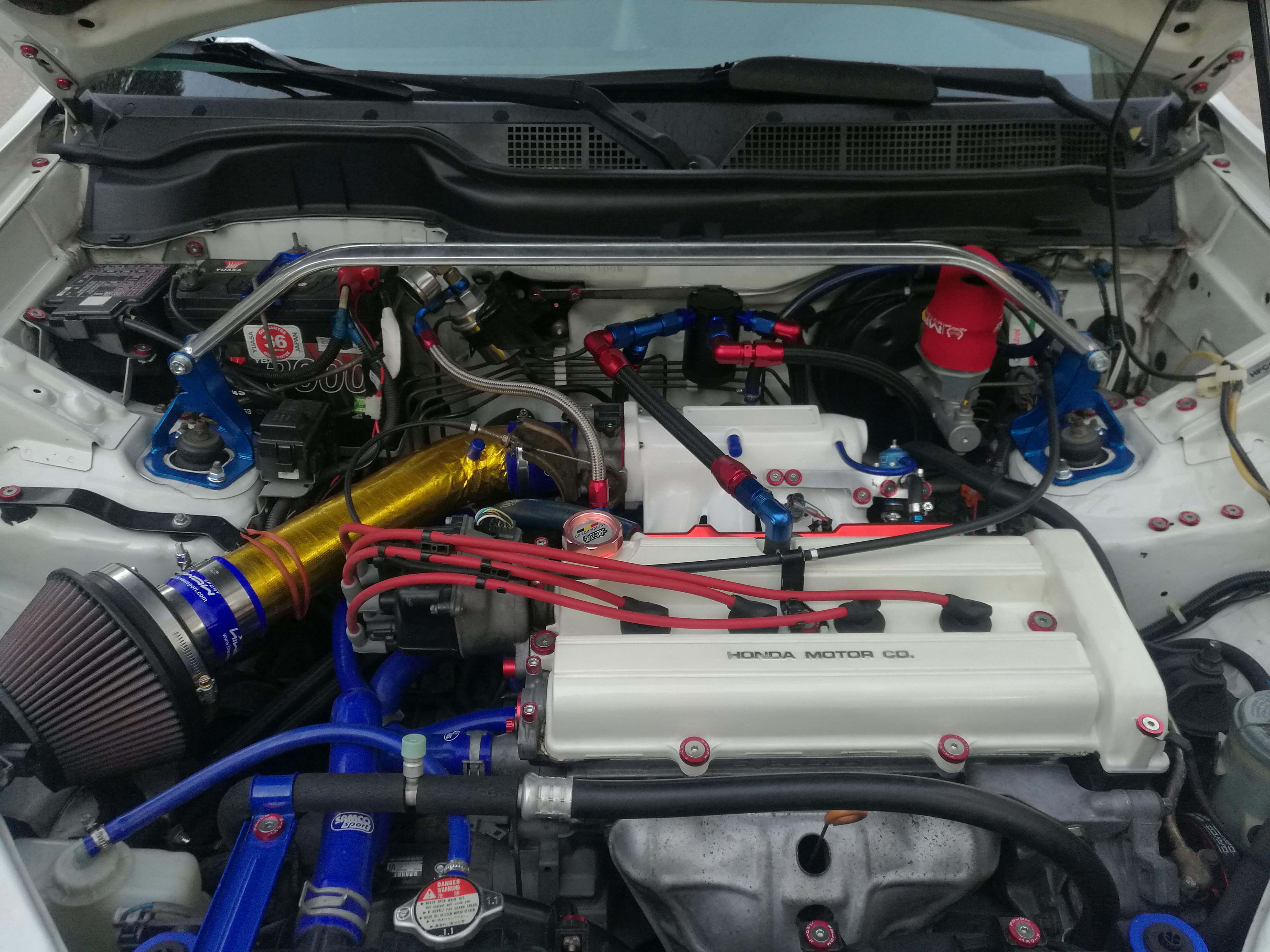

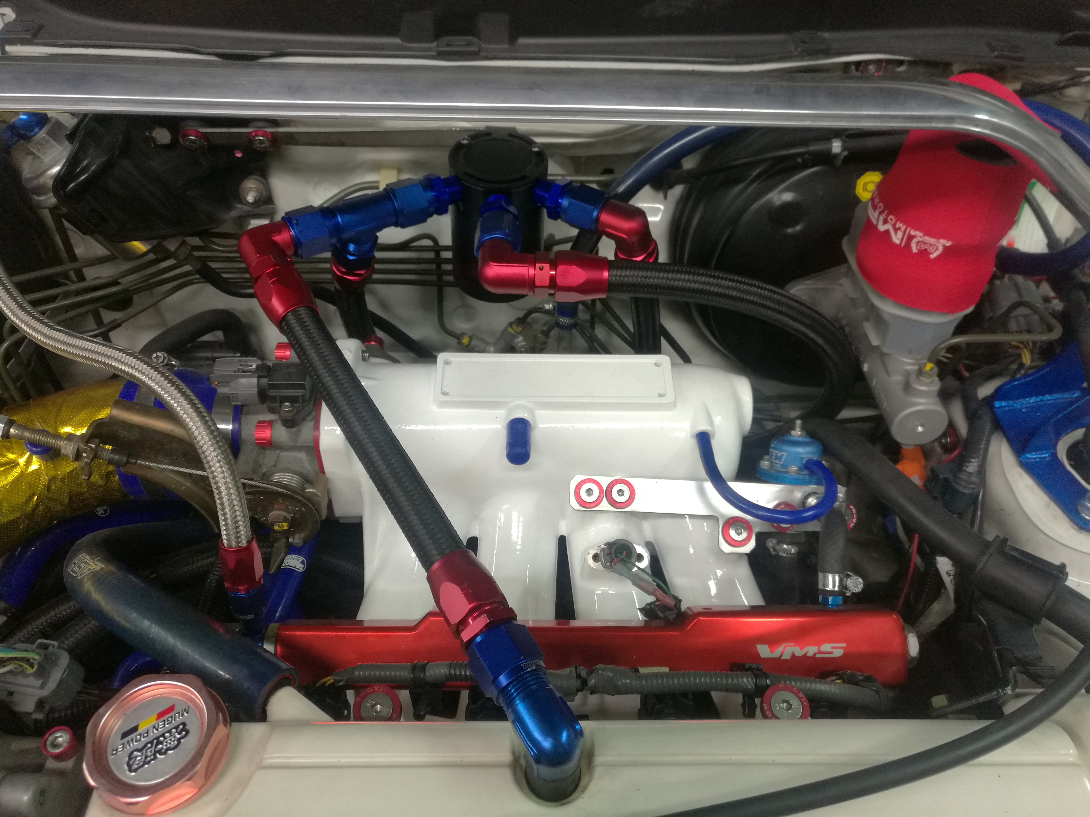

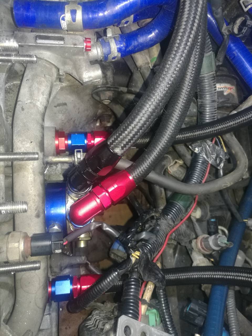

In the mean time I finished my CRV catch can setup. Two lines comming from the back od the block (M28 thread) direct up to the can, PCV is replaced by 10AN to 90degree 1/2" barb With Rubber hose stopper and directed to the catch can over T joint and air is vented underneath the can with AN10 hose exitong in between 2 inlet hoses and 19mm fluorolined silicone hose from the valve cover

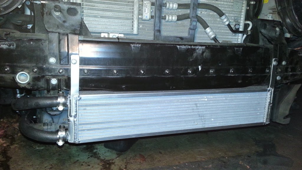

What also interest me is, heat exchange, that is going to be radiator or one pipe? something like oil radiator?
Yes. Heat exchanger in the front Like intercooler but different core for water.

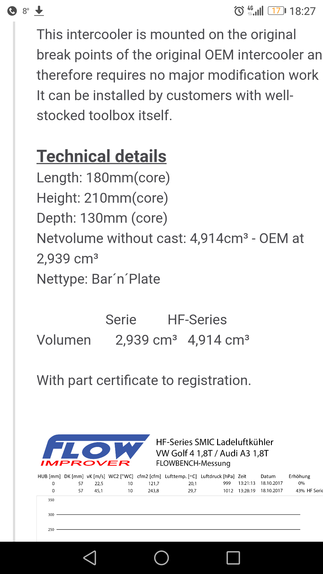

While waiting for complete wic kit which Will probbably include- RS4/S4 Heat exchanger he Will Mount New WIC Mahle next week to A3 1.8T and measure it and compare it to AMG V12 one he was using to se the logs. If performing well he Will be installing it.

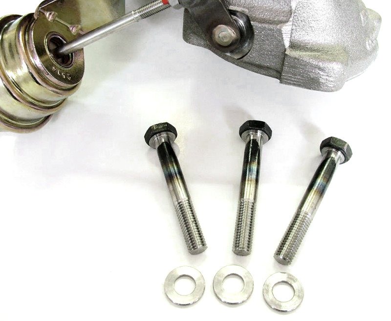

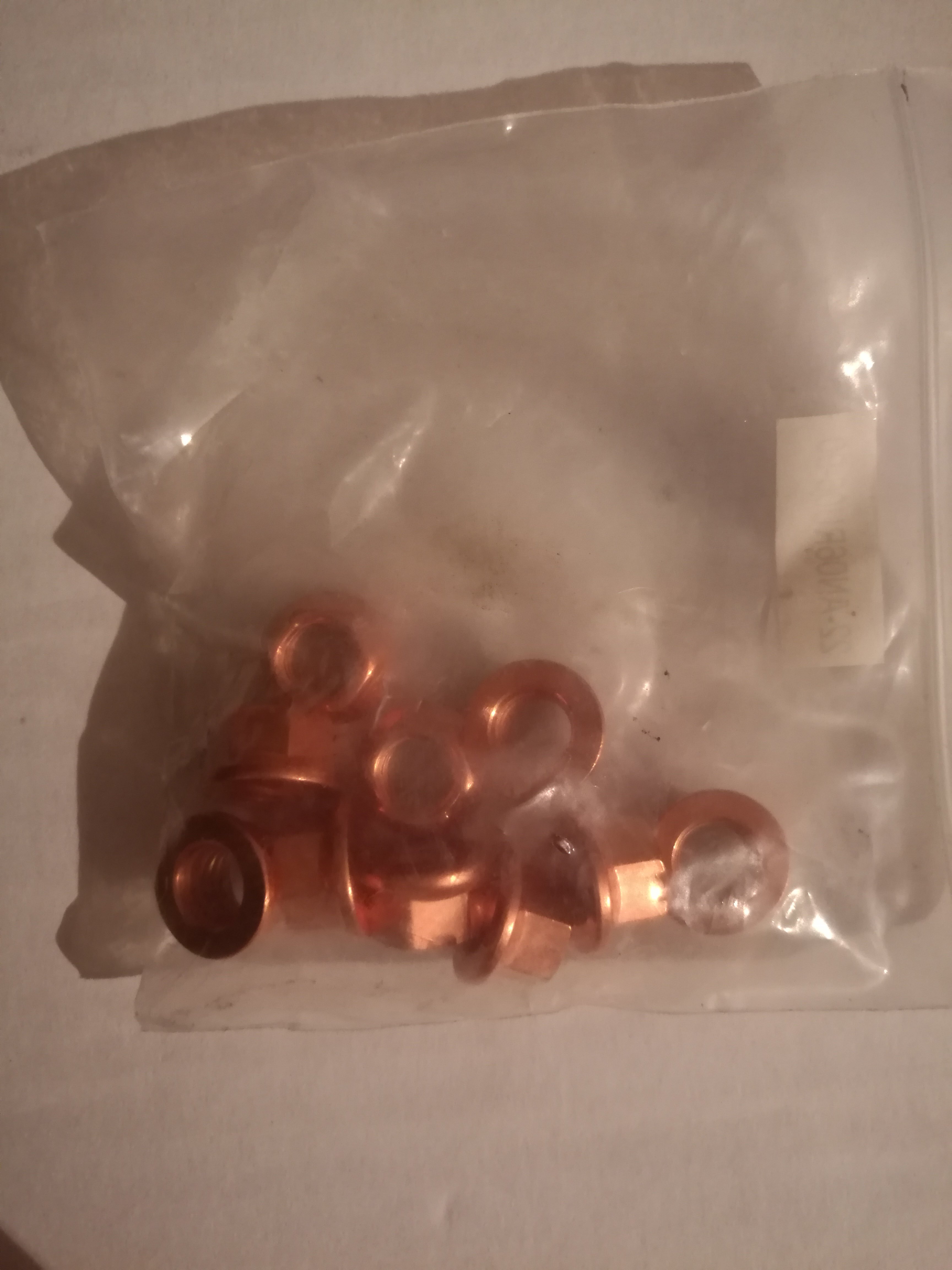

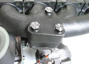

We Will have to tap tread or weld bung onto the exhaust manifold for that - meaning removal of exhaust mani and thus using New Inconel bolts for turbo, Cometic gasket and 10key M8 Cooper nuts that I already have :-)

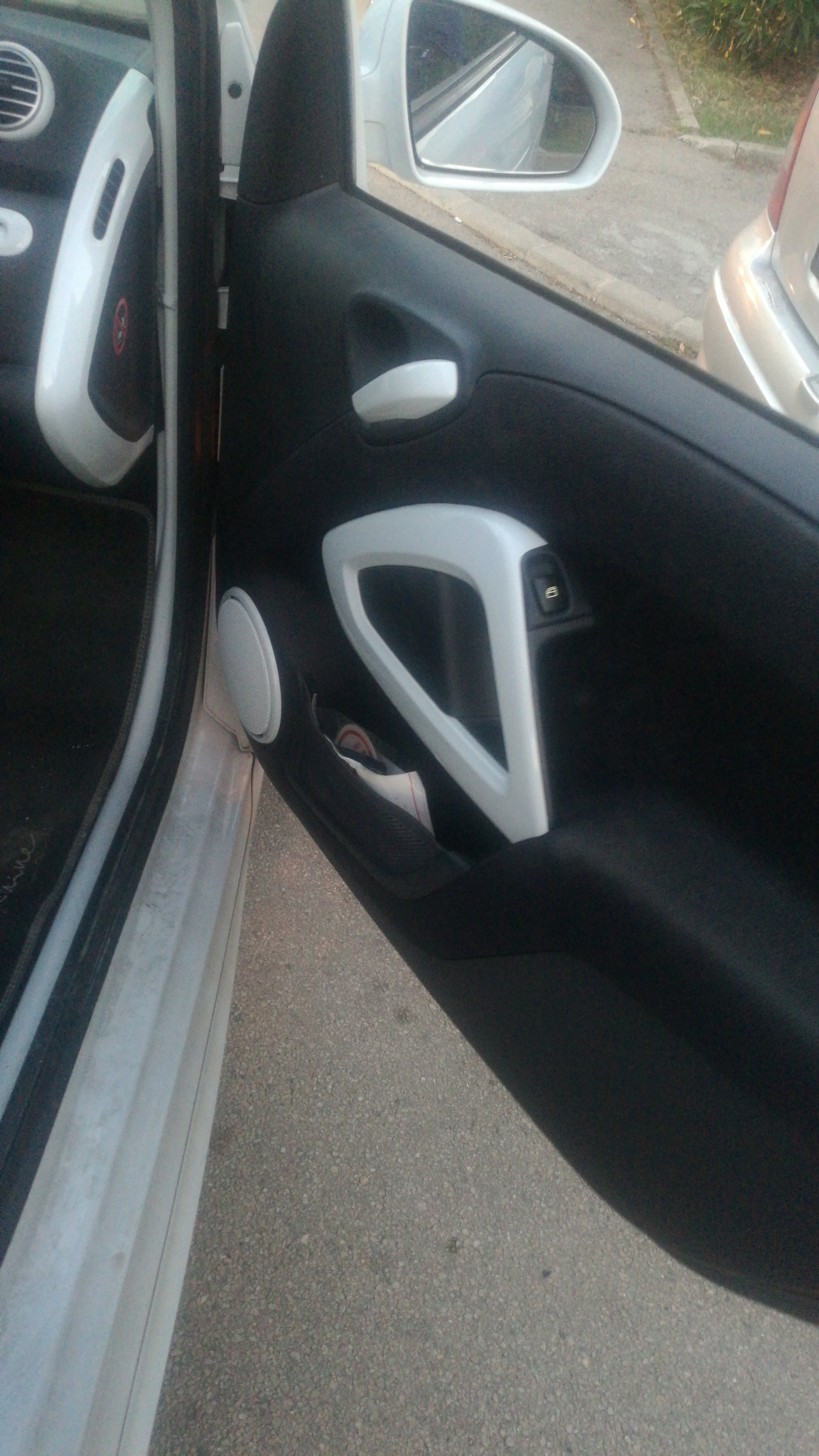

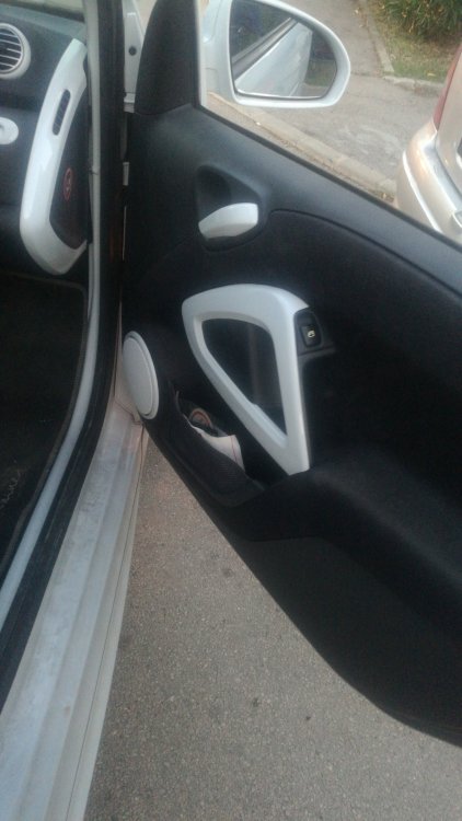

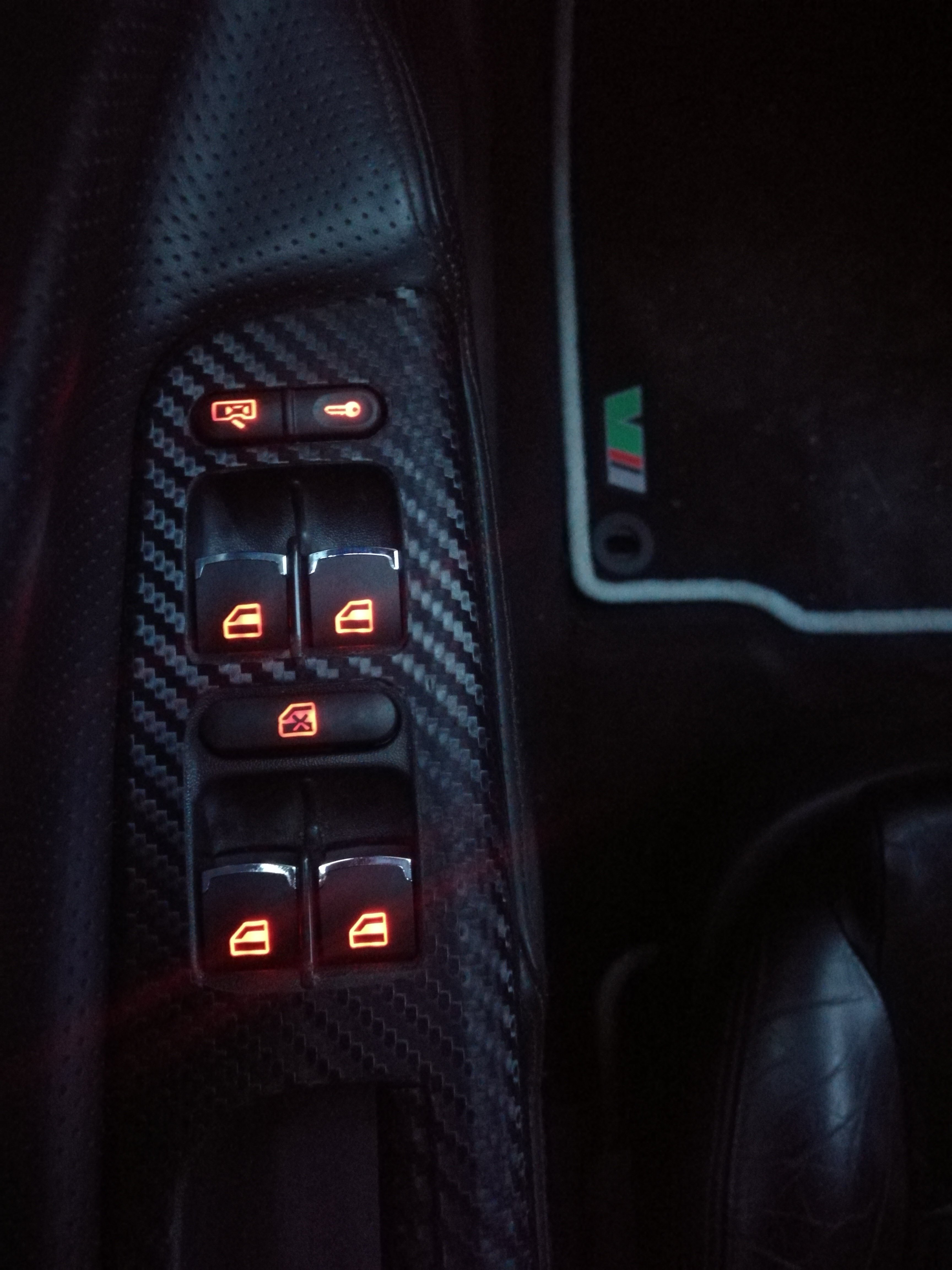

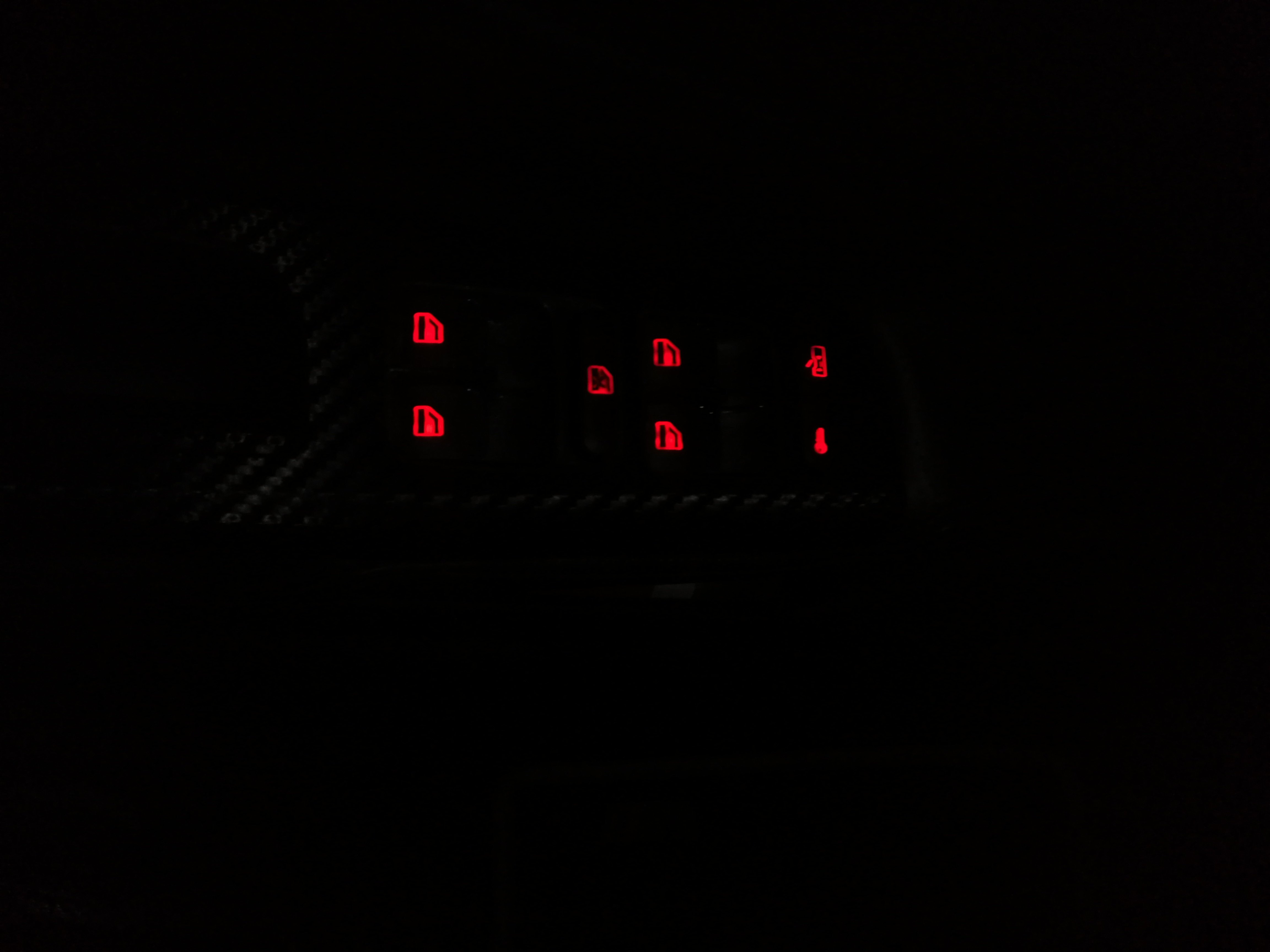

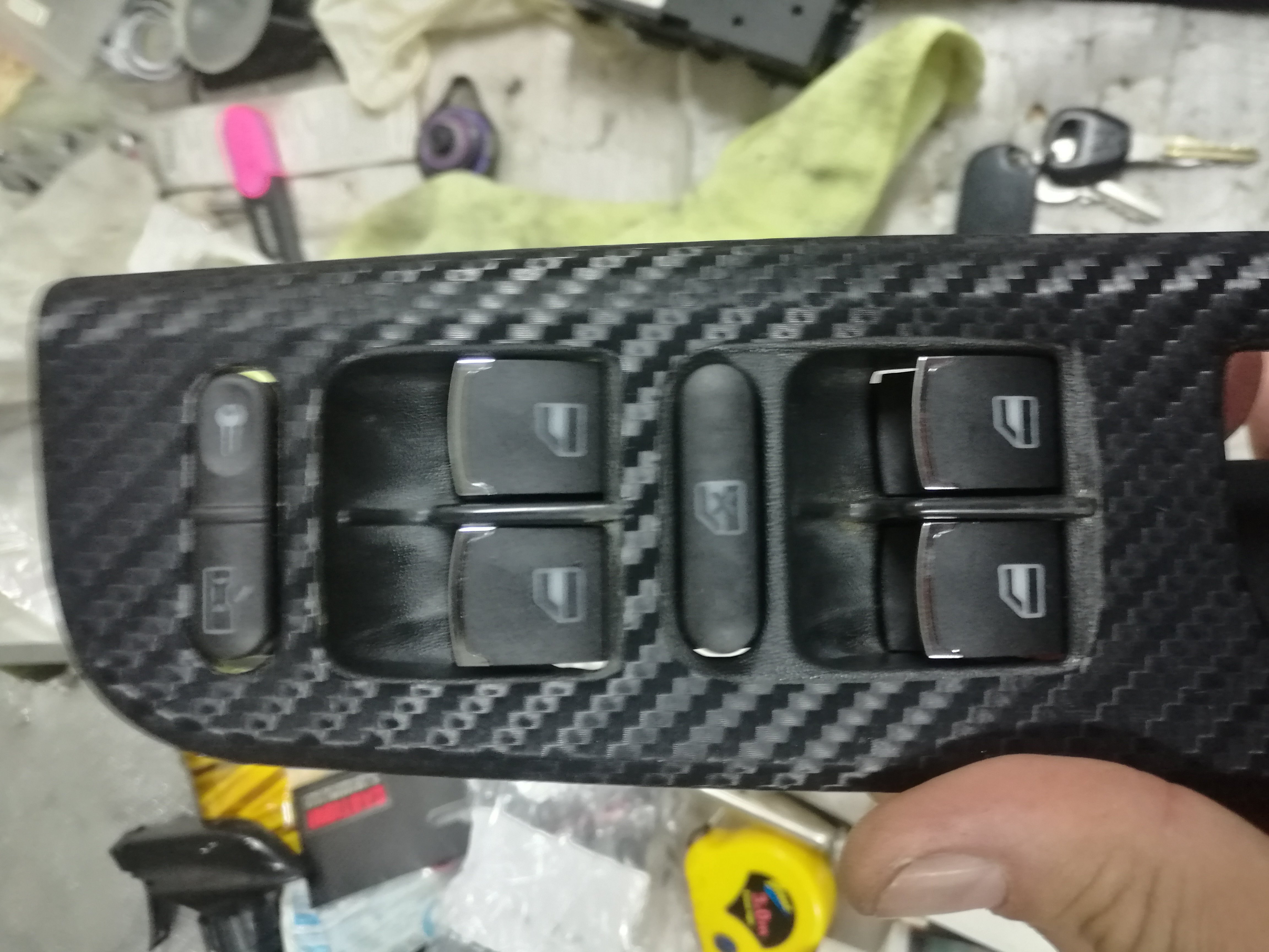

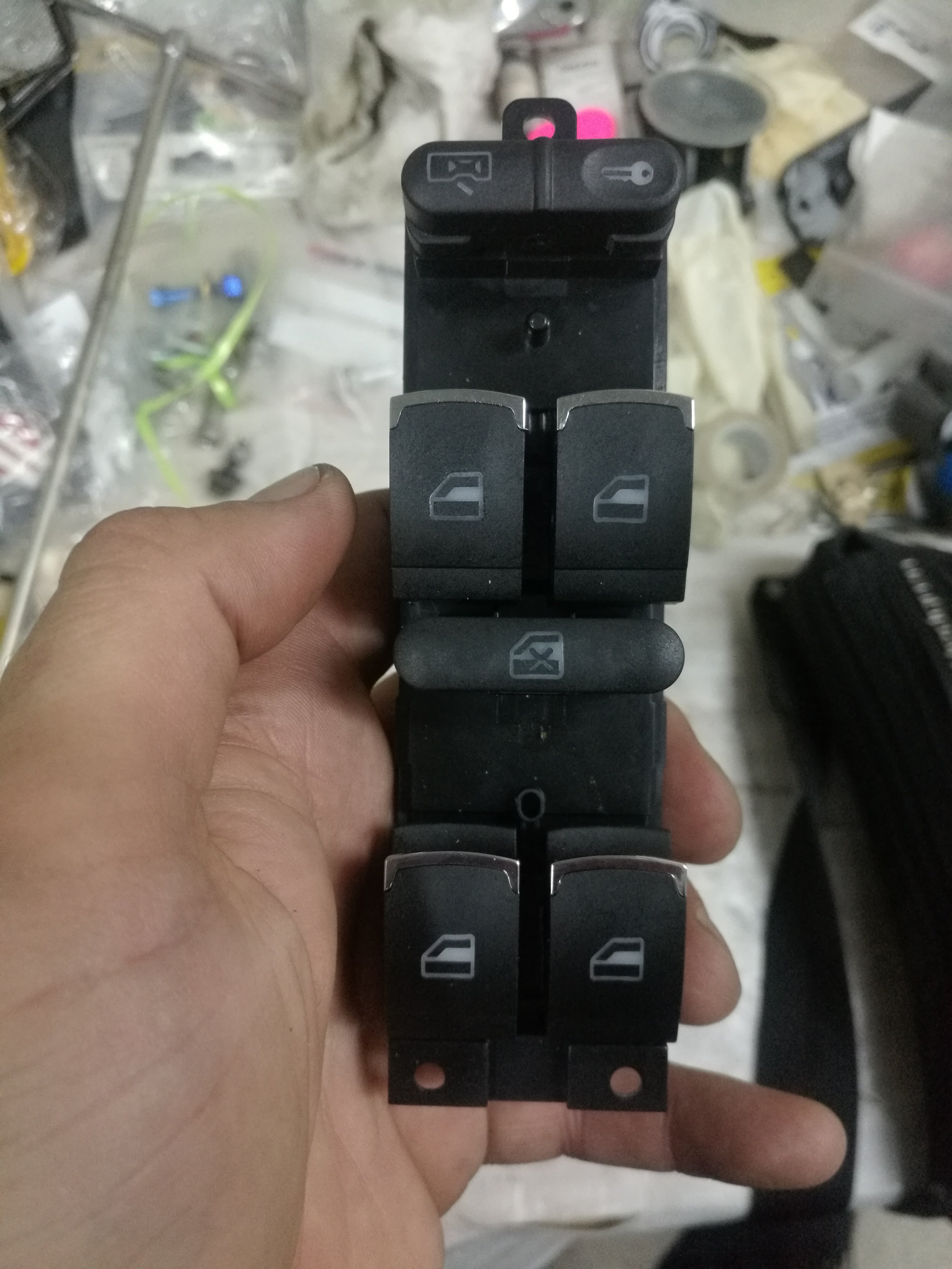

New Chrome detailed window controler

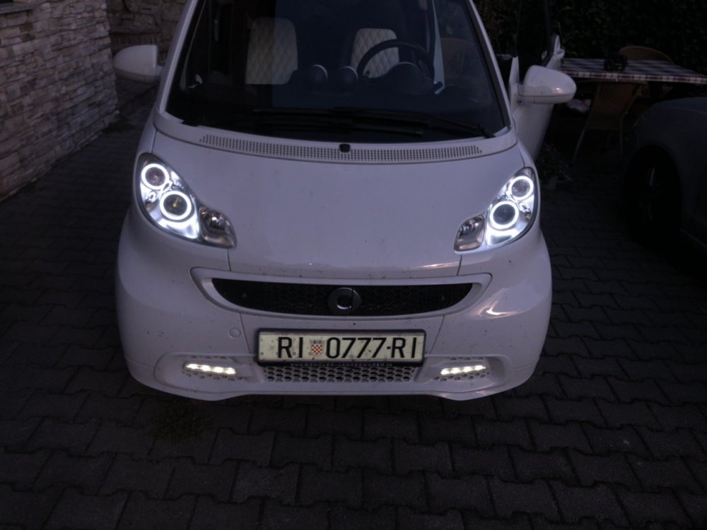

Some led impressions

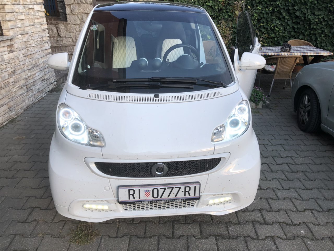

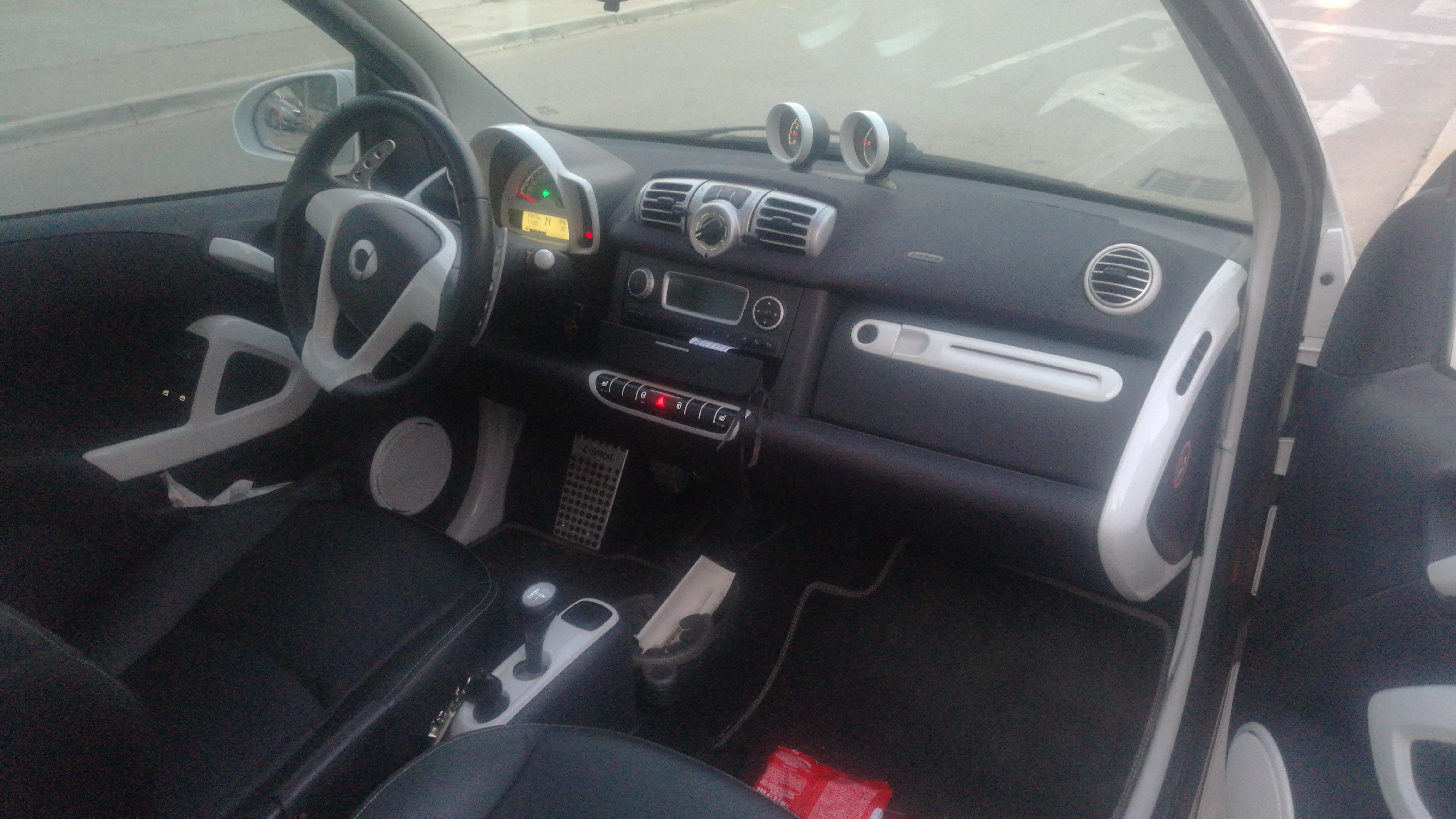

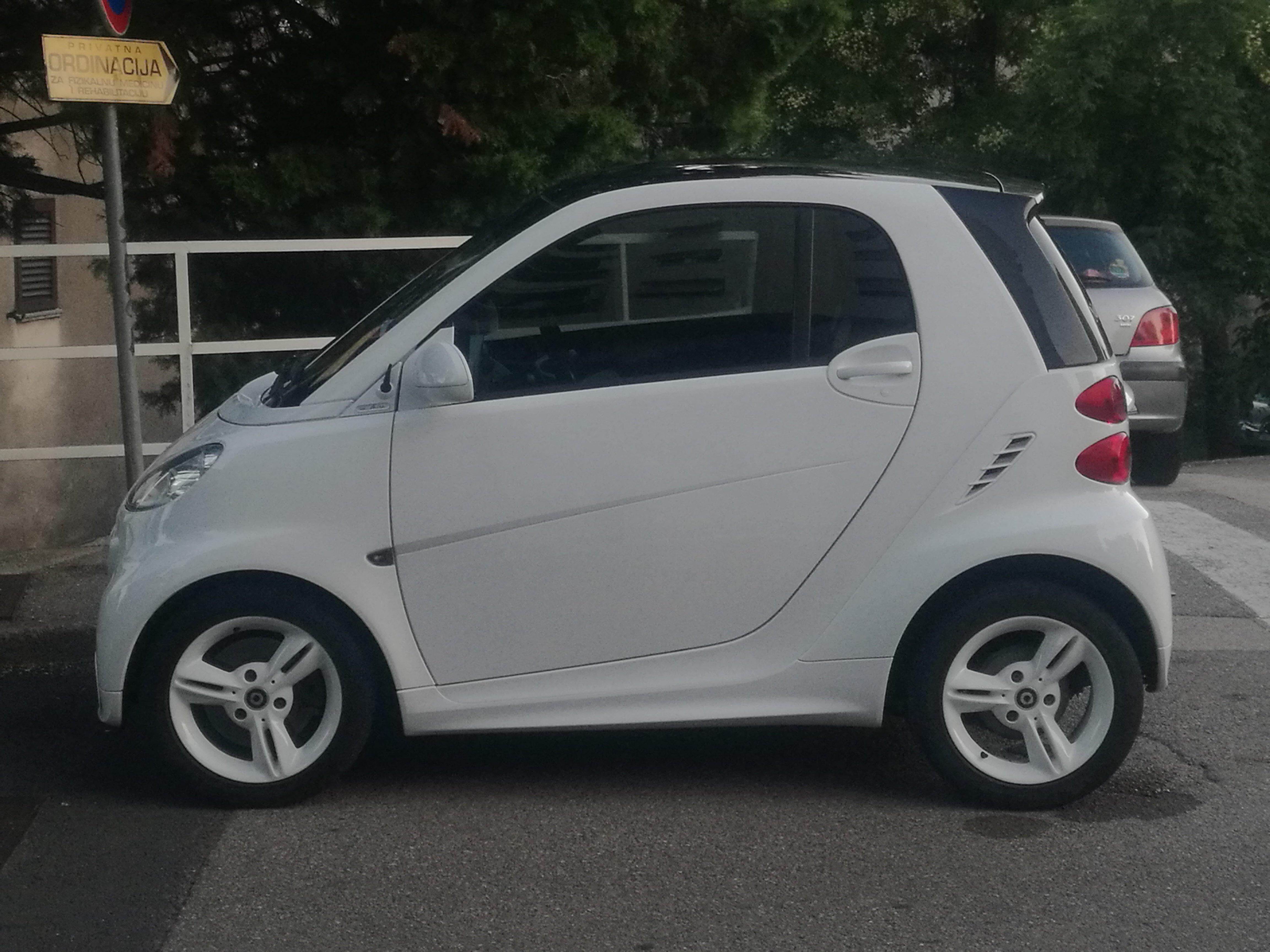

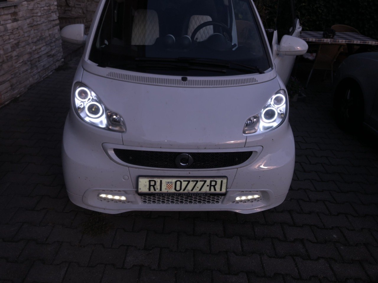

Just to share some pics of my wife Smart 451 1.0turbo Iceshine edition
Ofcourse moddiffied by me ;-)
Doing some fine tech upgrades to the headlights
Edited by davojuri

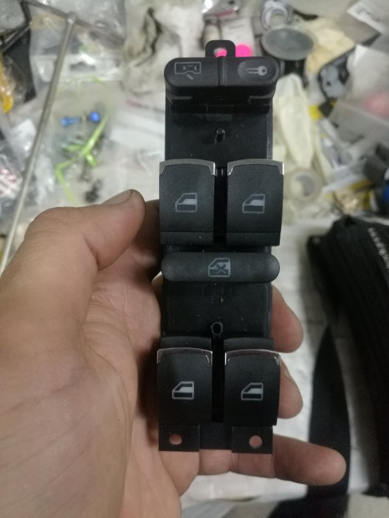

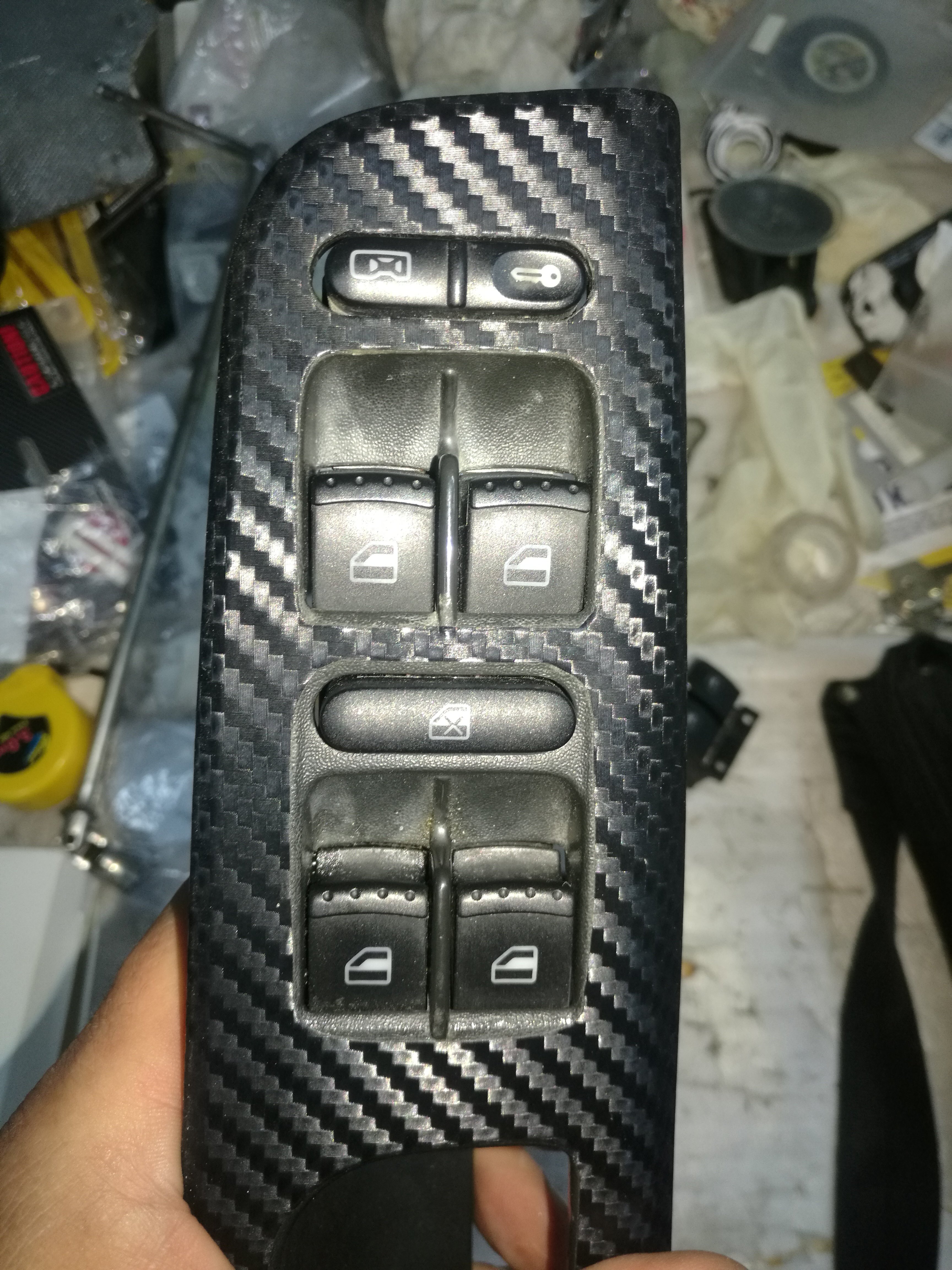

New window controler- www.aliexpres.com is more than pleasant surprise ... Not only that it looks way better than OE one due to the chrome details but the feeling and ease of window control is superior to OE ones and all that for Just 21usd

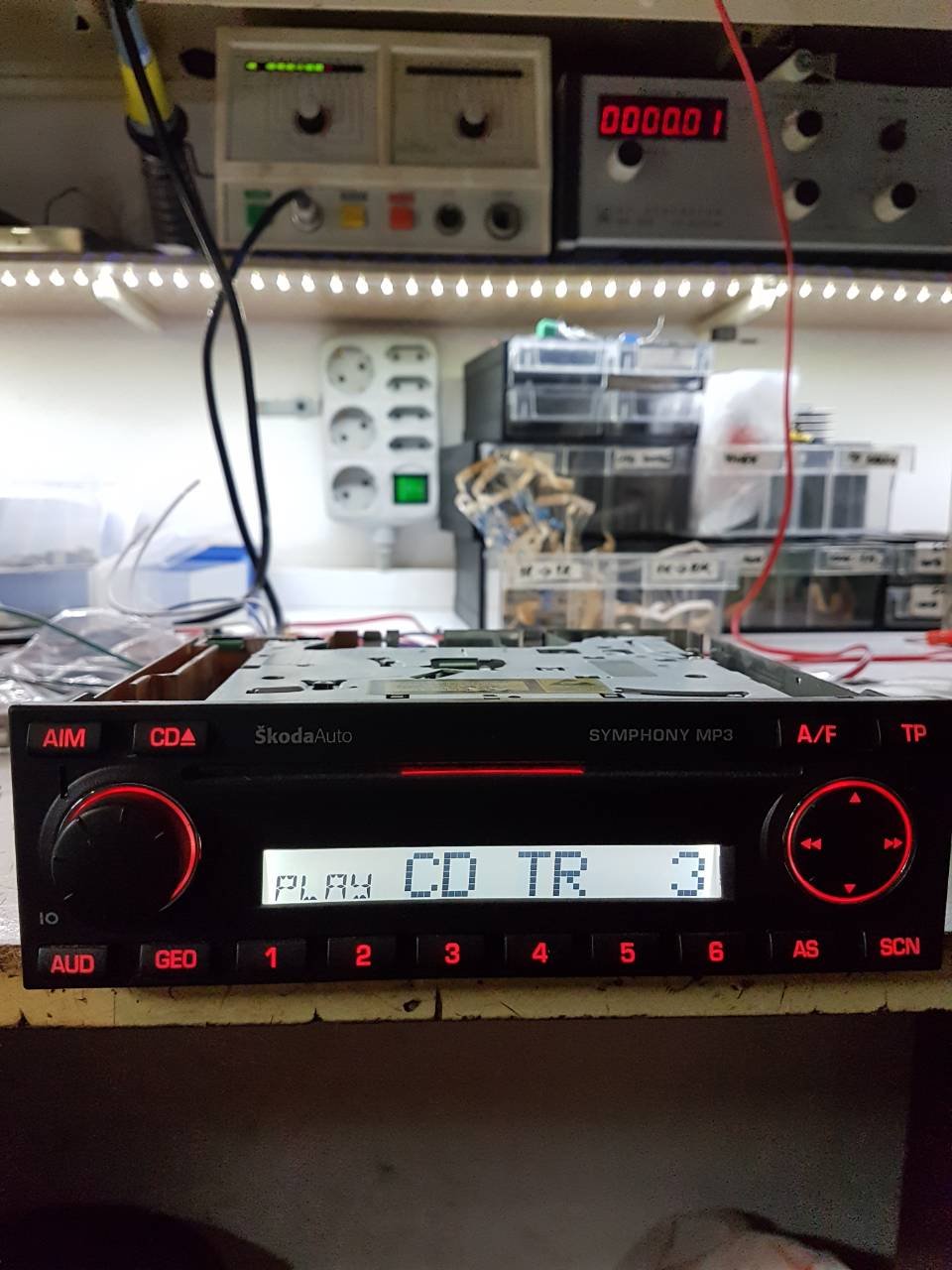

Symphony MP3 player color coded and time to replace old casette player
New Symphony MP3 player installed

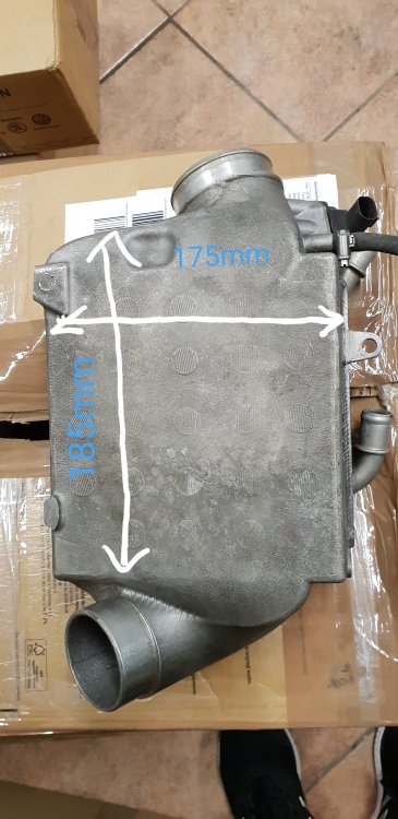

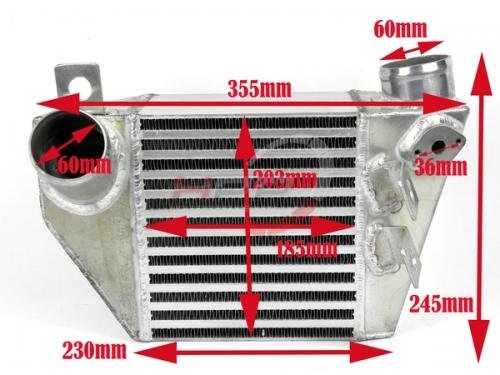

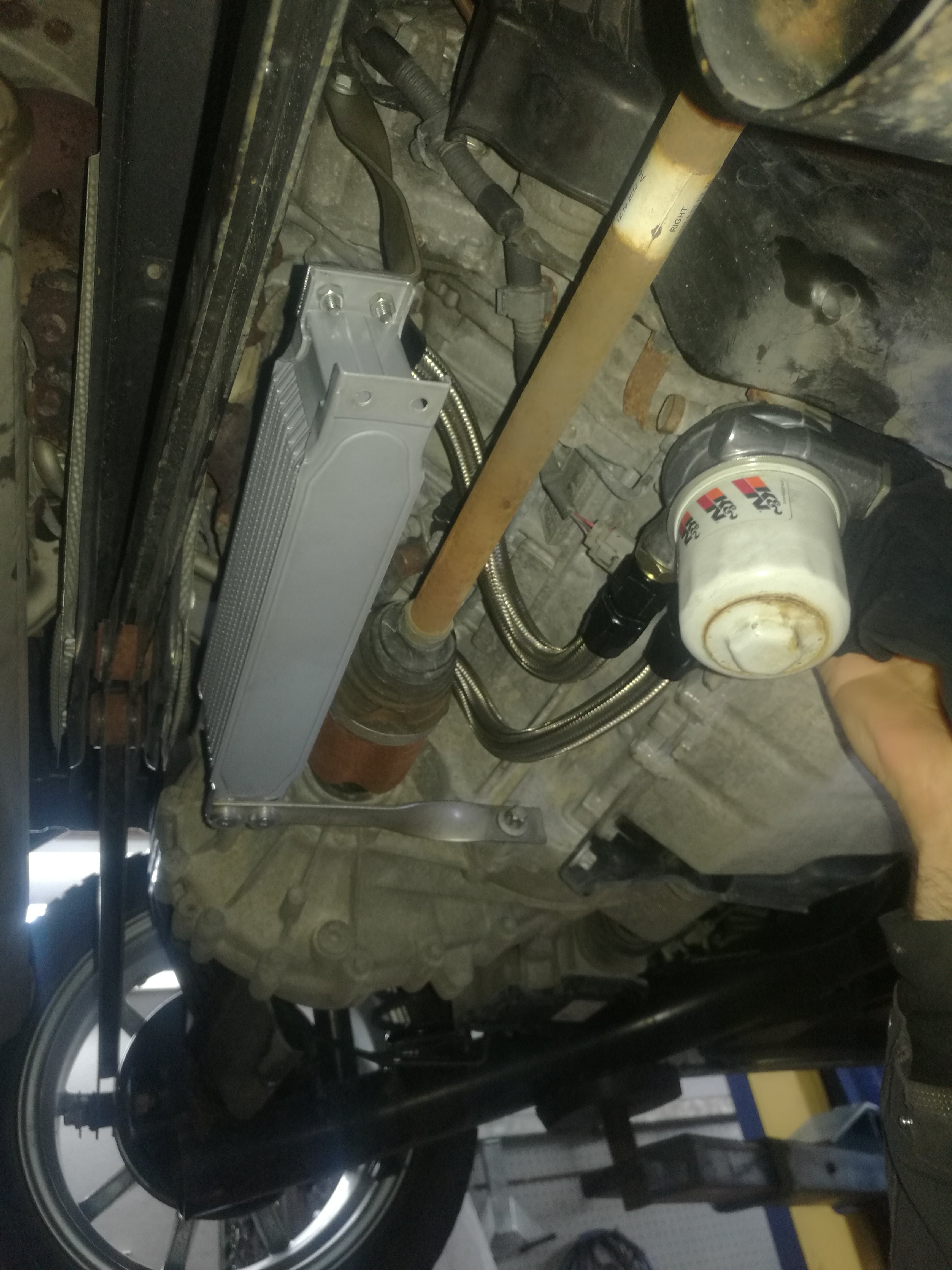

Latest update.

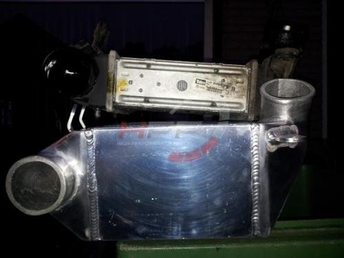

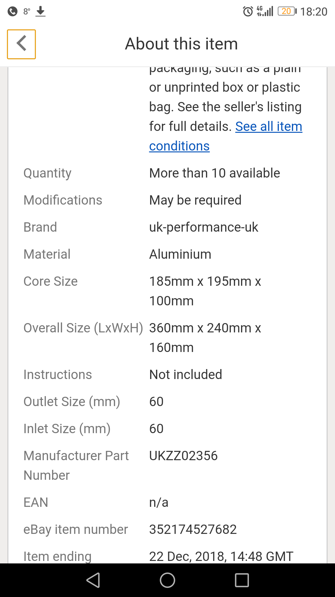

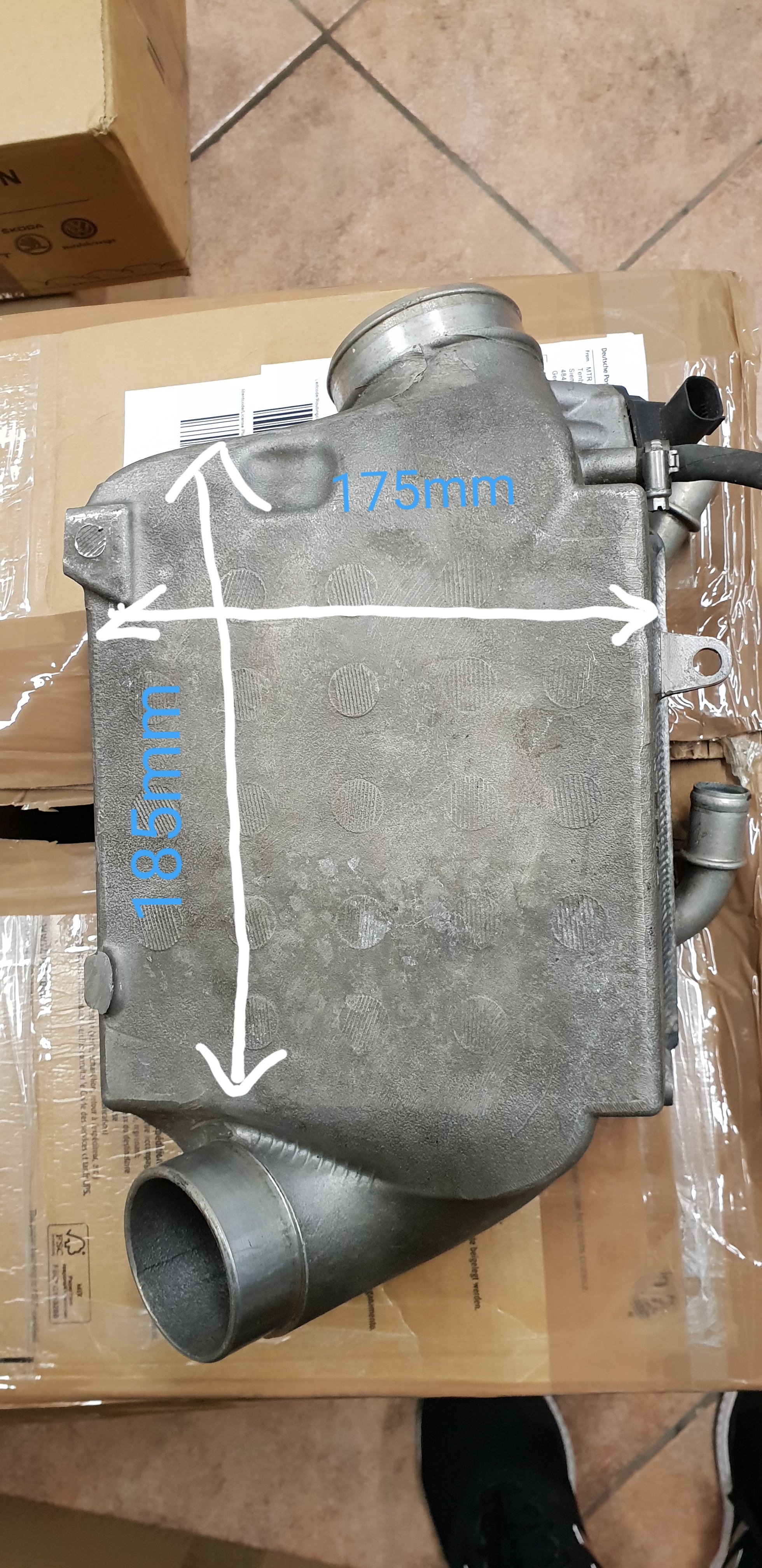

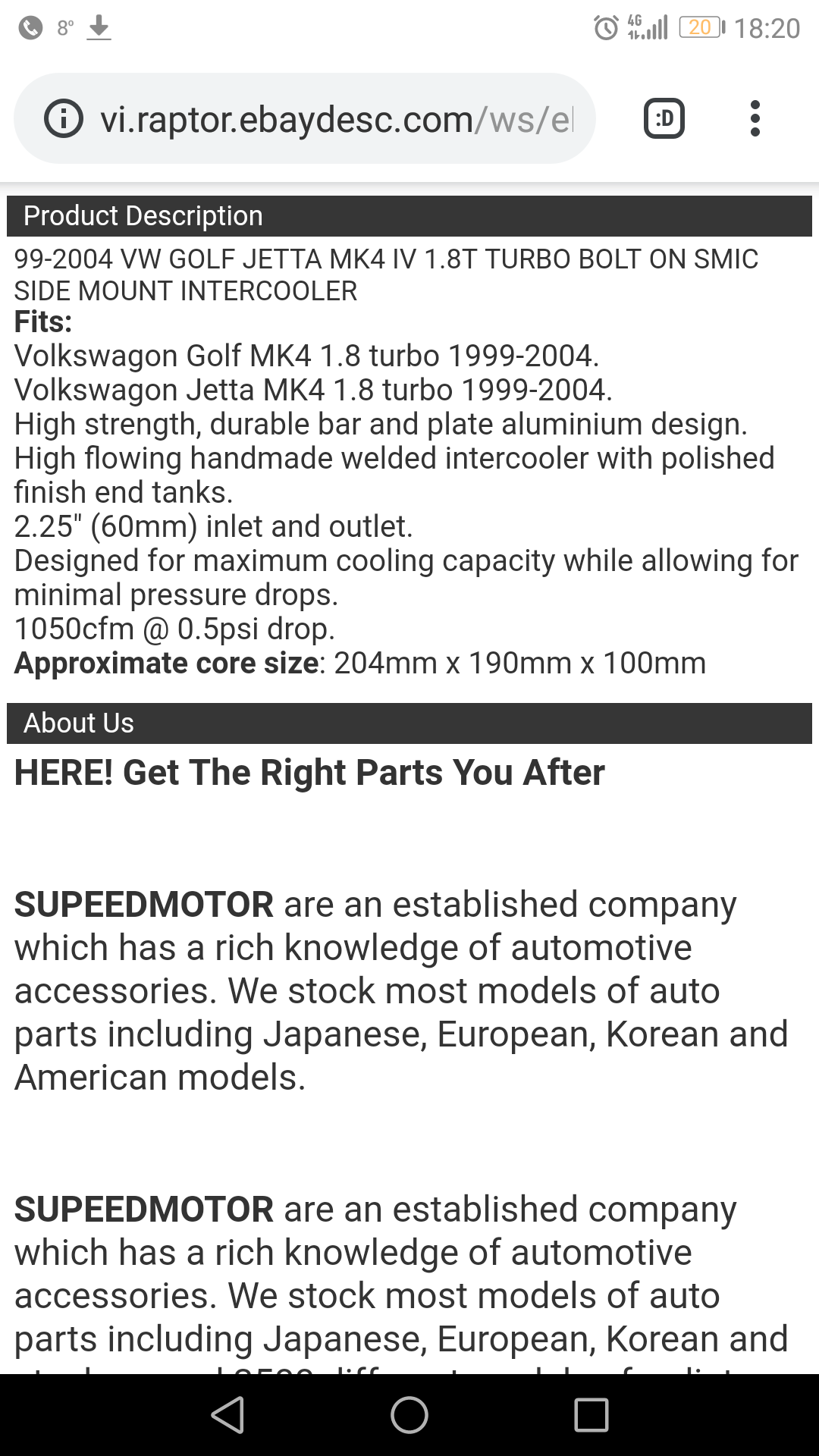

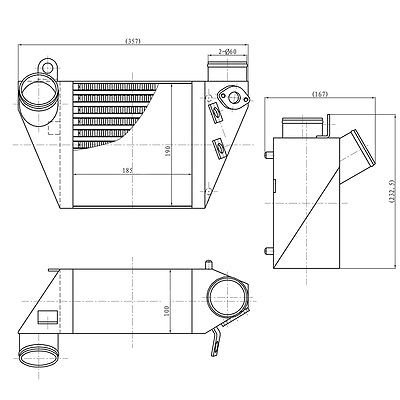

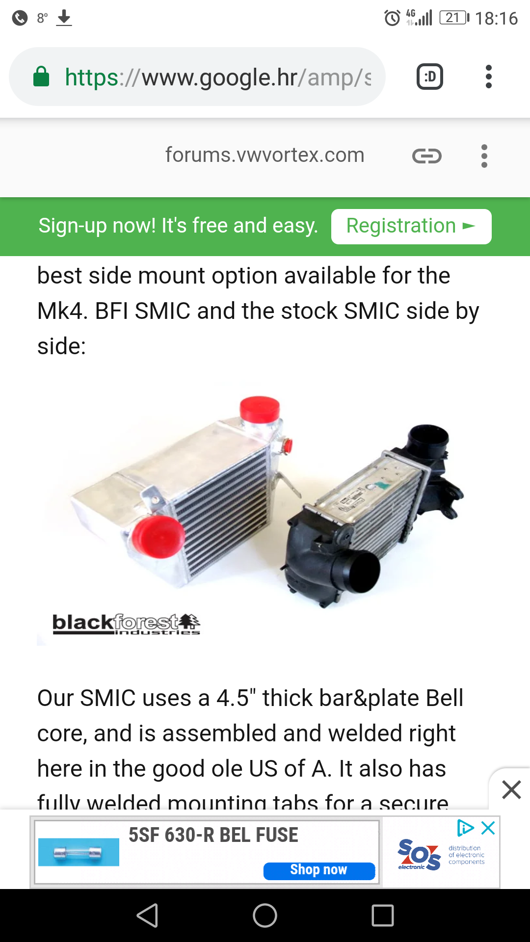

www.bellintercoolers.com first agreed to make custom WCAC or modify AMG one. Must measure AMG one to see if the core is close in dimenssions to the OEM one 1378246257_s-l400(4)_new_new_new_new_new_new_new_new_new.jpg.72237fc2f8986cce9400681d34a50d69.jpg
Edited by davojuri

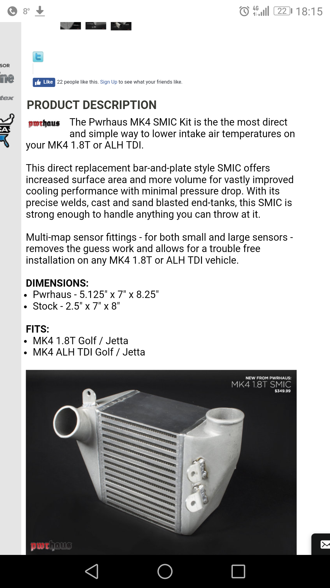

THE COOLER SET UP LOOKS INTERESTING :)

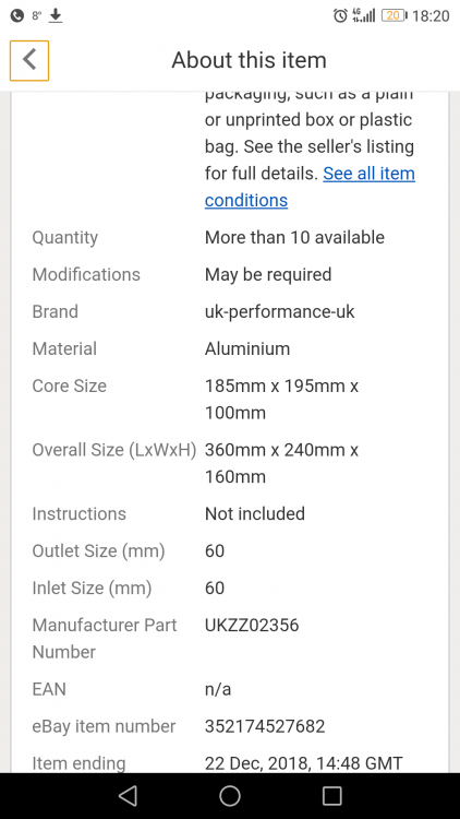

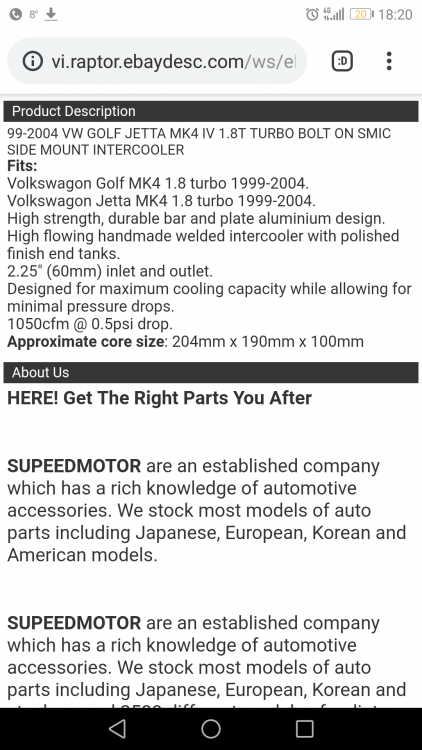

I Will send my OEM one and buy also aftermarket one as on picture (90usd from aliexpres, warehause in USA-free shipping) to have them as a role model for modification of AMG or if it has to big core to make whole custom one
Edited by davojuri
They Will also make custom expansion tank
Good news.

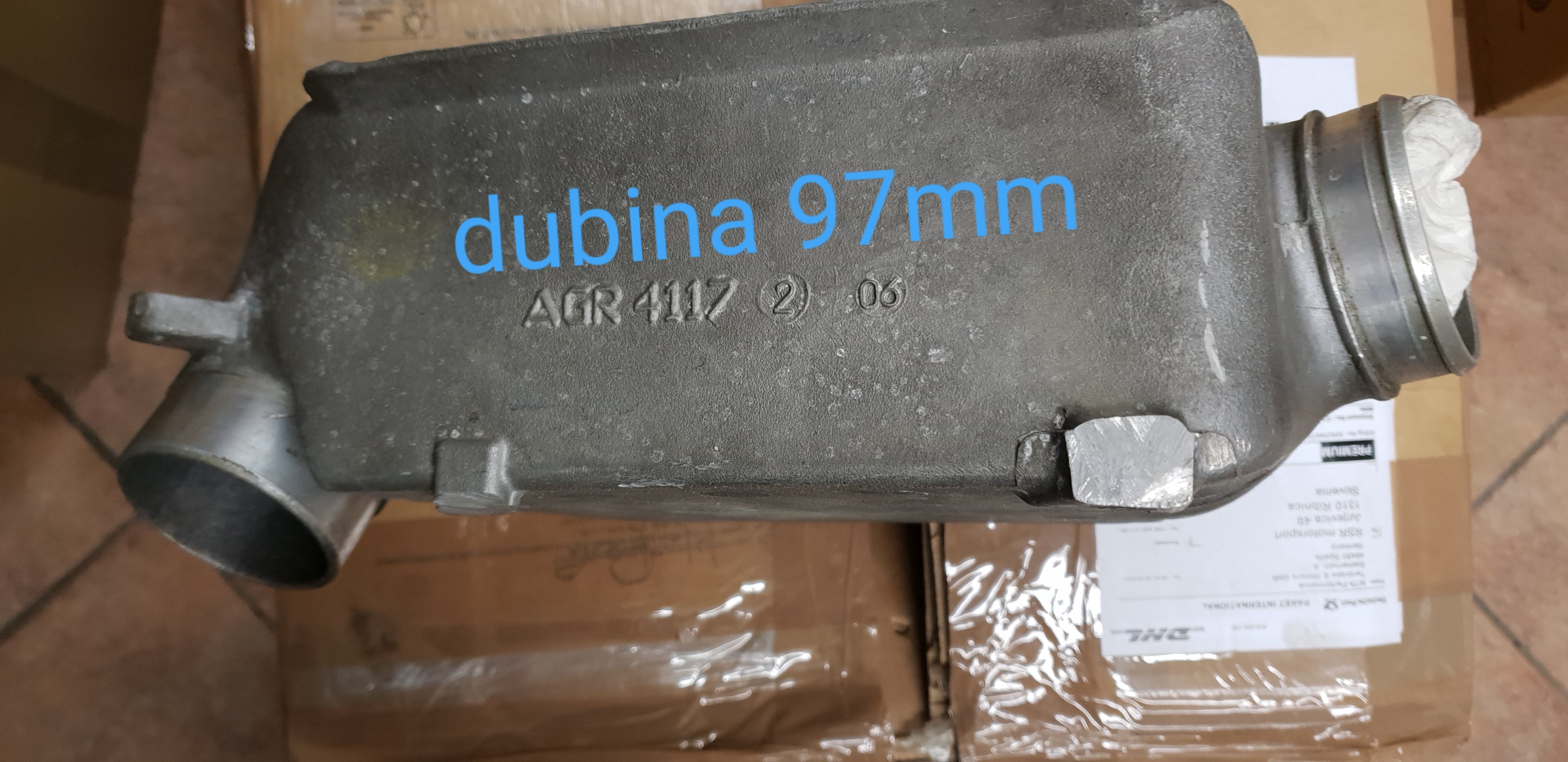

AMG core is similar to size of all aftermarket SMIC. So I Will buy used AMG one and send it to https://bellintercoolers.com together With my OEM SMIC as a role model for Connections and fixation points. That Will ensure OEM Mercedes quality core.
