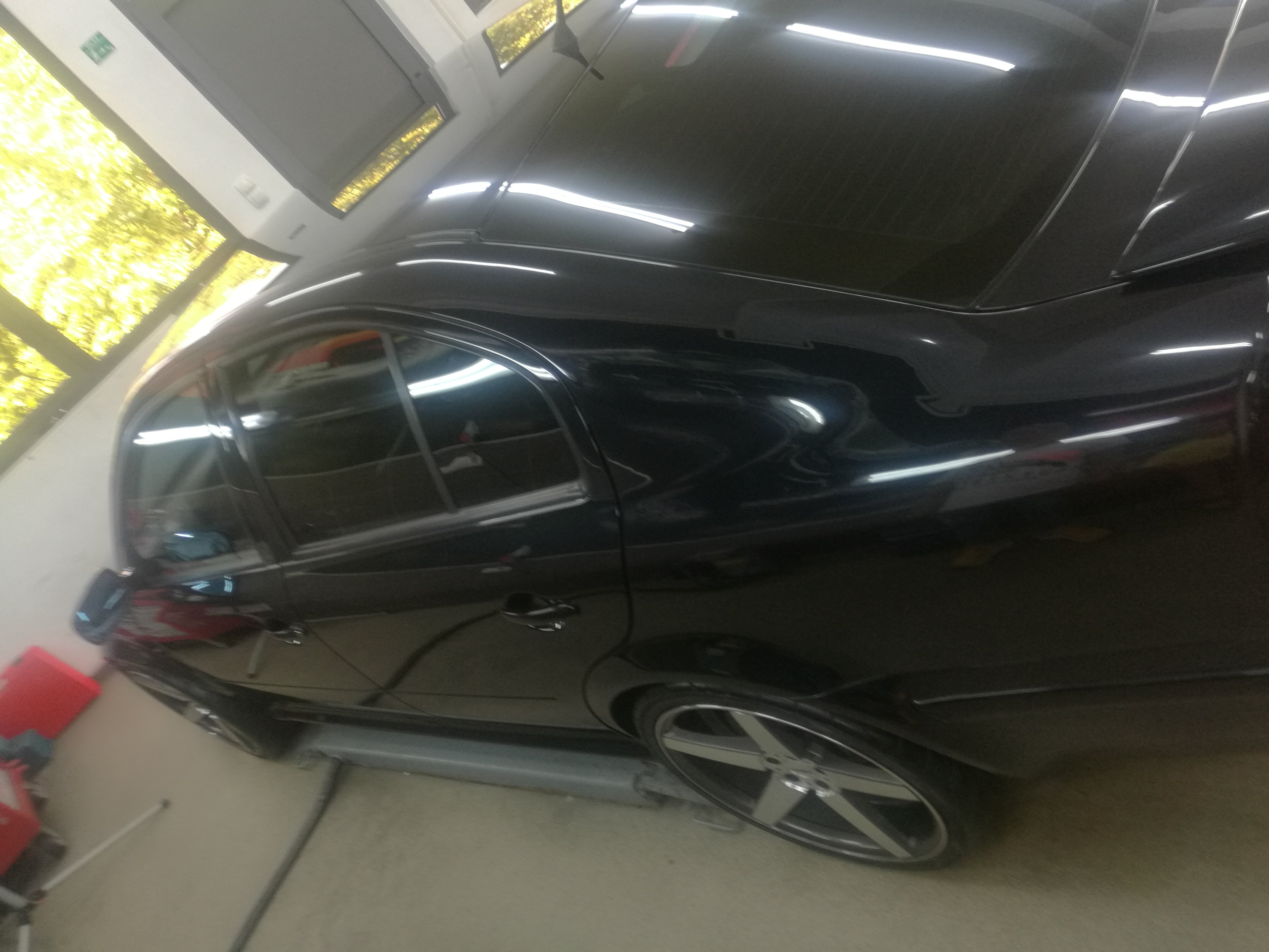

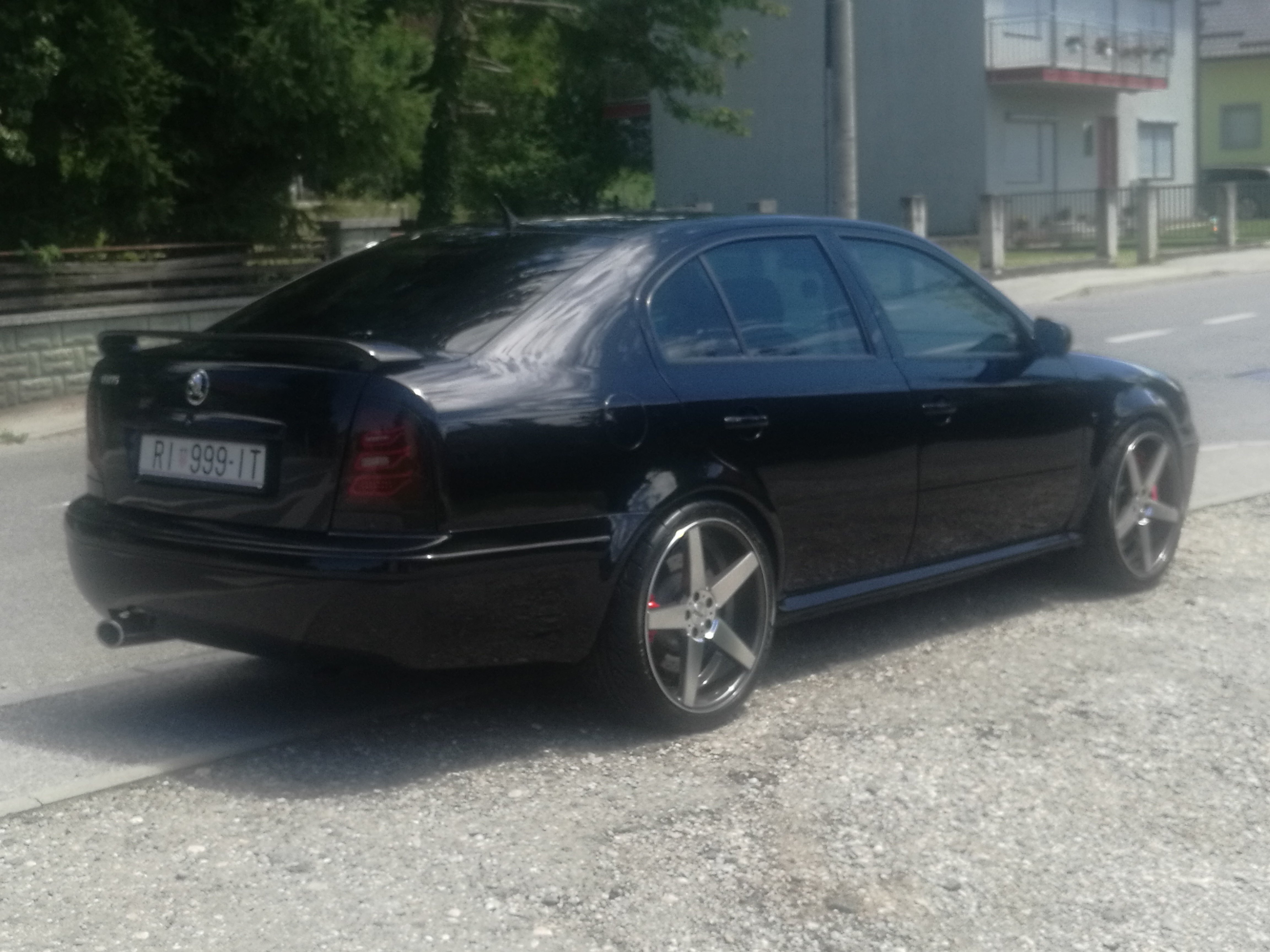

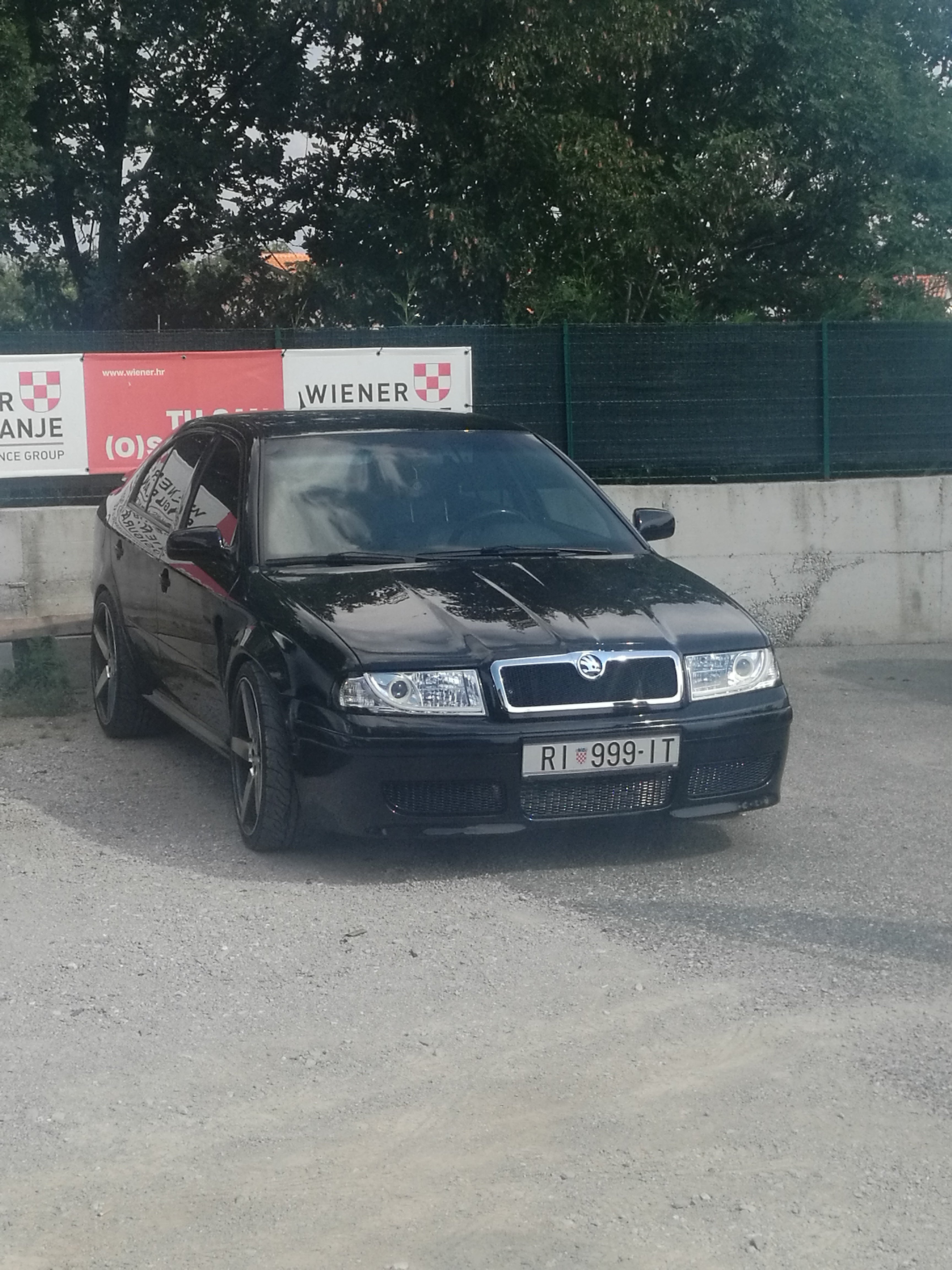

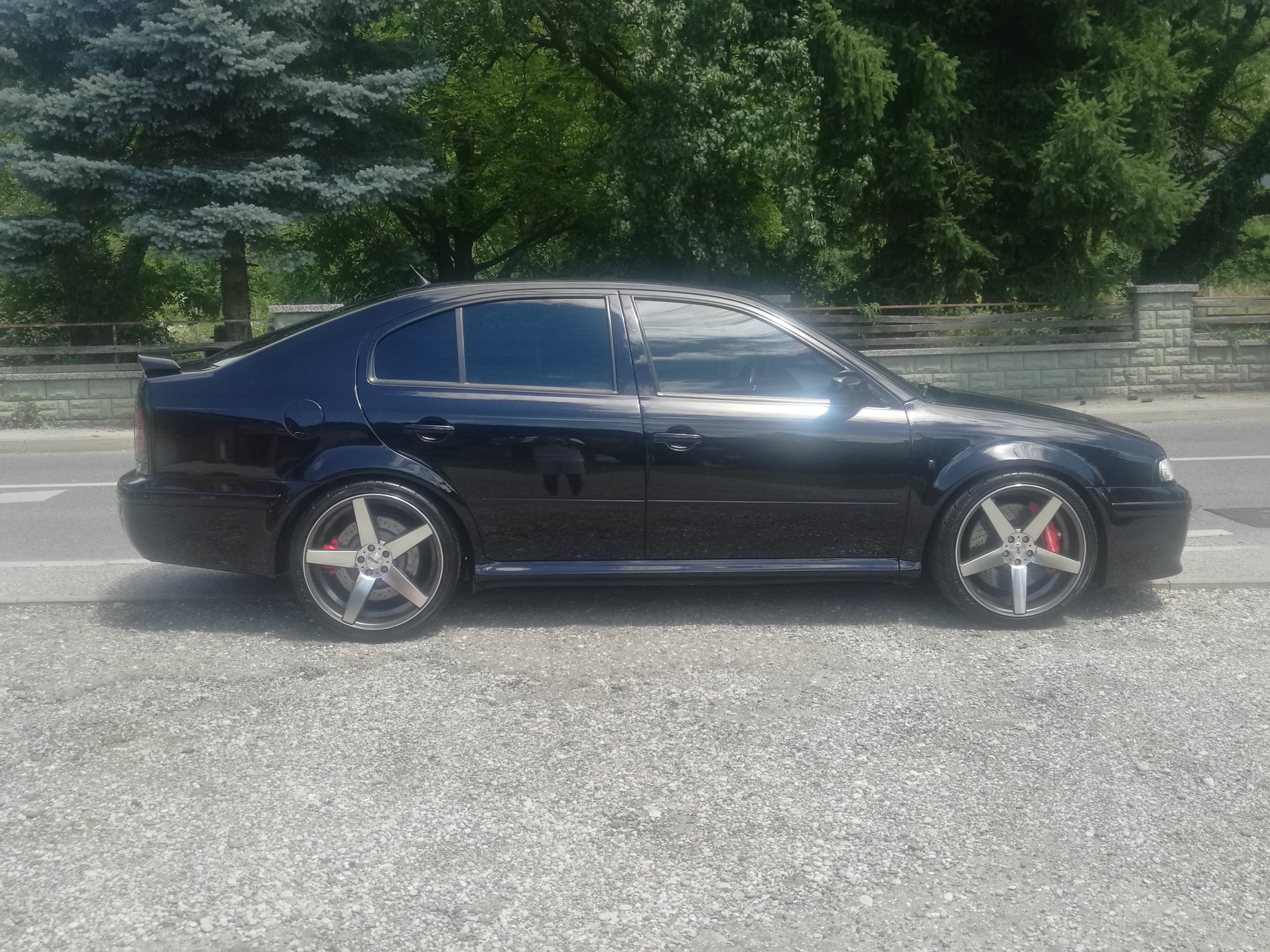

Damn dude, you have a really nice car! Wish mine was in Black and in that good condition....
Also lights look great! I've never seen 3rd party lights for front and back, that's a really rare find :)
Thanks Buddy.....that's because I mase them ;-)

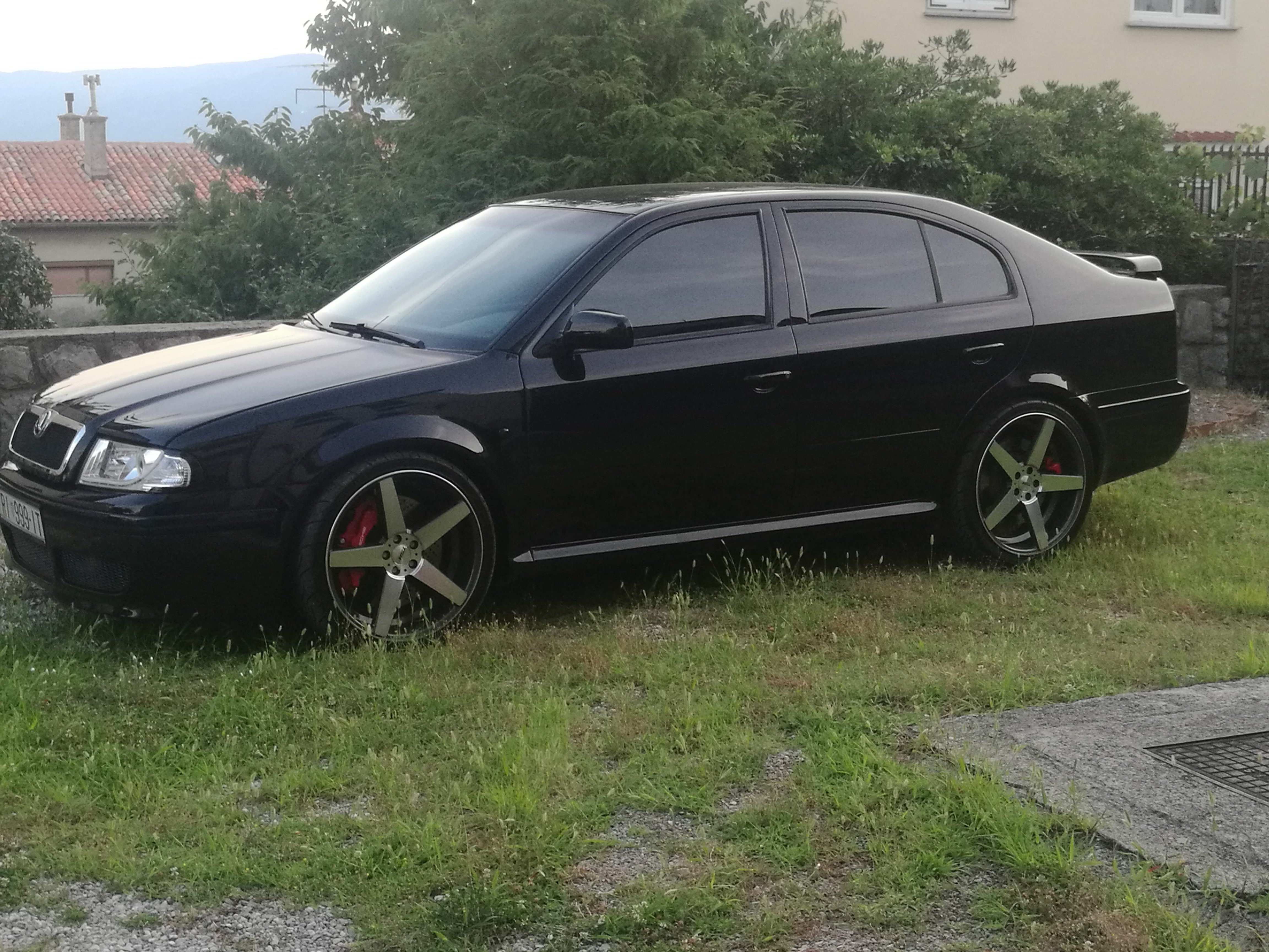

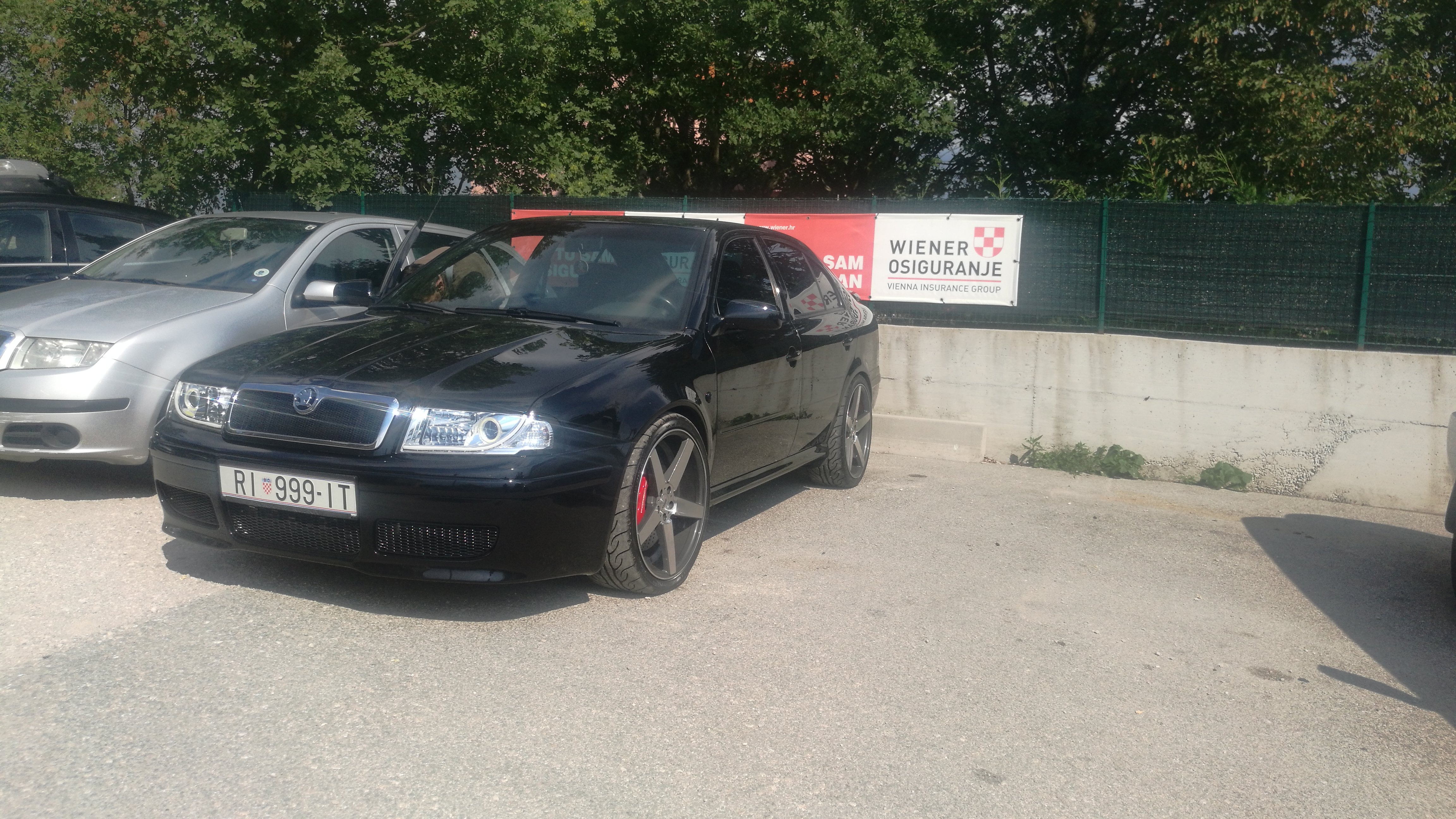

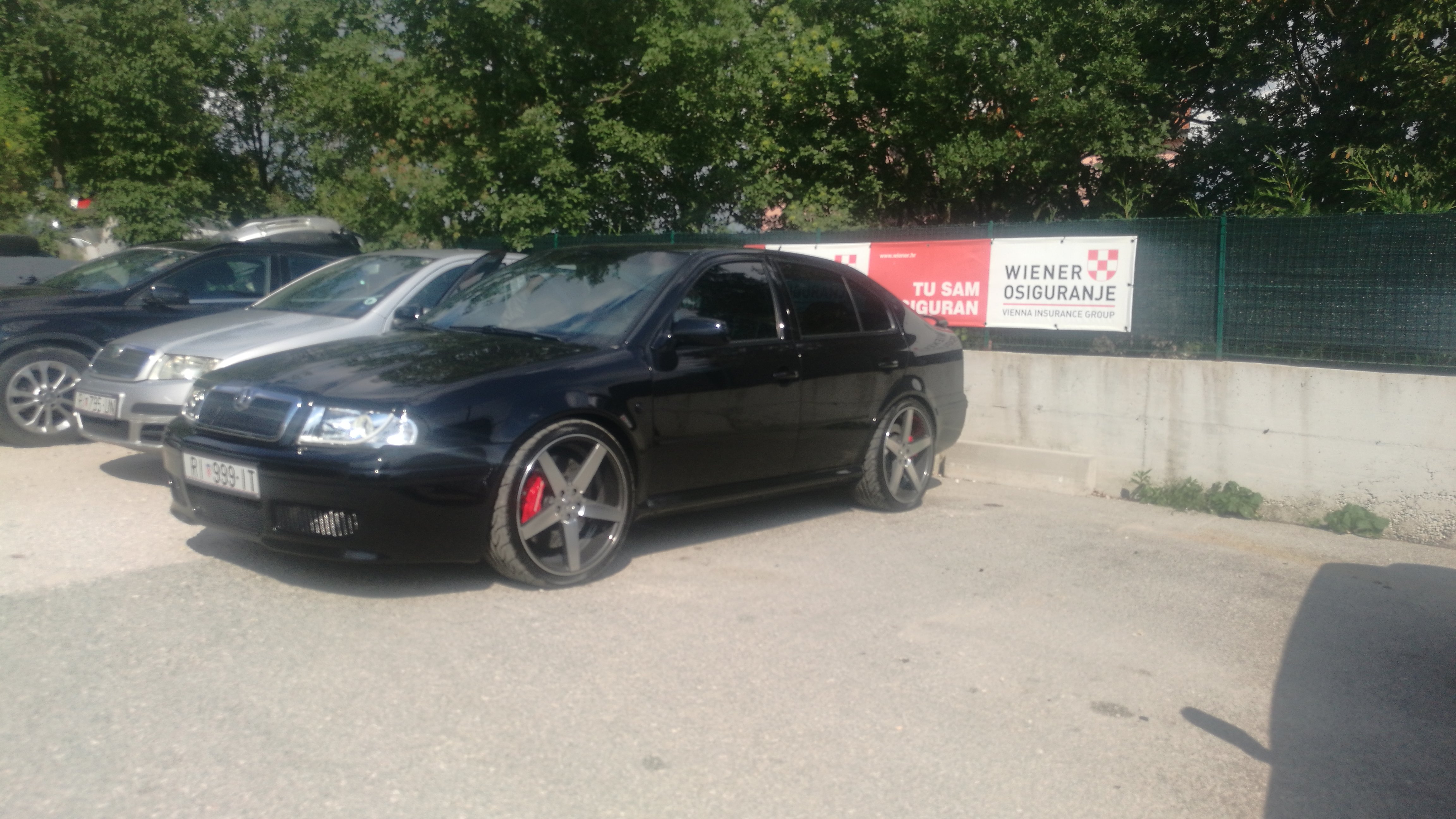

love brake setup, with this rims, they really look stunning!
Waiting for turbo, it will be really nice with 300hp
Front brakes are Porsche GT3 350mm 6pot progressing, rest ones ste Audi quattro 330mm Center discs and OE brale calipers. Front to rest disciplinske size Ratko was 312/256mm so 5cm,but due to the increased clamping force im front I decide ti increase rear disc size to evenly distribute braking Power. I would really Like to put proportioning brale valve but don't know how to do it. If there is any build thread I Will appreciate it.
On 18/07/2018 at 09:14, davojuri said:
Front brakes are Porsche GT3 350mm 6pot progressing, rear ones ste Audi quattro 330mm vented discs and OE brake calipers. Front to rear disc size Ratkžio was 312/256mm so 5cm,but due to the increased clamping force im n front I decided to ncrease rear disc size to evenly distribute braking Power. I would really Like to put proportioning brake valve but don't know how to do it. If there is any build thread I Will appreciate it.

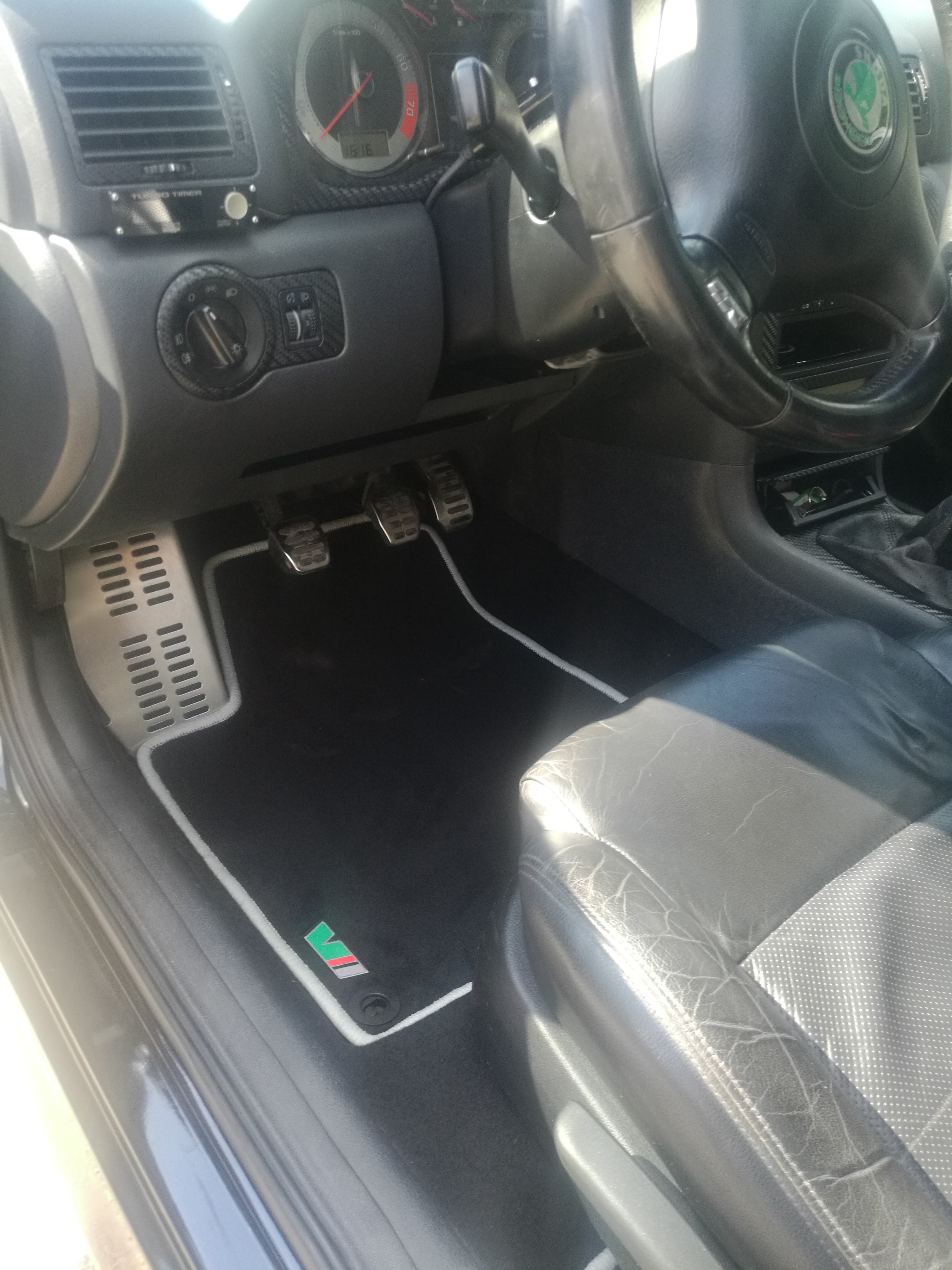

Black carpet gorom Bora and foot rest from Neetle-needed some welding and drilling but top end result

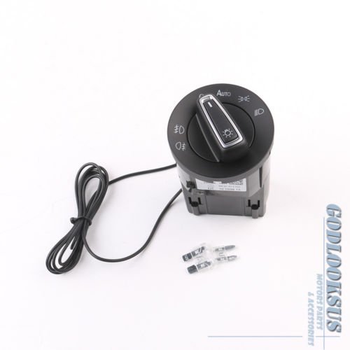

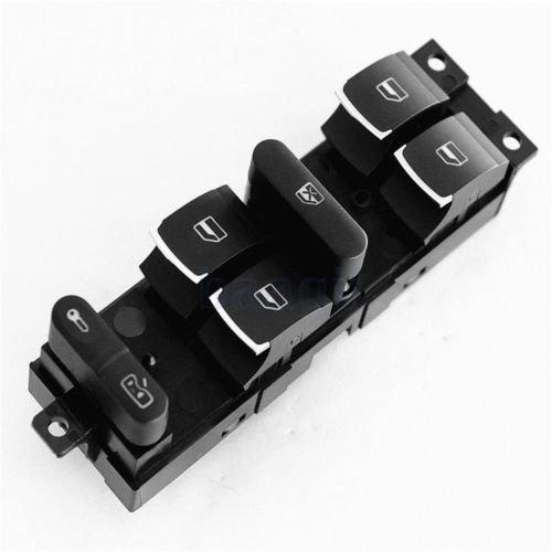

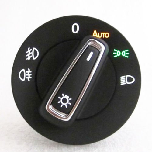

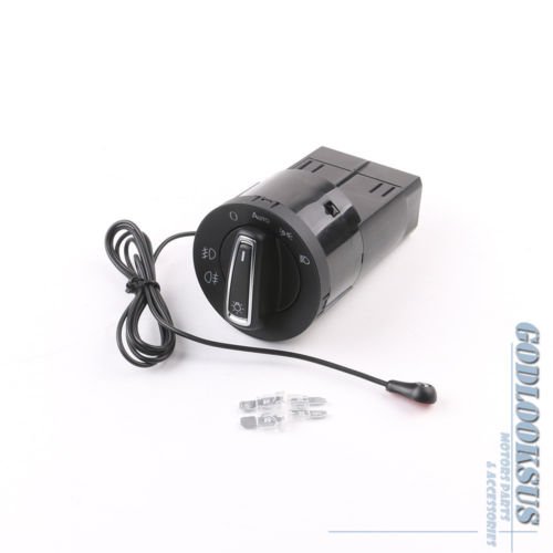

Just Got this Chrome Windows switch.
Going to install it soon.
Also waiting for Chrome light switch With light sensor

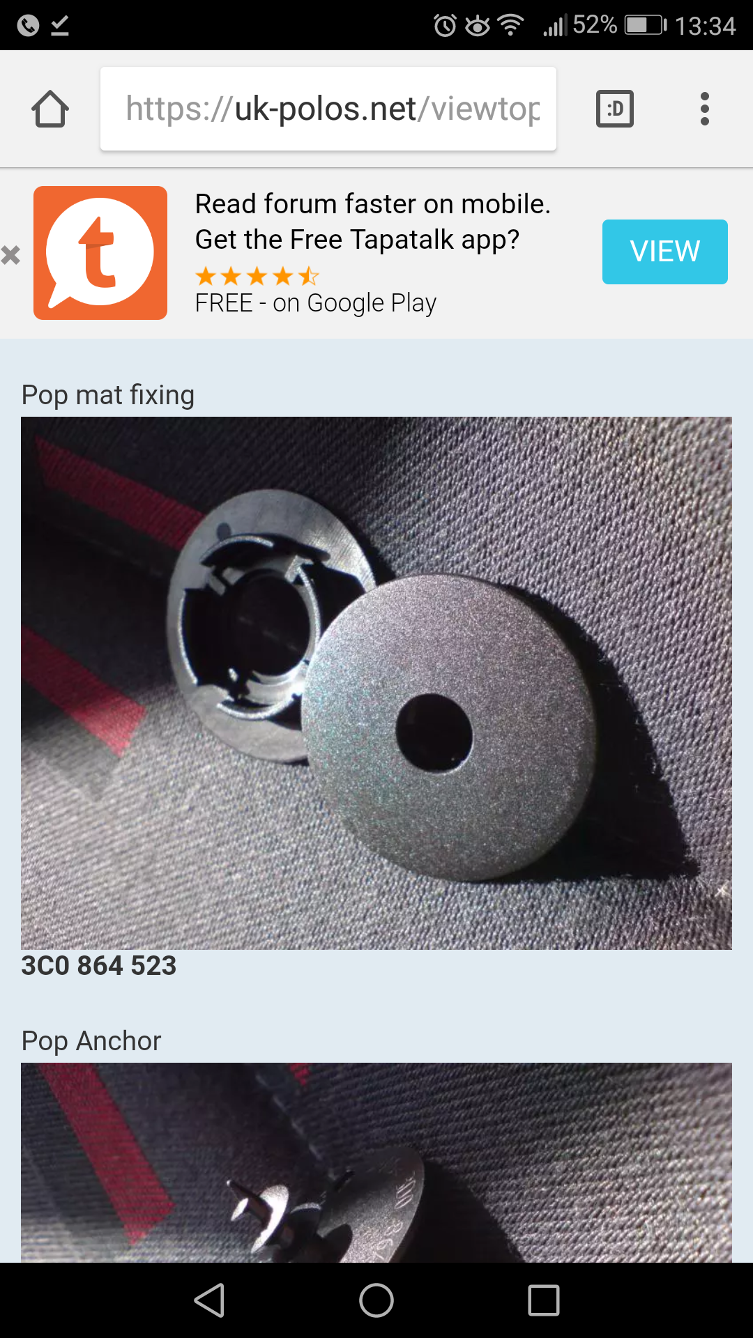

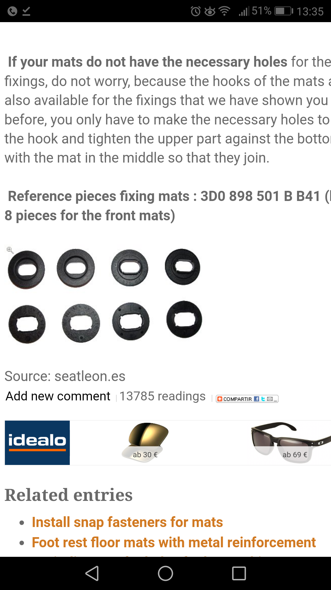

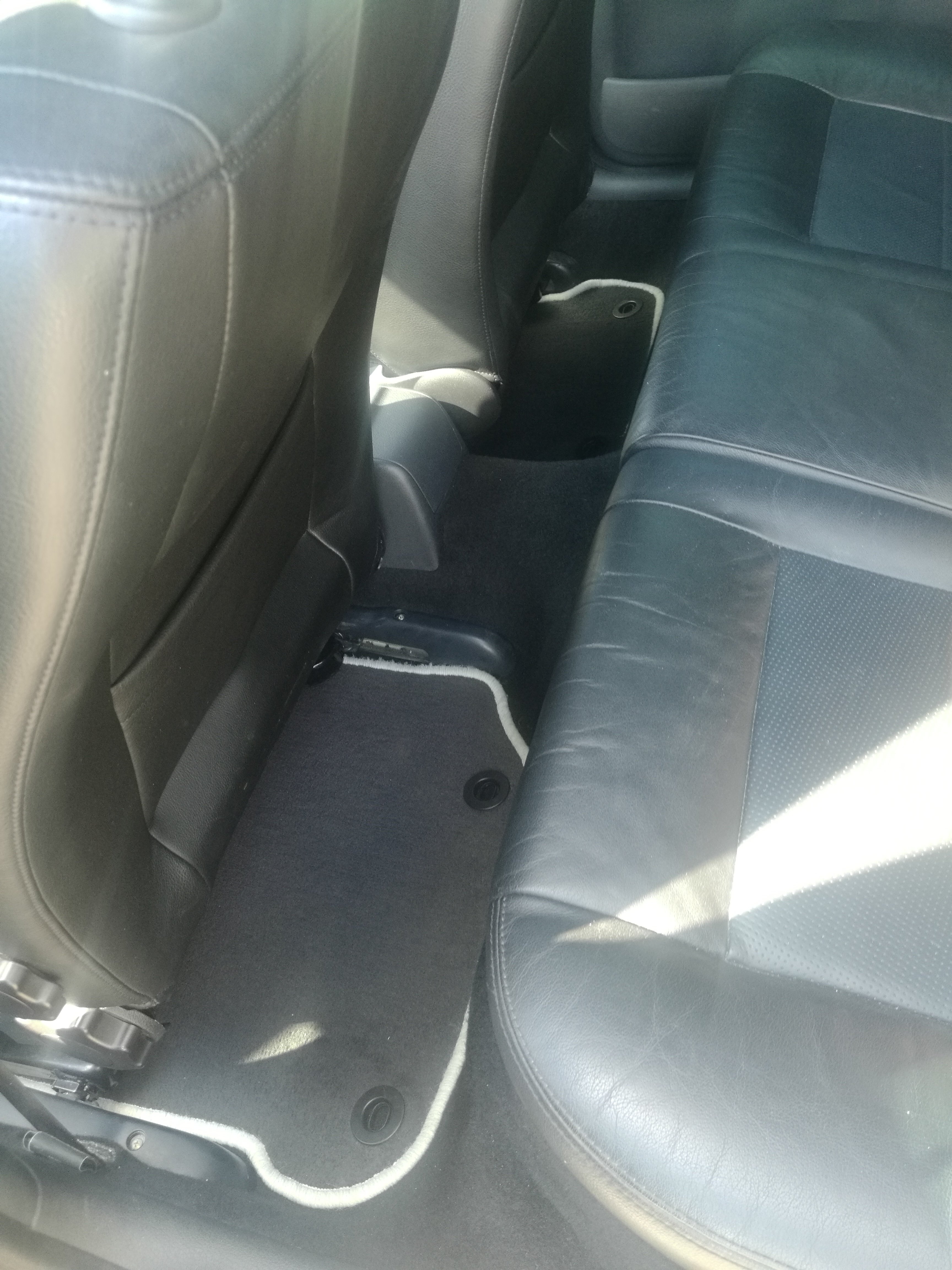

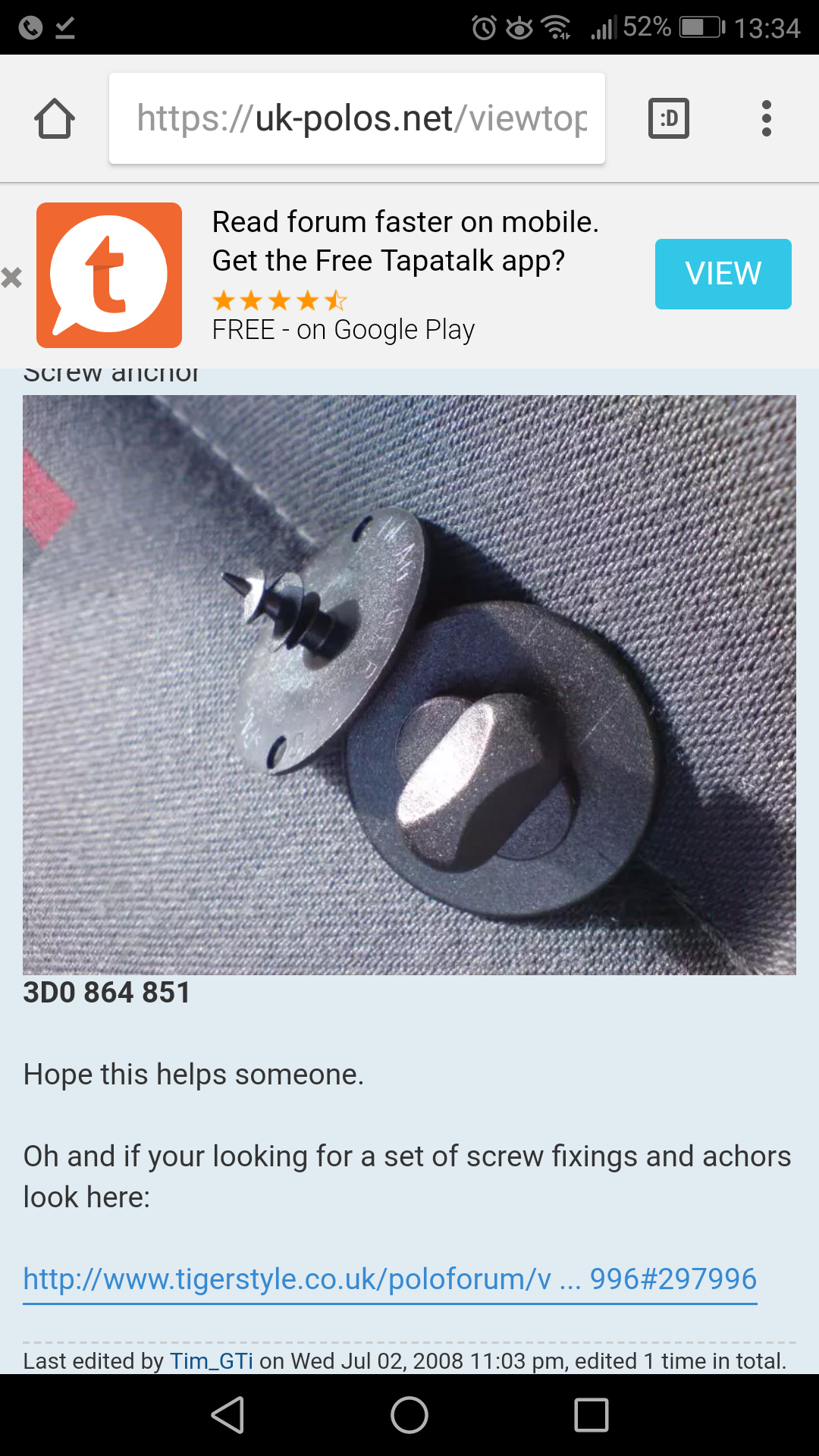

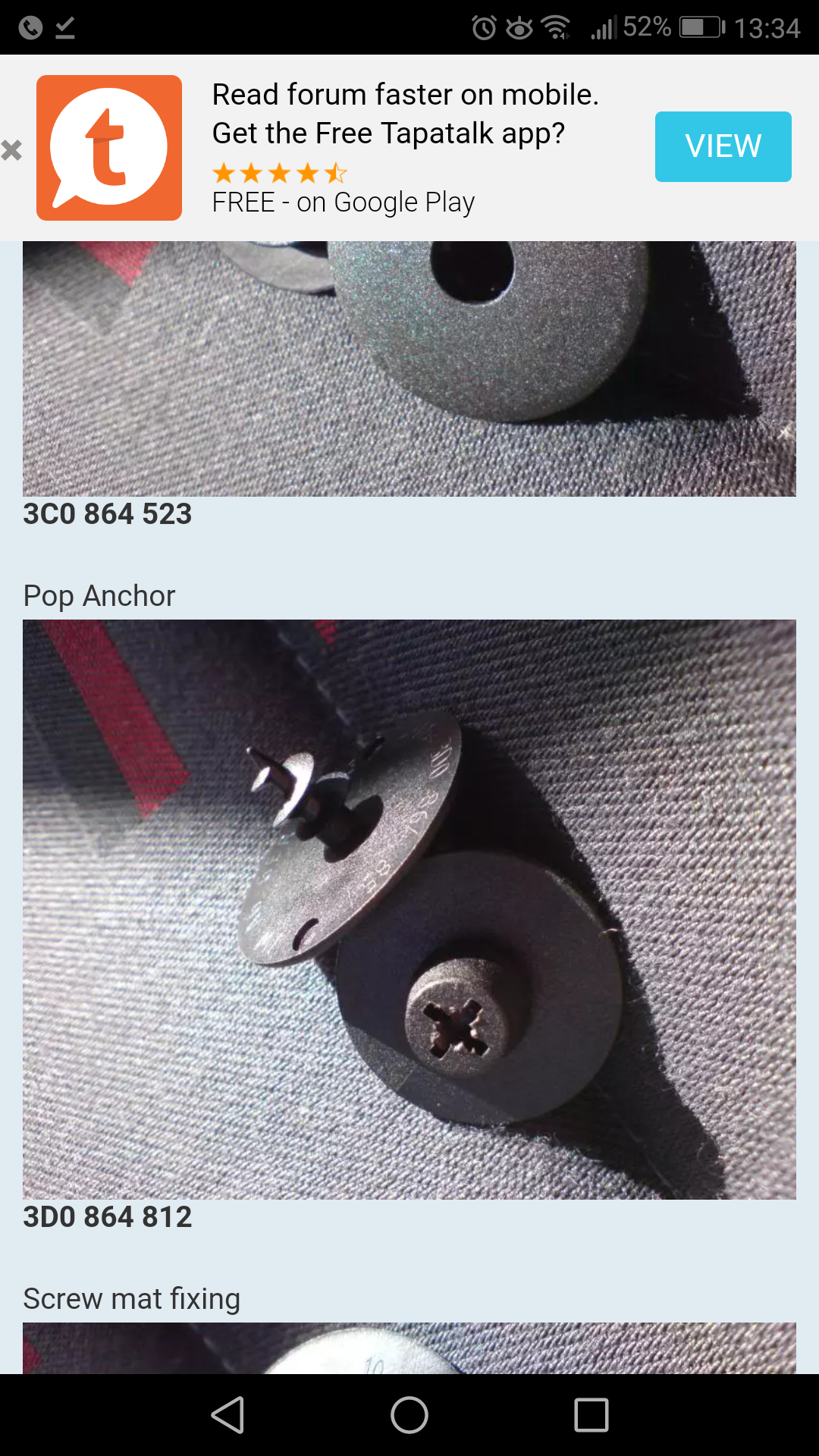

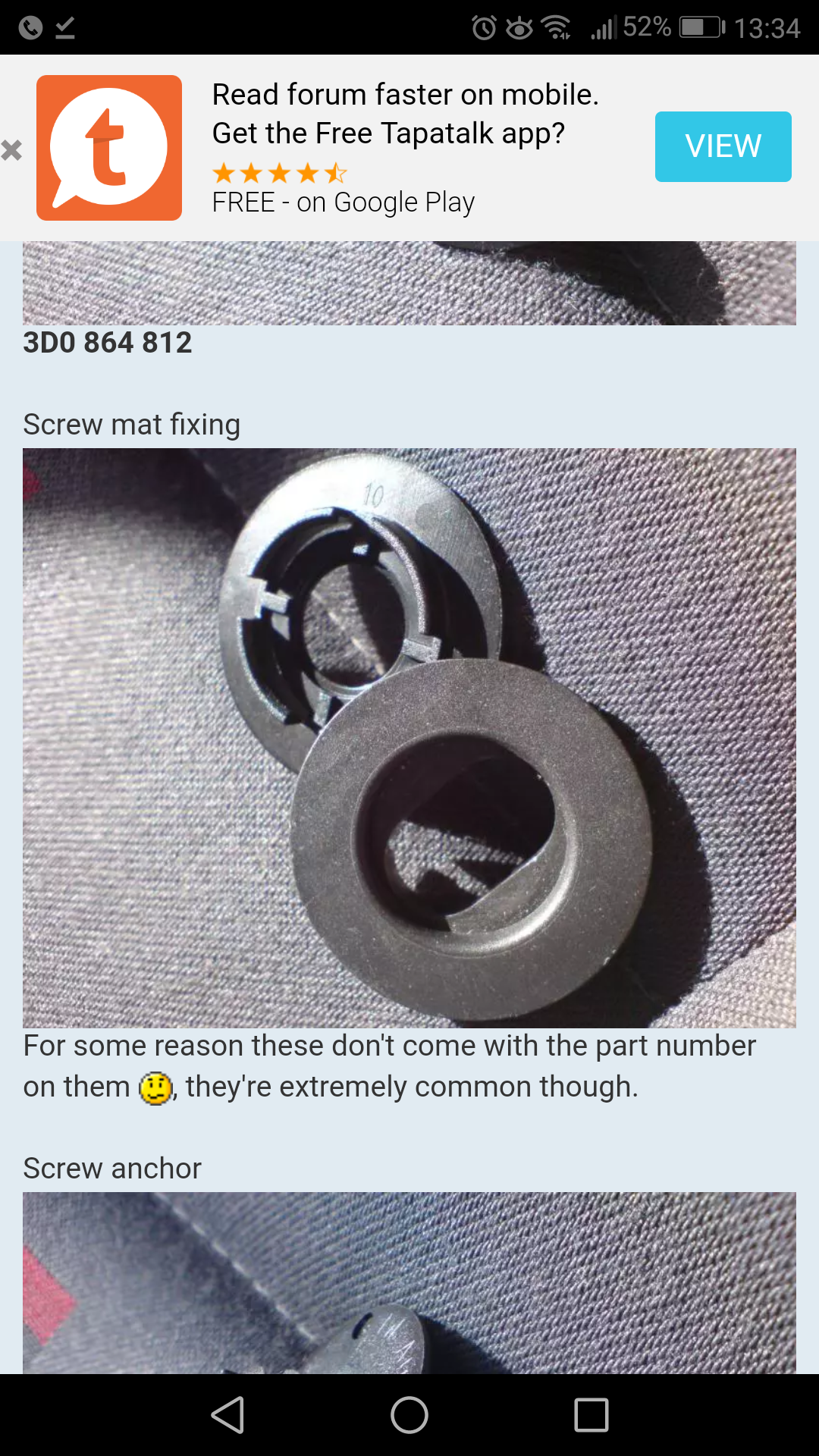

Bora carpet has only two round clips in front and no rear ones compared to 4 oval clips that were originally mounted by Skoda So either to change alll four oval holes for round ones on floor mats and ad two round clips in the rear or simply remowe two front round clips and put oval ones on front and rear
Oval ones seems beter and looks better to me but there is less choice by Skoda carpets for them  than by VW With round ones. I found VW Rubber  Mats for 25eur. Cant find that by Skoda

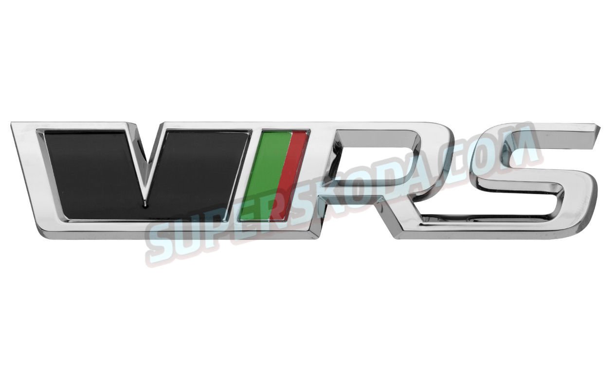

Will also change on the tsilgate Octy 3 grey emblem for black 245hp edition and Will put two on each front wing above blinker as iz was before painting
