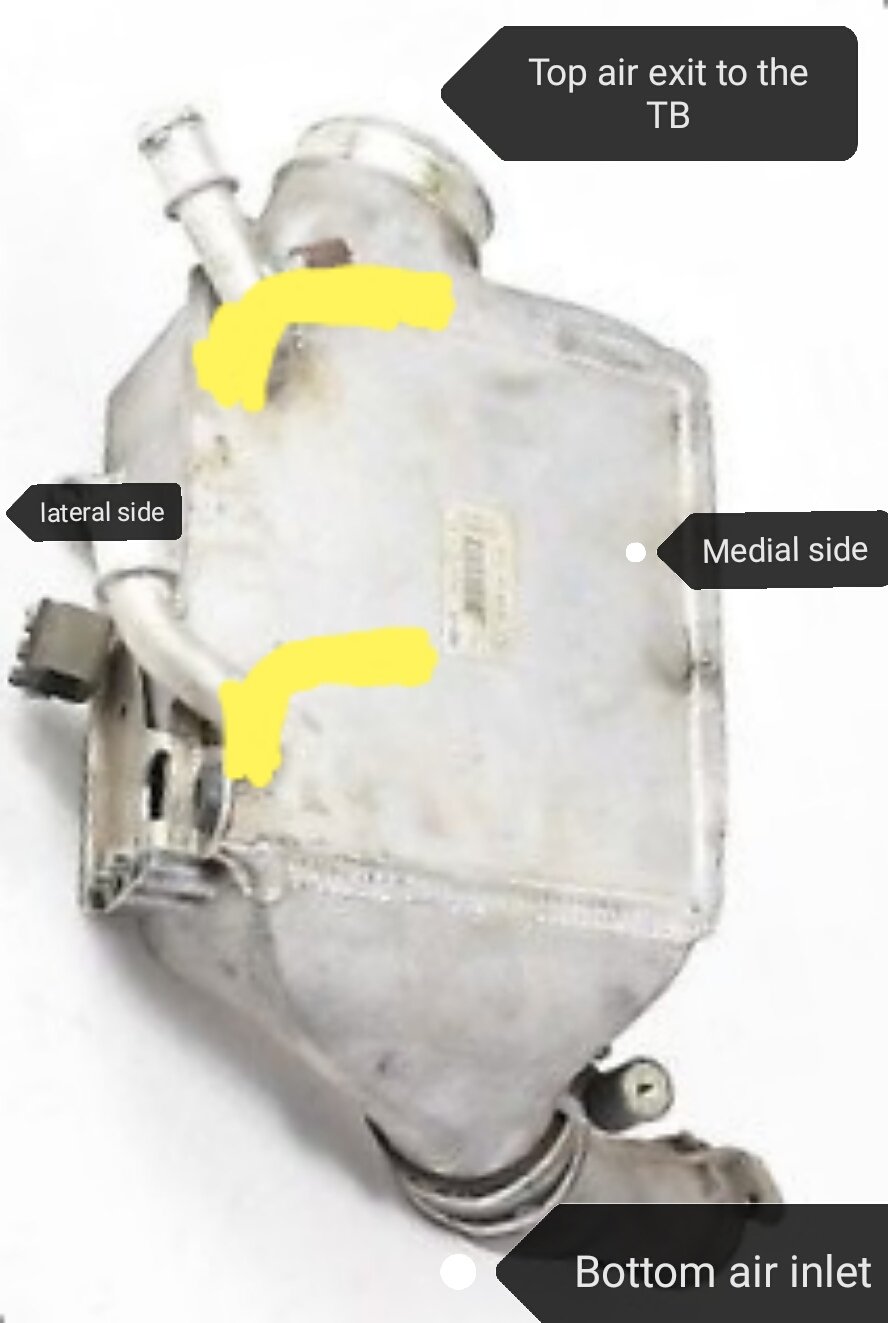

AMG wcac bought on eBay in USA and sent to https://bellintercoolers.com in Texas .
Today I Will ship also my OEM SMIC from Croatia. Can't wait to get New one back :-)

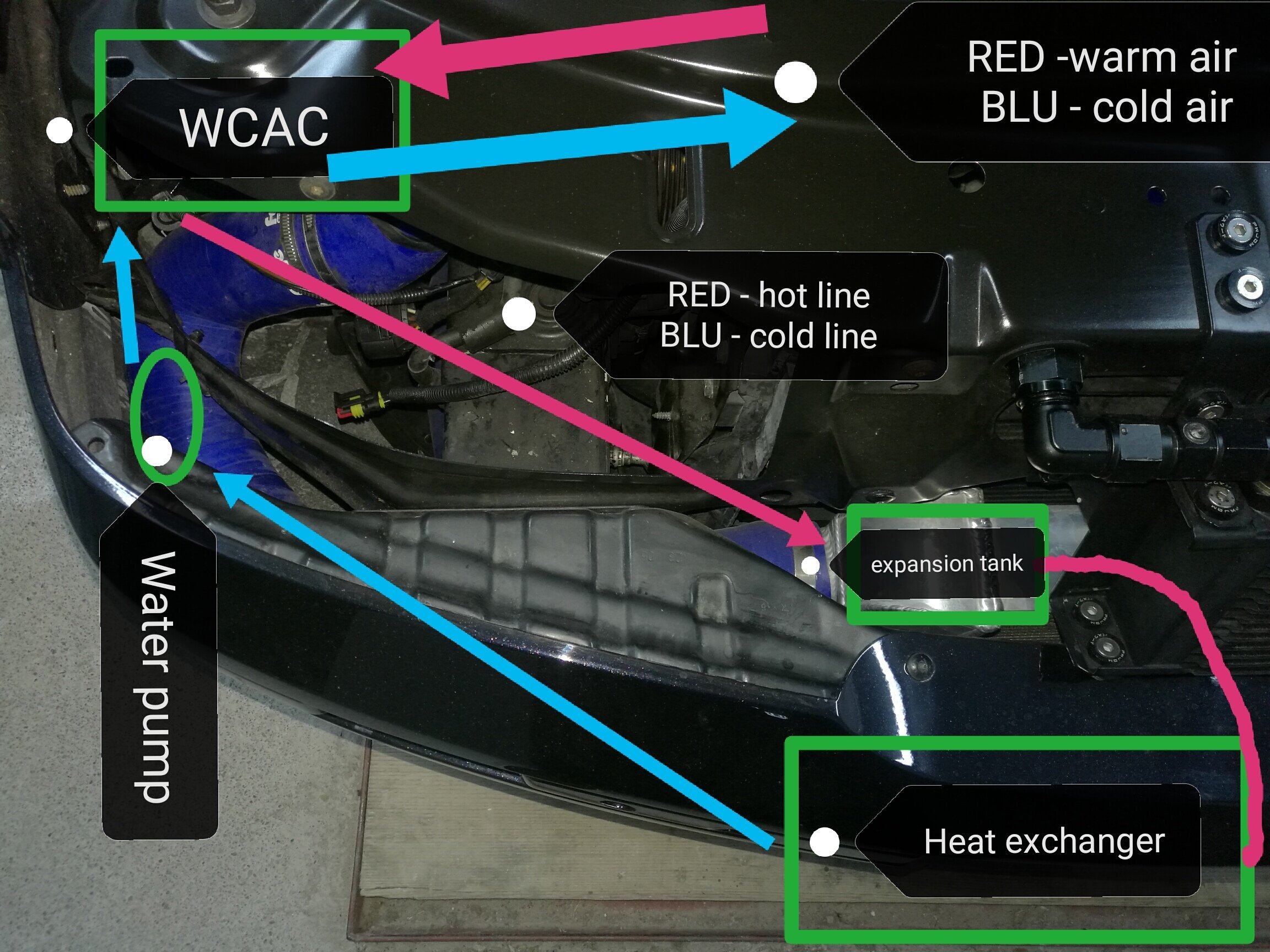

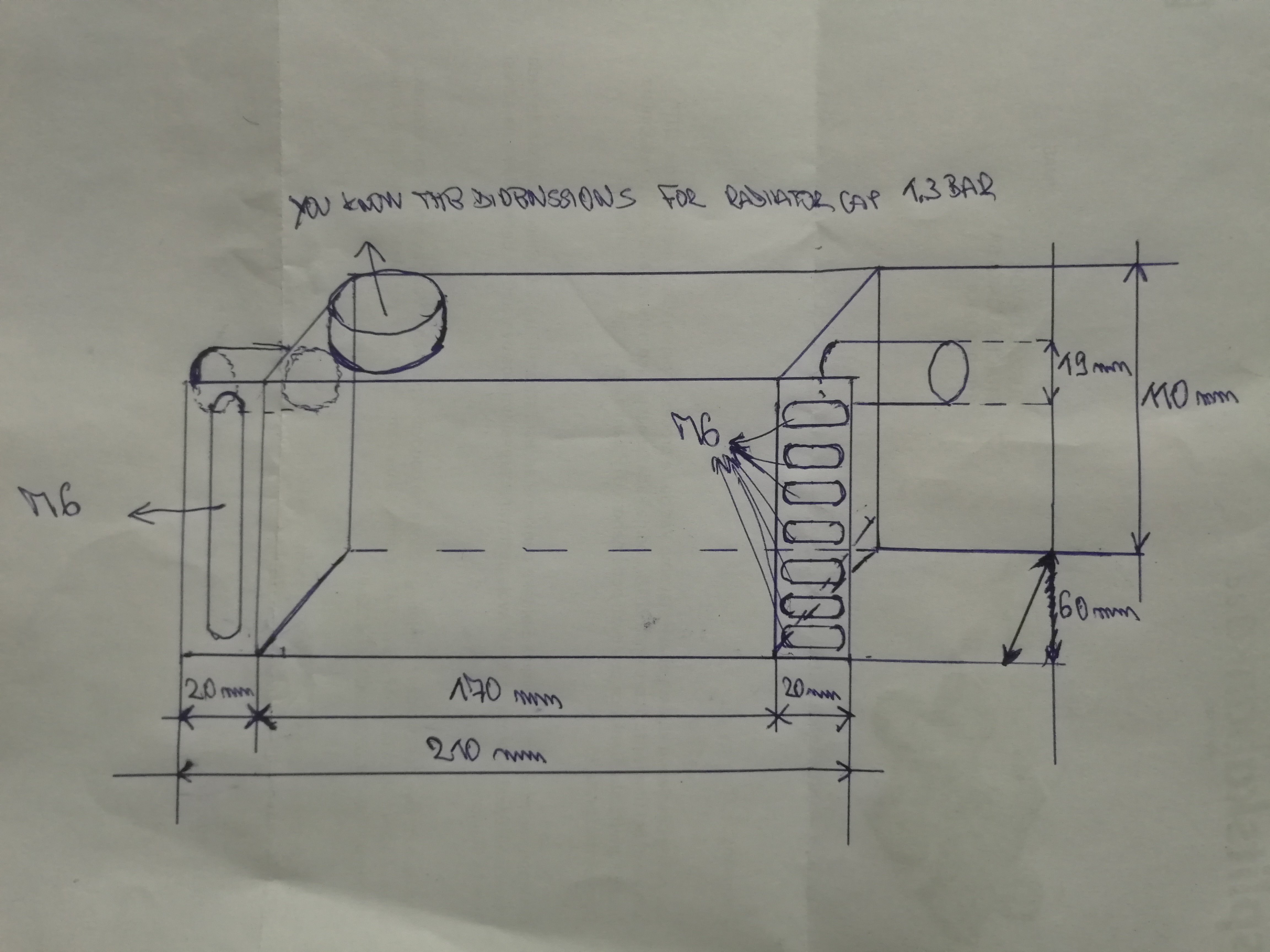

Just made drawing of how it all should look like.
Good that heat ecxchanger from S4 IMG_20181209_000506.thumb.jpg.7c5193920c58d859cf7a73581c769424.jpgis not dual but single pass so expansion tank will be also inline.
What do You think guys???
Any suggestions???

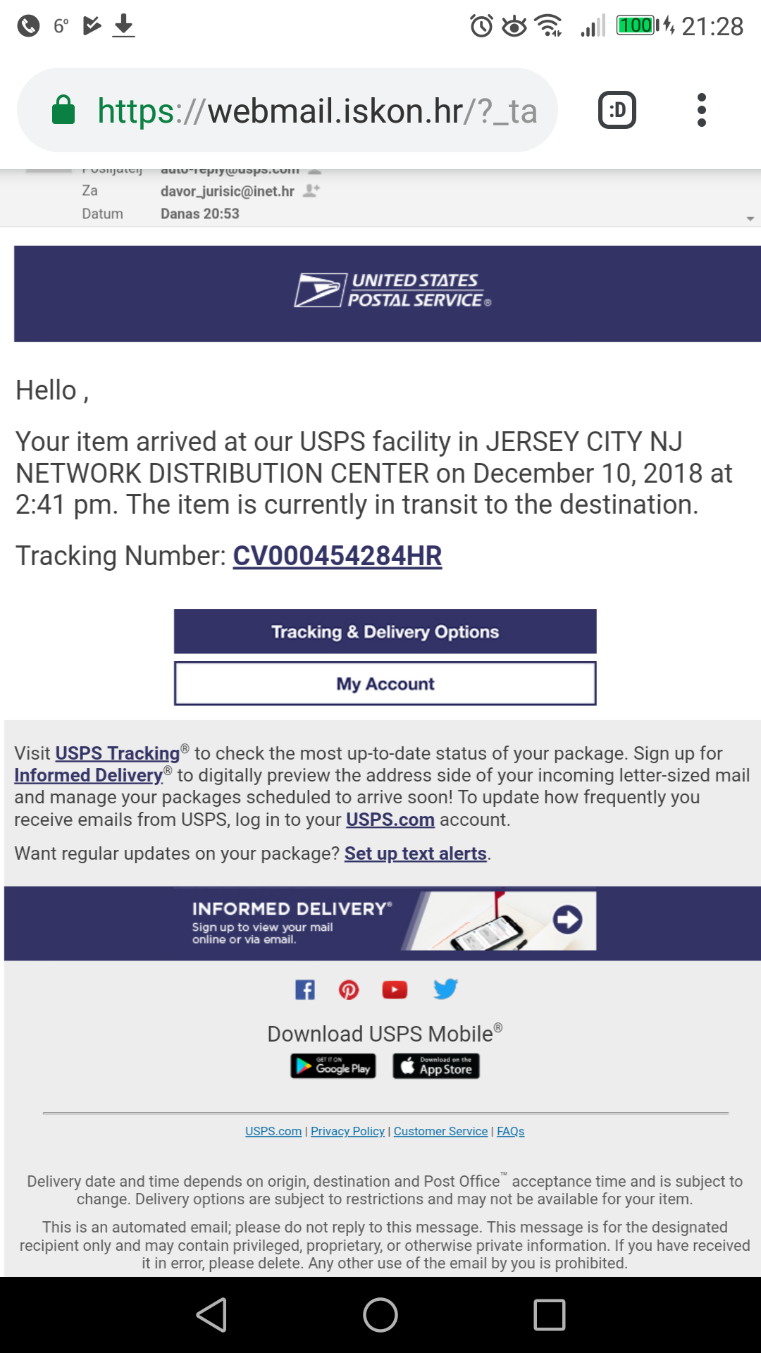

Hood news is that my SMIC reached USA. Today 2.41pm USA time it came to the Jersey City:biggrin:
I also made expansion tank drawing so it will be flat with the bumper upper surface behind the oil cooler as now FMIC is with 1-2cm protrufing neck for tank cap.
Hope You Like it.

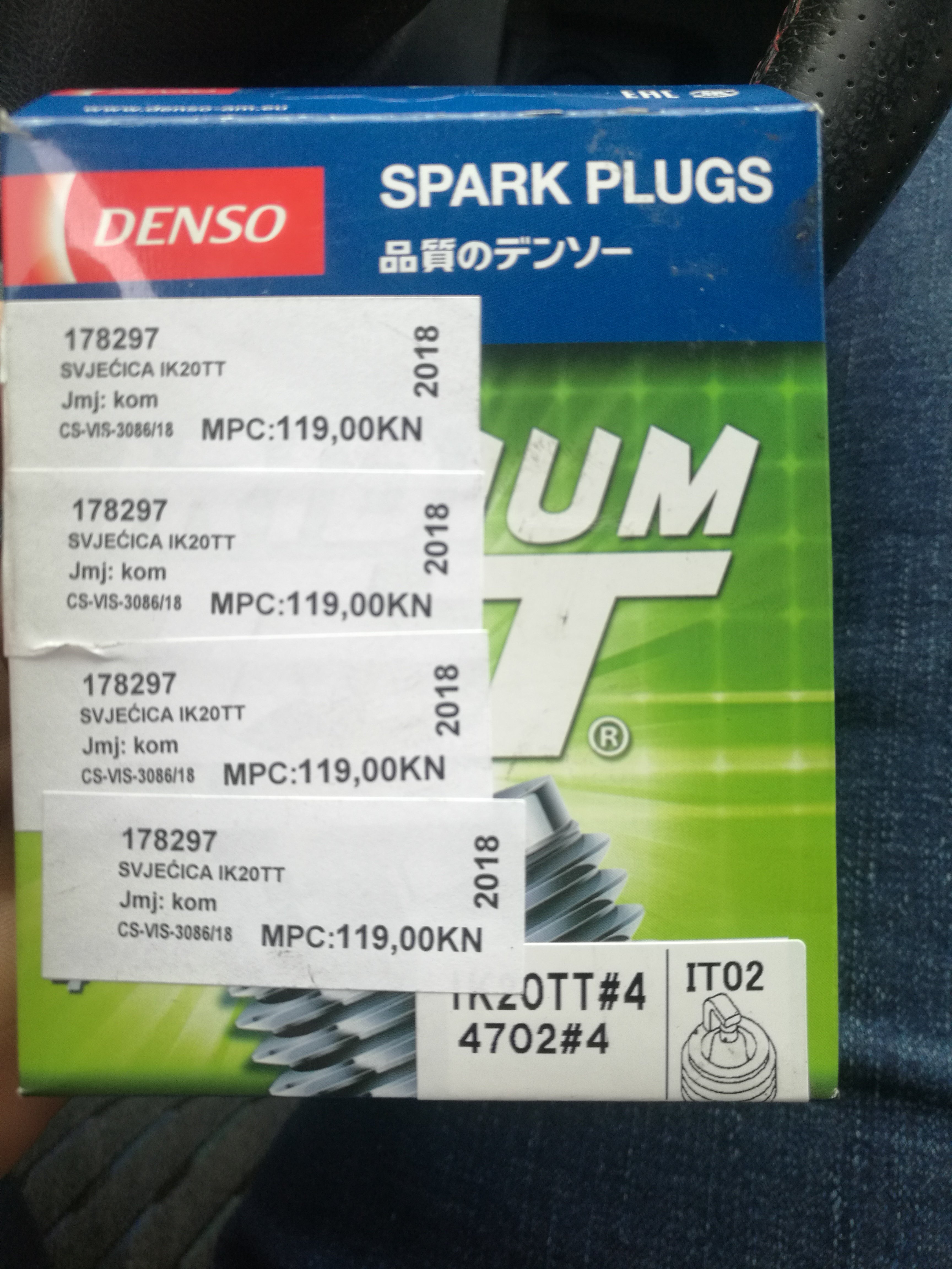

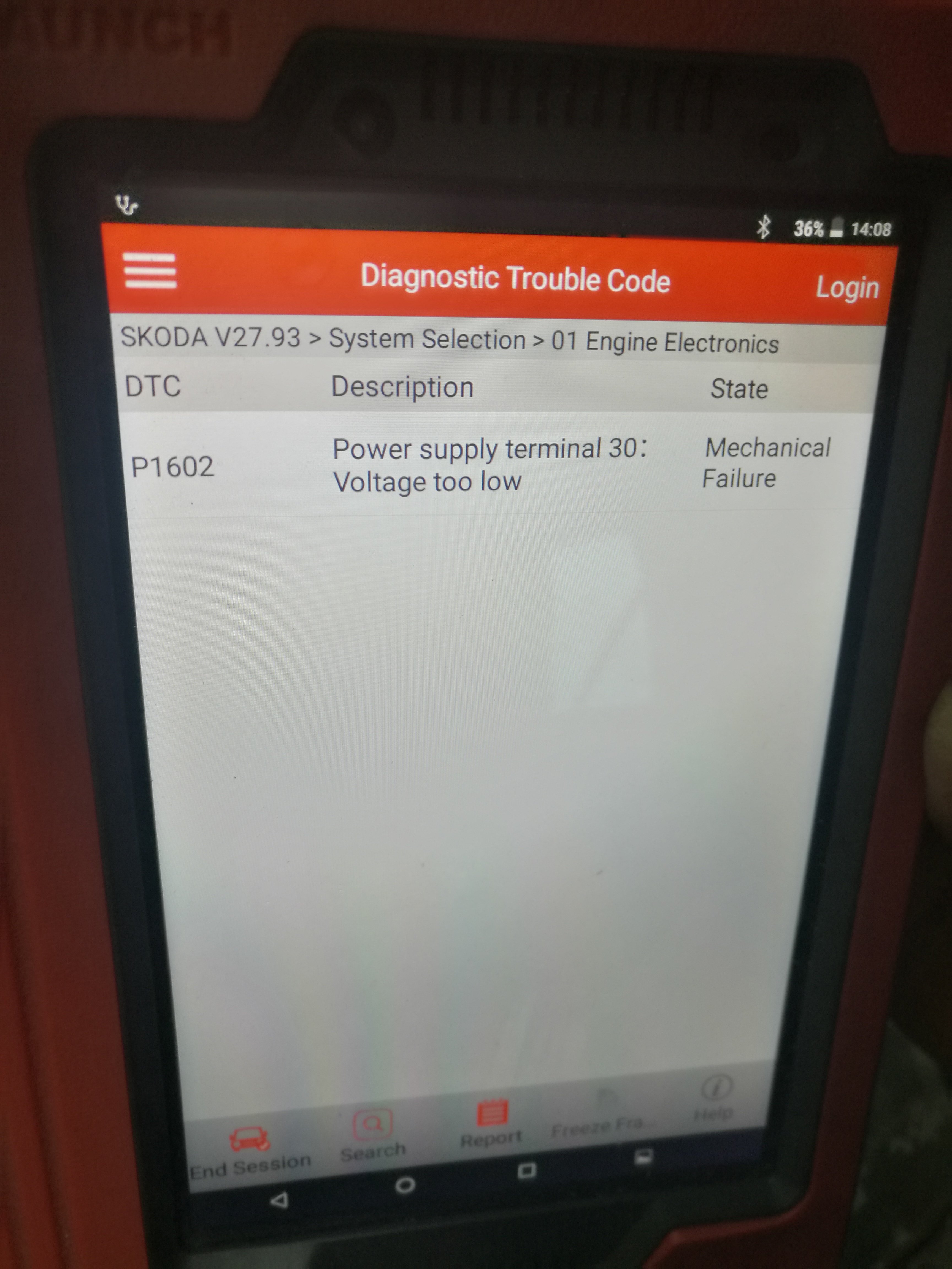

F.....g DENSO IRIDIUM IK24 gapped to 0.024" instead of 0.032" and IK20. Couldn't start the car.
Worked until now and error P1602 appeared. Checked everything and at the end did put oem ngk ones and started and worked as a baby:biggrin:
So I bought New DENSO IRIDIUM IK20TT and installed them. No more start up problems. Works flawless now, (was also good with old IK24 before which suddenly started making problems)
Bought them for 10.35gbp each

Bell intercooler has started adaptation of my AMG S55 to mimic my OEM SMIC.  It seems that there are companies in Croatia which also works for Rimac Automobili- fastest Electric car - Concept one and two. And I am planing to use them for custom heat exchanger. I Will not go into the height. Will use only Space below crush bar to be maximally efficient in cooling  so max 10-13cm in height but width will go up to 10cm. Lenght is for sure 60cm and maybe up to 70cm...so cubic volume (LxWxD) should be around or over 6000cm³. That can feed later on forged stroked block, CNC ported head and tfsi K04-064 390 hybrid.

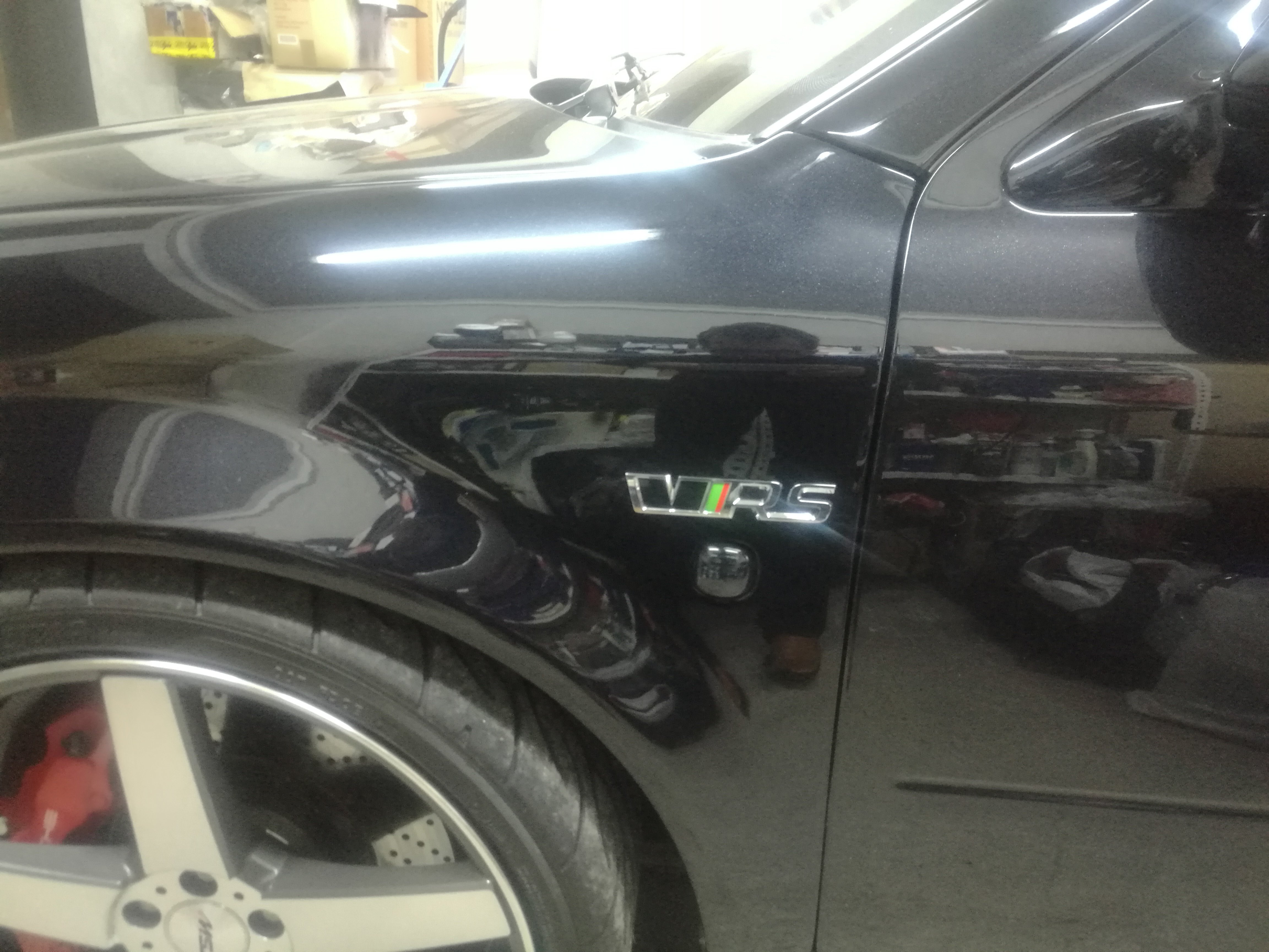

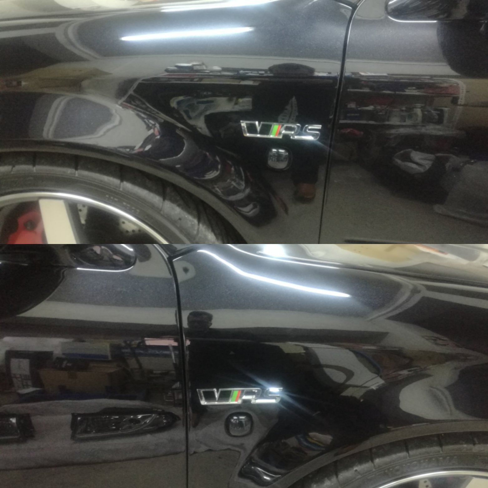

Finally black VRS 245 emblems for trunk and fenders arrived
To be sticked today I hope
New black ones are bigger than old Grey ones.

The work has begun. We Will make whole New WCAC and expansion tank. Here is the drawing for expansion tank.
P00460-DAVOR - Sheet1-2.PDF

DID YOU HAVE ANY MORE ISSUE WITH POSITION 30 VOLTAGE RELAY?
No for now, it turned out that Sparks were quilty. Replaced them for New ones. Haven't driven car since than-in garage unregistered without headlamp so I just turned it on in garage and it was flawless. Will check it on the road this days
MINE KICKED UP SAME CODE BUT HAD THE RELAY GO ALTOGETHER A FEW YEARS BACK SO WONDERING IF ON ITS WAY OUT AGAIN

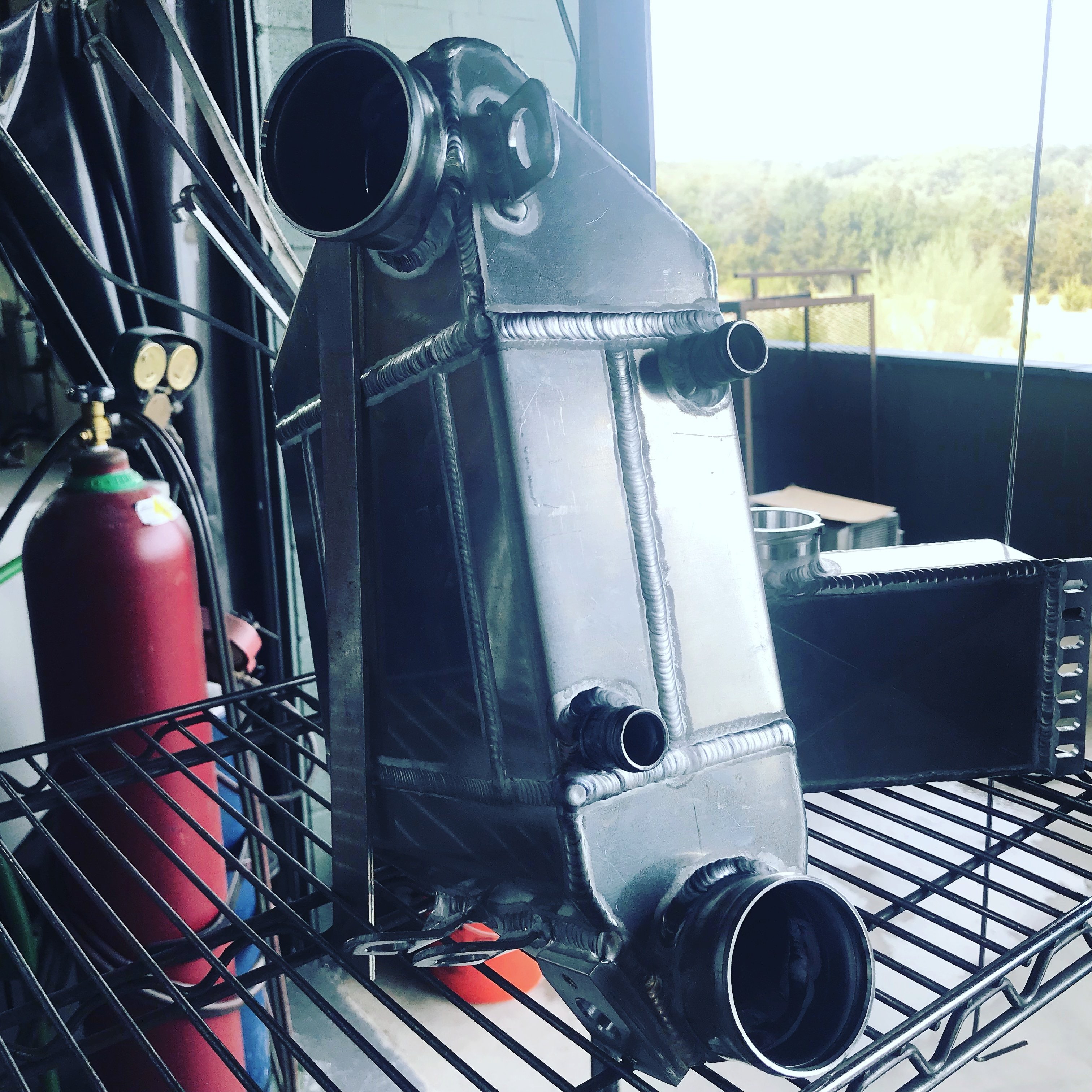

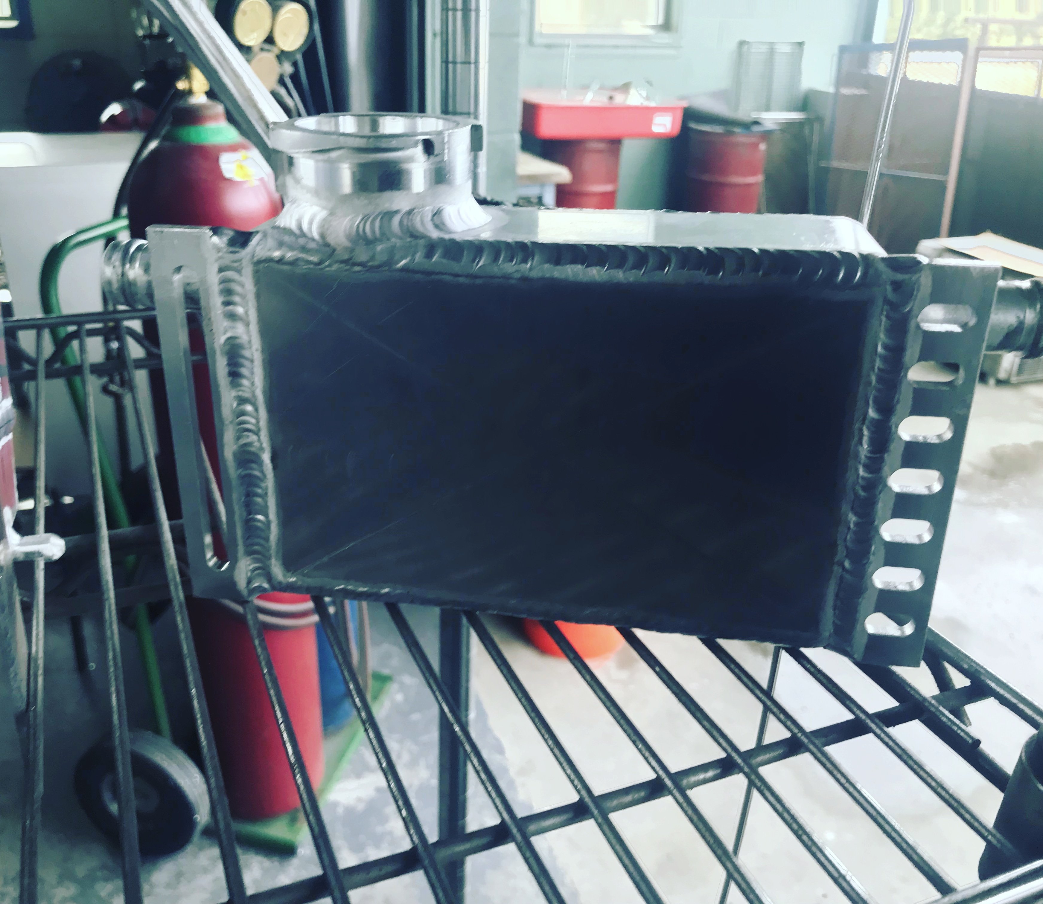

Just spoked (via mail) With Mike from Bell intercoolers and expansion tank is finished and WCAC is about 40% finished. Will be tomorrow. So I asked for few pictures for You guys here before I get it in March. Hard waiting time in front of me. This week Will take measure for custom heat exchanger and will keep You updated.
Edited by davojuri
Custom WCAC and expansion tank made by www.bellintercoolers.com
Hope You Like it
Comments are welcome
