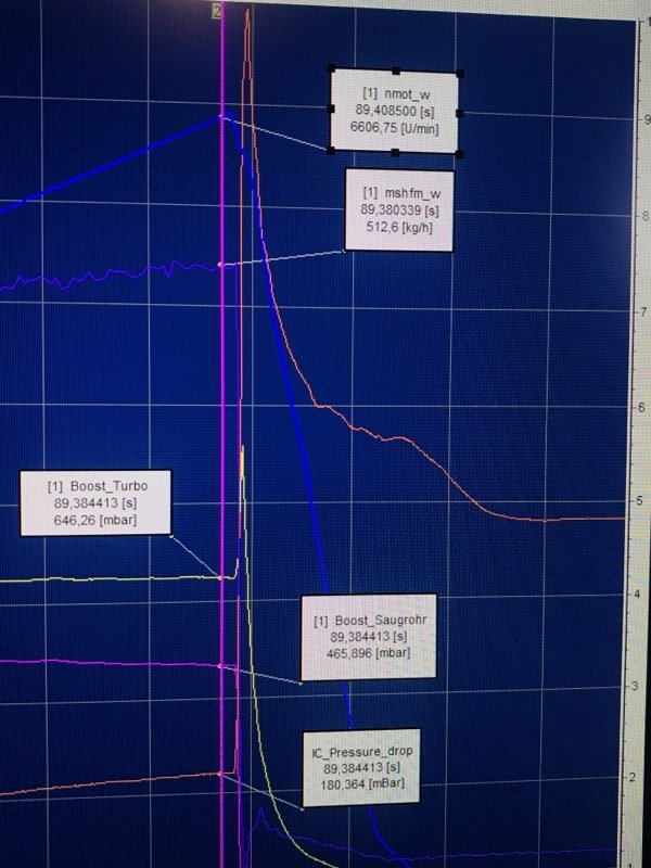

At the moment it has 290hp and 407Nm but tuning is not finished.. waiting for Bosch EV14 550cc 52lb injectors next week ...but datalogging shows on  0,65 bar boost and 6600 rpm pessure drop 180 mbar at 512 kg/h air flow ...we have to fix that. He even thinks that same paper or towel is left somewhere in hoses.....strange but You never know

Does anyone has any idea how to fix that data logging info?

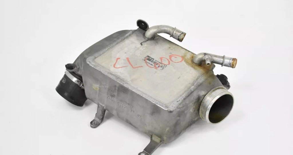

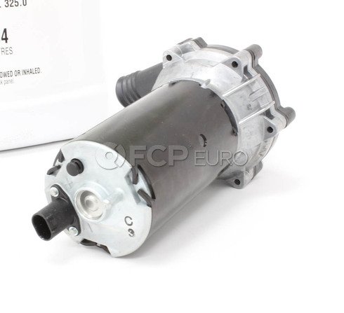

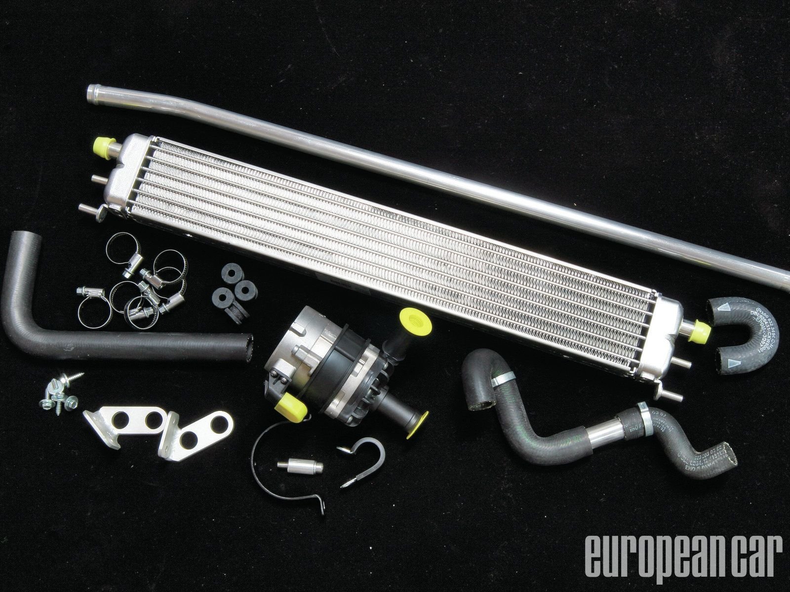

If needed he Will flow bench everything (yes he has and know how to use that machine).....also he ofered water cooling With IC from AMG V12 as on picture,pump and cooler,all together smaller than curent FMIC setup and way more efective. Btw Golf 7 GTD inlet air temperature 180C and outlet 45C. You all know what cool dense air means for tuning
Edited by davojuri
Bosch pumo

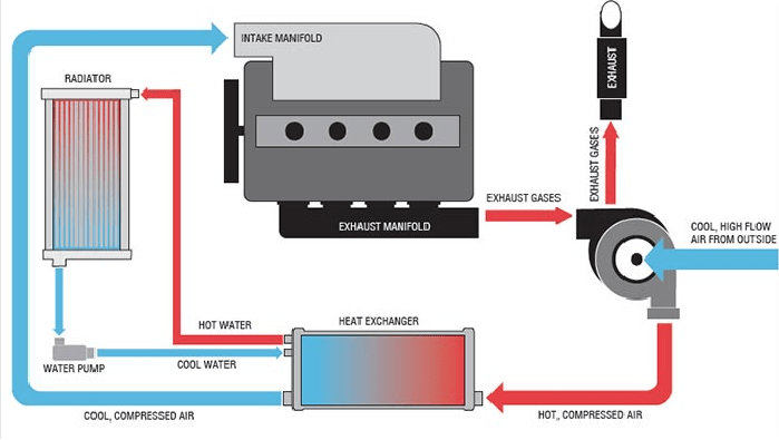

And Water lowers temperature way better than air by conduction-heat transfer by direct contact
One kit for Mercedes With upgraded pump and radiator

Yes...tuner is not satisfied . He will map it tomorrow with new Bosch EV14 550cc injectors but using his water cooled IC conected over the engine and than will connect back my FMIC. It seems on flow bench test that my FMIC  restricts flow. Than I will have to put either AMG V12 water cooled system or Wagner custom FMIC Like Here for S3 8L

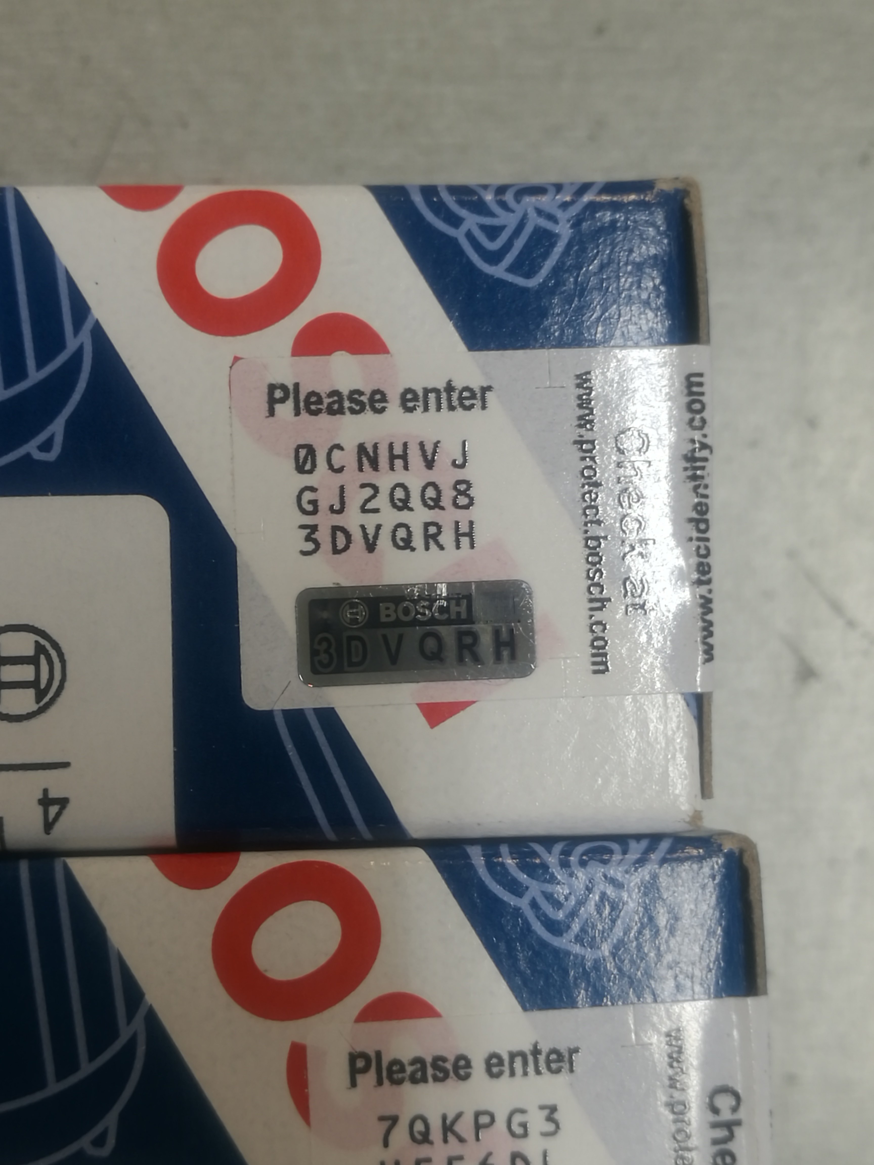

Just checked my injectors here:
https://protect.bosch.com
and yes they are genuine.

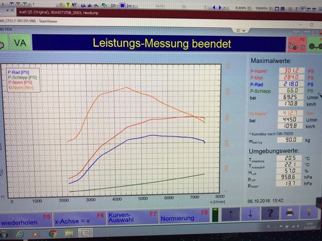

Latest update with AMG V12 water cooled intercooler at the very begining  it measured 302hp and 412Nm, Max drop pressure at 7000rpm is ONLY 10mbar-practically no flow restriction, and Max temperature of intake air is 40C at 302hp. Than at very begining emulator locked-license expired. Had to wait till monday. He borowed it from German tuner only for my car and we renewed his licence for Short period-2 weeks only. He is not any more doing 1.8T. So at monday further water cooled tuning update. Hope You like it guys. Nice weekend to all of You. I went swimming yesterday here

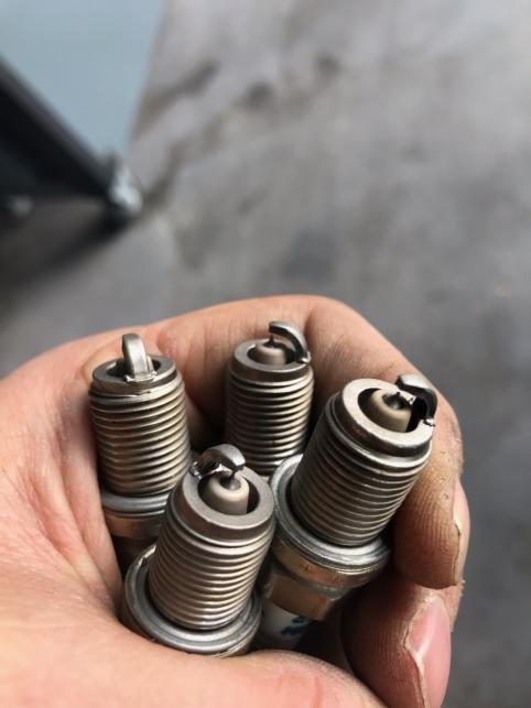

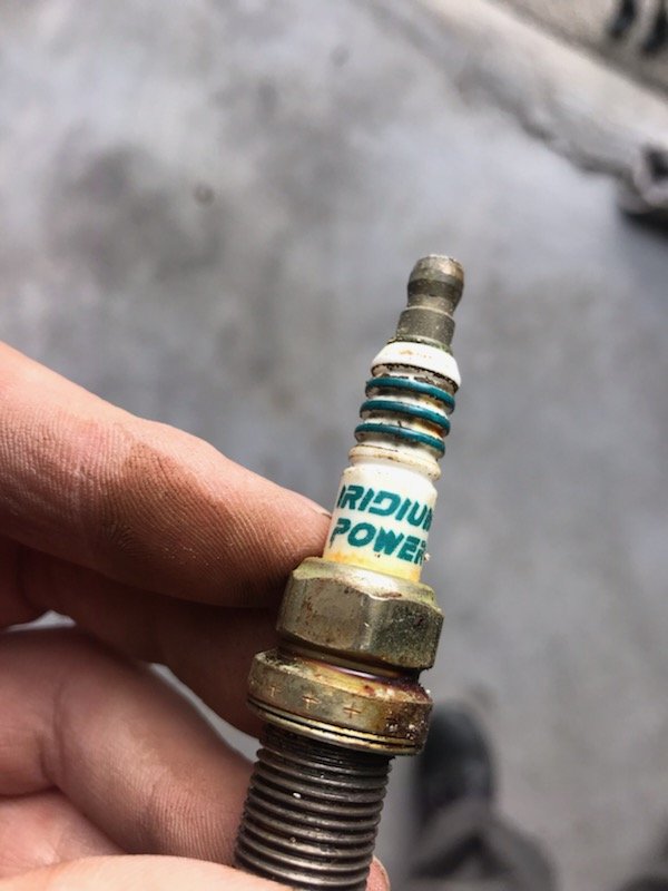

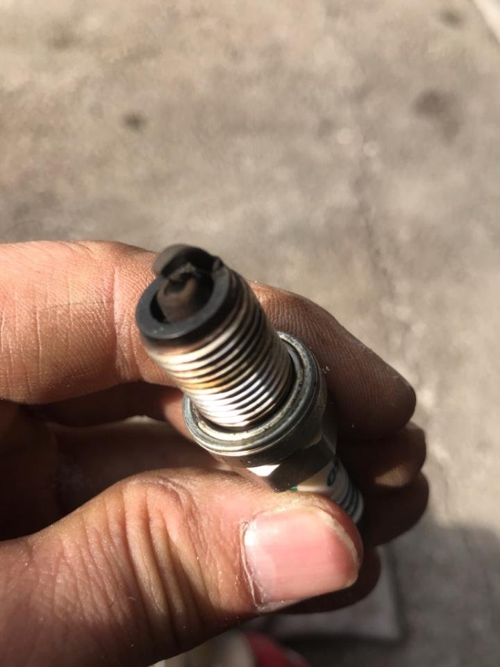

Spark pluga IK24 gapped to 0.024 (0 032 is standard) before and after ceramic treatment
And finalllllllyyyy what everyone is waiting for prof od mentioned numbers
And all that without even touching the ignition

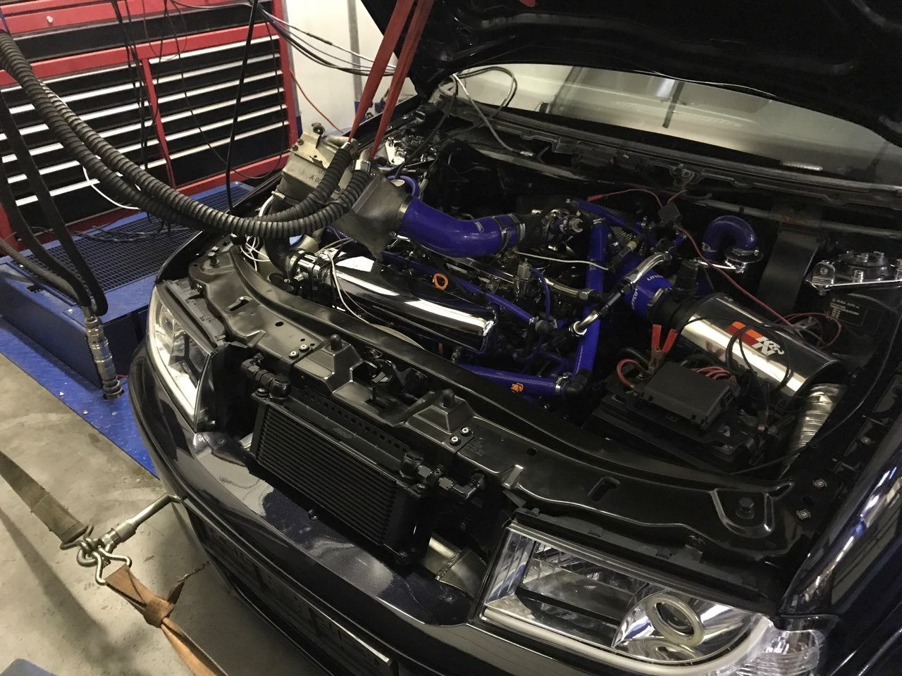

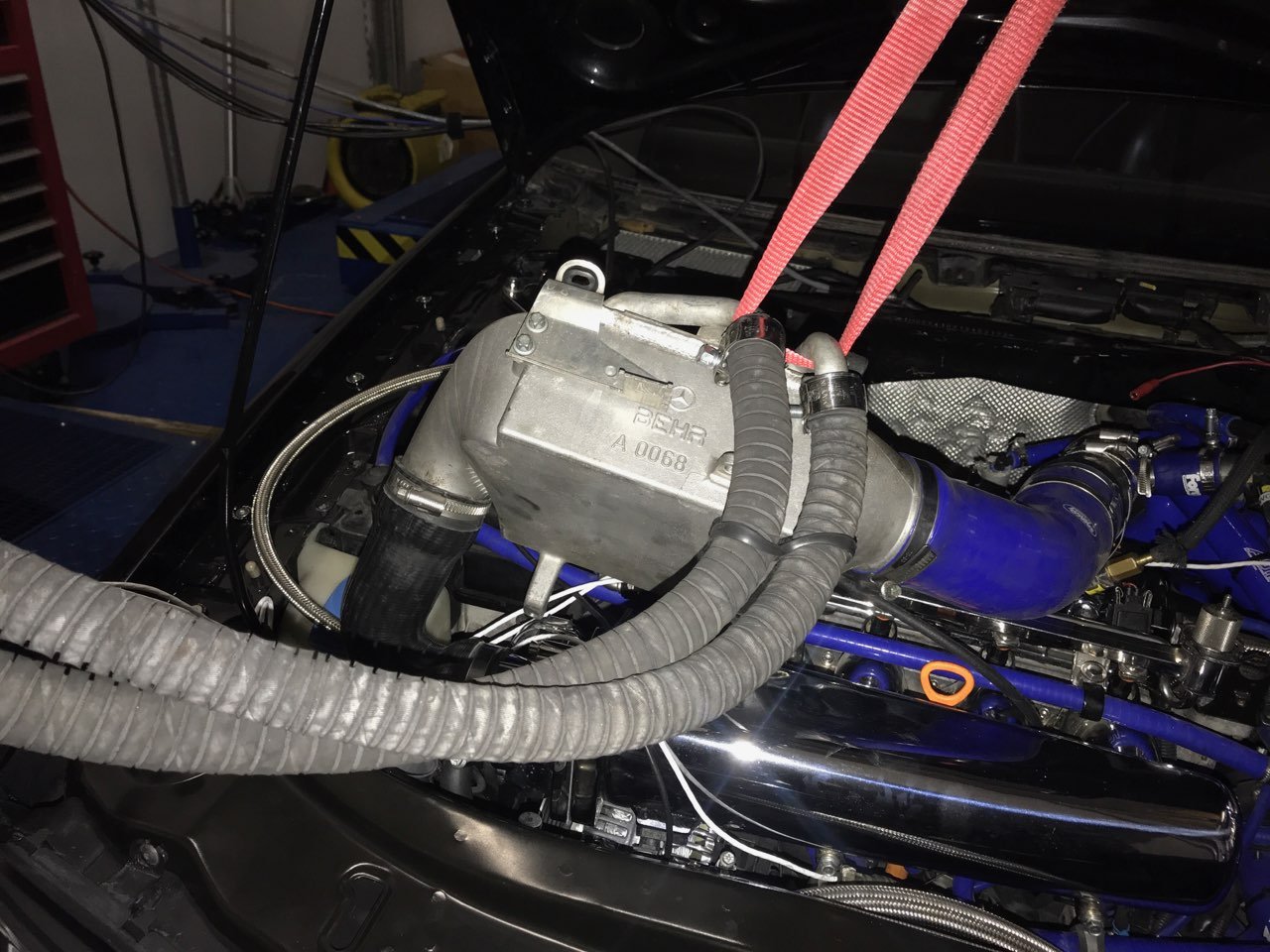

Nice, where will the ic mount?
To the SMIC OE location-in the front of the front right wheel
Heat exchanger in the front below register plate and pump and overflow tank in between
And old FMIC out of the car
