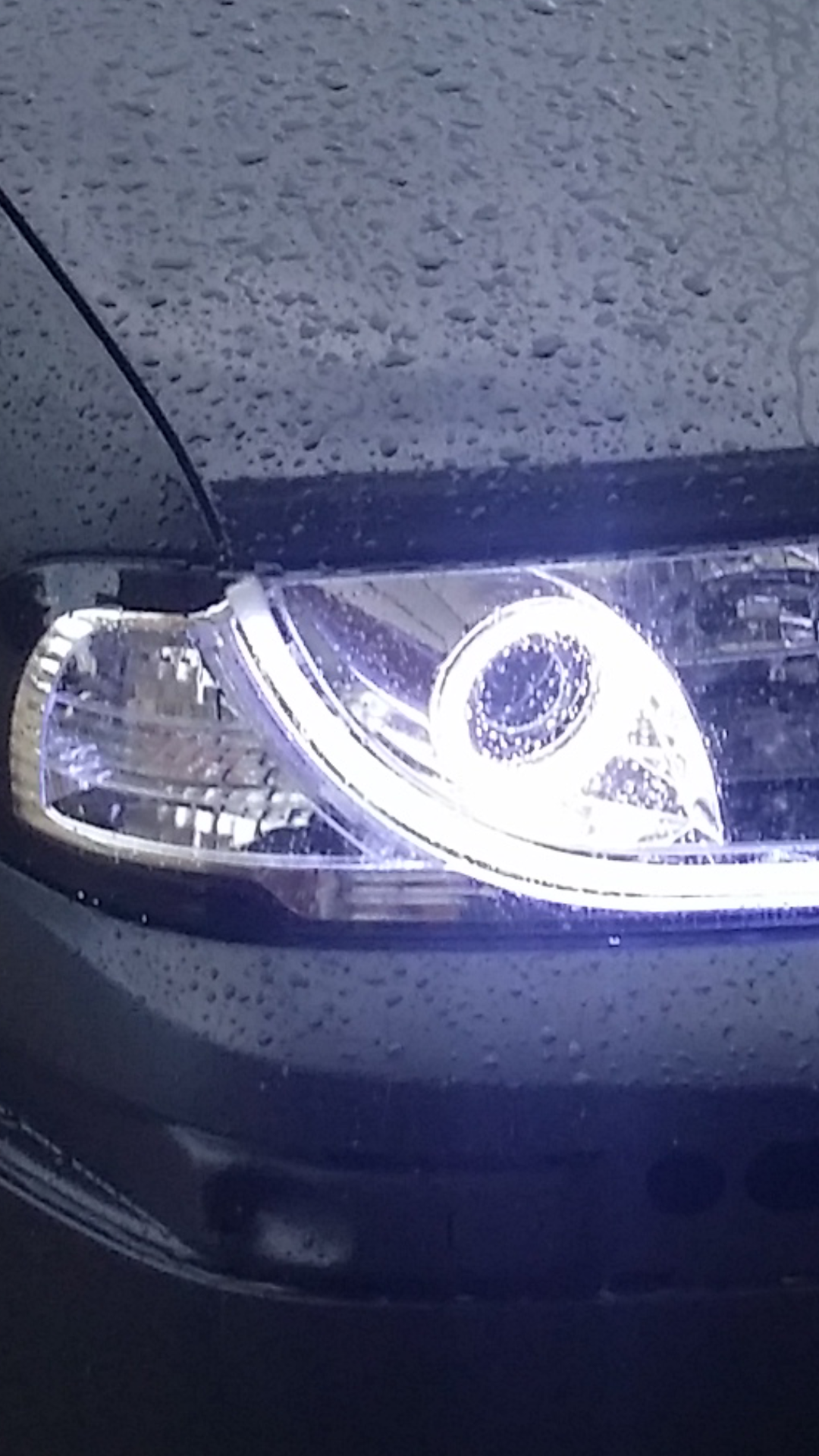

While waiting for 21mm spacers in 42draft design style to be made-light with cuts to be able to mount new wheels instead of 9ld 15mmones I did some pre work on broken headlights to see how will my latest idea look like. I had headlights with integrated repeater and dotted DRL like early audi style. I reworked them and did put bixenon 6000K projector into the existing lense to have focused low/high beam. But that old audi style leds bordered me so I digged this out
1. Bought 70mm cob led ring with plastic cover-not to be seen when off
Screenshot_2015-01-06-20-47-29_zps5ab685
Screenshot_2015-01-06-20-47-47_zps8e3ed2
2. Due to the fact that the rings are yellow when off I searched for latest development and bought jdmtoy ones-only ones not so yellow when turned off
Those mother f.....s spec are
COB-type high power LED halo rings
New V3 design (no more ugly yellow when the LED ring is not lit)
Made with high power COB-type LED lights
3-4 times brighter than conventional CCFL Halo Rings
Content: 2 pieces of LED halo rings
Color: 7000K xenon white

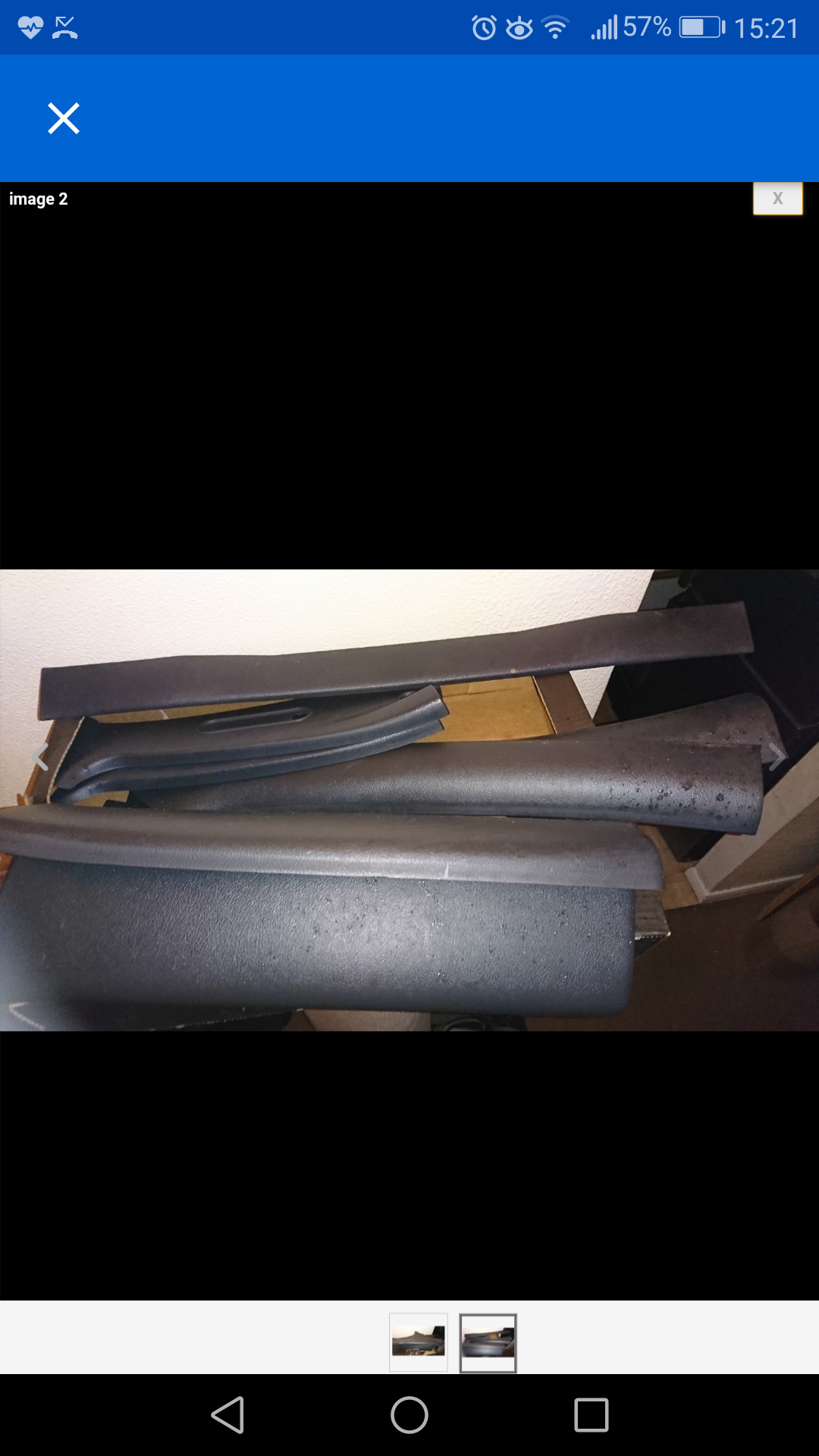

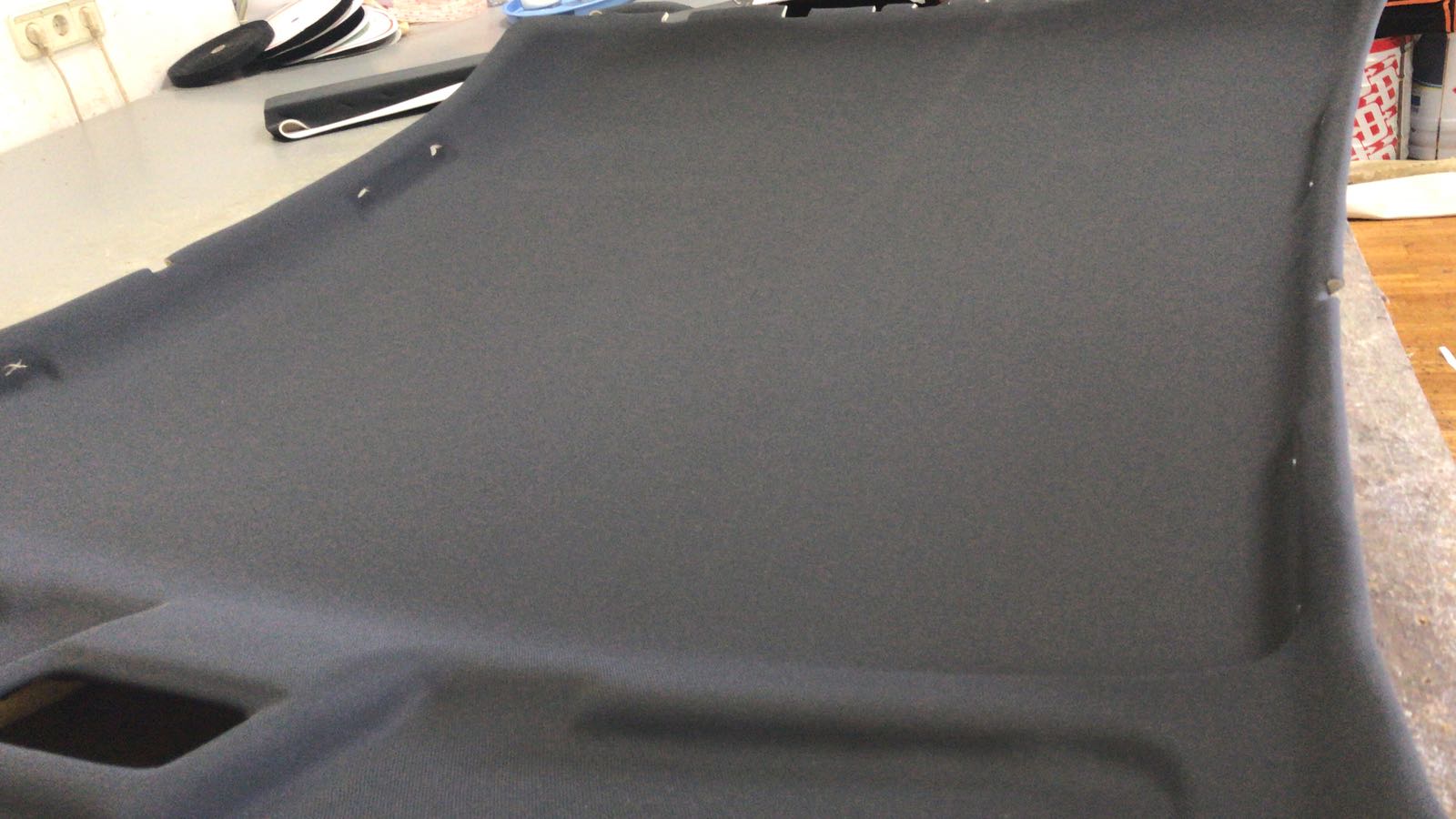

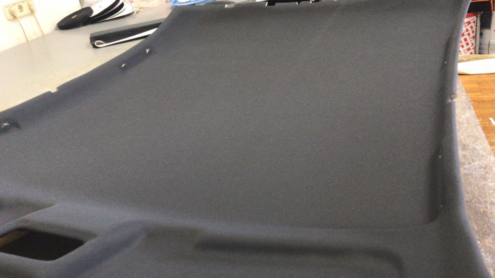

1.roof lining retrimed in black and nano protected by Gtechniq
2. Cleaned and nano protected A,B,C new black pillars
3. Led lights on black roof light
4. Cleaned and nano protected Seats,Door pannels and dashboard

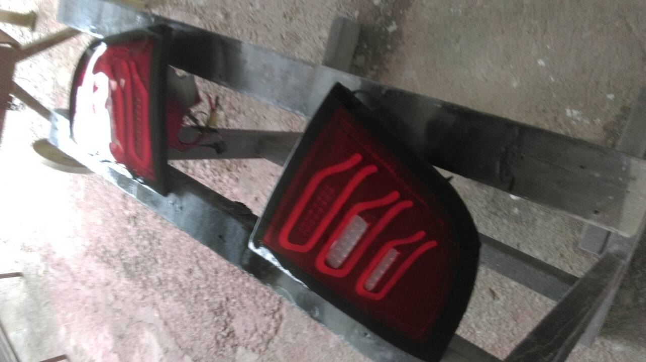

9. New rear led lights painted With clear laque and to be wrapped in clear protective film as front ones.

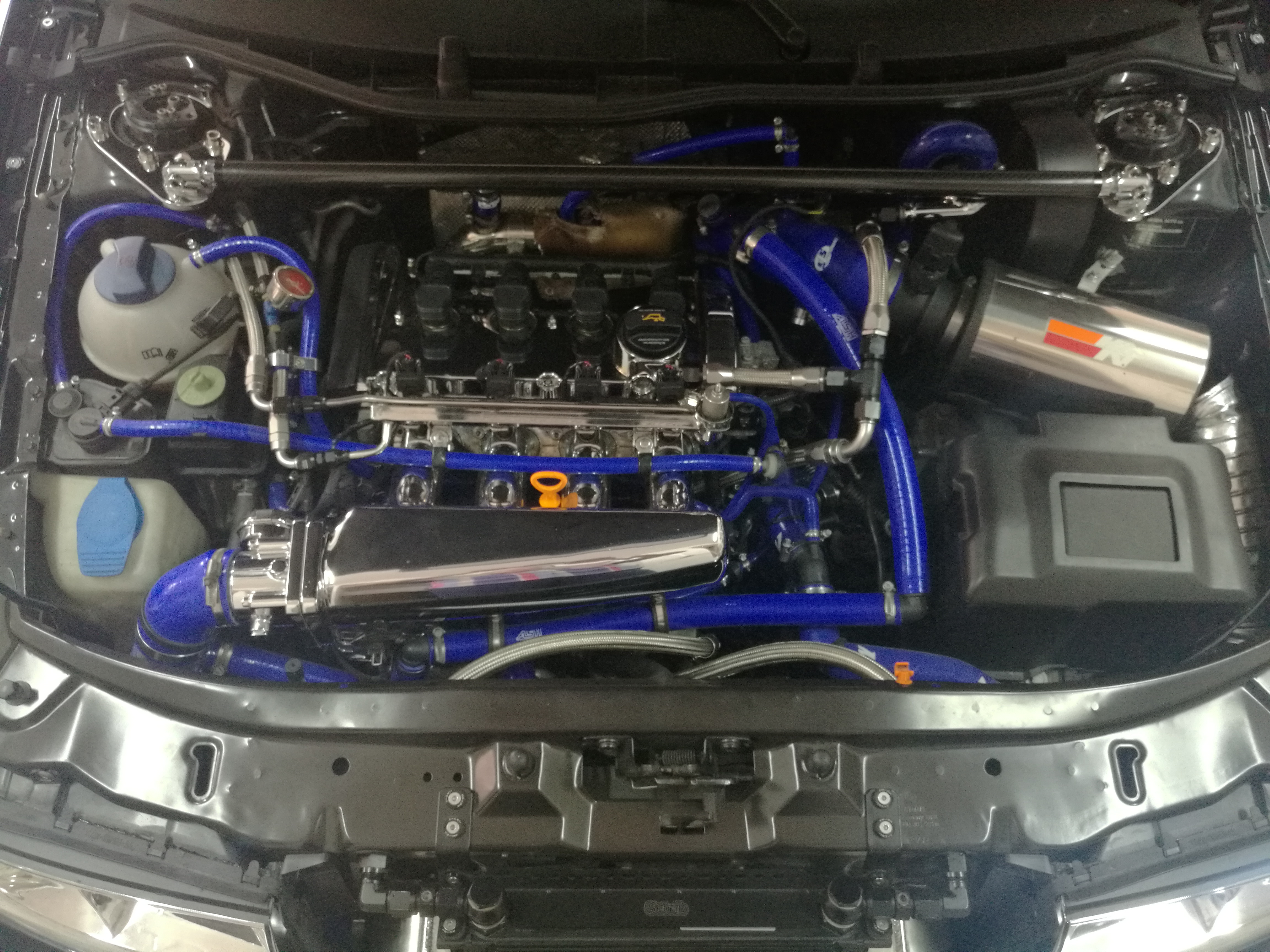

And yes whole engine bay is chrome plated from bottom to top
