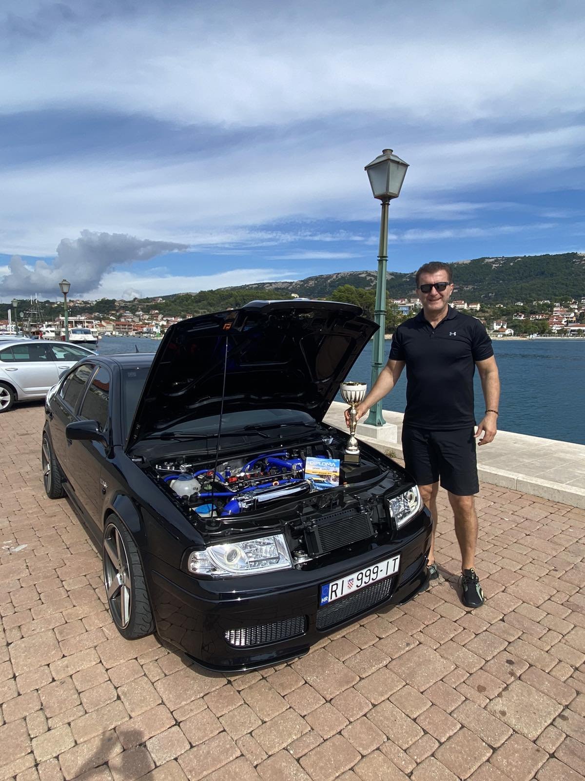

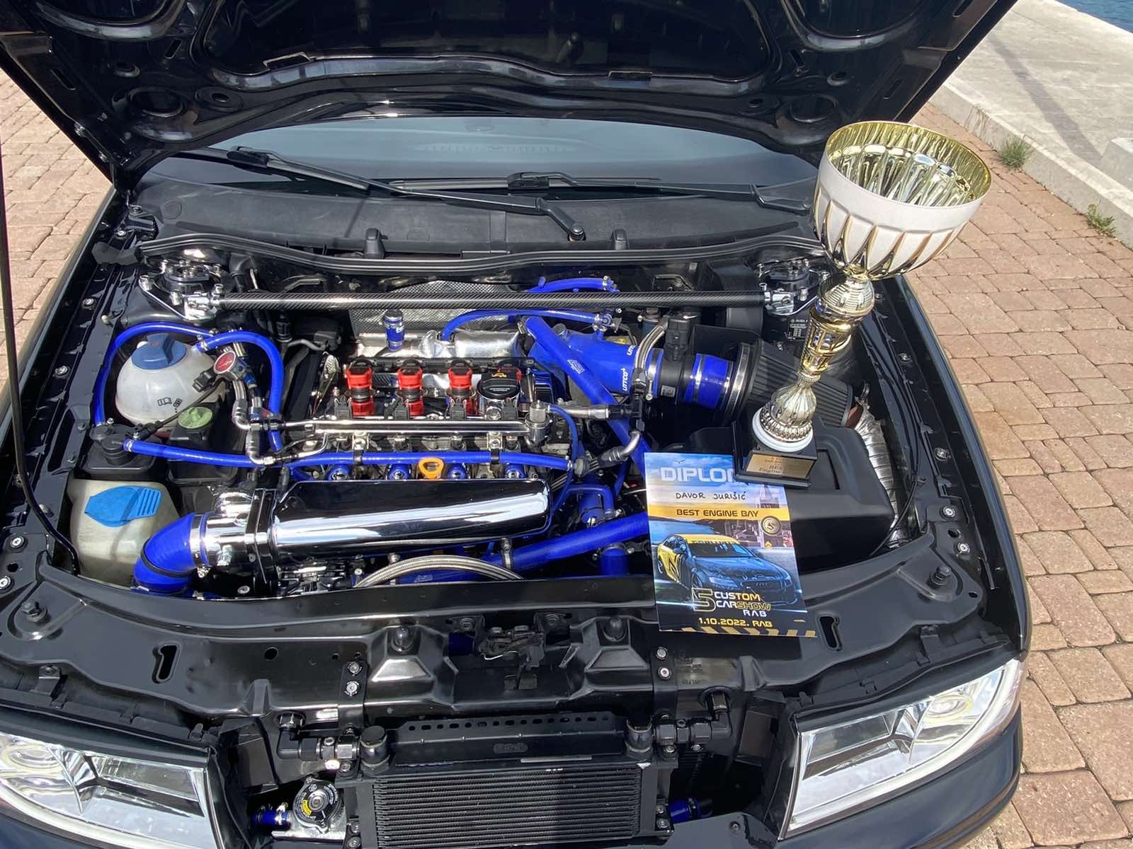

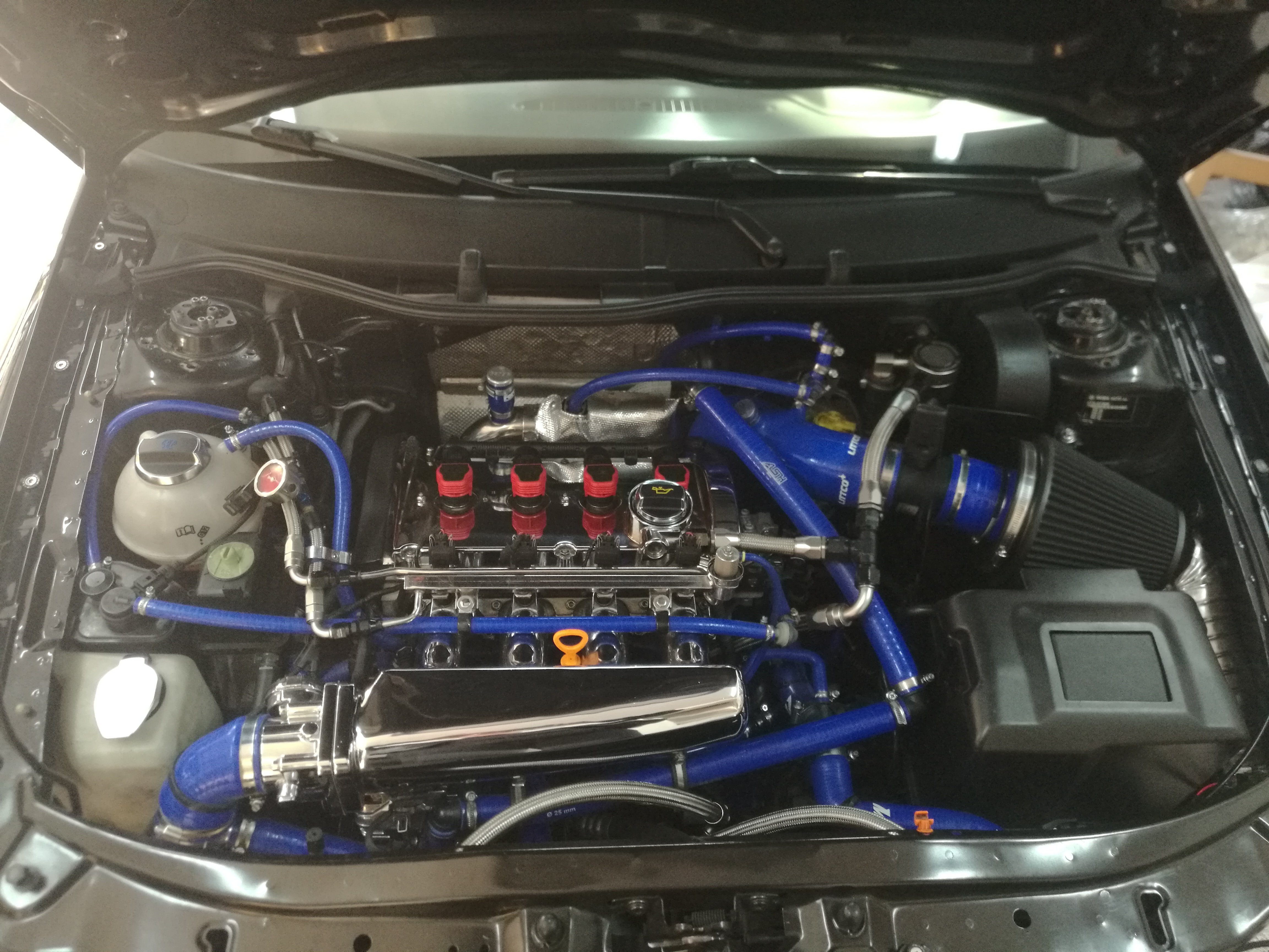

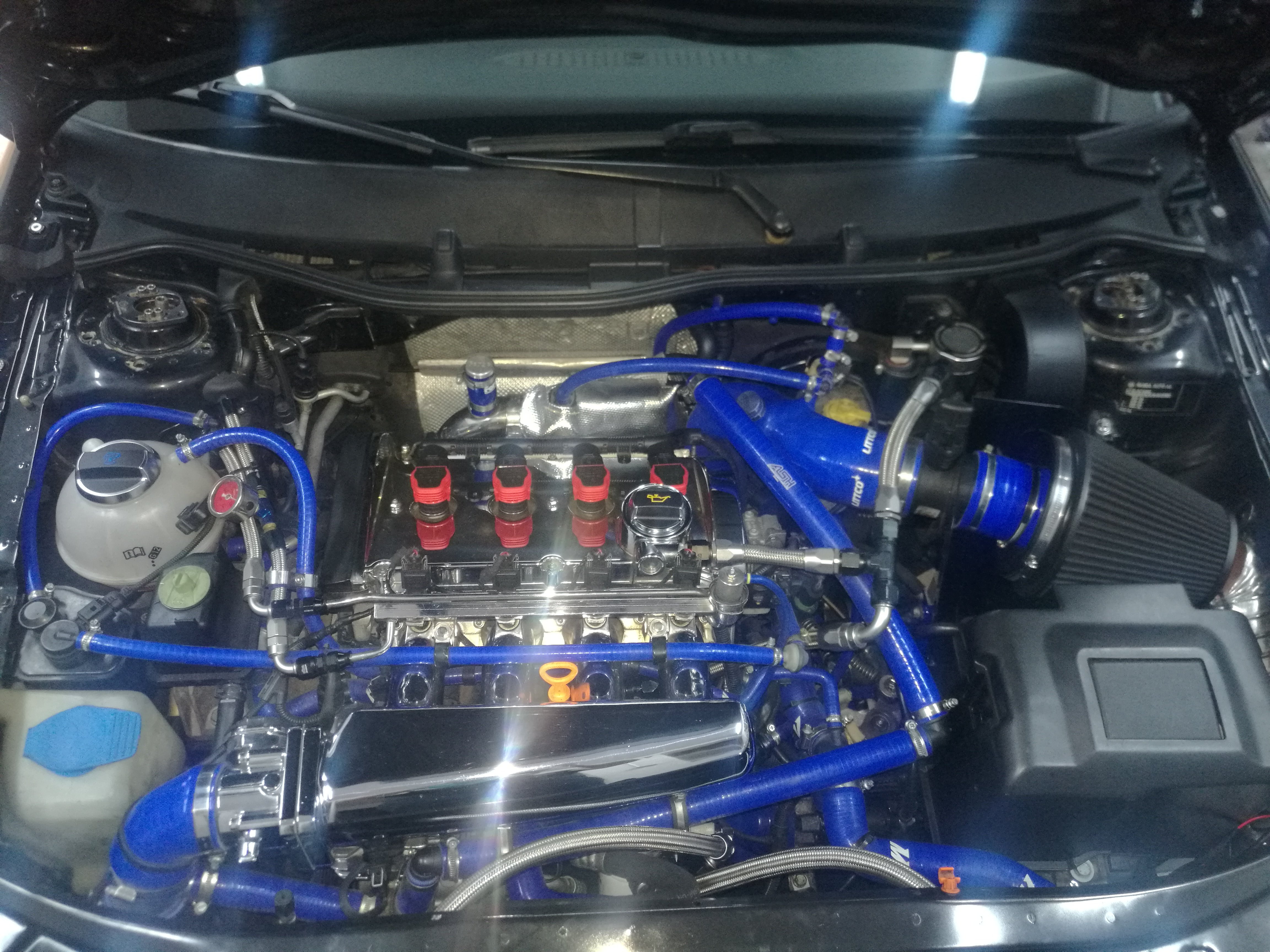

Second time on Island Rab BEST ENGINE BAY on 5th TUNING CREW RAB SHOW.
Honestly she was by far most completelly tuned car in every segment and quality of work done so far away from the rest, most of them are only for watching from distance of 5 and more meters😉😉

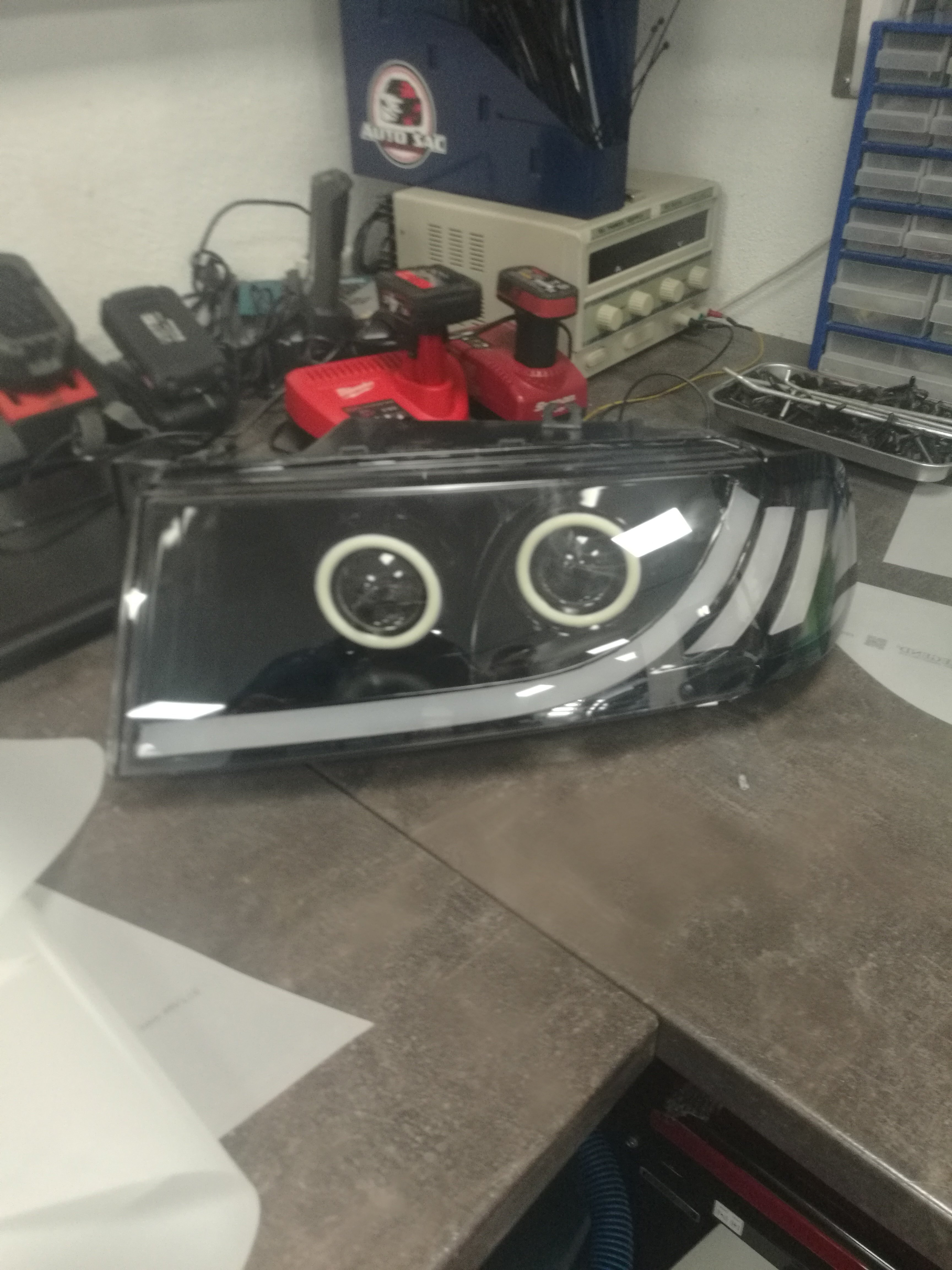

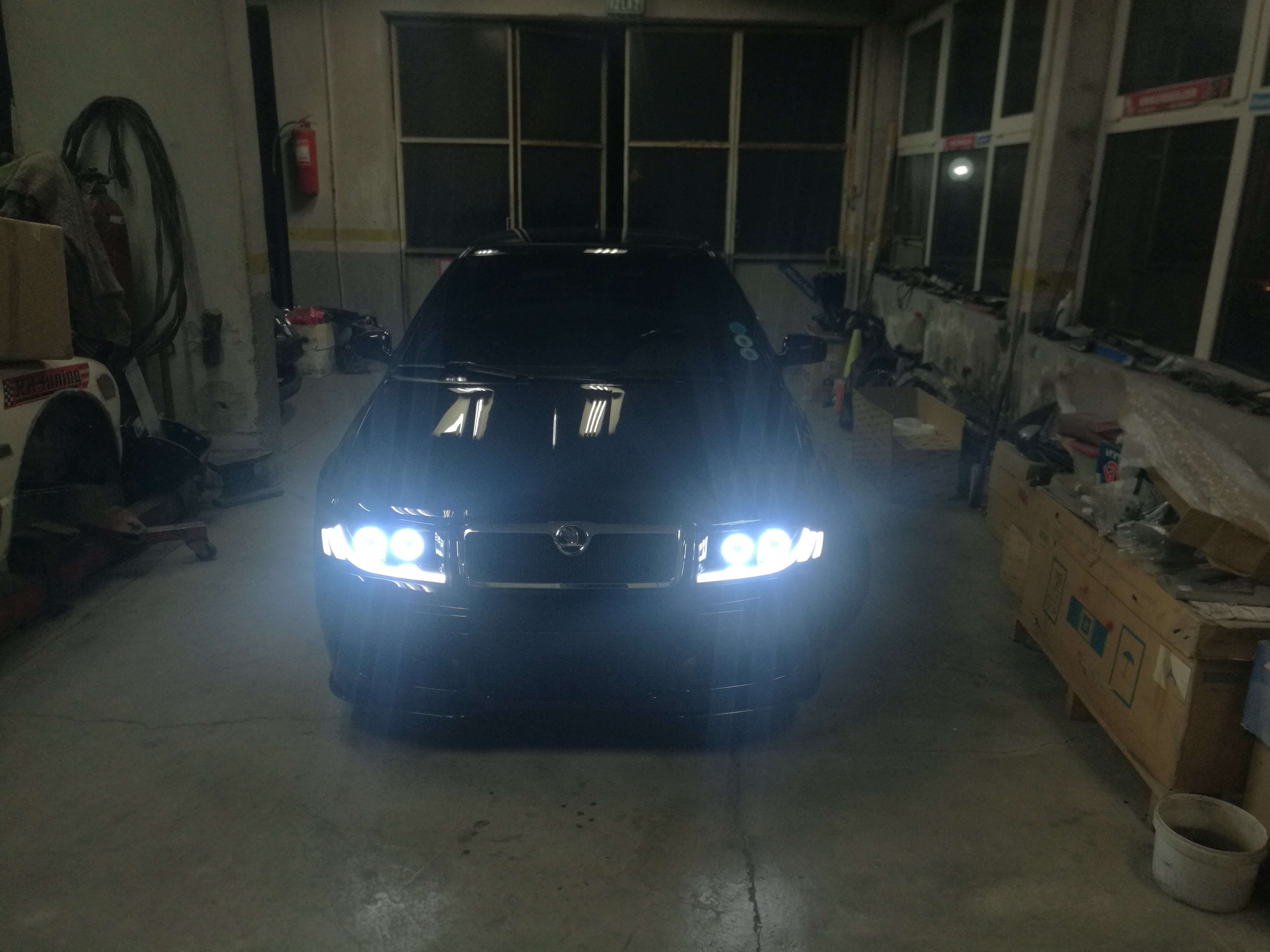

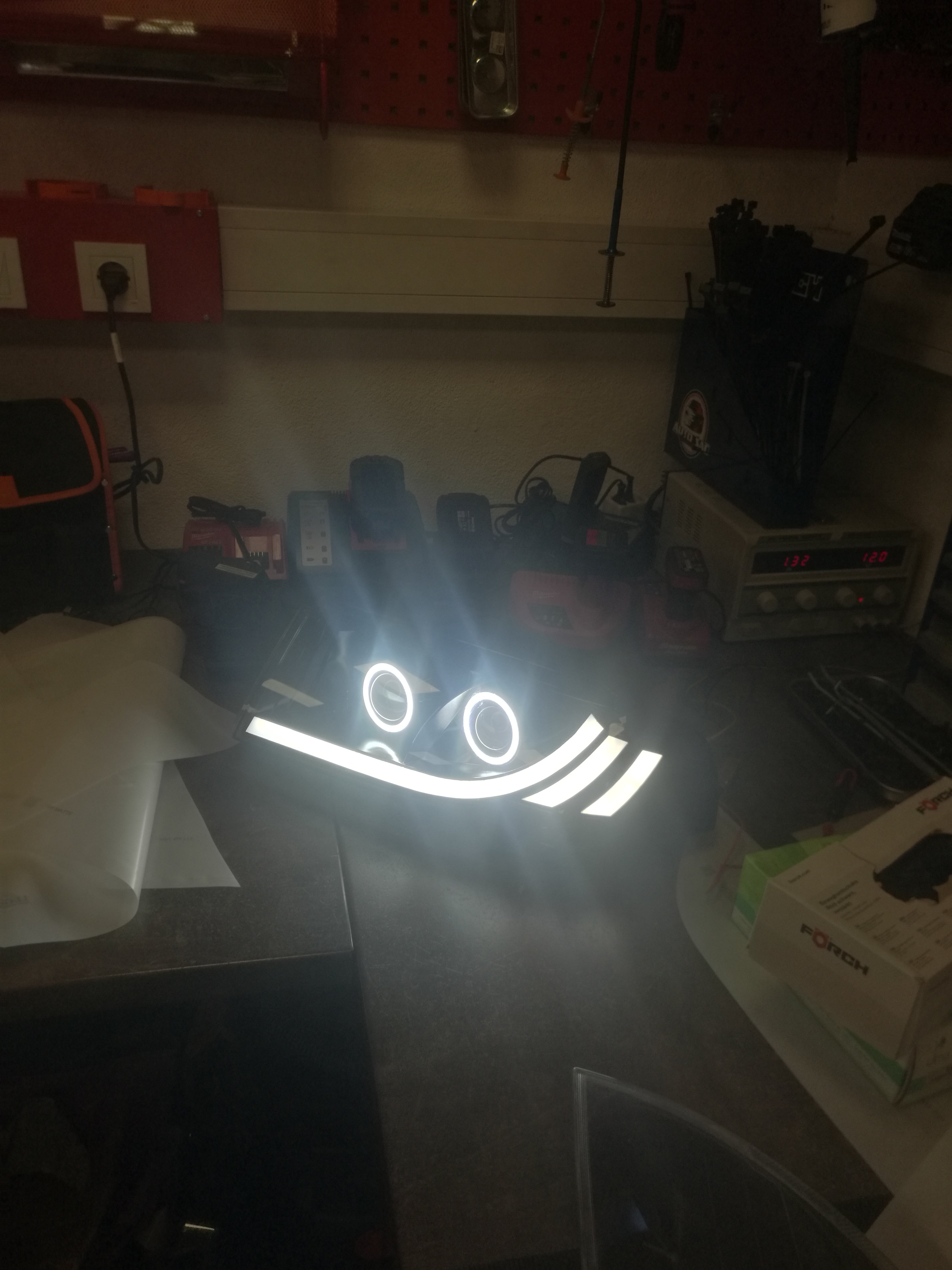

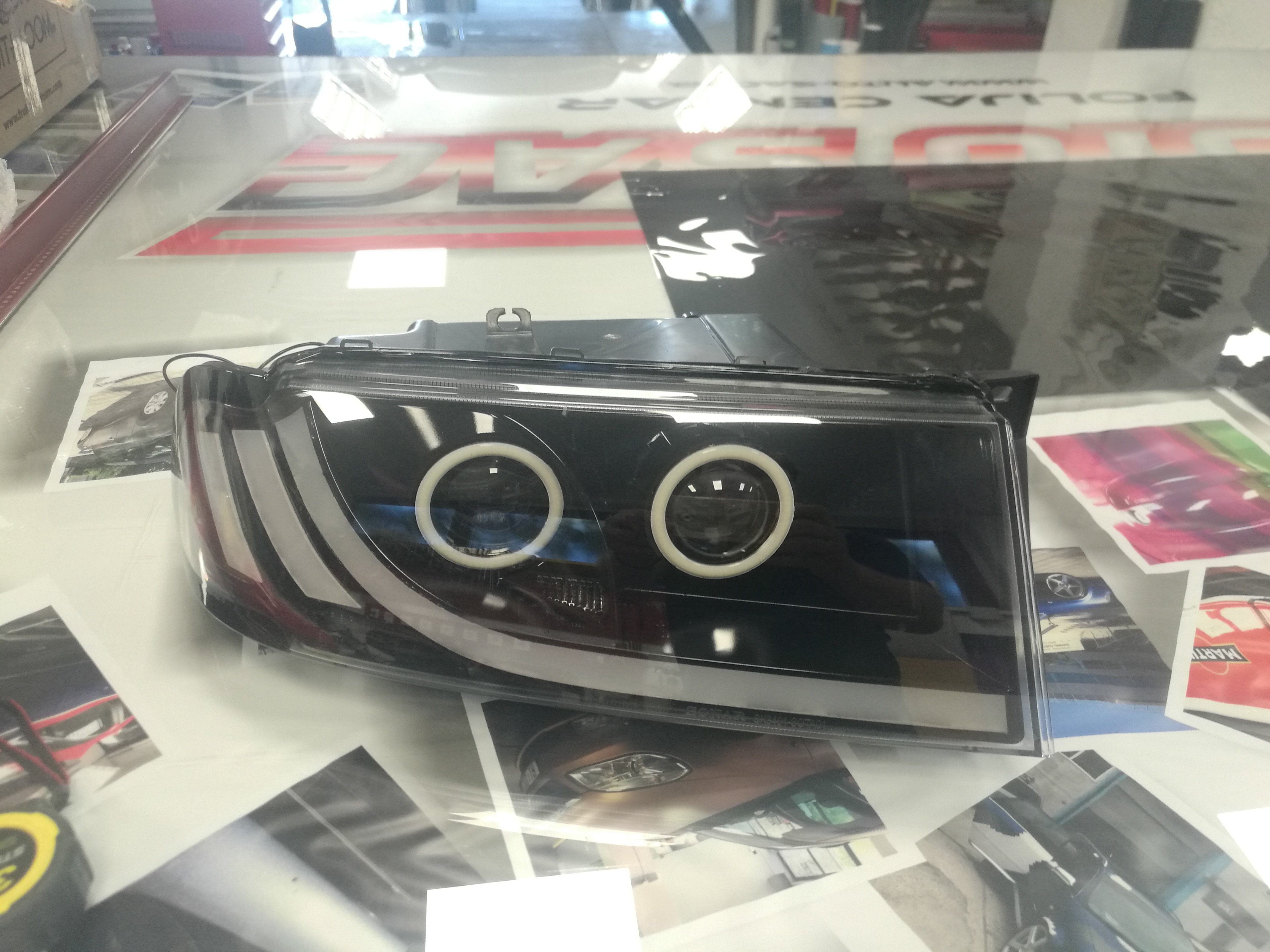

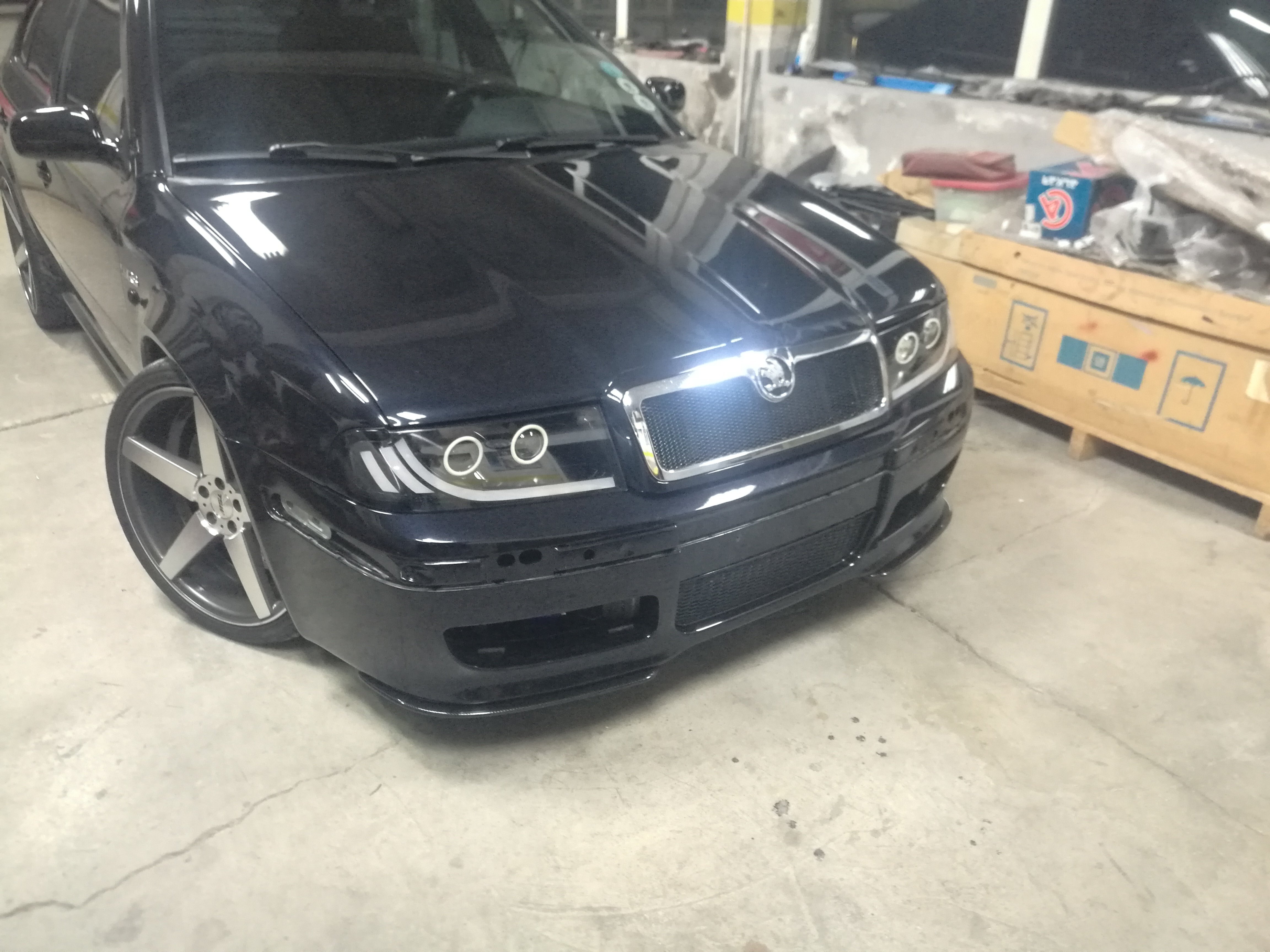

Headlights finally in my hands. Looking great and bright white 6000k. Left at shop for selfhealing PPF before installation next week.IMG_20221018_150259.jpg
Edited by davojuri
hurry up need to see them fitted 😁

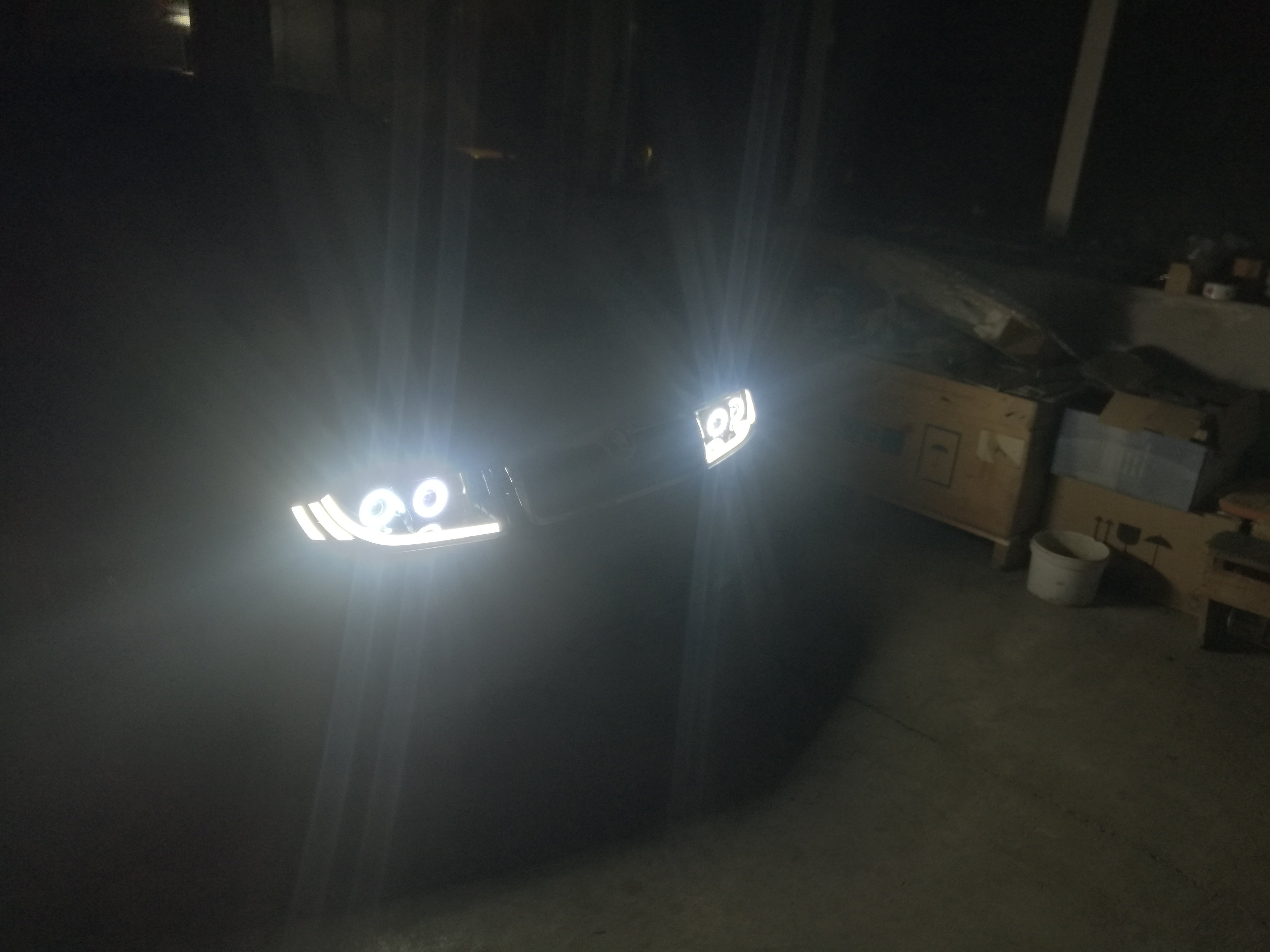

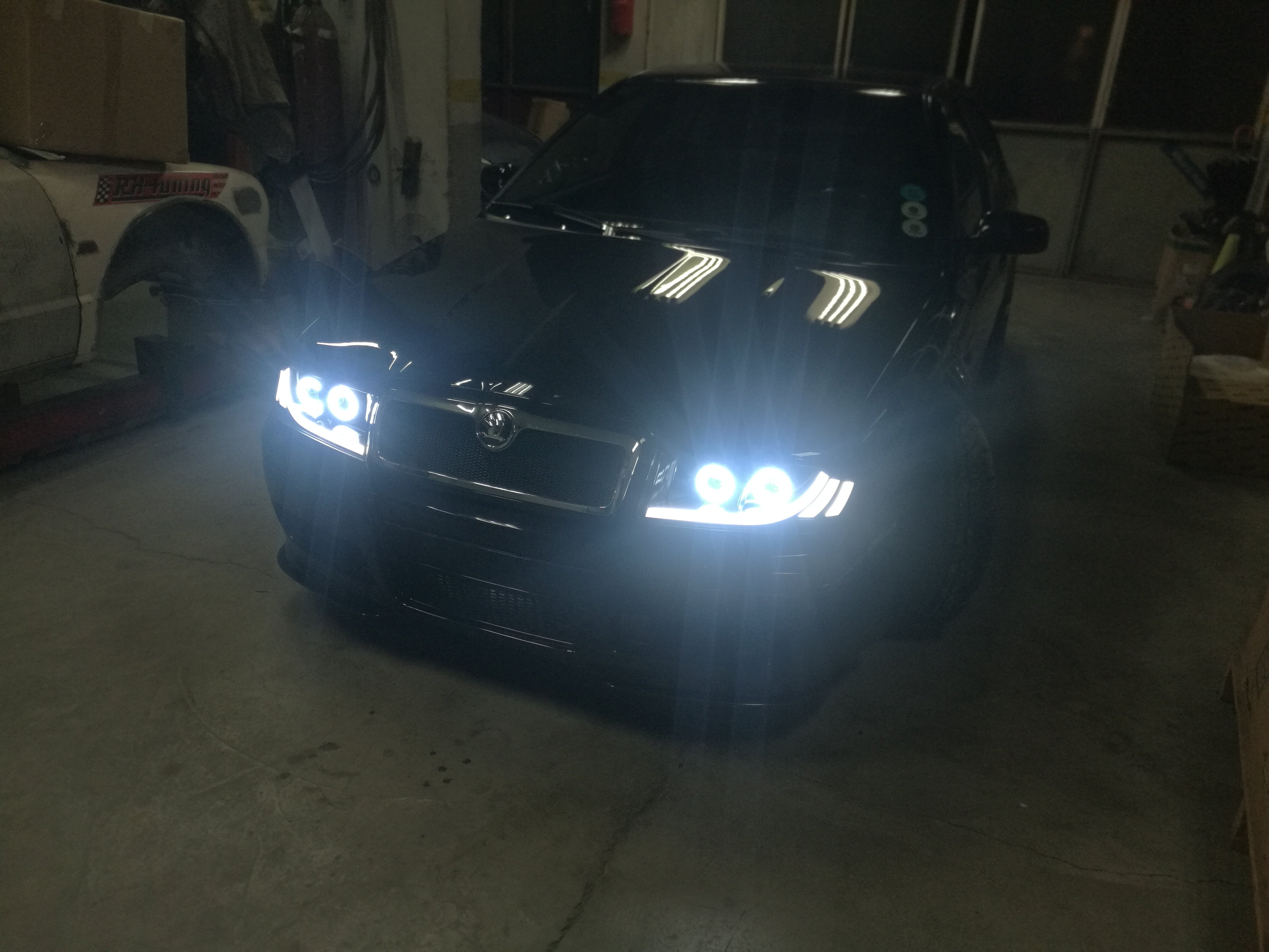

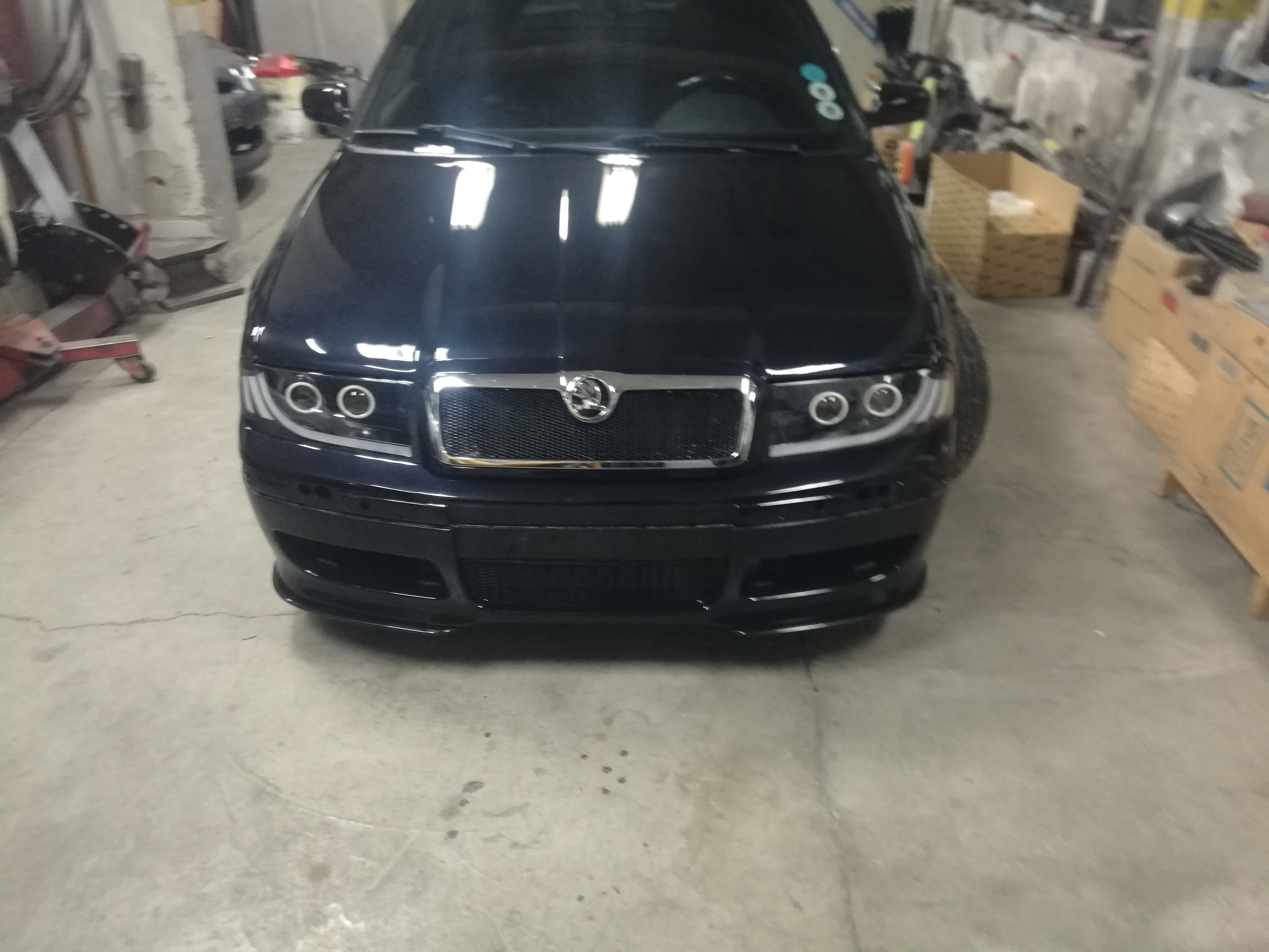

Finally installed

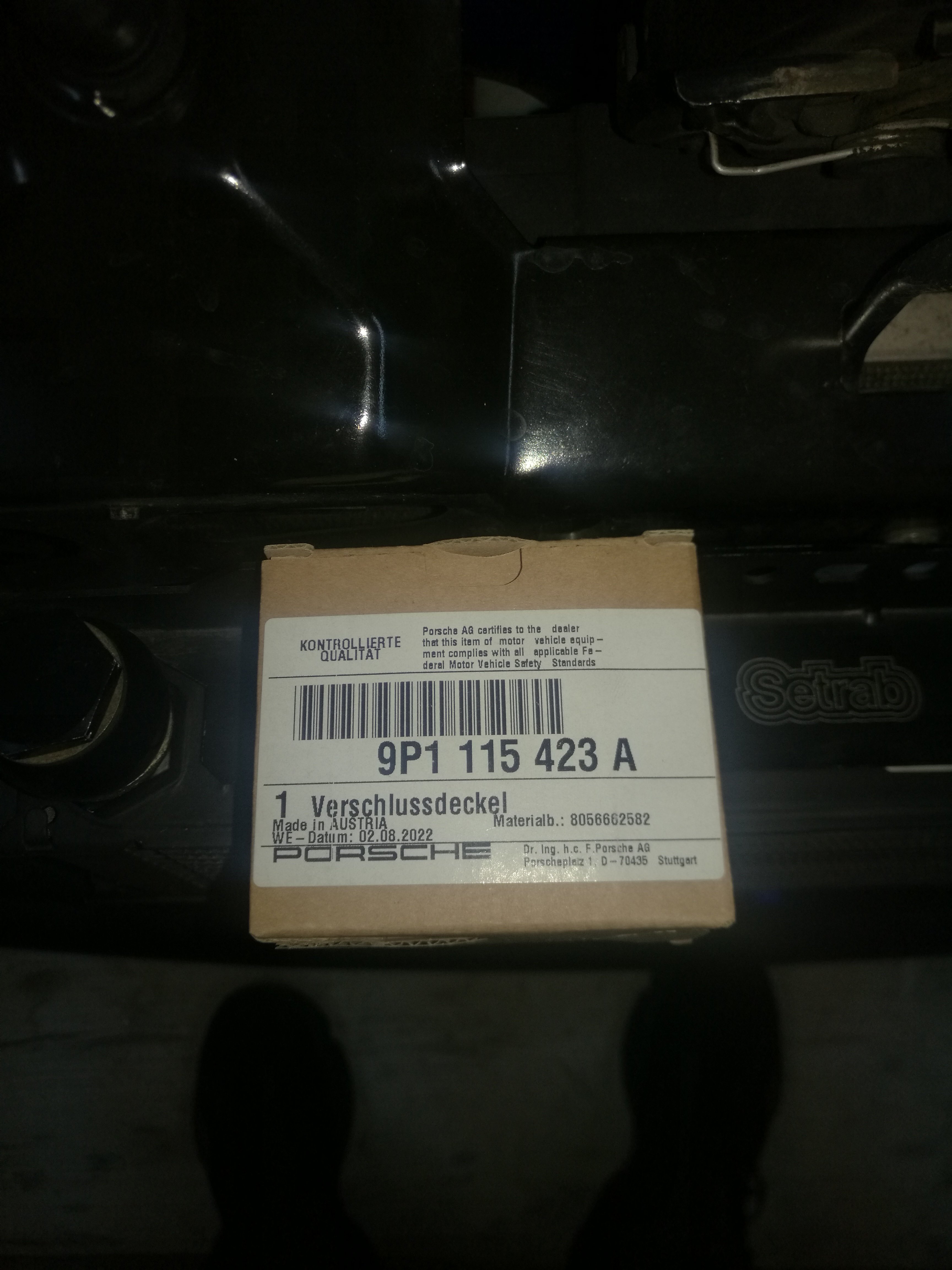

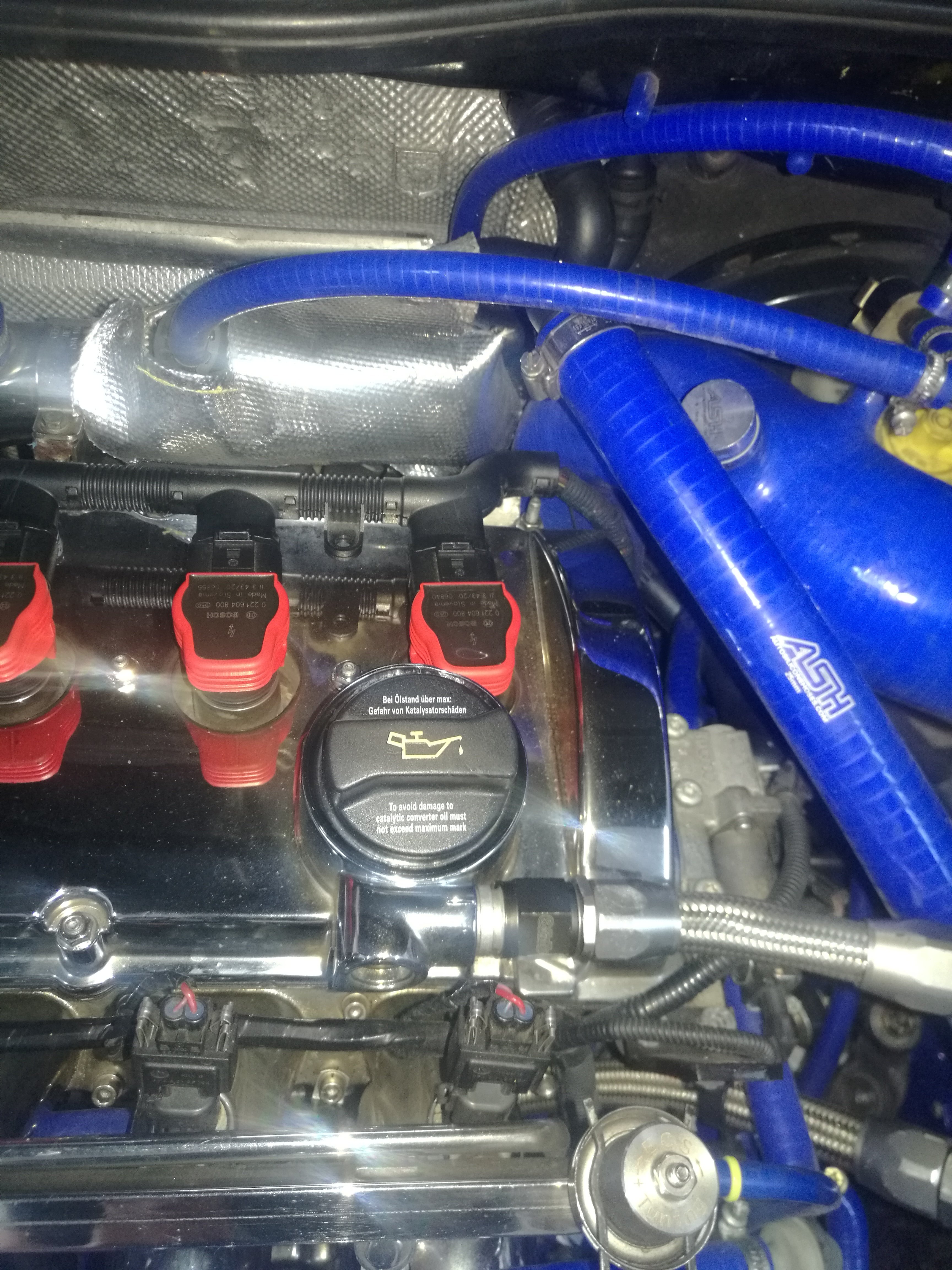

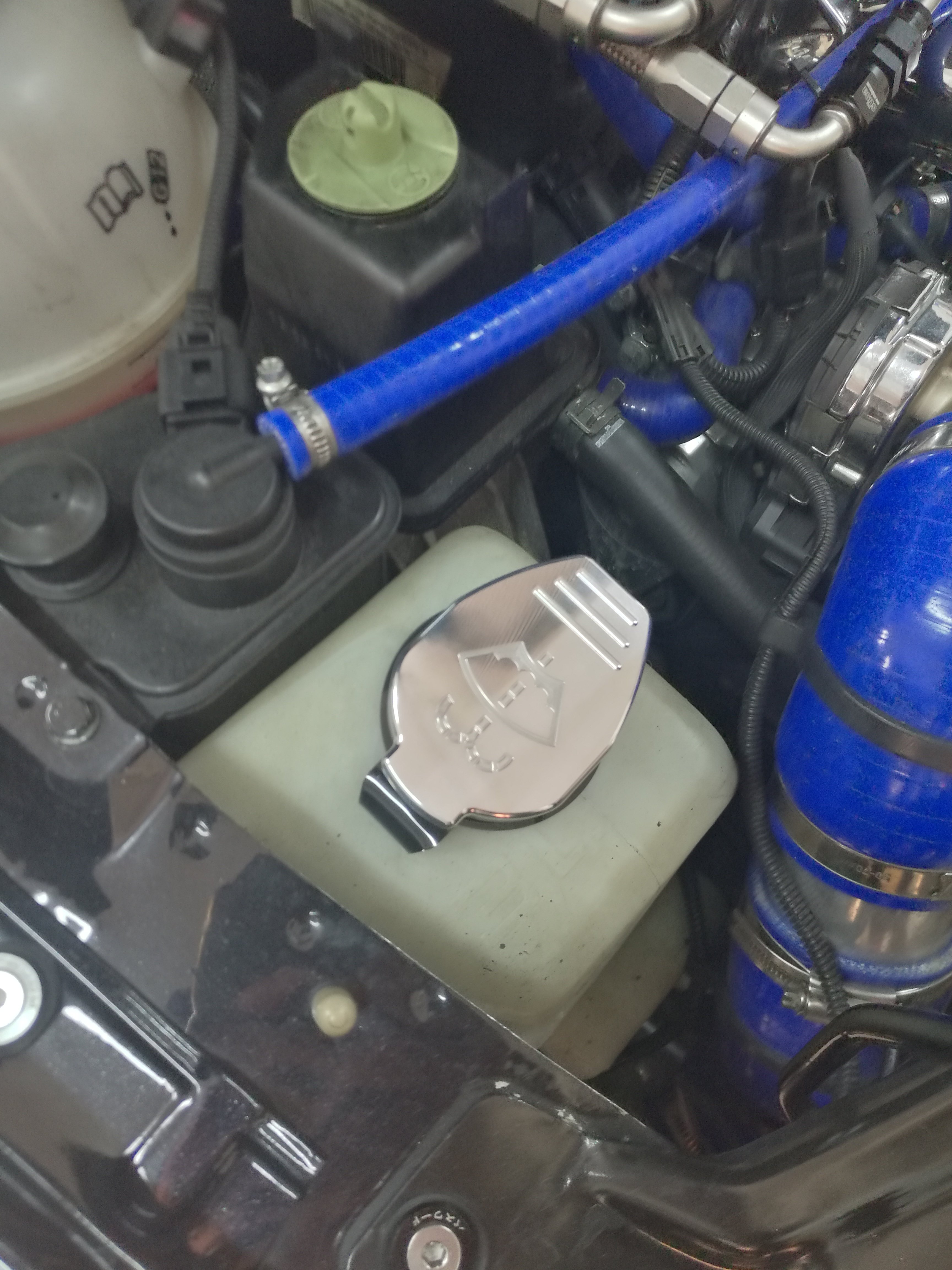

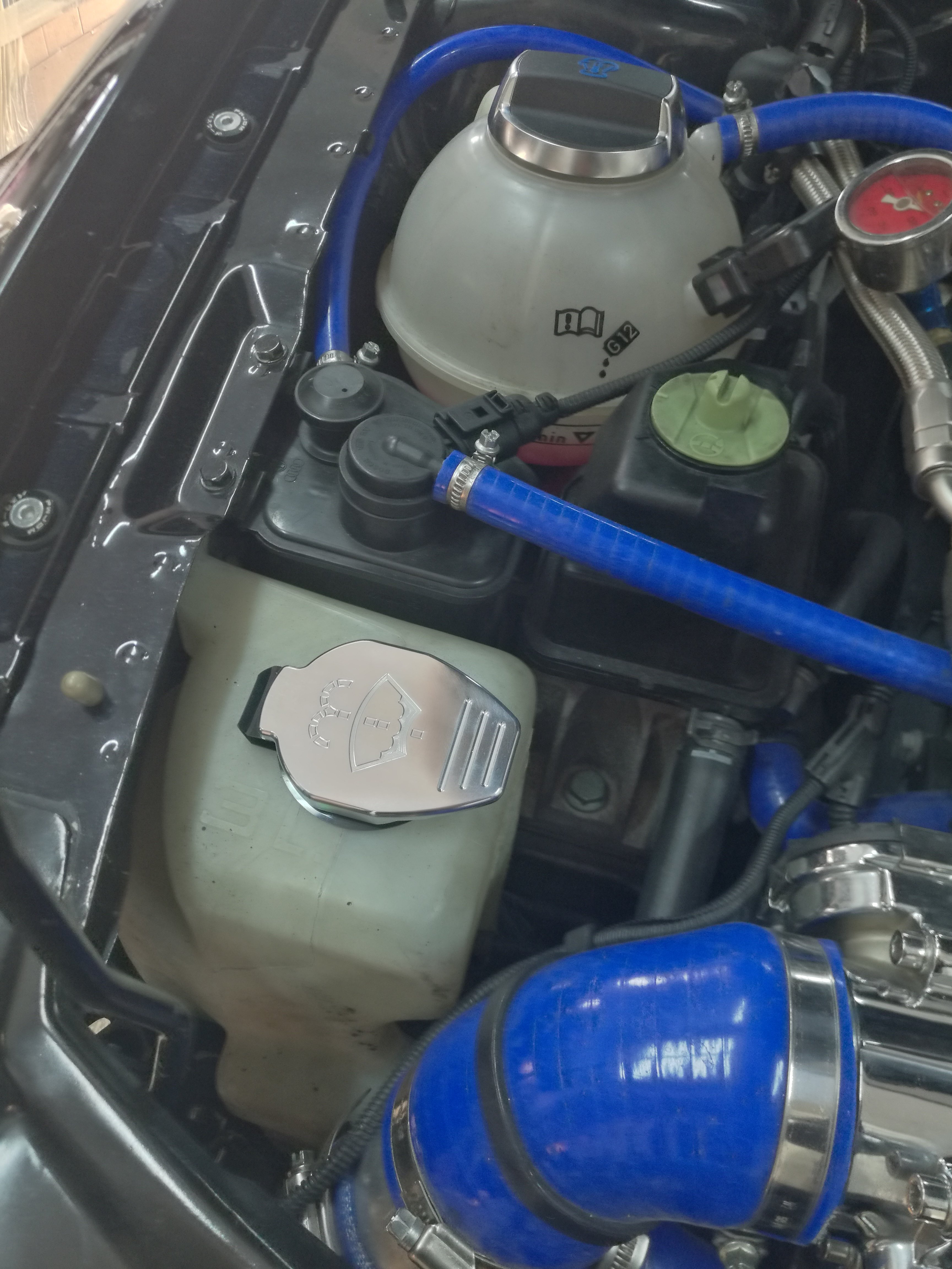

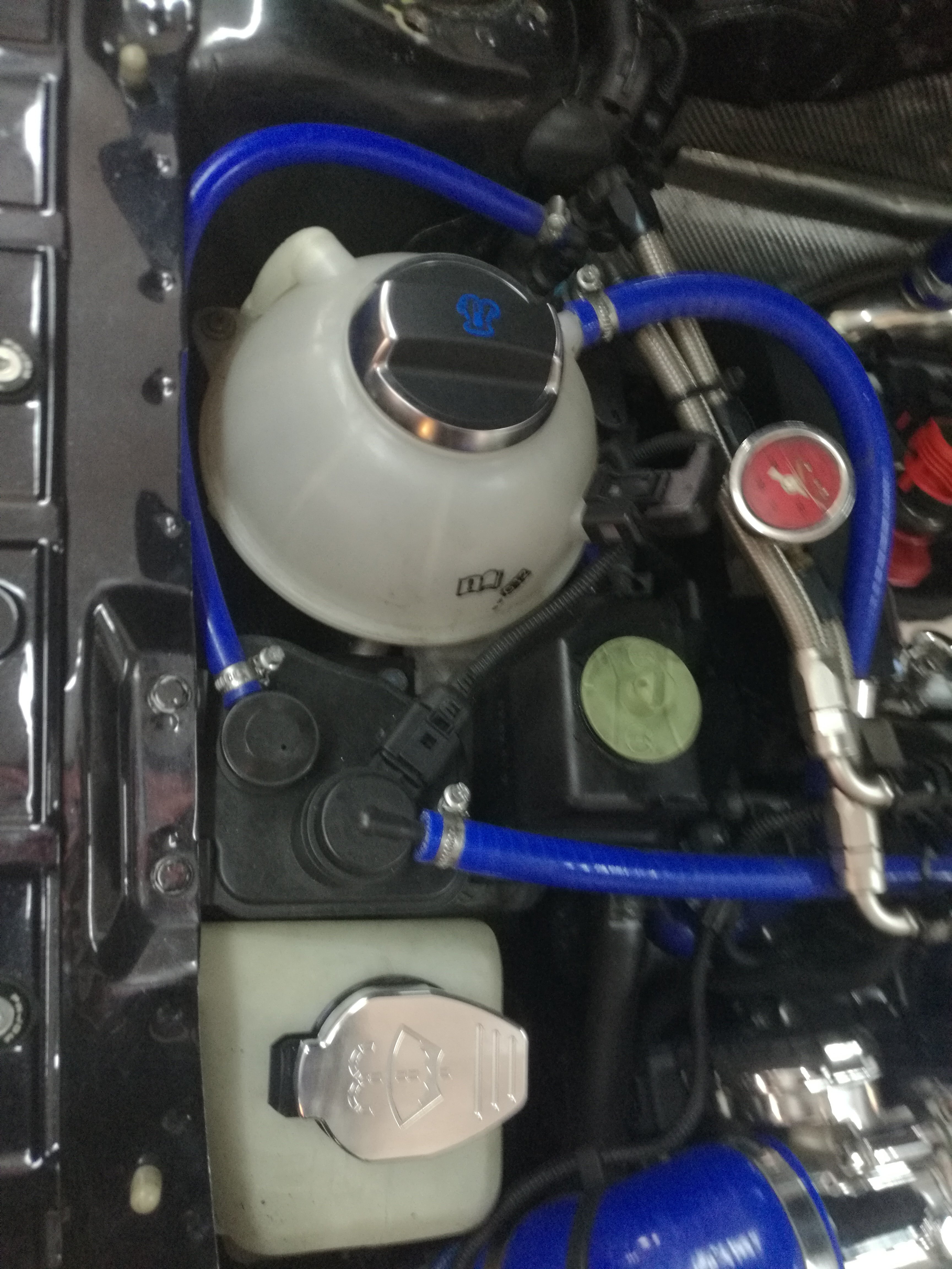

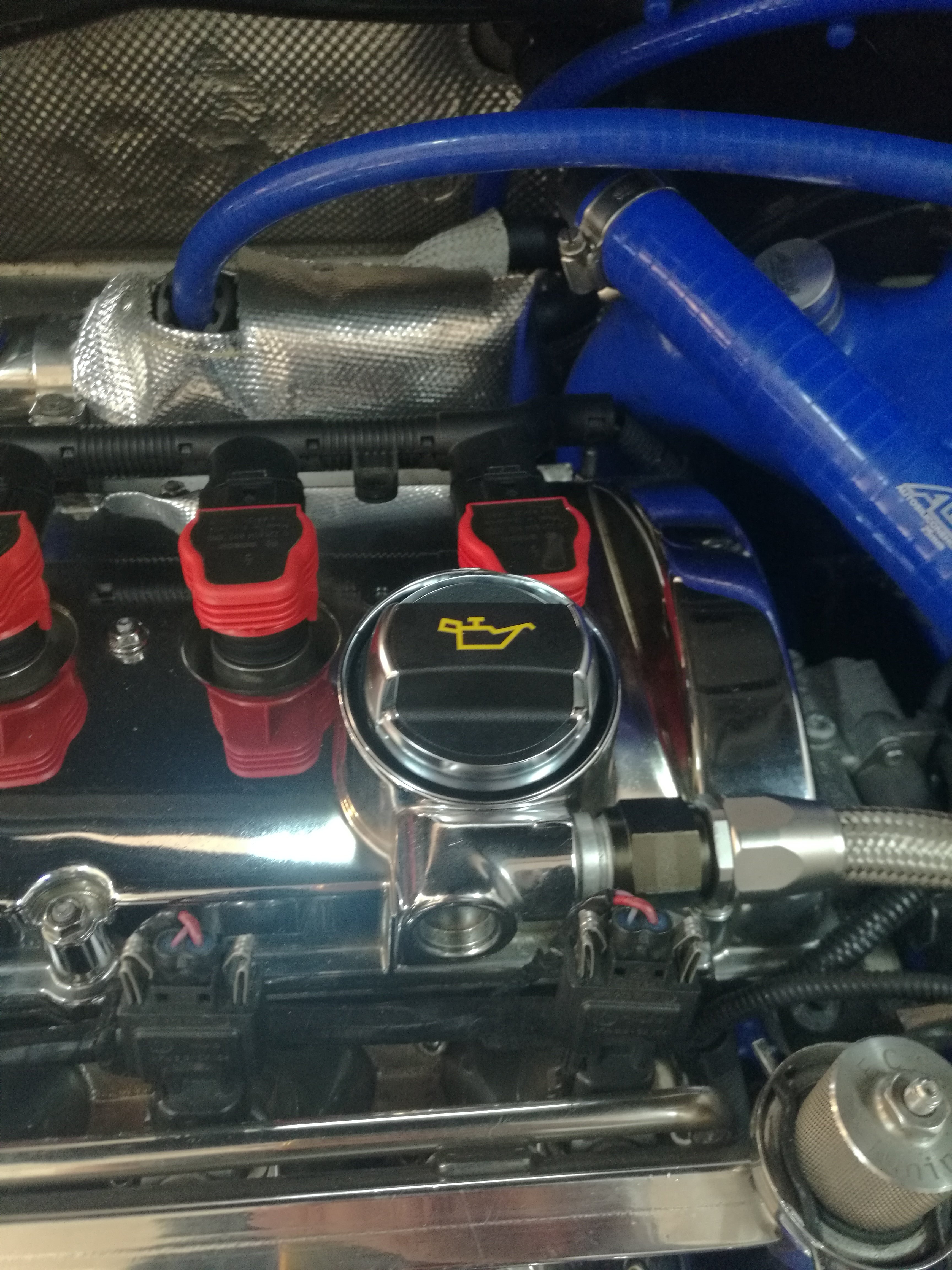

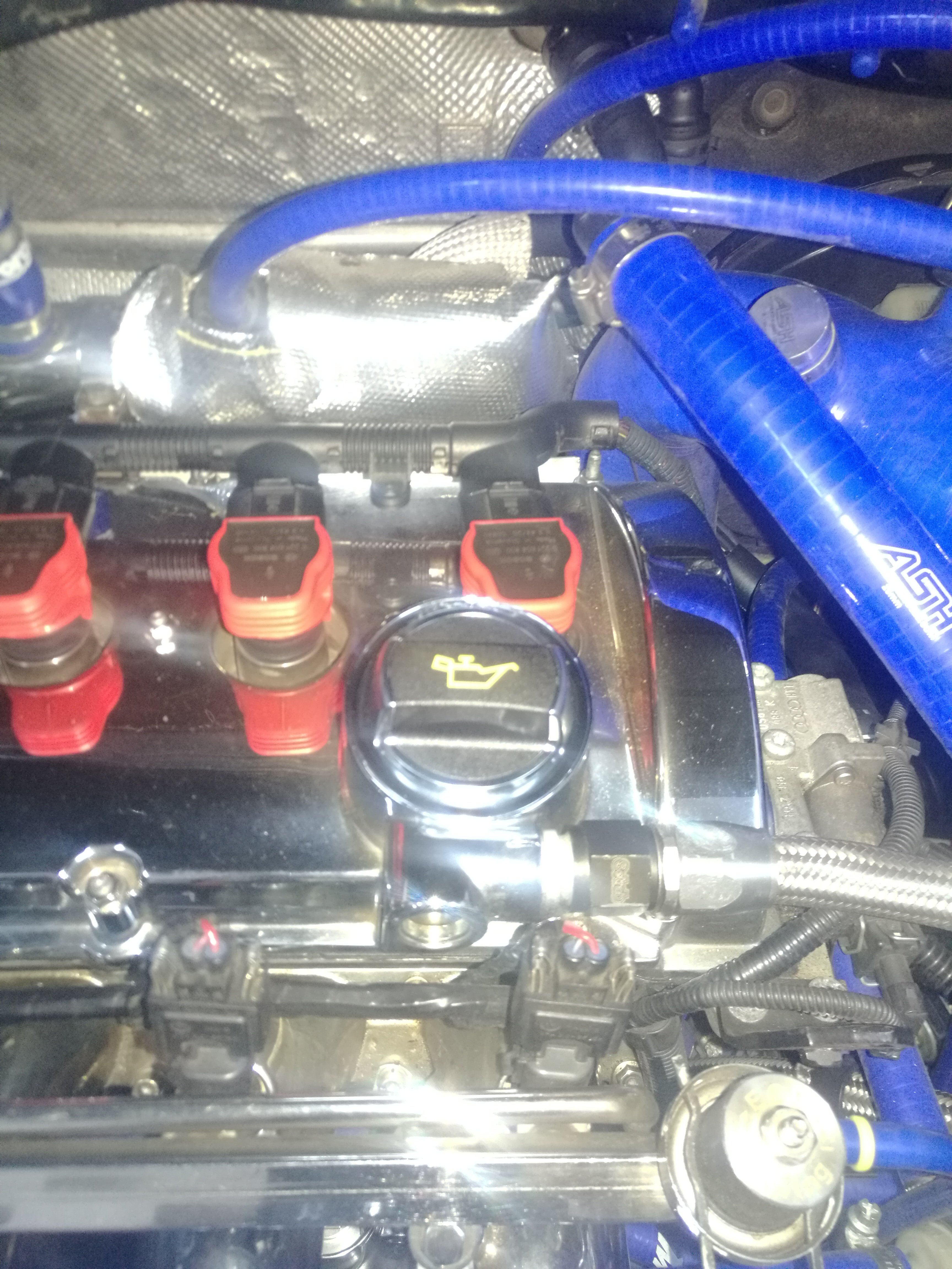

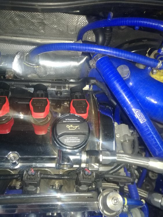

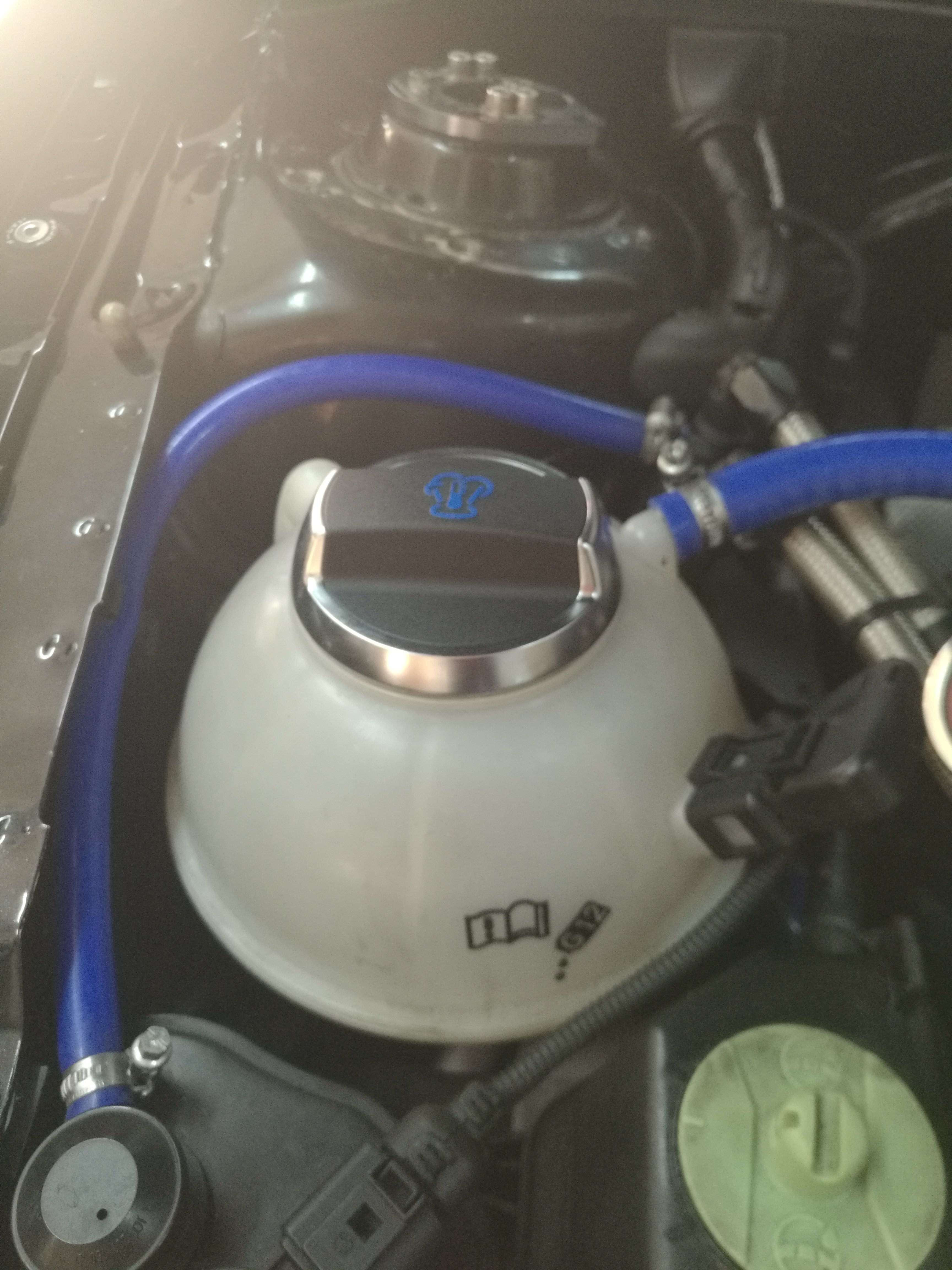

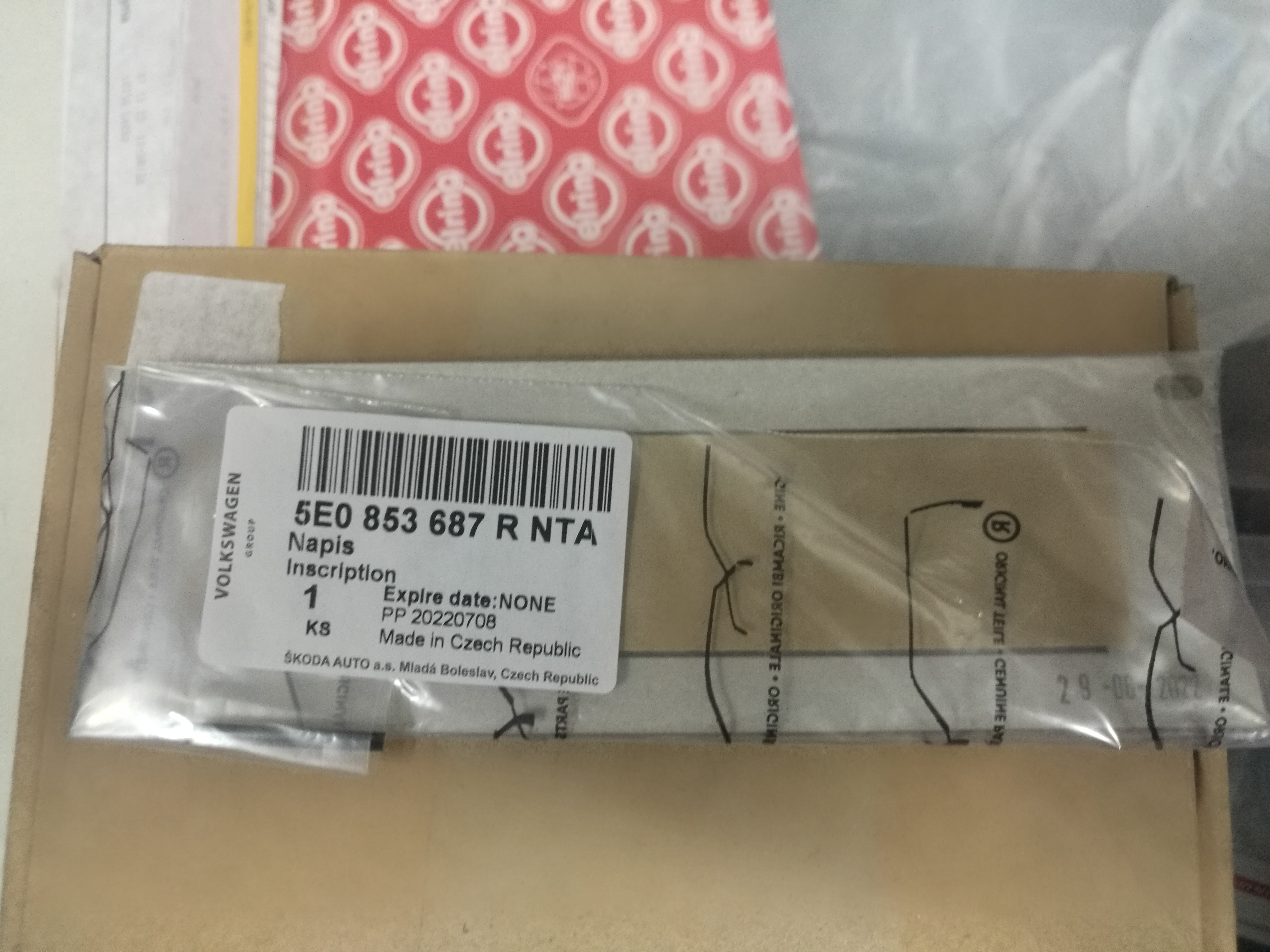

Some Porsche godies installed-oil and coolant cap. They look much better than R8 ones.IMG_20221108_153707.thumb.jpg.db73db6b4a588cb1cc09b3c020a3d3e3.jpg

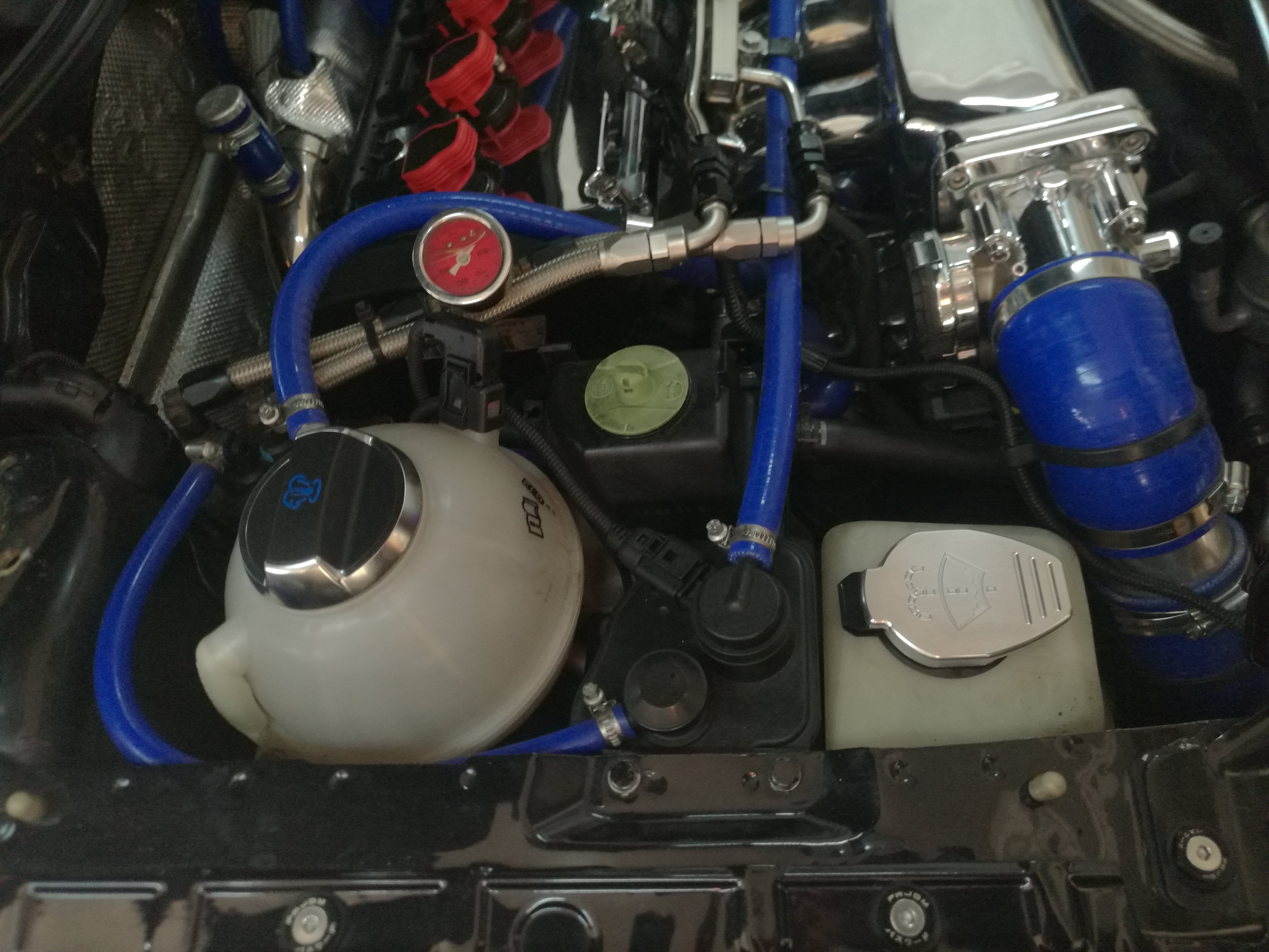

Some more bling bling stuff. JCAPS billet washer bottle cap. Perfect fit. Now only missing JCAPS billet servo pump cap to complete it.
Edited by davojuri

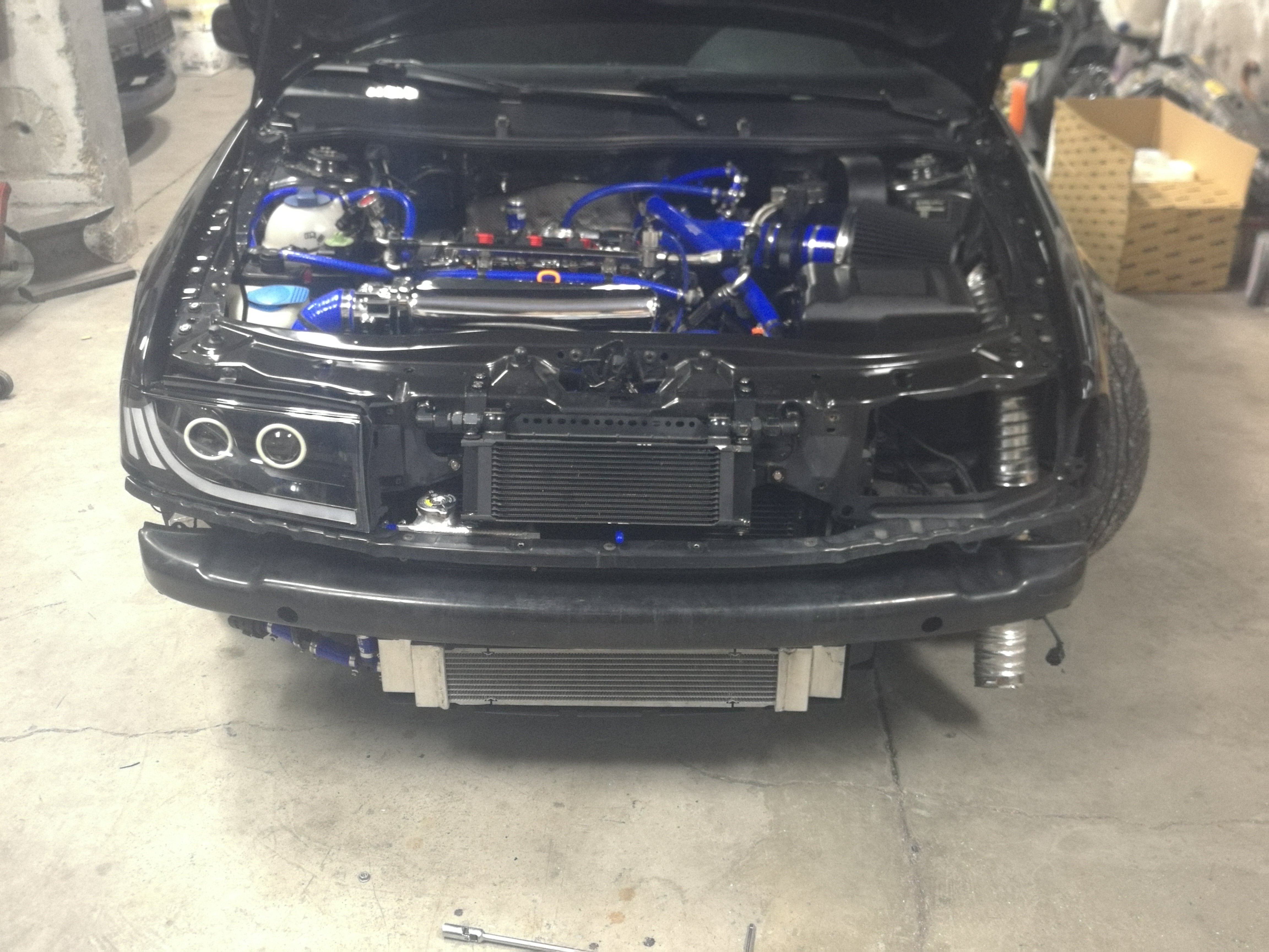

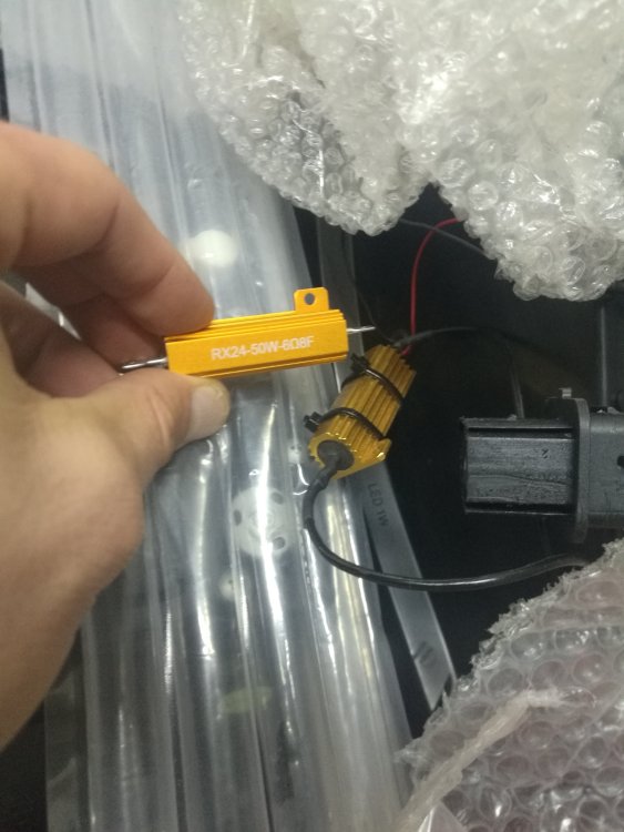

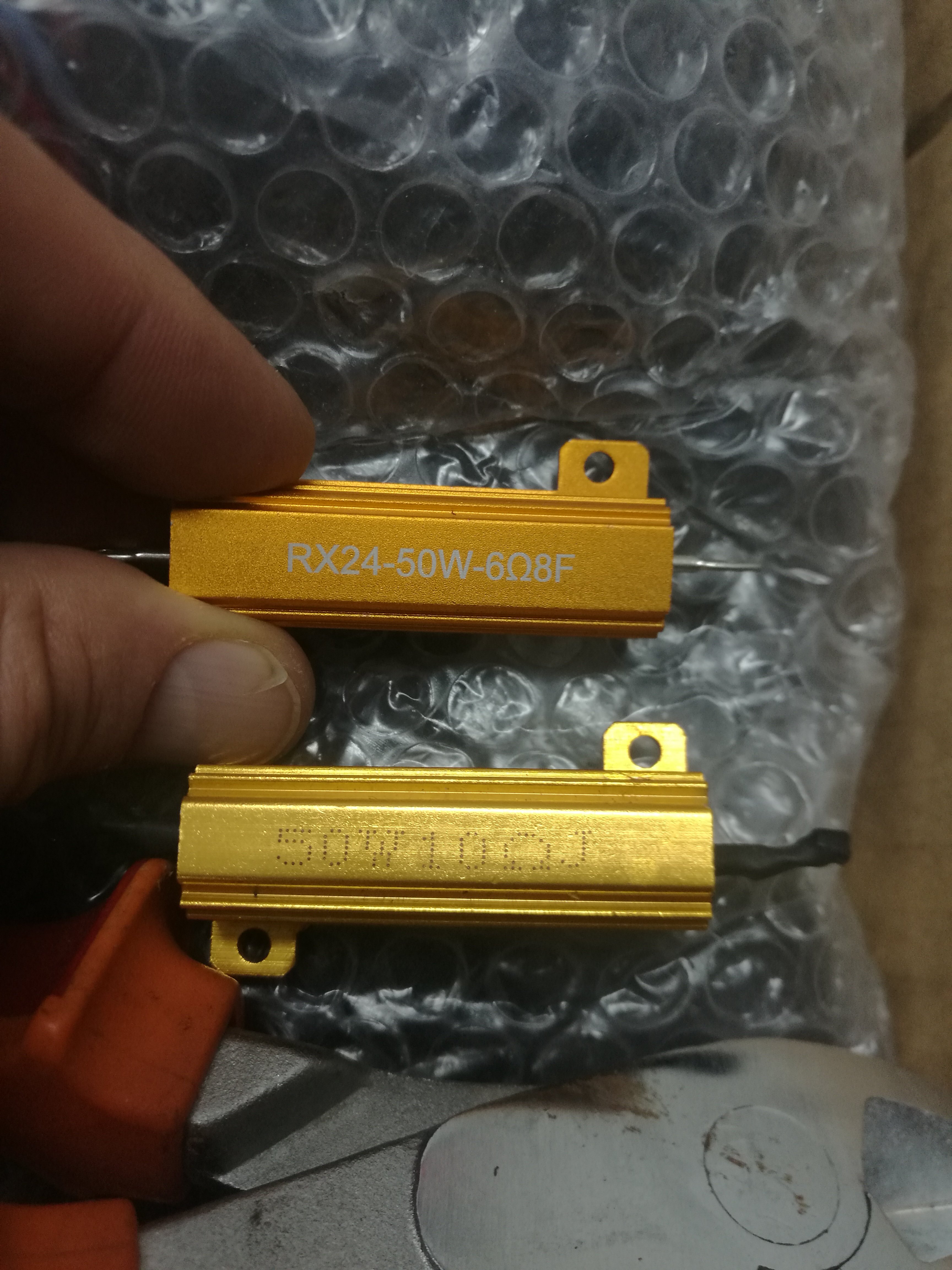

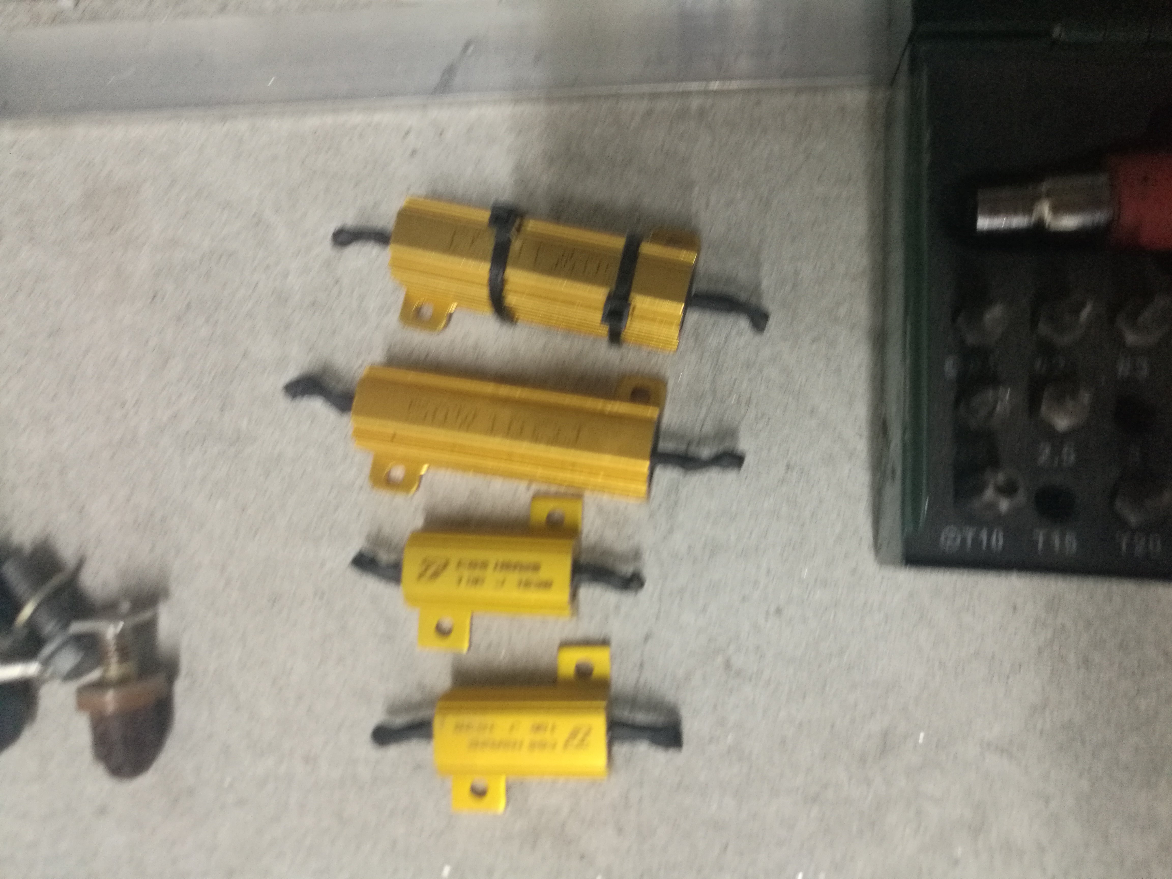

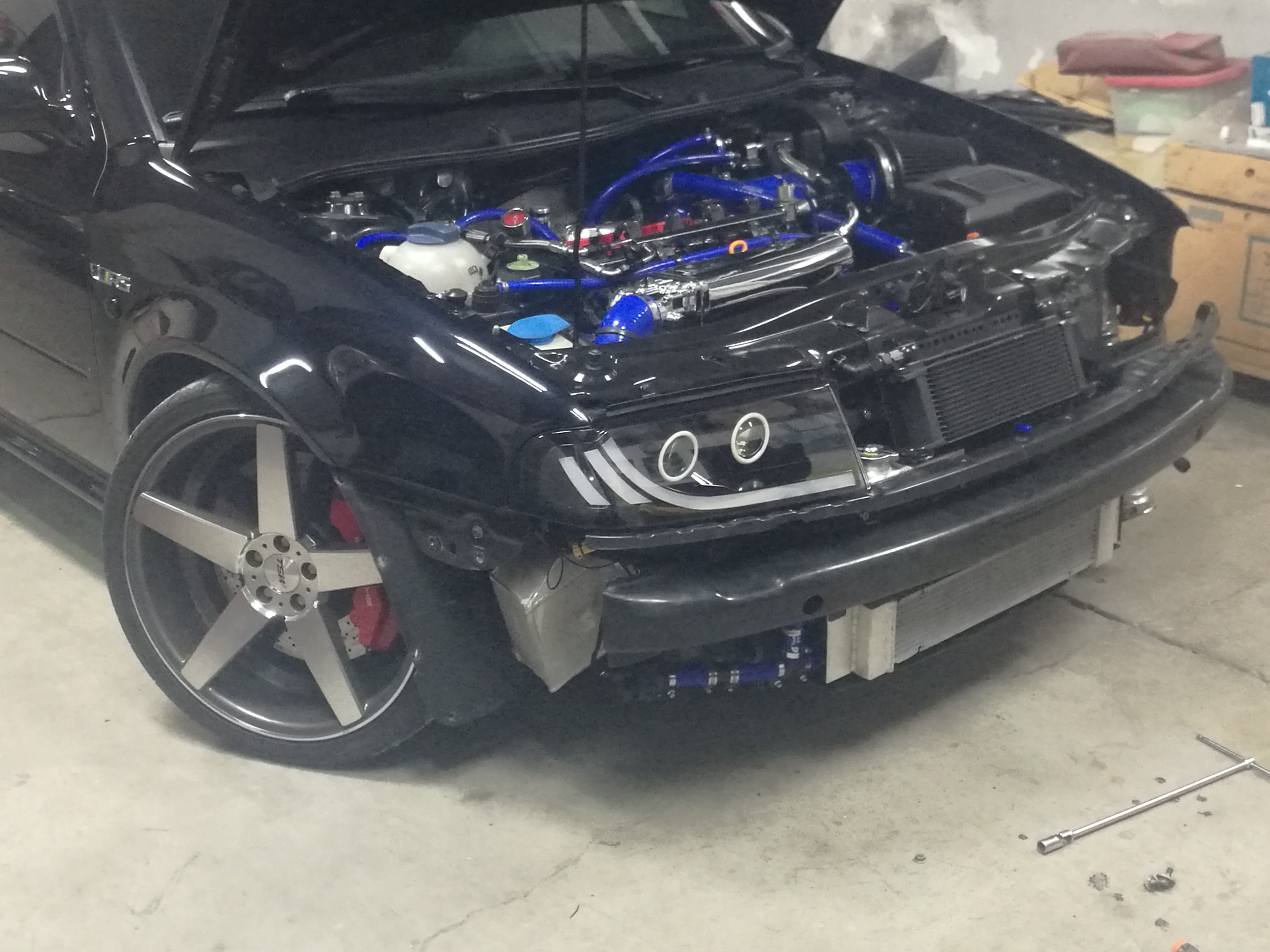

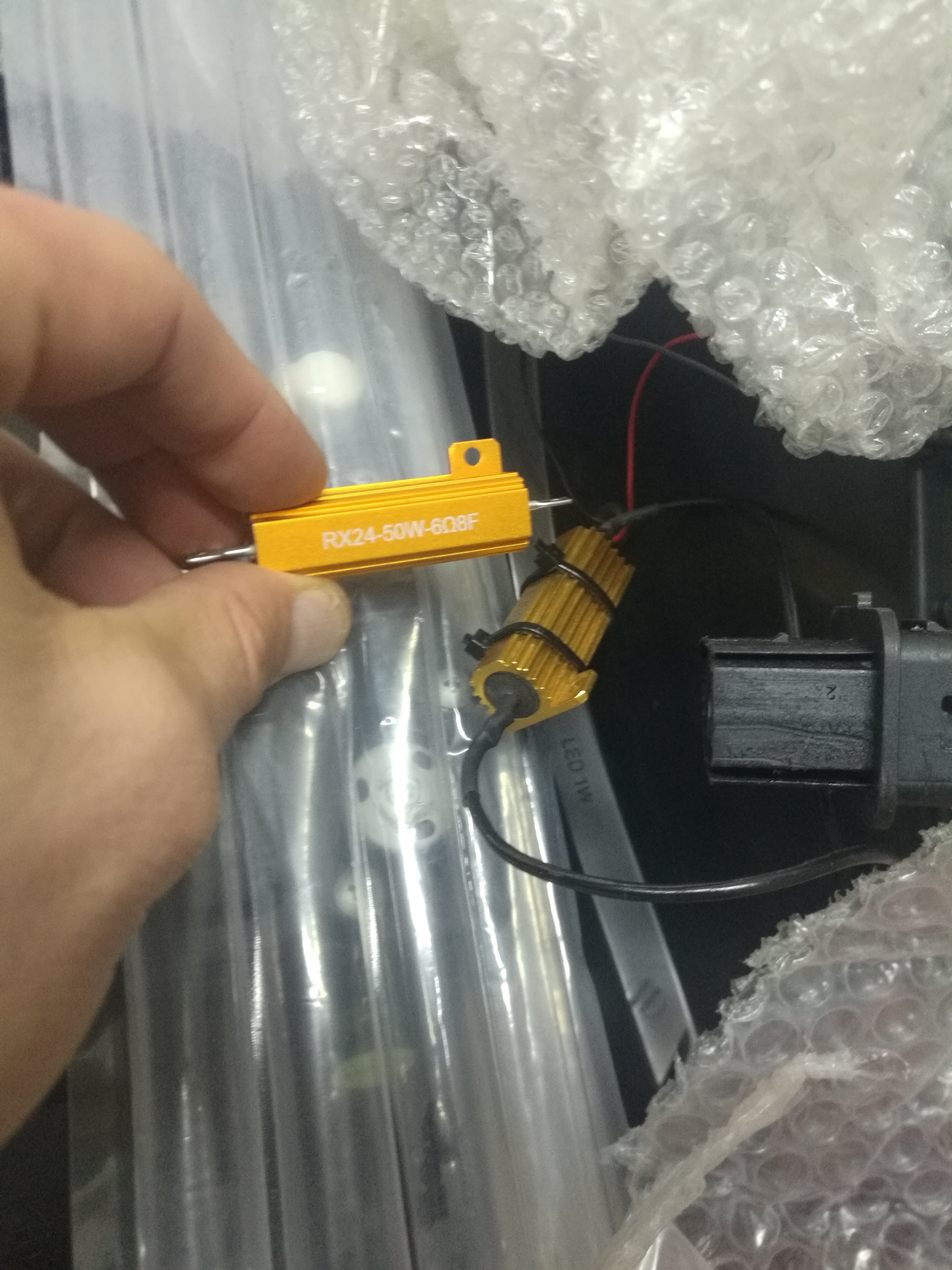

Had quite a few problems with new led headlights.

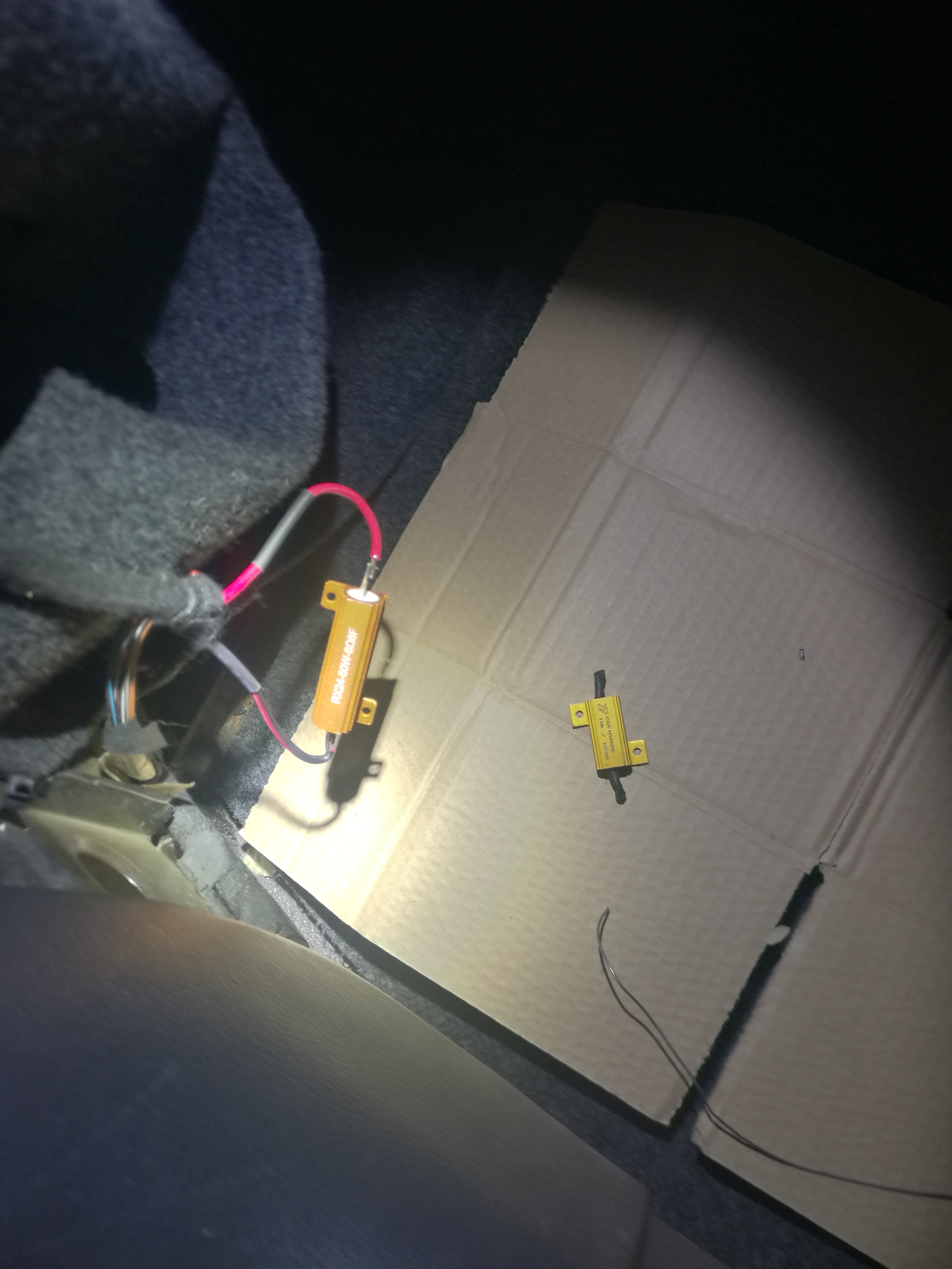

Turn signals were to fast, so i wisoted guy who works at Rimac Bugatti, and who previously installed my Color MFA, and he measured resistsnce so we had to change all front and rear resistors for 6 ohm 50 wat. And now turn signals are working great. He dealt also with driver long light not turning on, now both are working and I can finally asdrmblly them and front bumper back in  place. So happyyyyy

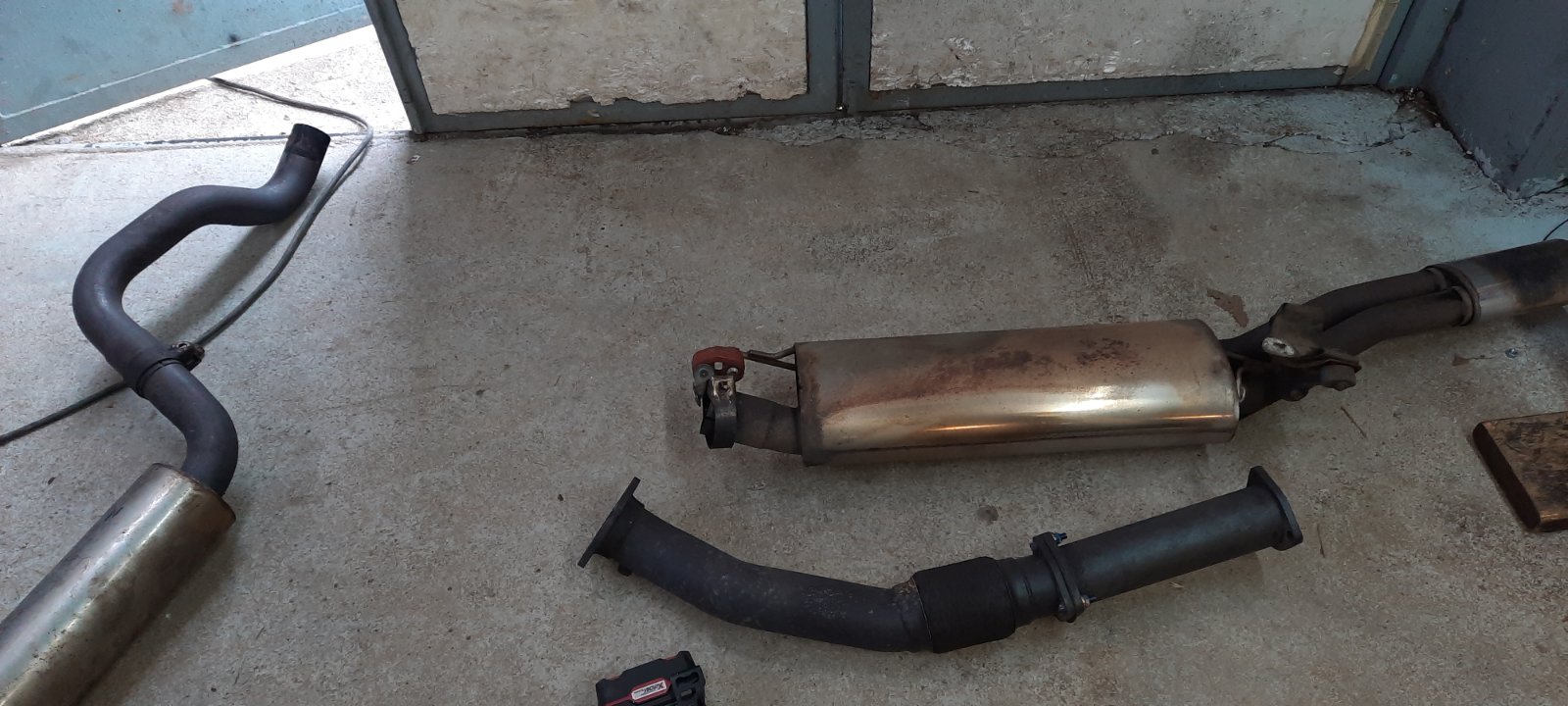

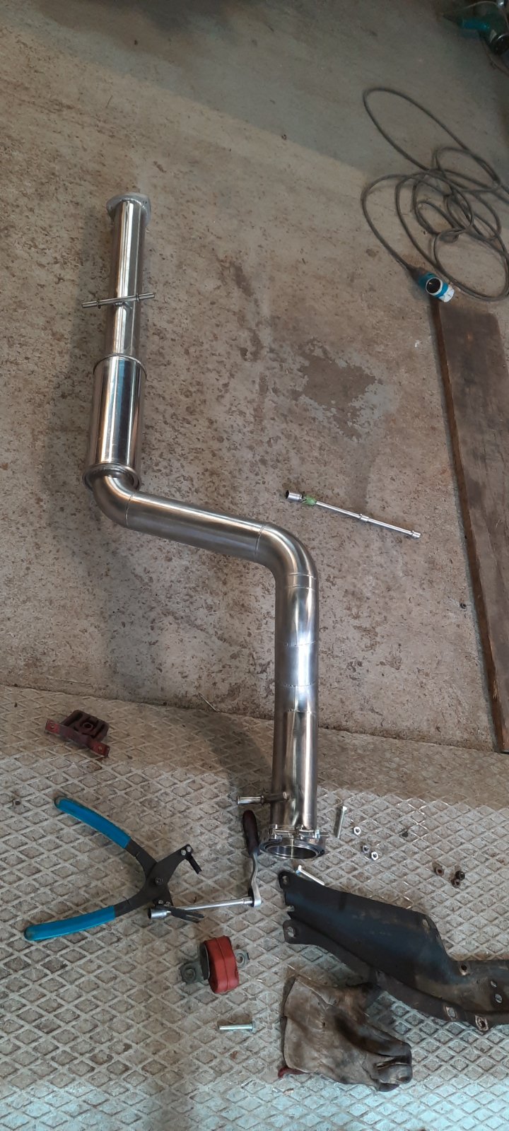

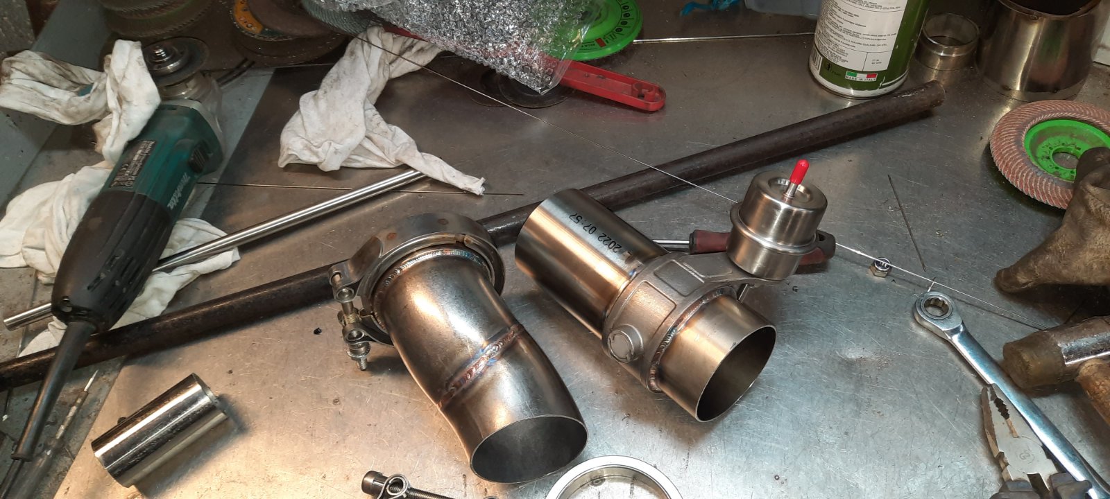

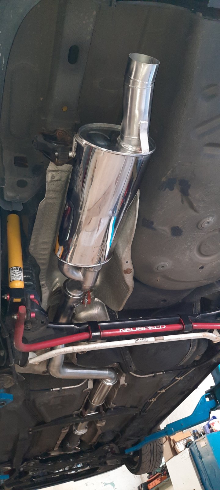

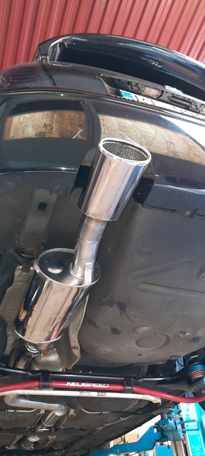

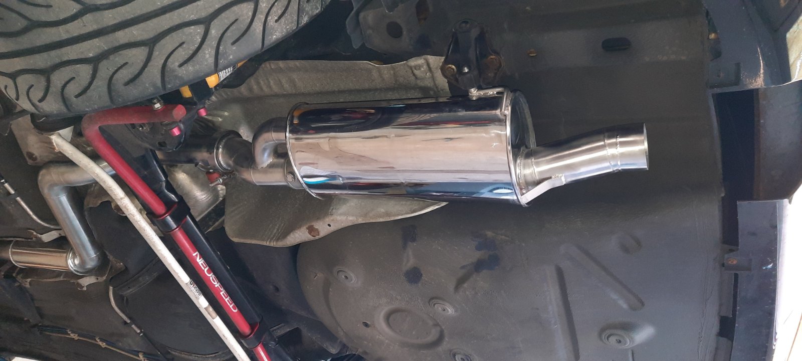

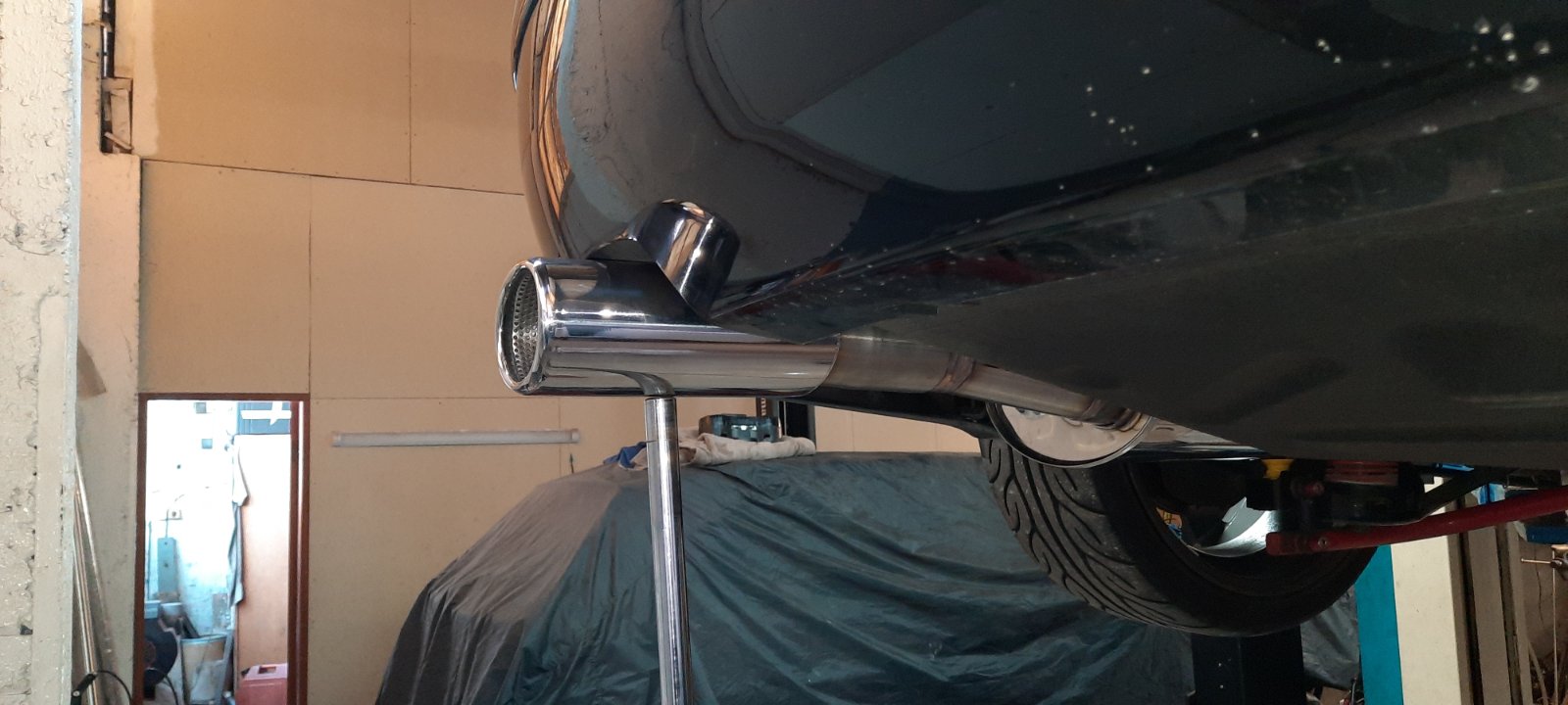

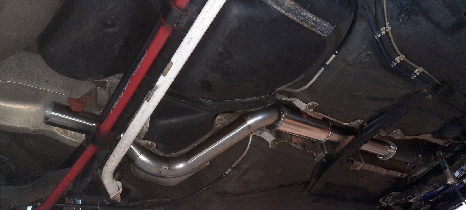

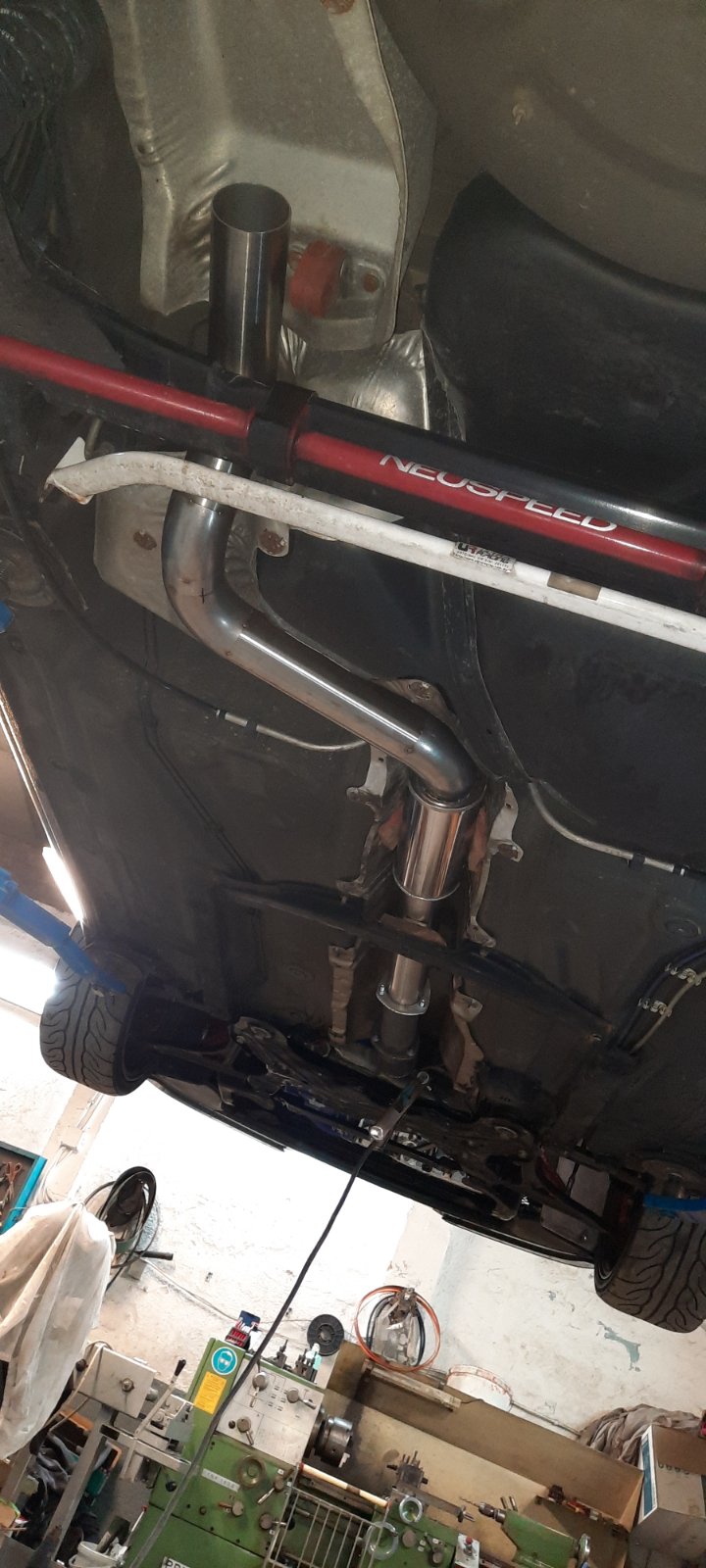

New 3" custom cat back valved exhaust being made. Maybe some Inconel/ceramic DP insulation to,despite  it's already ceramic coated.
Pics soon
All down

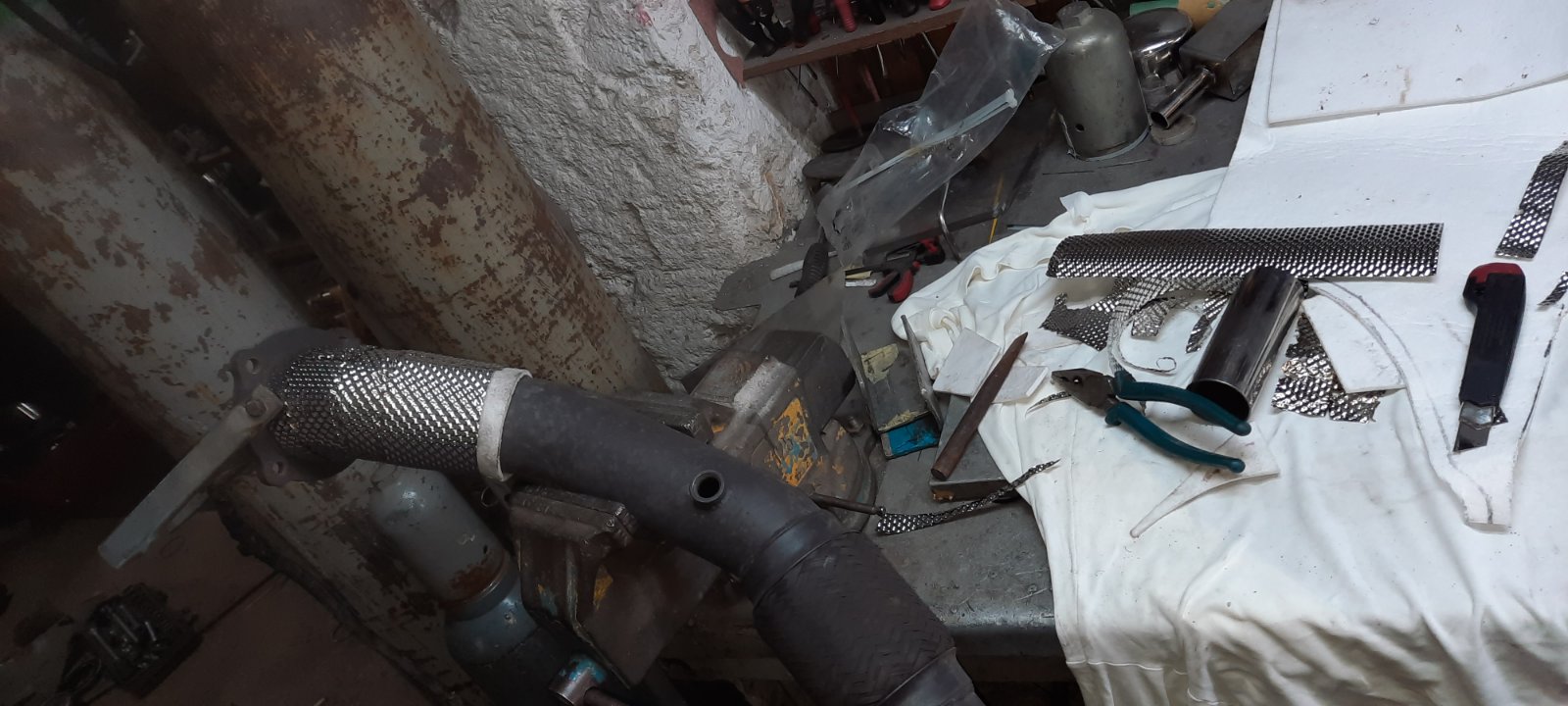

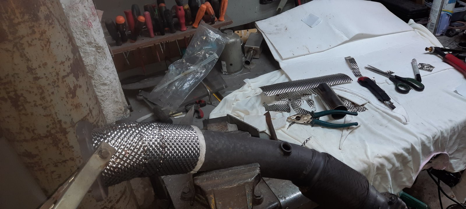

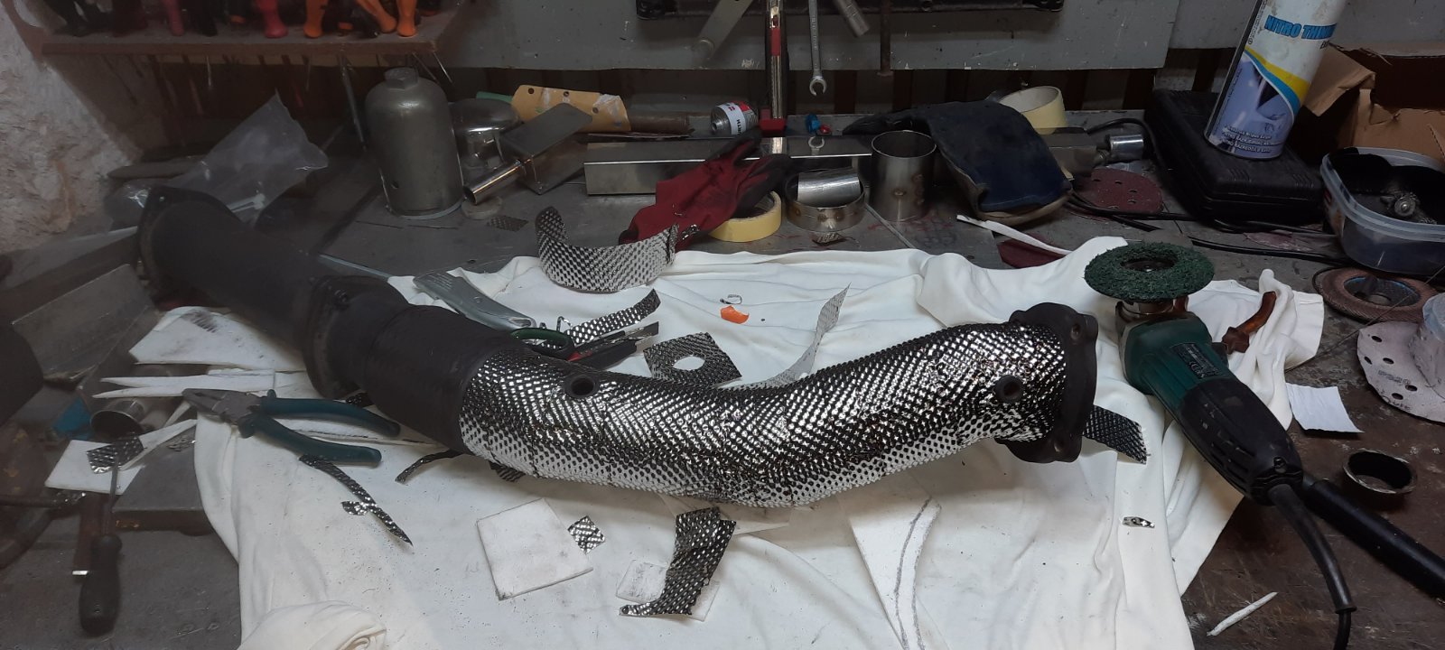

Work in Progress. Some updates. Existing 3" DP from 42draft design USA,which is modular-3 pieces (had two ends,one 3"to 2.5" for cat back Miltek,and other 3" for future 3" cat back upgrade) which already was ceramic coated black is being additionally Heat protected with ceramic heat insulation fabric and Inconel sheat welded over it. Can't be better. That 3rd part will be remowed for new one with V clamp connection instead of standard push on

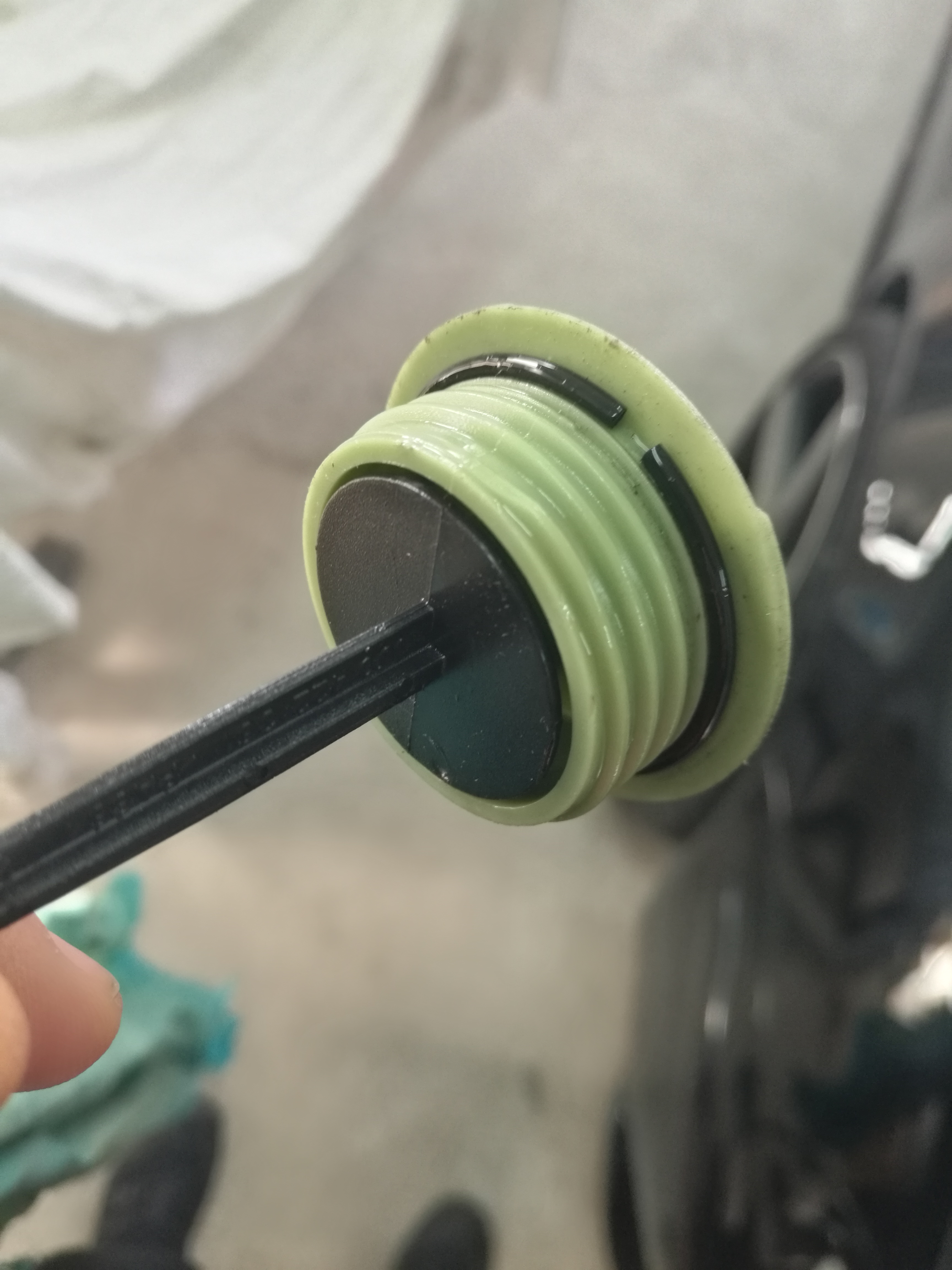

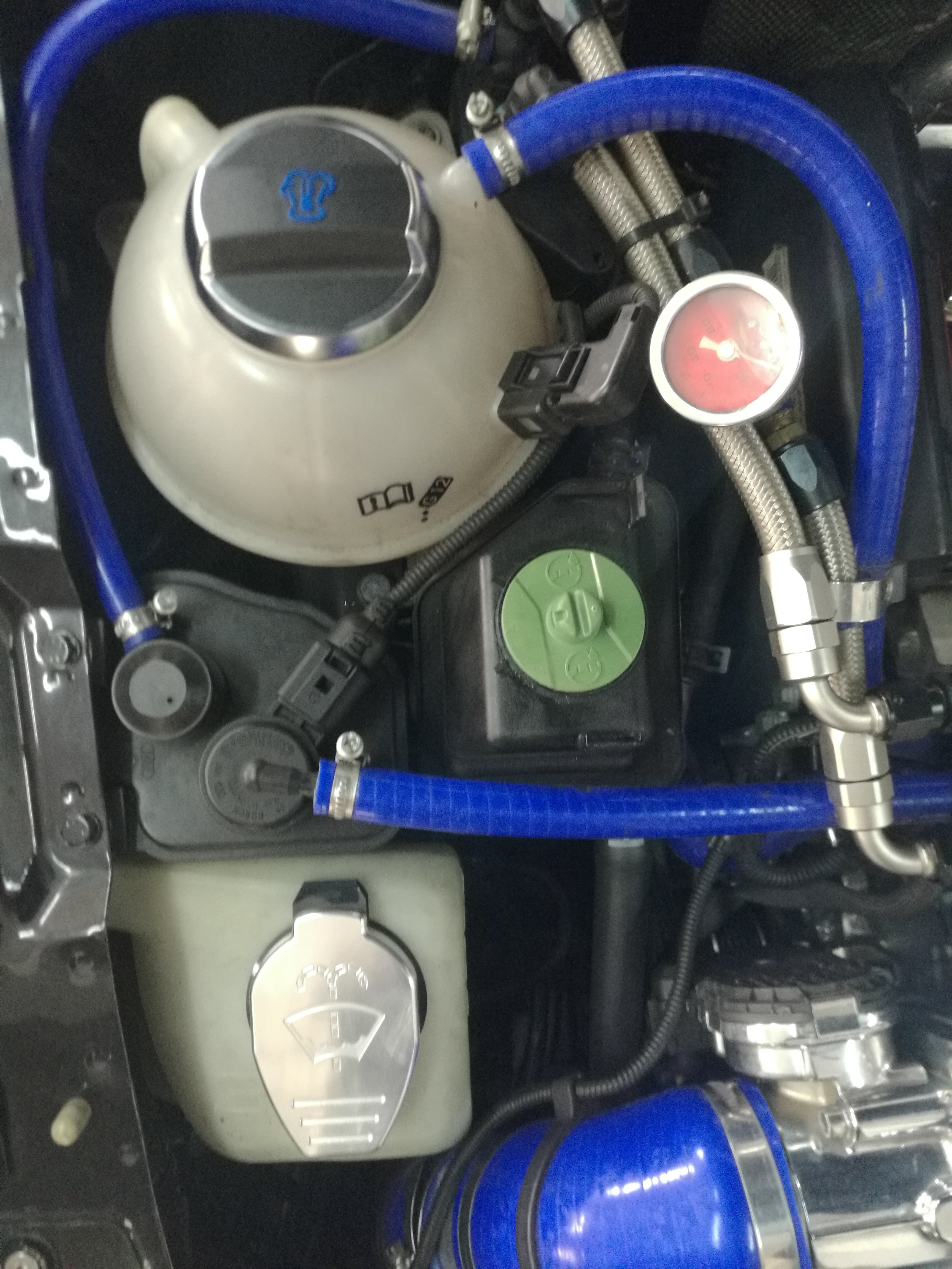

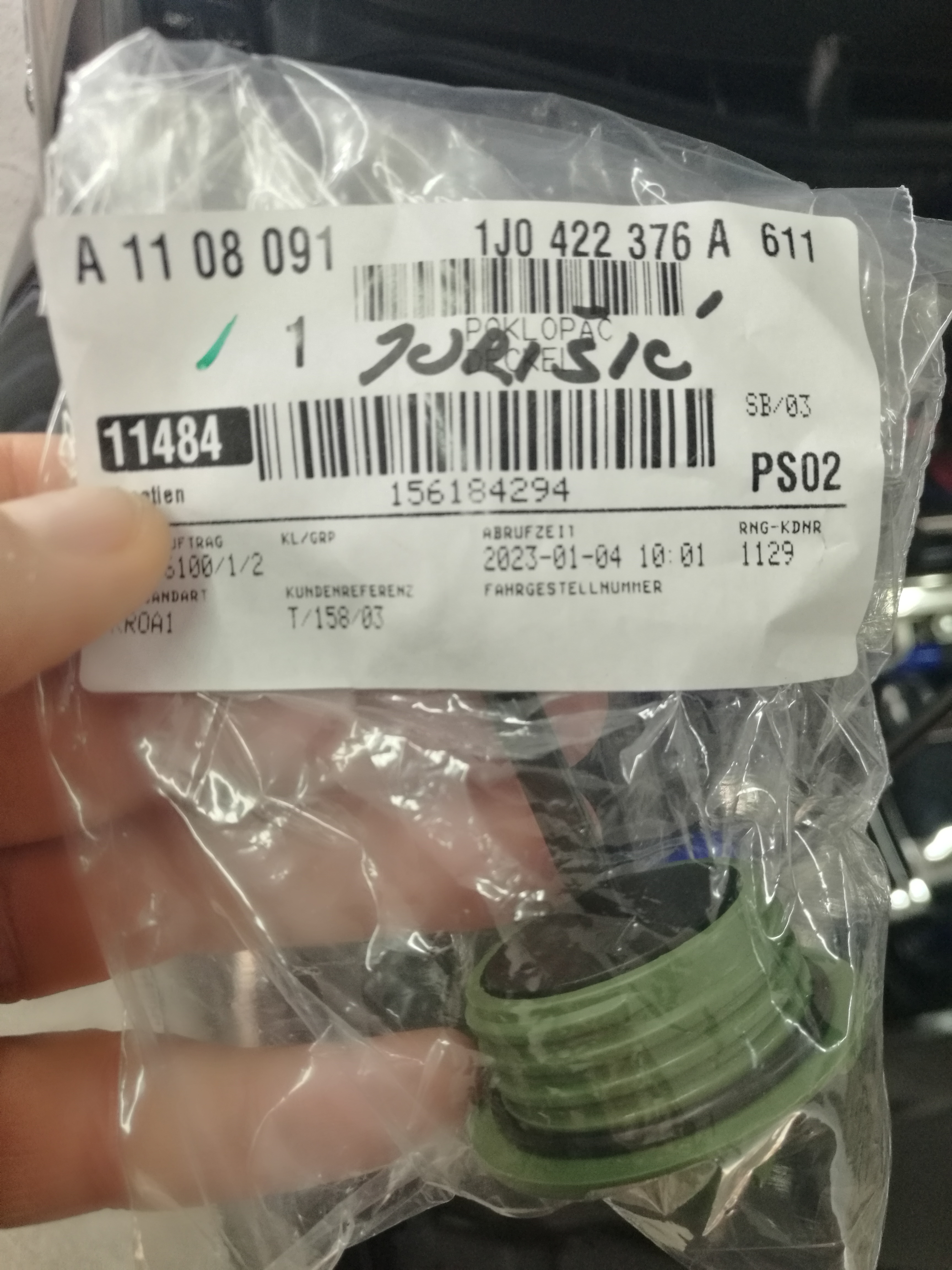

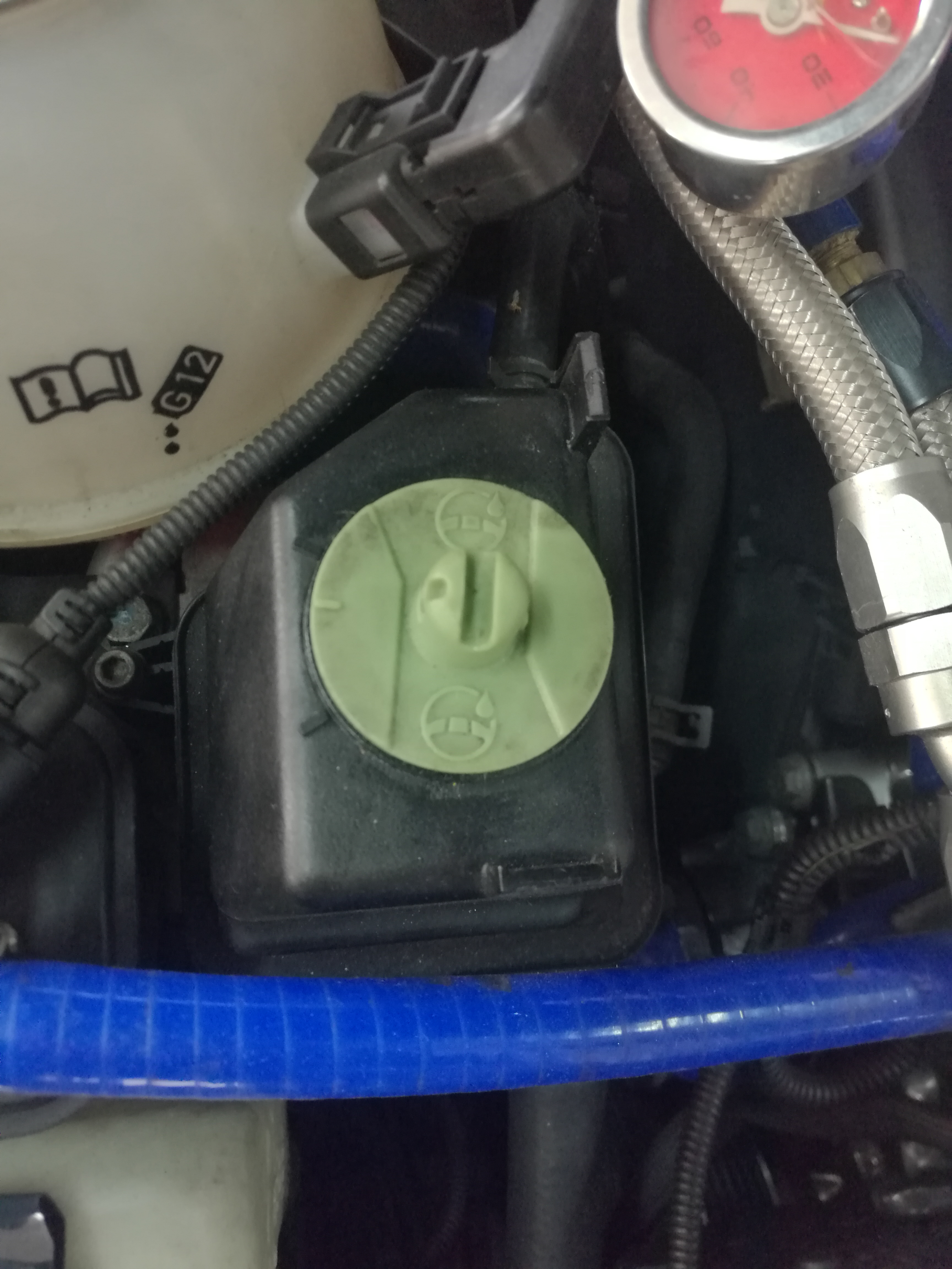

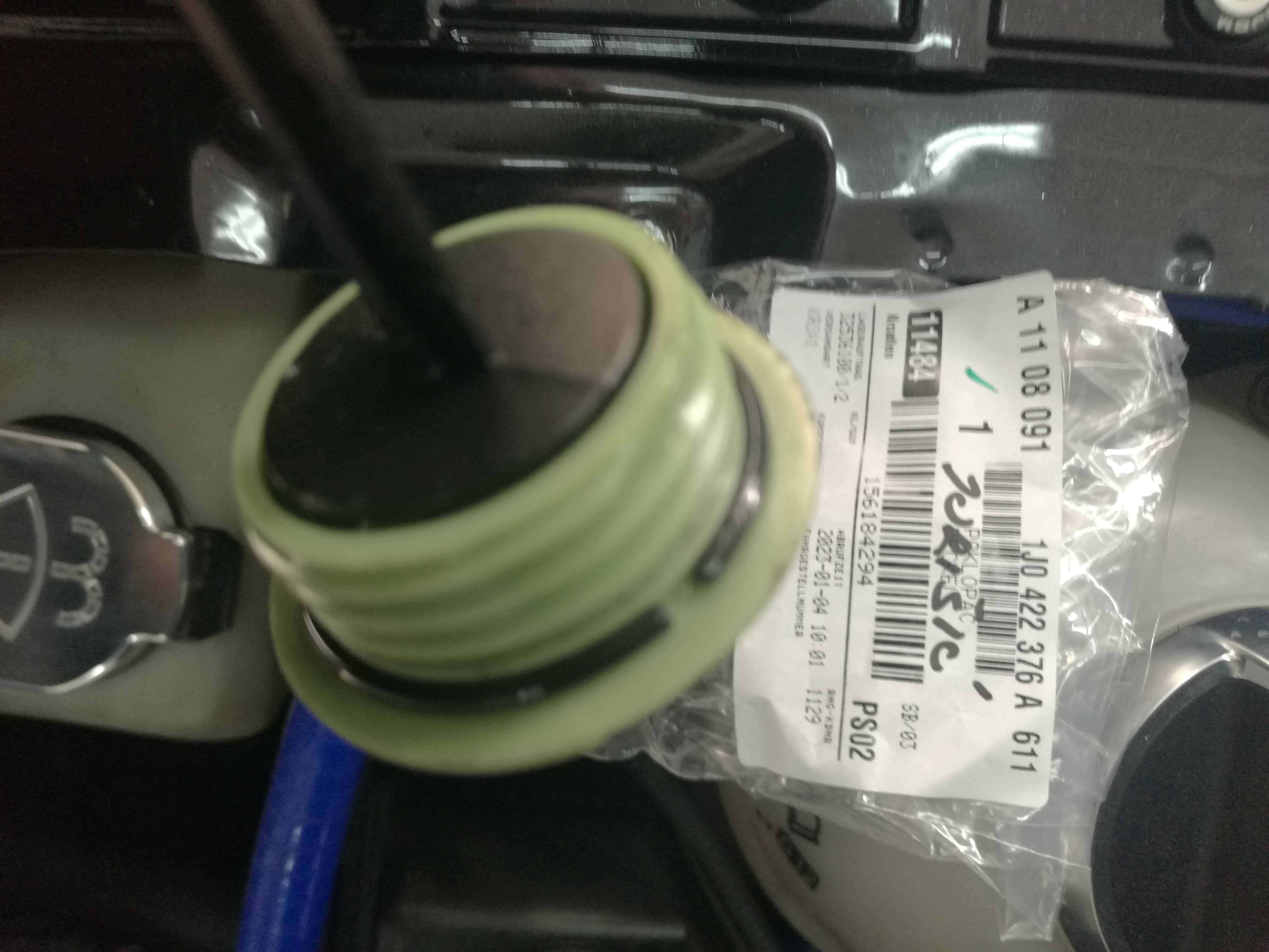

Servo fluid tank cap had broken O ring so I had to buy new one, O ring is not available alone, so I bought whole new cap. If I only could found that billet aluminium JCAPS cap sold from ECS tuning but on back order, to complete all 4 (oil,washer,servo and coolant cap).

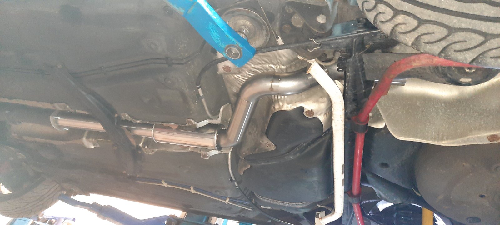

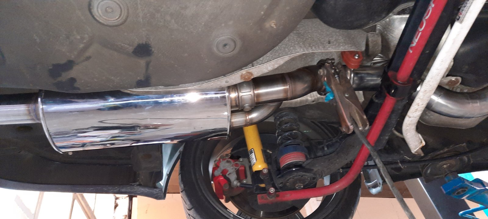

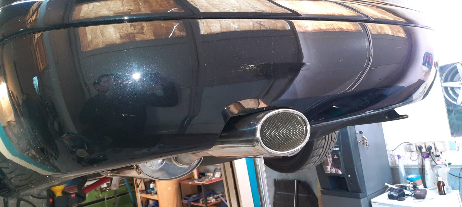

Btw first impressions with new vallved 3" exhaust are great. Miltek was only option back than more than 13y ago and did its job correctly, suroassed several track days, but rear silencer was gine and this one is more powerful replacement with silent and loud option on click of remote. Great.

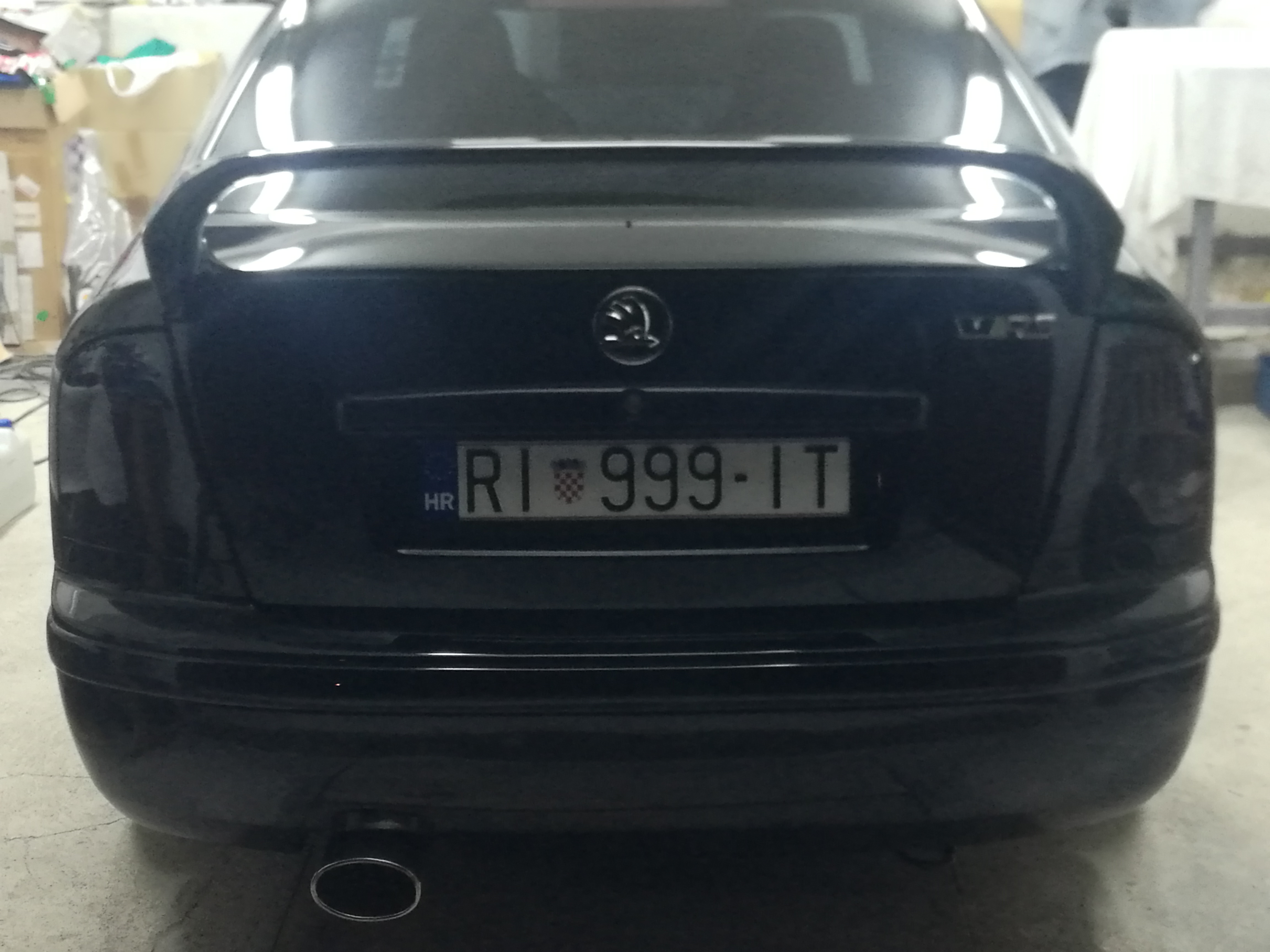

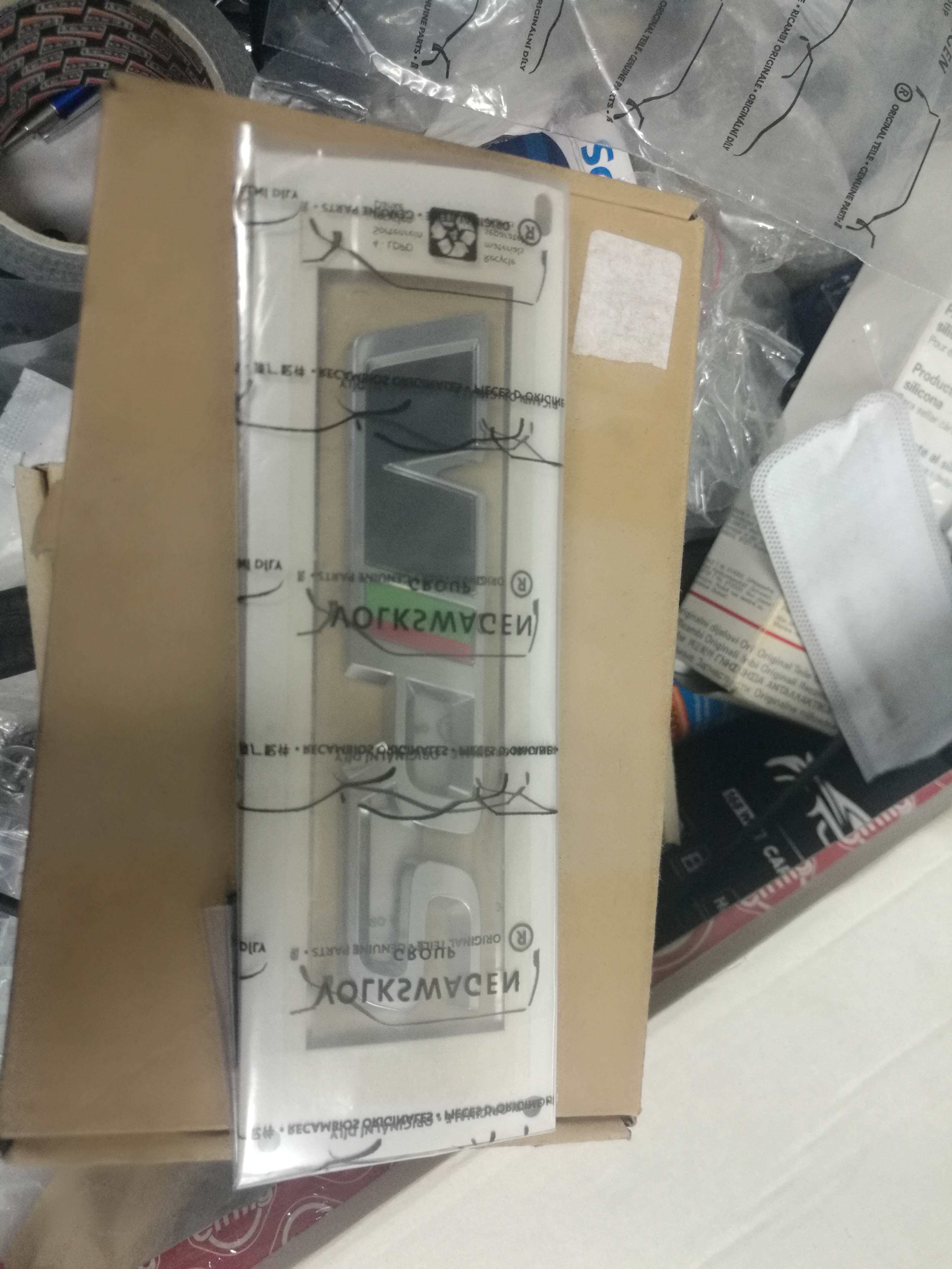

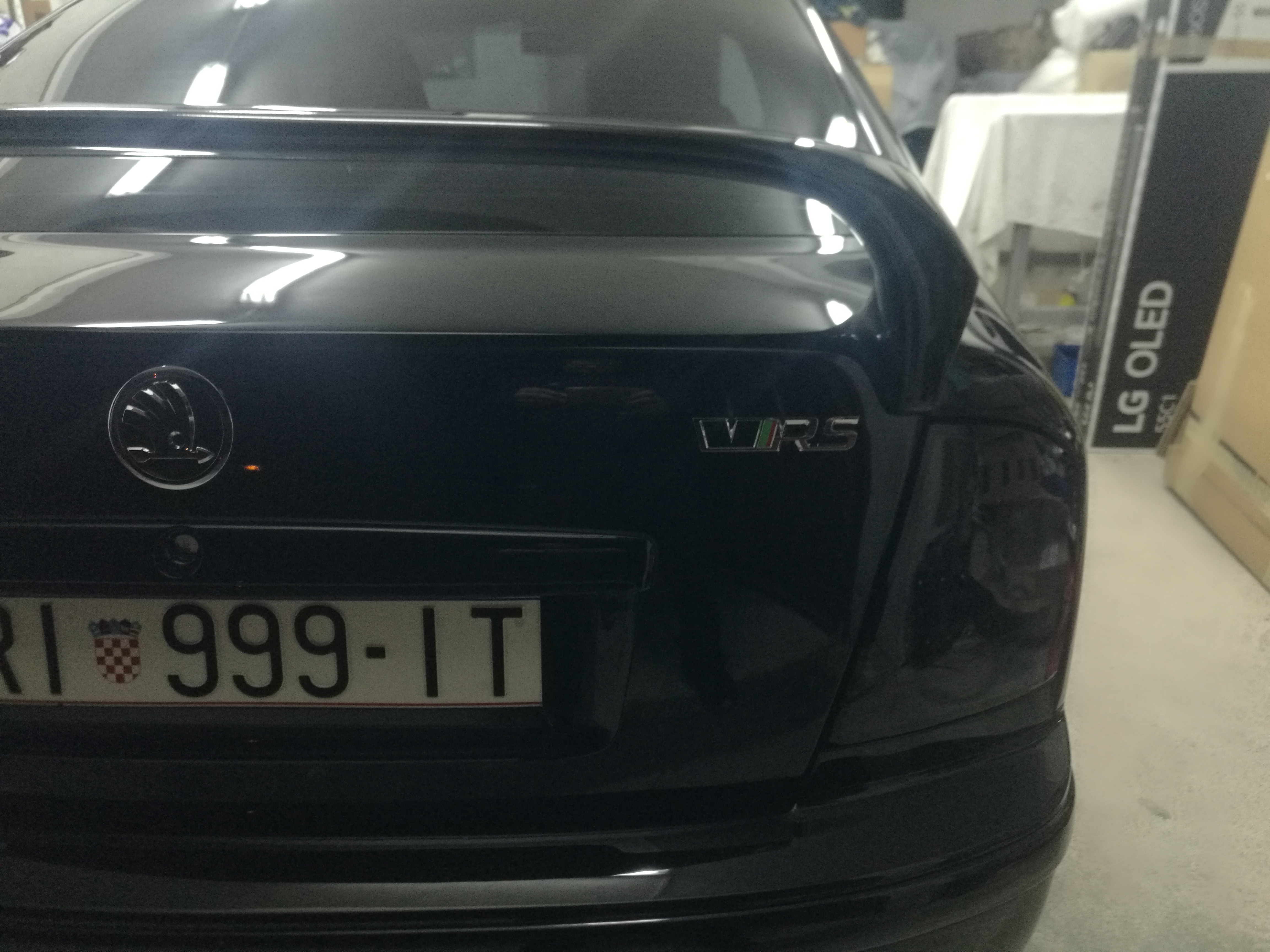

New badge for the trunk is back again together with ones on the fenders
