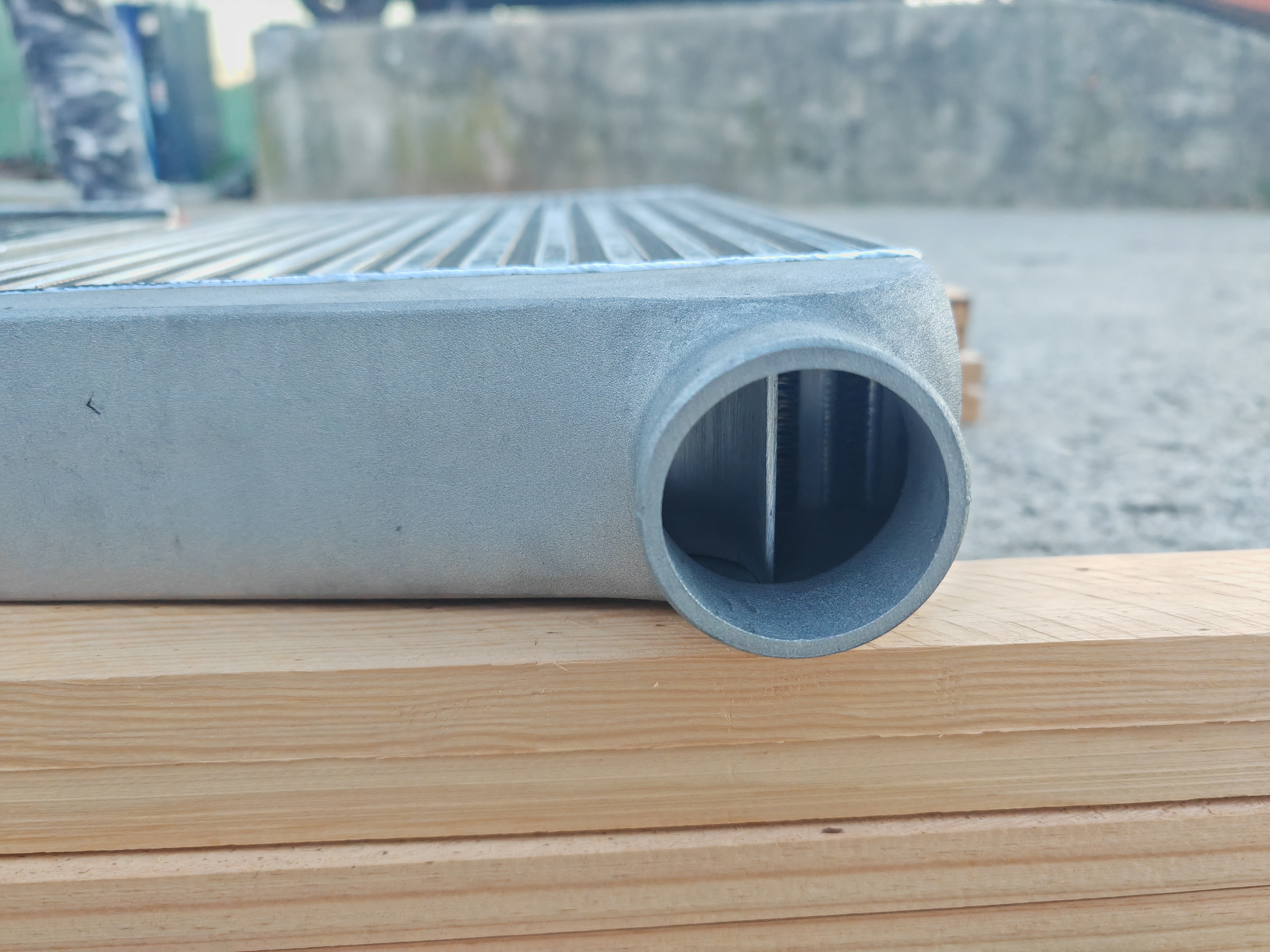

Garrett 750hp core 450x307x76mm, two endtanks with 63mm (2.5") connections and 4 63mm blue antivibration couplers.
Can't wait to put otmom and perforate crash bar with app 5cm holes for sir flow and cut bumper for bigger mesh and remove reg plate on the side on magnetic holders.
Endtanks will recieve inner separating plate to separate inlet air in two directions,one in Llwer half and one in upper half od FMIC to avoid heat soak in lover part.

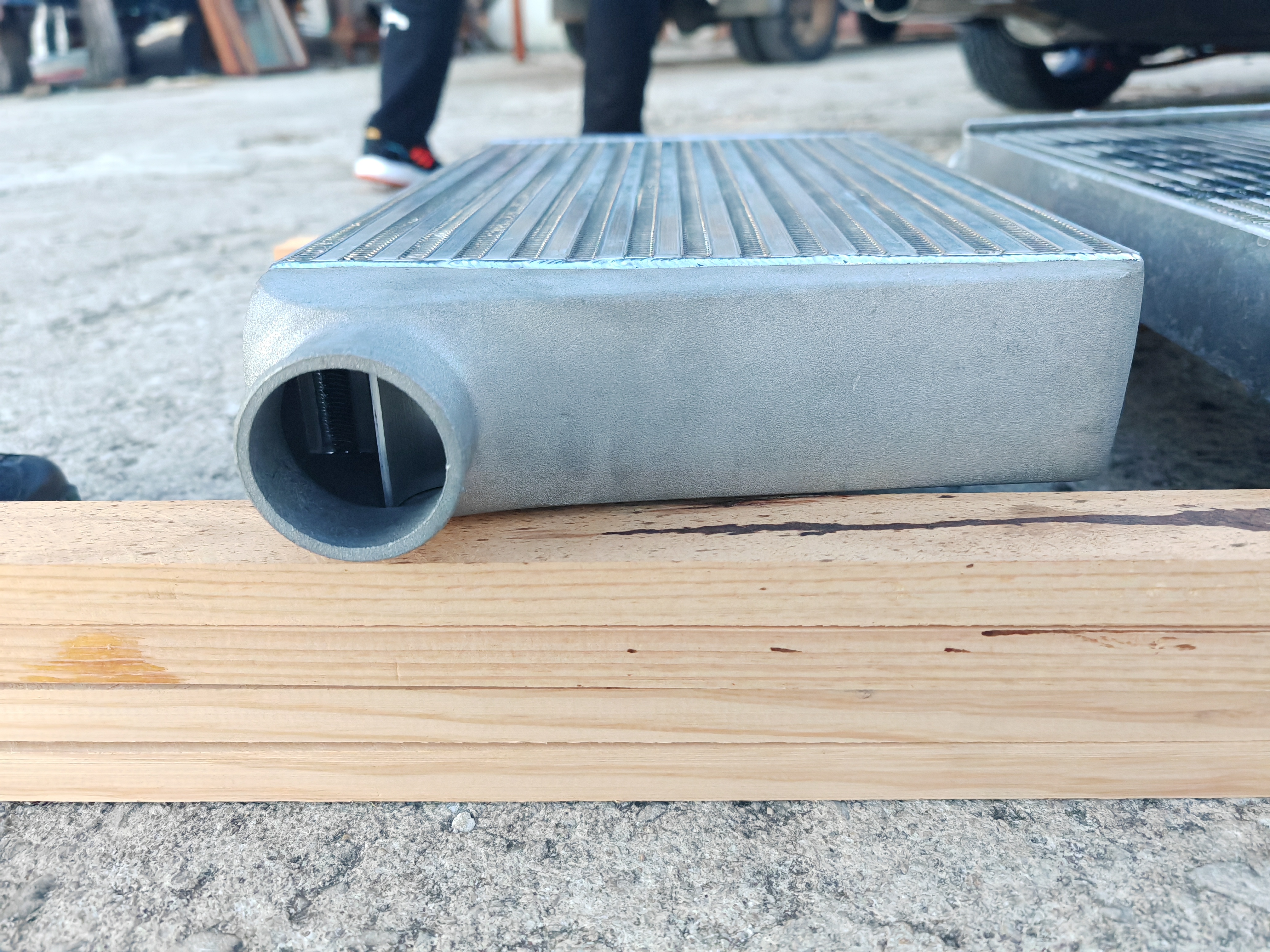

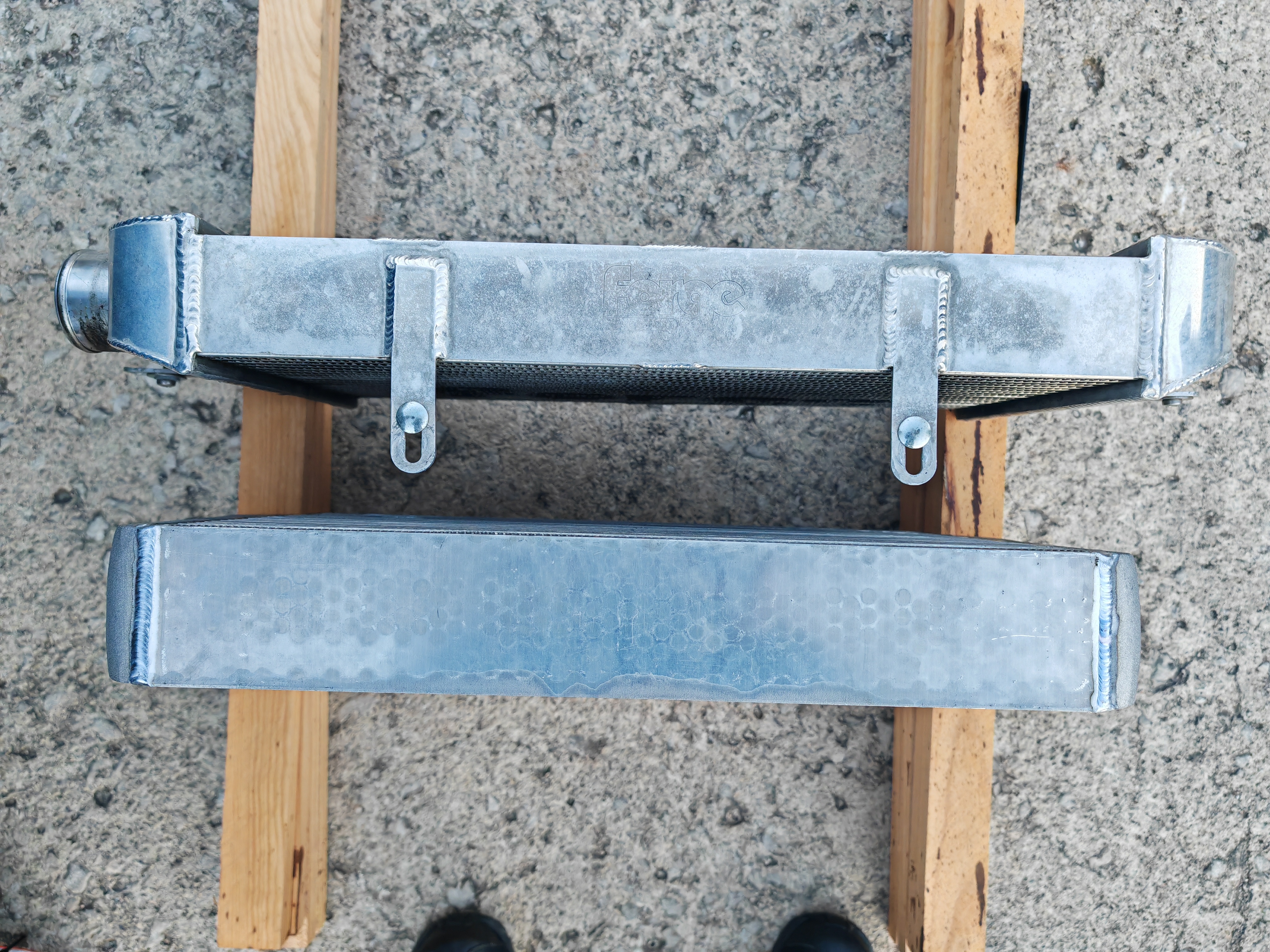

Endtanks recived diffusors same as HP Performance does, to avoid heat soak in upper part of FMIC. Core is Garrett 450x307x76mm, inlets are 63mm (2.5”), welded professionally by #veskoracevar and preparing for installation, overboost pipe over driver side, return Lines to TB over passenger side. DV rerouted already because of it. Than we Will measured IATs and post them Here.

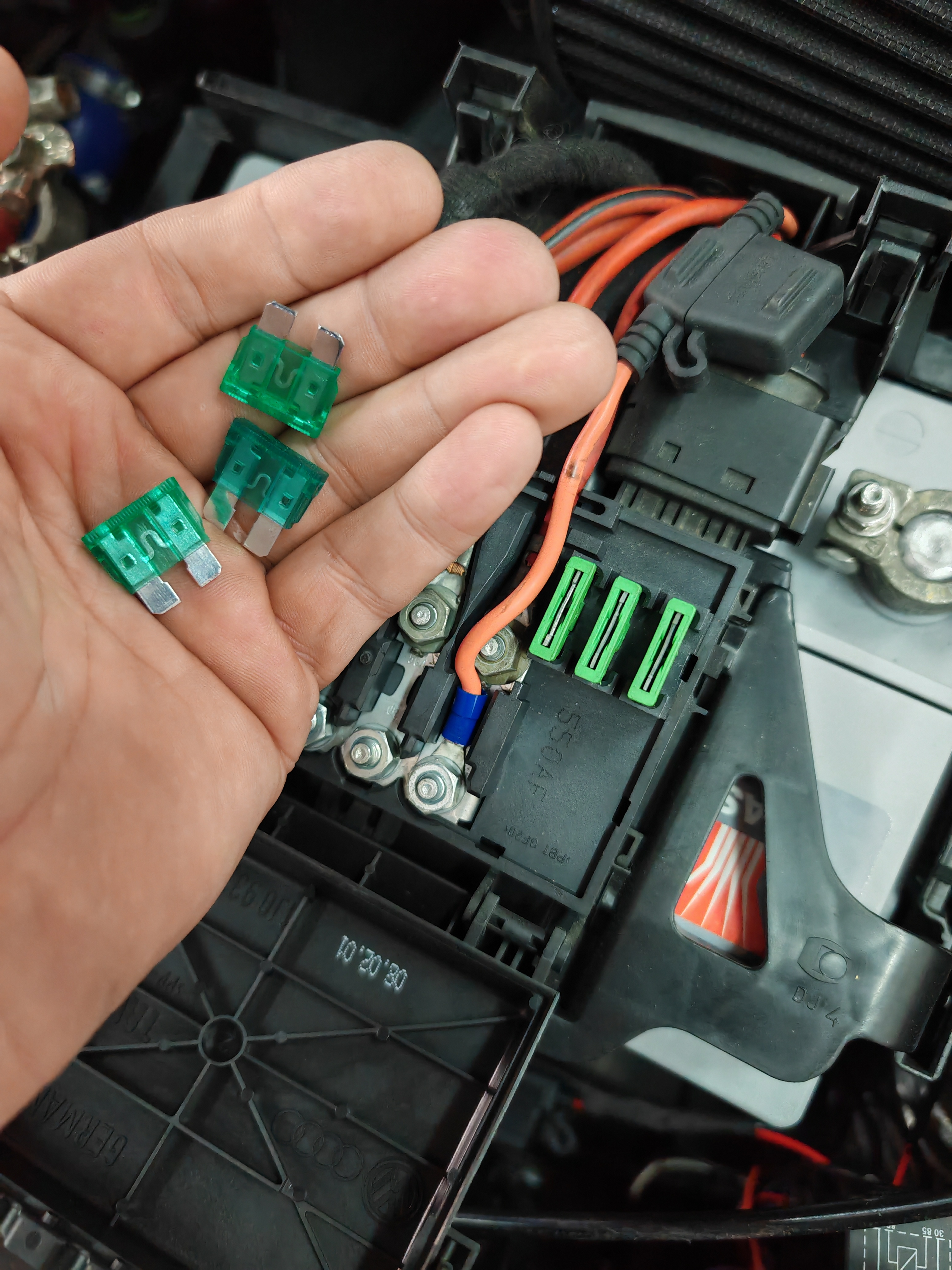

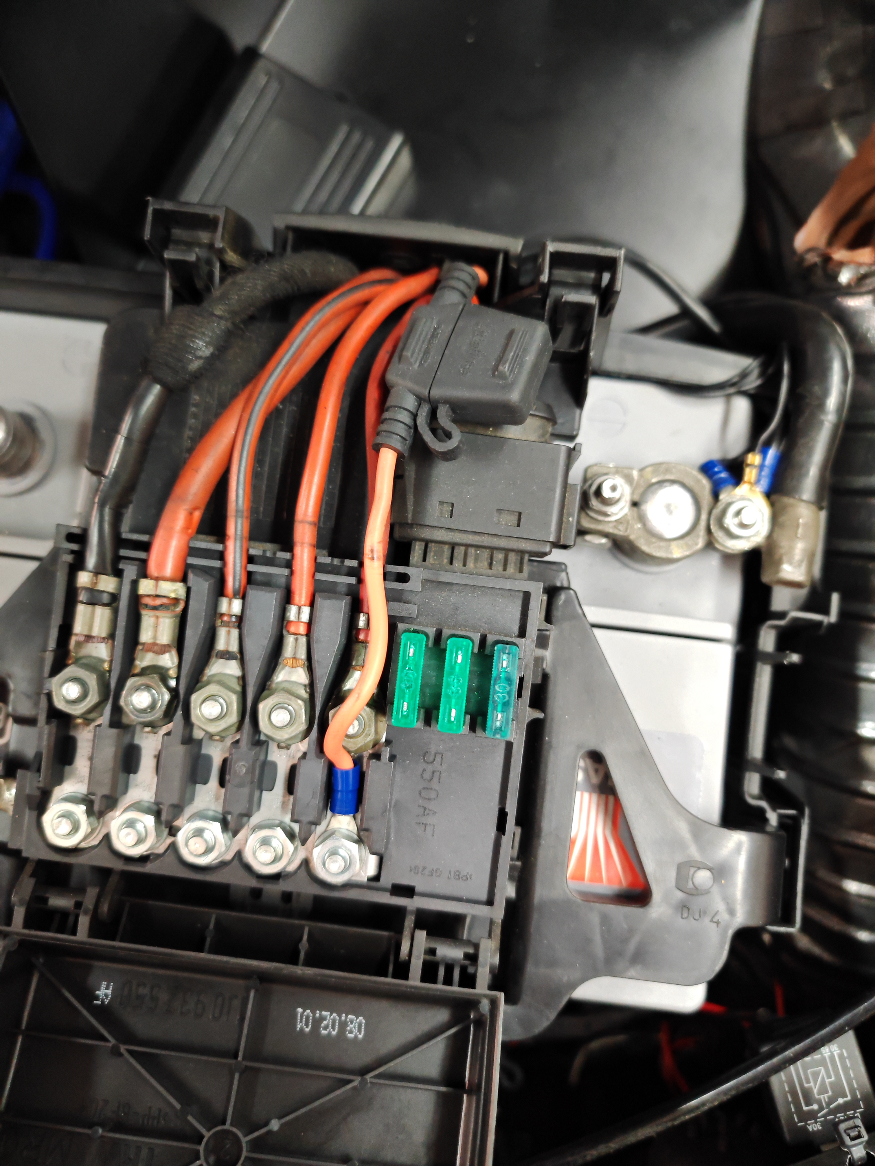

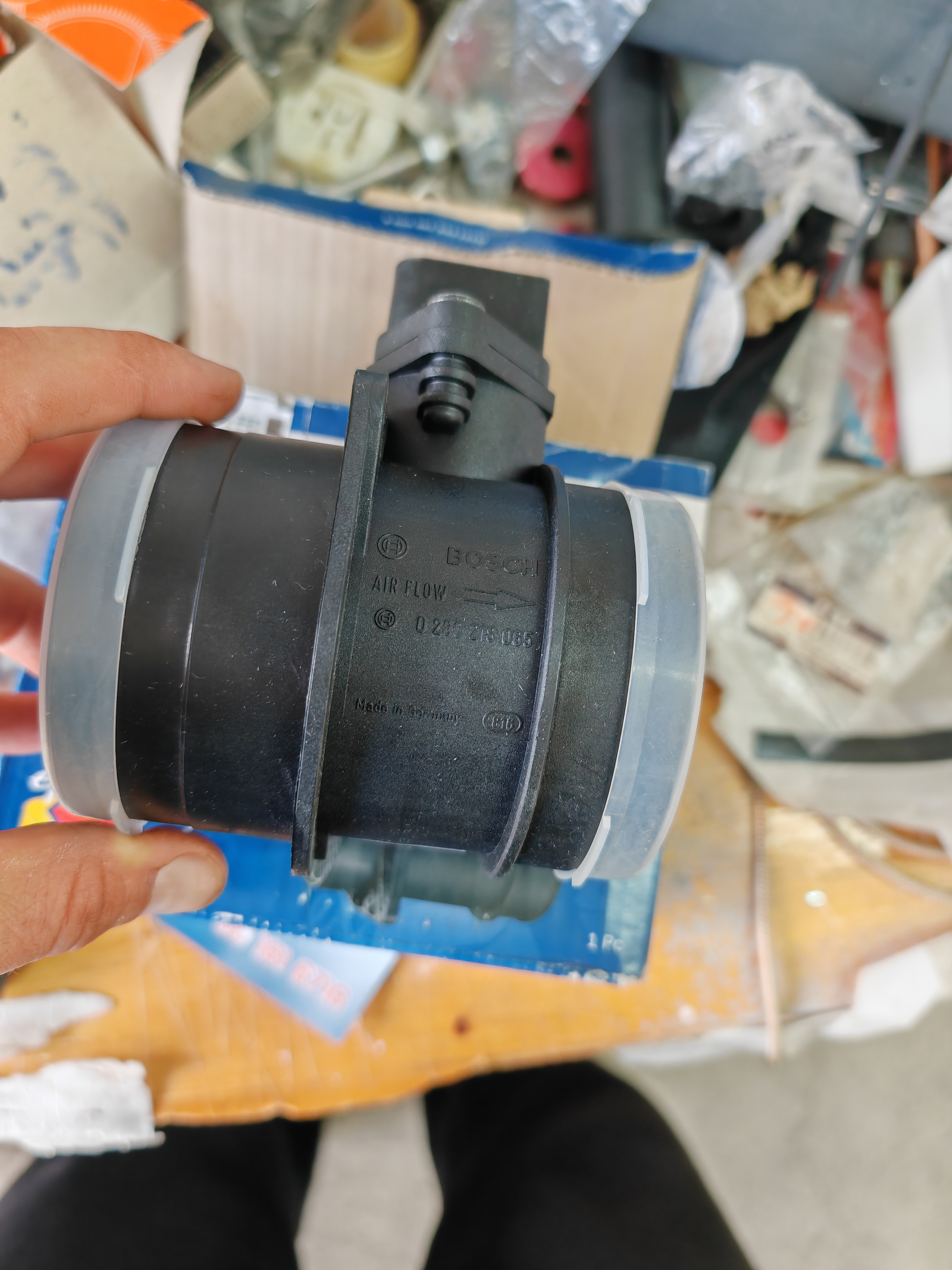

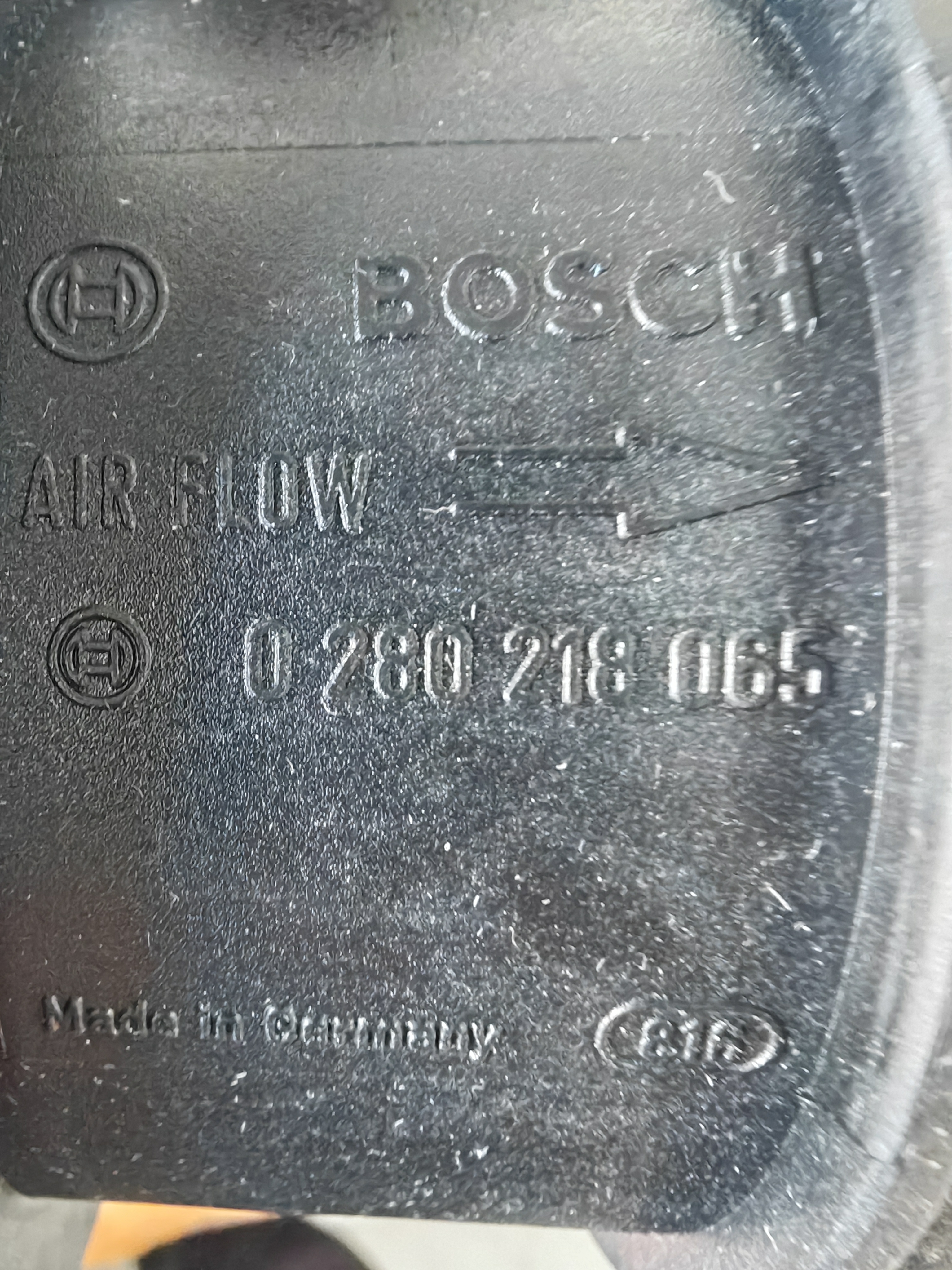

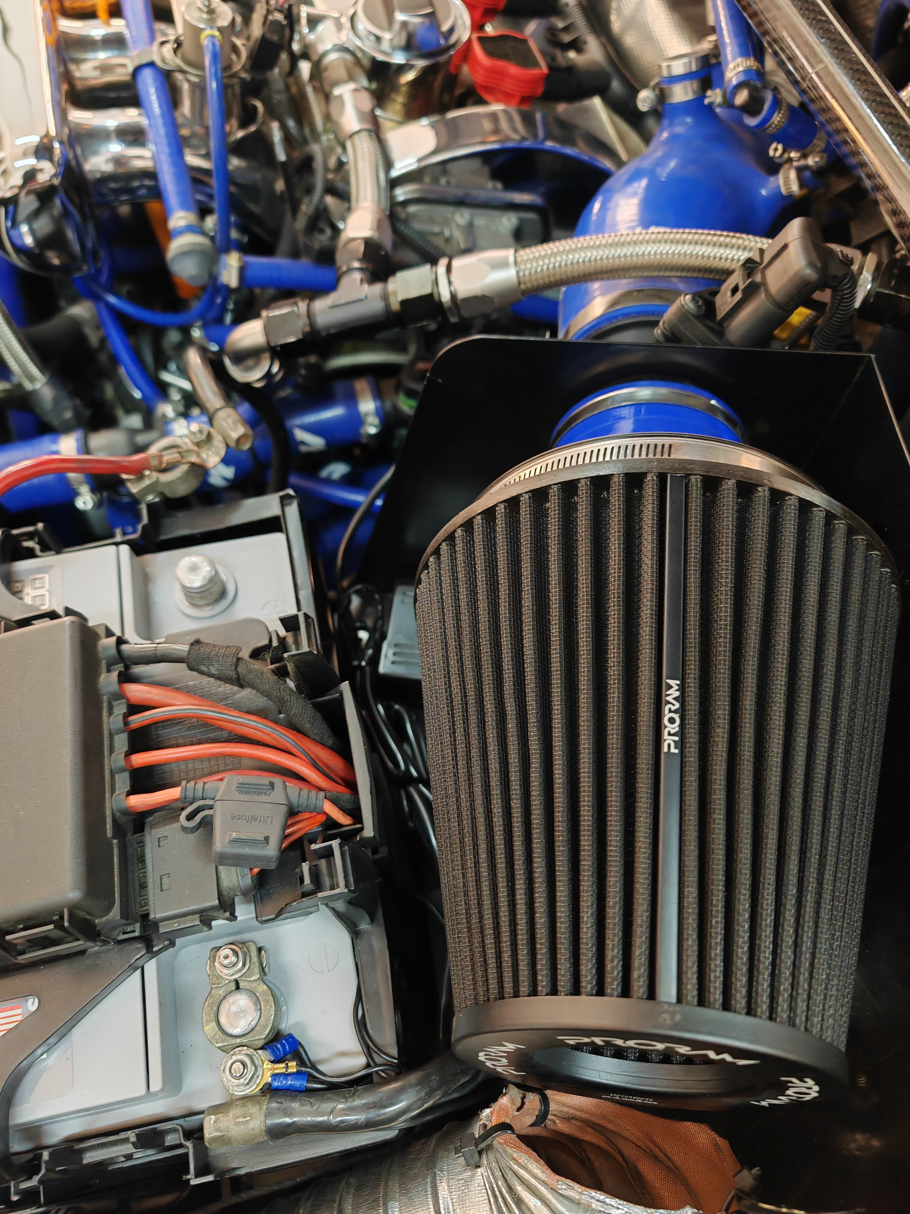

After remaping my wife's A5 we did test drive and Matjaž looked at comp logs. I had a feelings car is left without "air" in full throttle pull and sometimes looses boost at 4000rpm,also repeatedly had 18010 error. Lambda Readingu was almost 1 and Lean mixture.
He first looked at 30A green fusses on top of the battery-oxidated, replaced them with new one-error is gone..

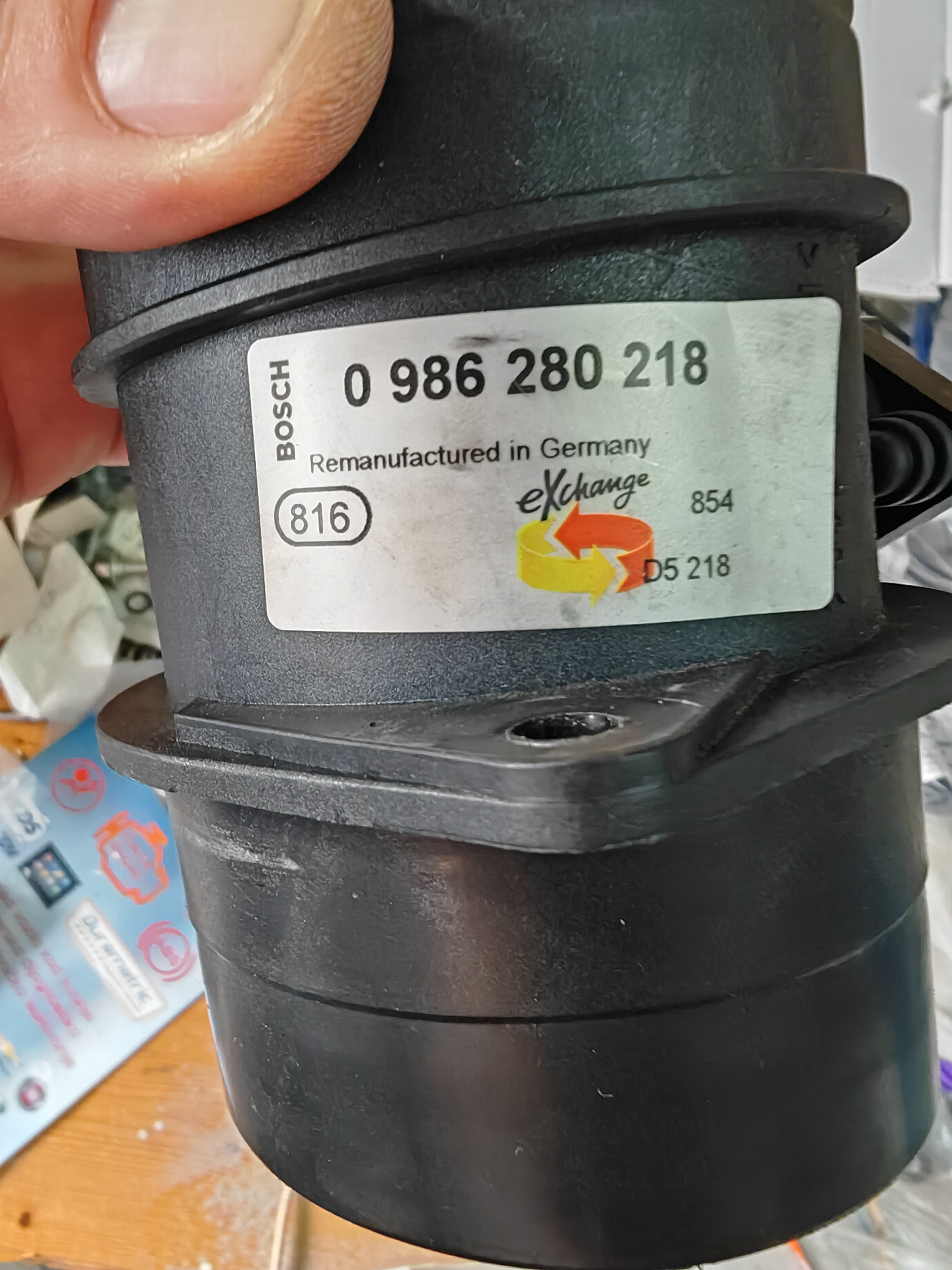

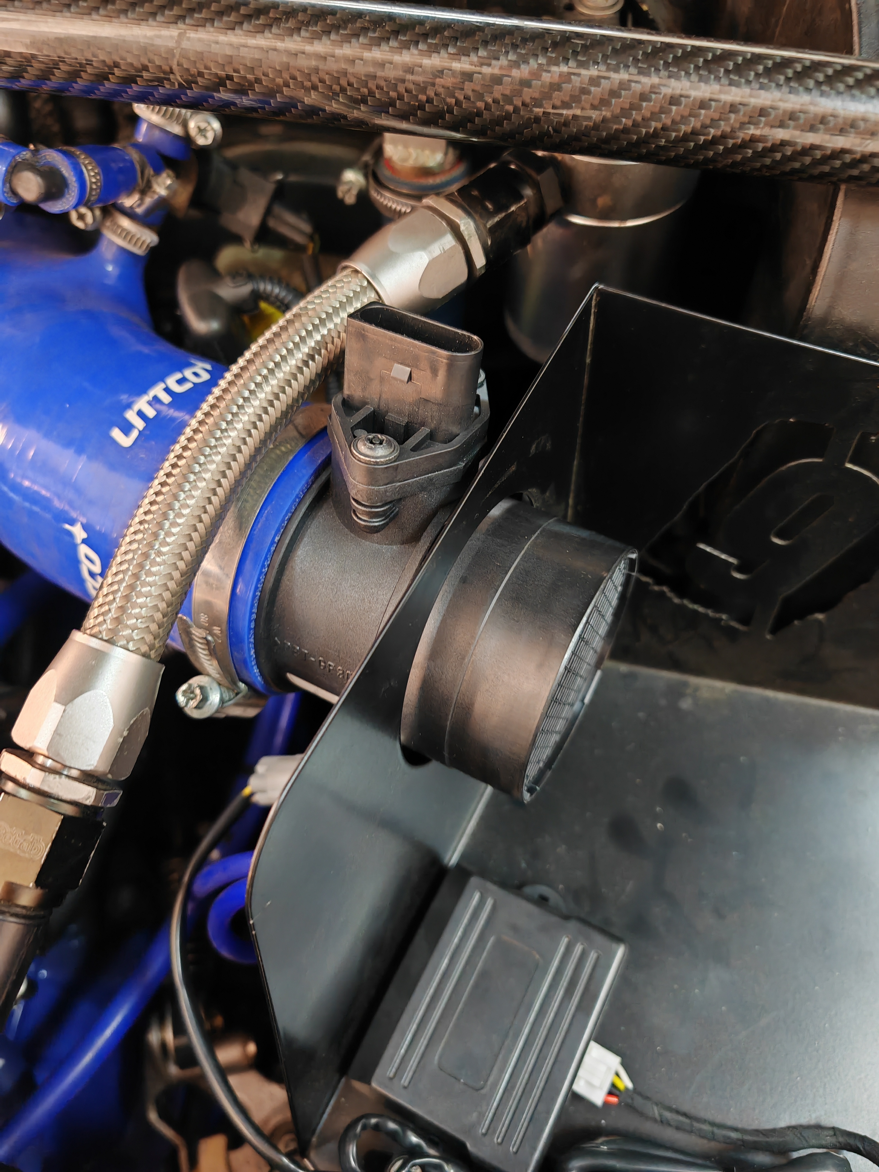

Than he said MAF and or fuel problem.

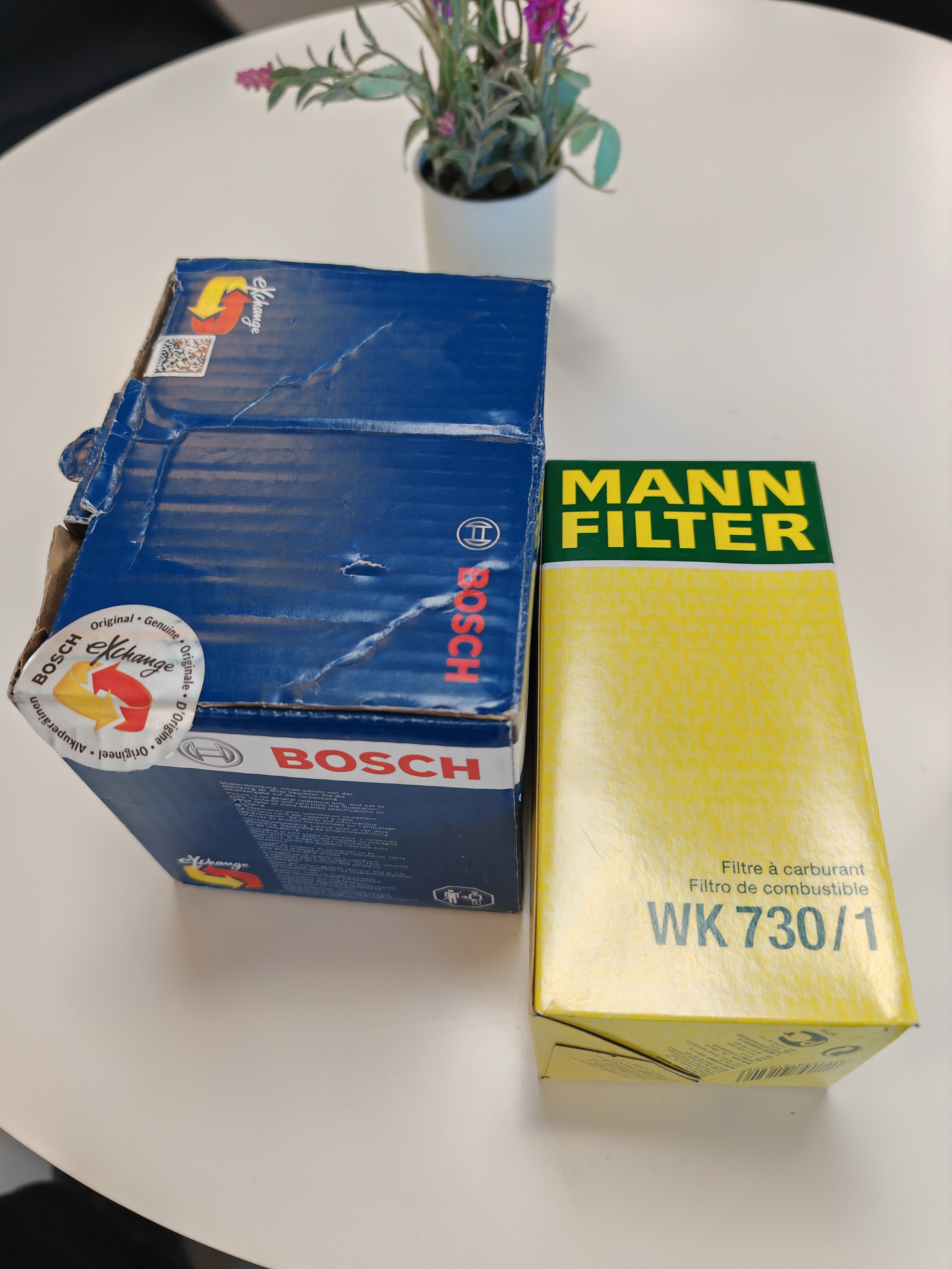

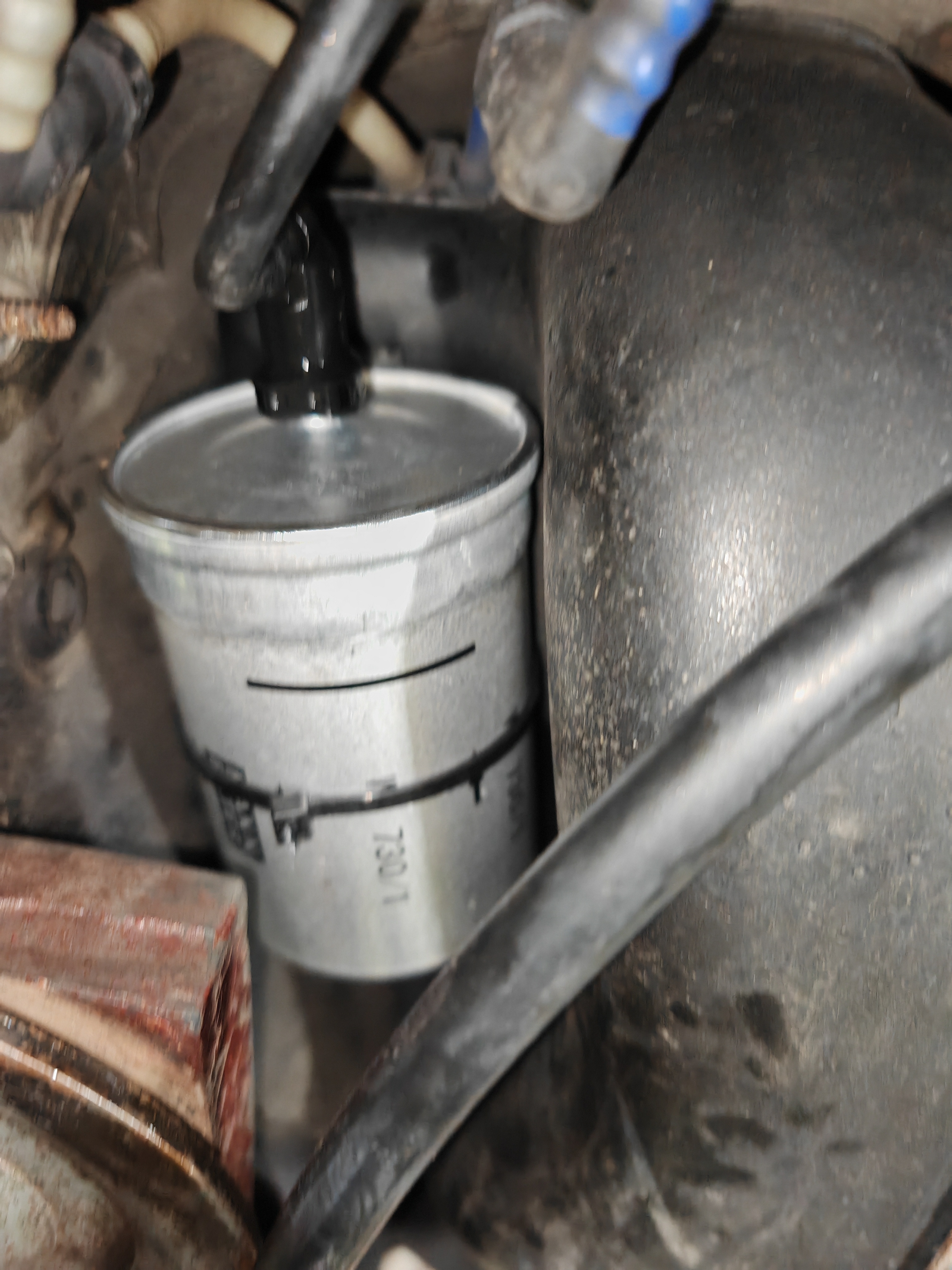

We disconected MAF-,improvement but still fuel problem. Oppened tank and inspected pump for fuel hose break and leak-everything ok, but than he asked me when did I replace fuel filter-more than 10y ago
So today I replaced old BOSCH which was installed 8.2018. for new one also from Bosch, and tested car, pulls like hell, ASR lighting all the way through  1,2 and 3rd gear. No errors.
Tomorrow will replace fuel filter to for Mann one.

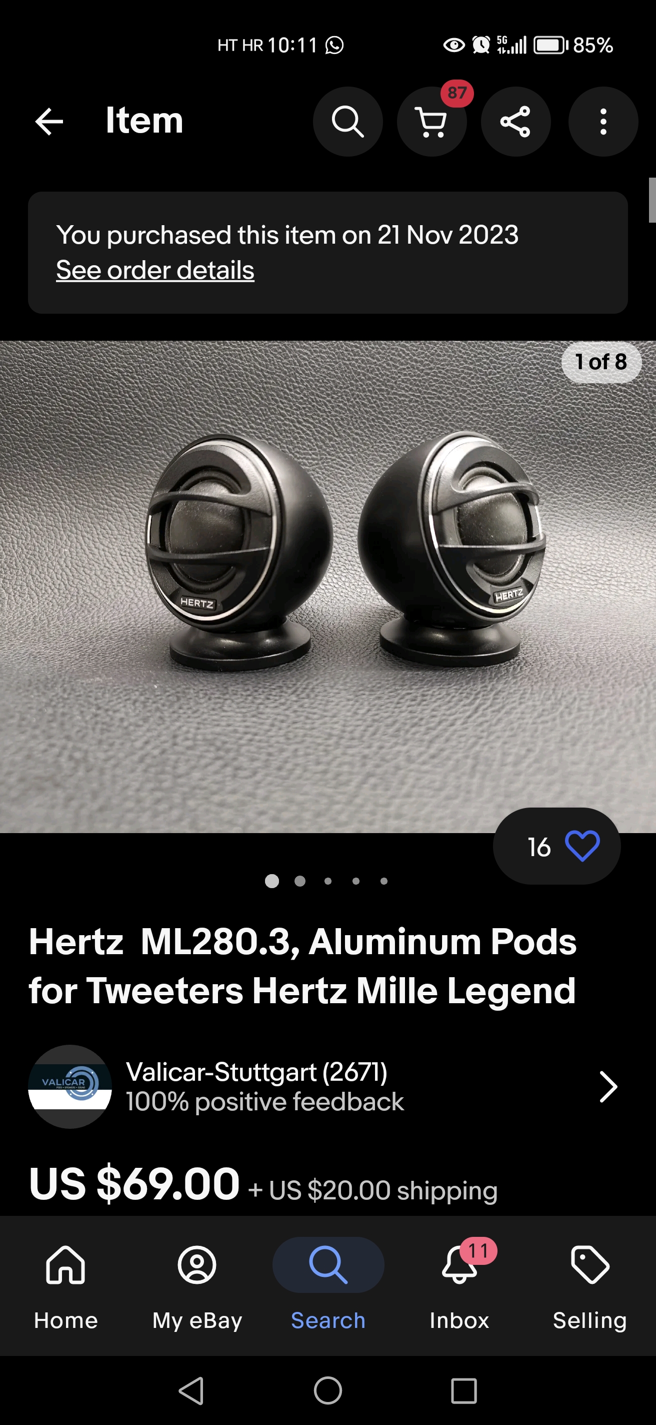

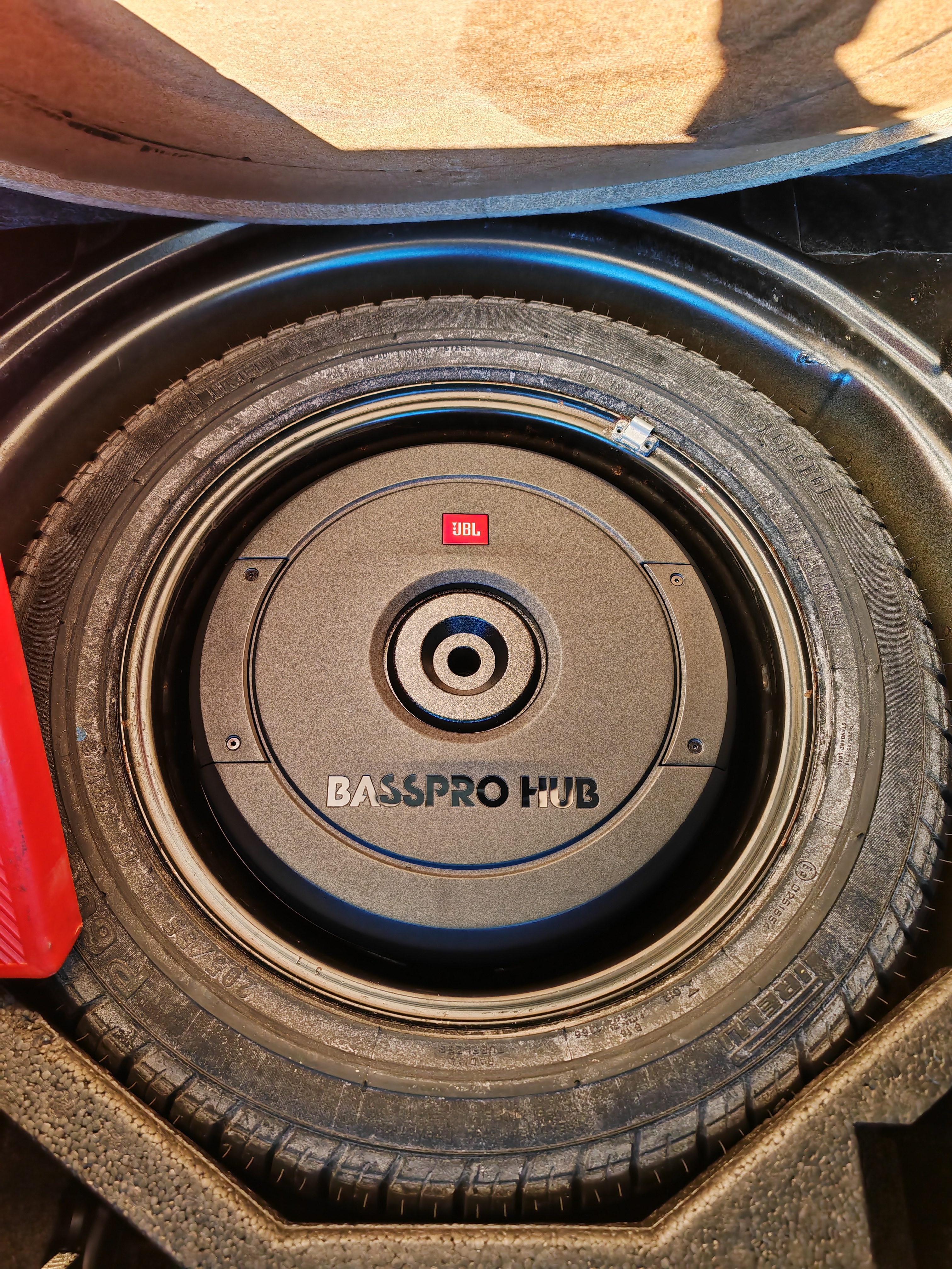

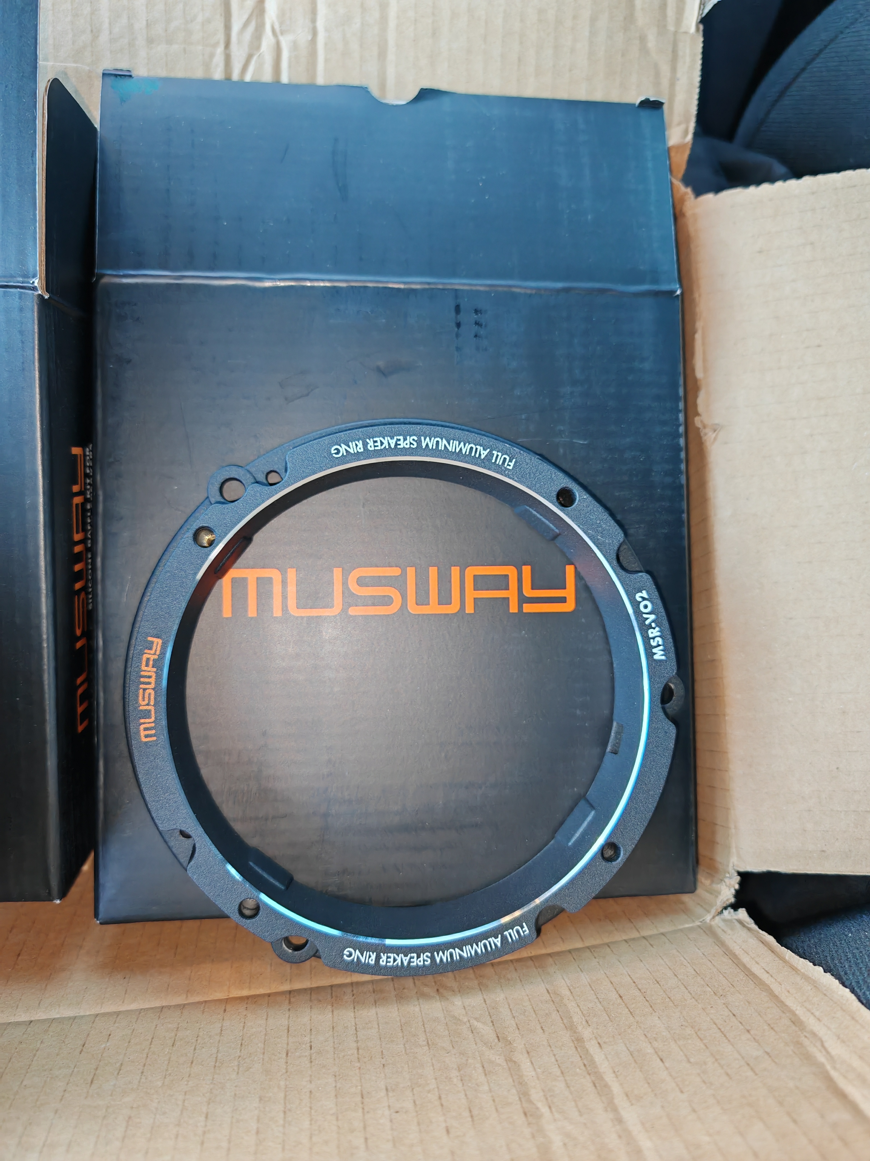

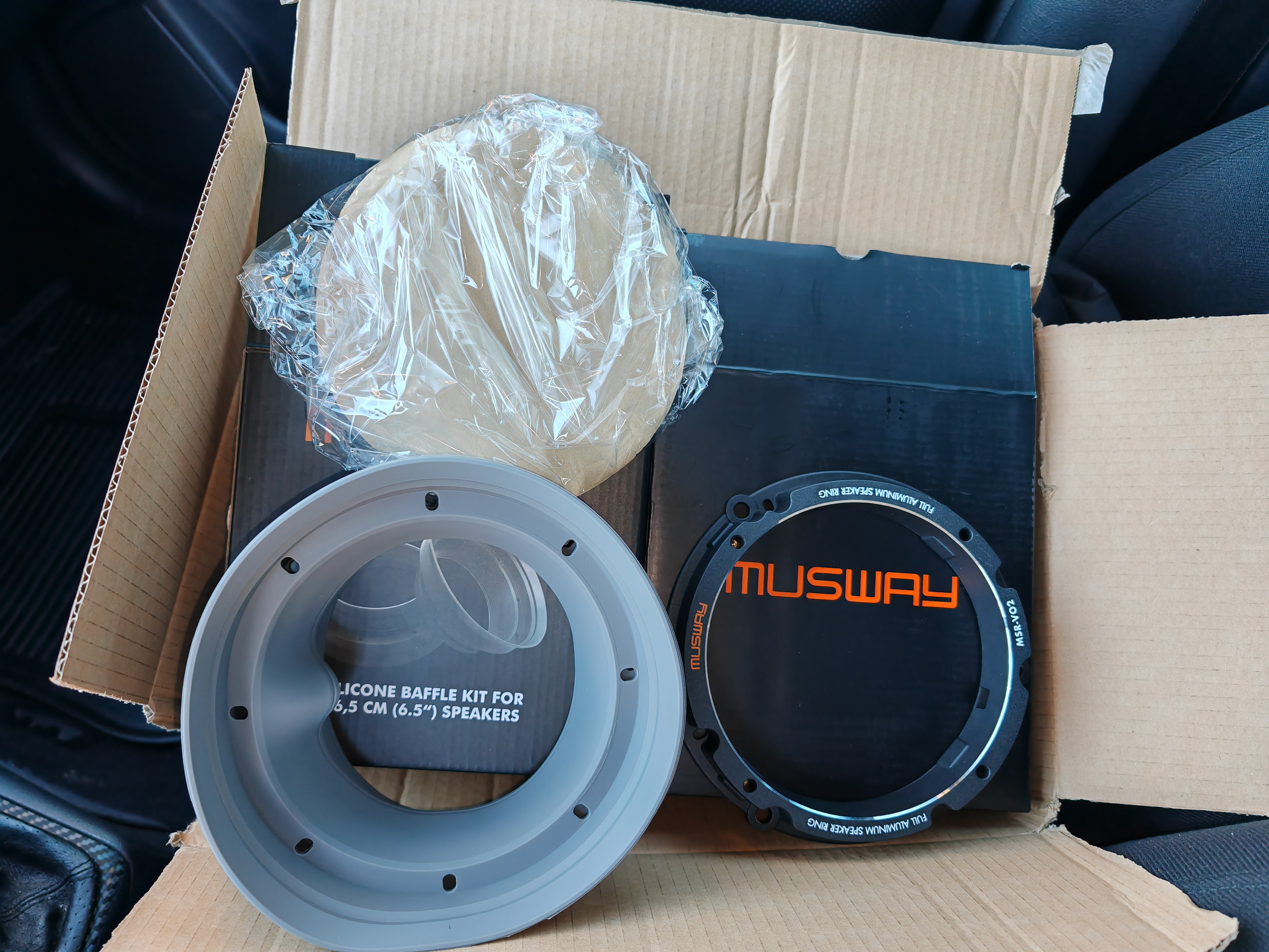

Time for stereo upgrade.
Just test fitted JBL bass hub (design award 2018) and fits perfectly, two set od Hertz Mile Legend EISA 2015/6 best product, Hertz 4ch DSP amplifier, alu ring adapter for front door, silicone sleeves and sponge and waiting for alu pods for A and C Pillar for tweeters, full car sound damping Will be done hehehehehe

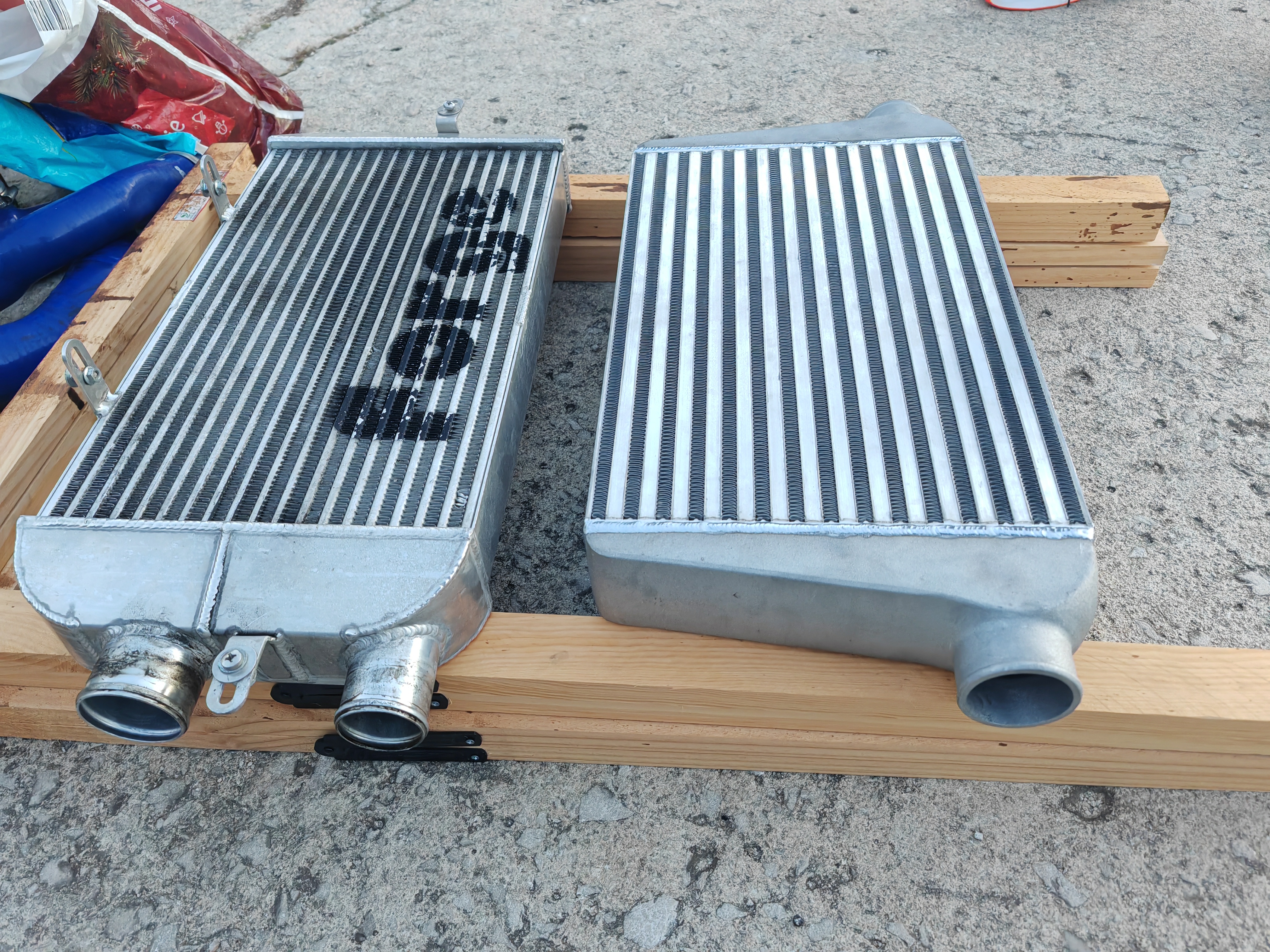

New Mann WK730/1 fuel filter in place

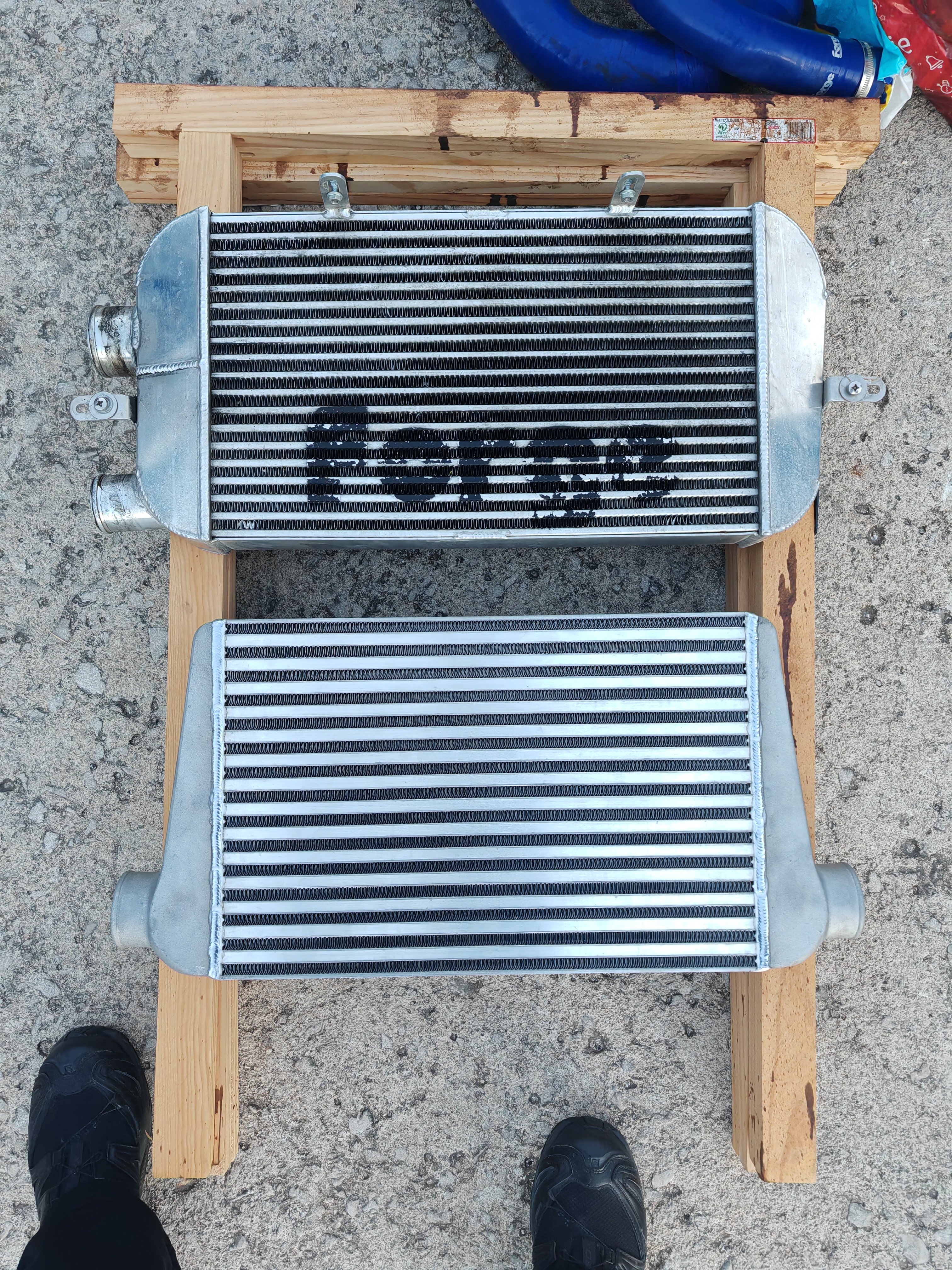

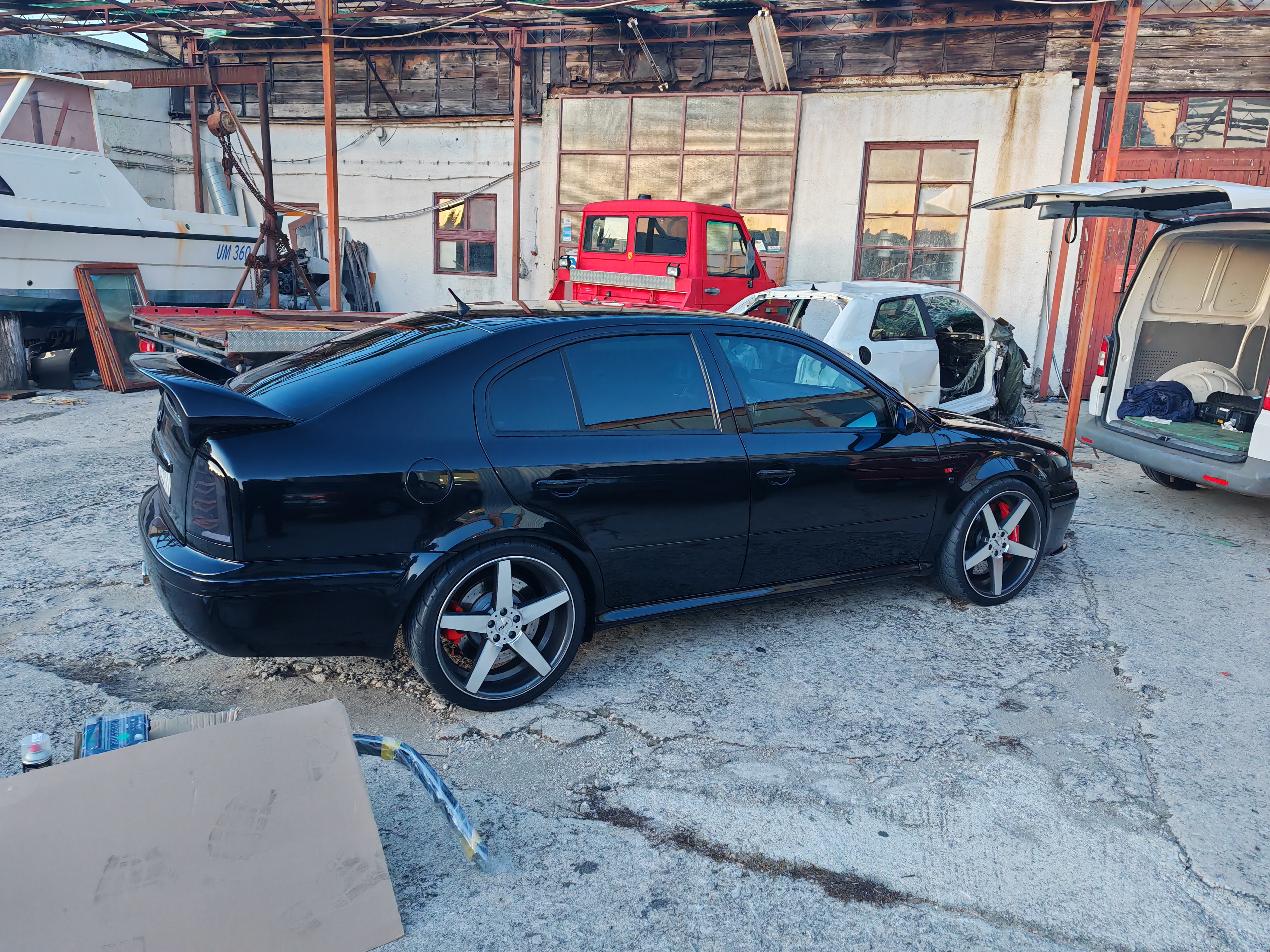

Car was left in Vesko racevar garage for the so long avaited installation of the new Garrett FMIC with 2.5" pipes all around.
Crash bar will be perforated and bumper cut for bigger mesh
Air filter Will be fully enclosed in new air box with air feed duct attached to it.
Box will be additionally thermo insulated with 1cm adhesive sponge with reflective alu film on it.
New air deflector in bumper will be made from Titanium, and adapted for the passage of new overboost pipe over driver side
On pictures you see how new core is thicker than old Forge one, same thickness as endtanks which are narrower than old Forge ones. I have measured old FMIC-core and endtanks and searched as crazy for the right one, from Wagner tuning (wanted their Competition core-fine tube)
to the Setrab and back to the Garret which turned out as perfect one.
Dimenasions are: 450x307x76mm rated for 750hp and perfect fit behind crash bar.

Intercooler looks spot on and i look forward to more updates, i run the Airtec mk4 golf cooler on mine , not twin pass and a tall thicker core compared to my old forge item.
