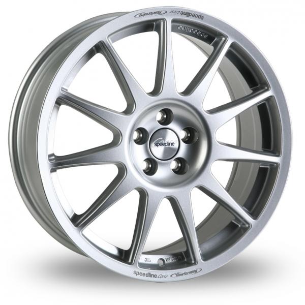

As above, lightweight wheels would be a must for me - OE in look but something light like flow formed Turini's perhaps.
These?
Any photoshops about on what they'd look like on a yeti?
I haven't forgotten to weigh one of my wheels Richard, I still don't have working scales :(
Speedline or Compomotive is where I'd look for lightweight, but strong. Designs tend to fit in with OEM for me too.
My 8x18 Turinis were just under 9kg per wheel, excluding tyre to give you an idea. Skoda 18" designs, Zenith and Neptune are 12-13kg.
they are the ones. Really good quality wheel and around 4kg down on an OE 18" iirc. Also, used to run OZ superleggaras - not quite so OE but another really nice option for quality and weight. I can confirm they also bend as opposed to shatter in an 'off'!
All the race derived OZ Racing, Sparco, and Speedline rims (as above) would work with the right offset. You need light weight, strong rims with sufficient clearance for calipers and discs. Looks are secondary.
If you want an OEM look, slap some Skoda badges on, and nobody would know...

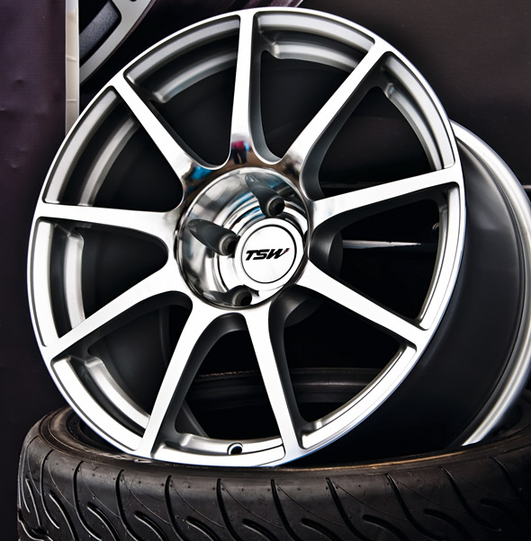

Having chased and tried to get the Speedline Turini, I've been told now by two different sources selling the Turini that they don't make these in the correct offset or a suitable fitment.
So I am looking at these, which come in at 7.7kg each in 17x8.  TSW, which I have to import from the USA.
