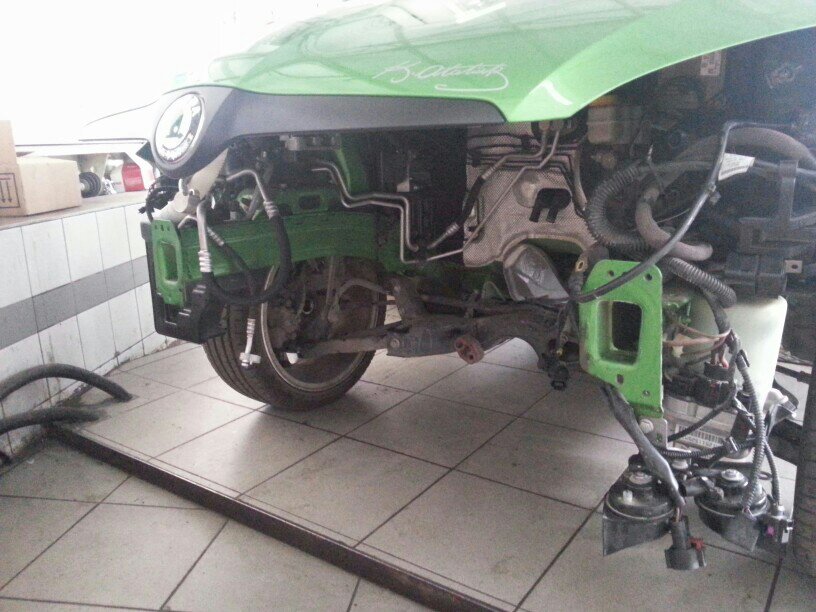

This my rs in local dealer... missing the heart...:D
