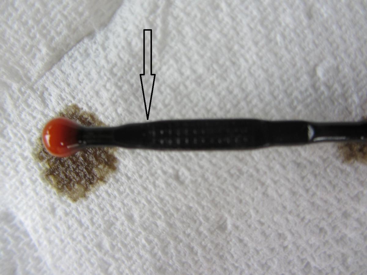

Had my car for just over 3 weeks now so decided to have a quick look at the oil just now when I got home from work (engine hot).  The oil just goes about 1 cm into the hatched area, compared to right to the top when I bought it.  I know it's going to use oil but as I've only done 350 miles is this still normal?  It's a 2012 plate with 3,850 miles on the clock now.  It's not as if I'm thrashing it either, I've only driven to work (roughly 20 mile round trip) and done about 40 miles on the M4.  On my trip to work I'm lucky if I can top 60 due to the traffic/country lanes but I might have topped 70 by a tiny bit (I'm 48 now so no boy racer).
You will get different readings with a hot reading, so it is good to know what a stone cold engine and oil reading is.
The cross hatched area is 15mm long, (1.5 cm) so i hope you are not showing 10mm (1cm ) down from the top when it is a hot dip.
.5 cm down from the top is OK,  but you could put some oil in.
What ever,
best get the cold dips & hot dips done and try to get the oil showing in the top 3rd of the Cross hatch with a hot dip.

George,
Probably getting my mm and cm mixed up!  The oil is in area c of that picture after a hot dip so it needs some oil, I'll take a cold dip tomorrow morning and see where it's at then.  The garage did give me 2 litres of oil but I didn't think I'd be using them this early.
The engine is just run in now and oil use should be very low.
Once you have 3.6 litres in you should be fine.
Please try the 'Jabozuma Oil Check' tomorrow or when Stone Cold.
Start the engine and stop right away.
That should show the same level as your Hot Dip.
Please let me know how it reads that why.

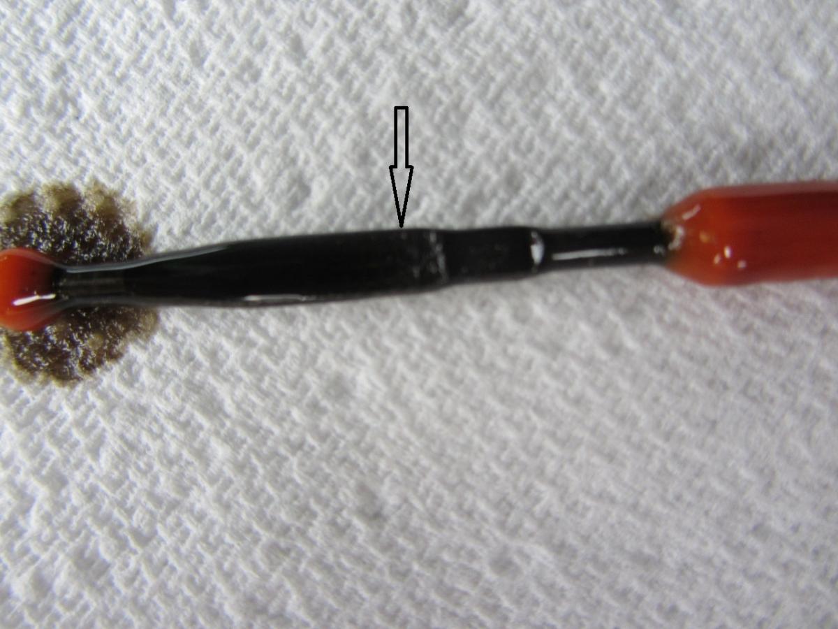

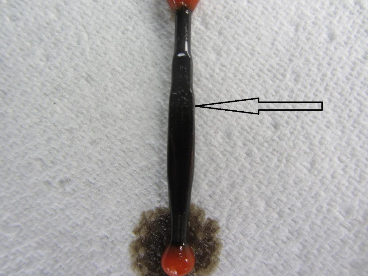

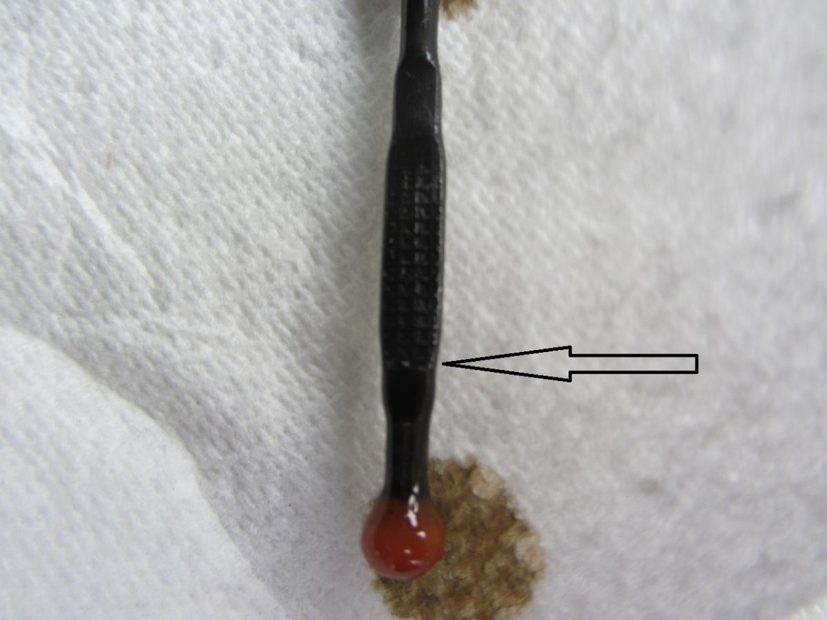

Just been out and taken the oil reading when my engine was stone cold and then did the start/stop reading.  Interesting pictures but which one do I believe?  Do I top up or wait till the light comes on?  In the start/stop pics the oil is in the same position as when I did it yesterday after I came home from work.
post-30617-0-80760800-1379746912_thumb.jpg   post-30617-0-21735800-1379746918_thumb.jpg
post-30617-0-43767800-1379746924_thumb.jpg   post-30617-0-59735200-1379746936_thumb.jpg
First 2 pics are from cold and bottom 2 from start/stop.  Camera skills not too good this early in the morning so I've stuck an arrow on there.
This is the level mine was at the morning after I had my new engine fitted, stone cold.

Milges, i suggest yours is just using what is expected & you need occasionally to put some oil in.
zom414,
You  need to talk about it with the garages if concerned.
*But it probably first needs some oil to show the correct level with a Hot Check and see if it uses oil or not.*
If the cold dip stays constant day to day and week to week and over the miles that is good.
if the hot dip is constant and high enough up the dip stick fine.
I have just over 3.6 litres in (3.7 litres) and if i go dip now cold the Oil will be just below the top orange marker.
If i do a Jabozuma check,
or go and run it and do a hot dip 5 minutes after stopping and the oil reached 80*oC, it will be just below the top of the cross hatch.
**That is the same place on the stick as where both your cold dips show but when checked hot.
& thats not only on my daily driver but when checking other vRS dipsticks..**
george

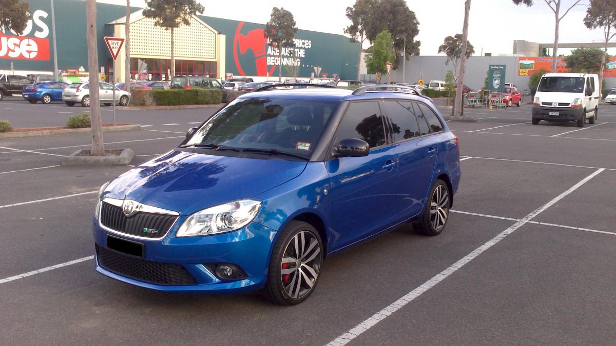

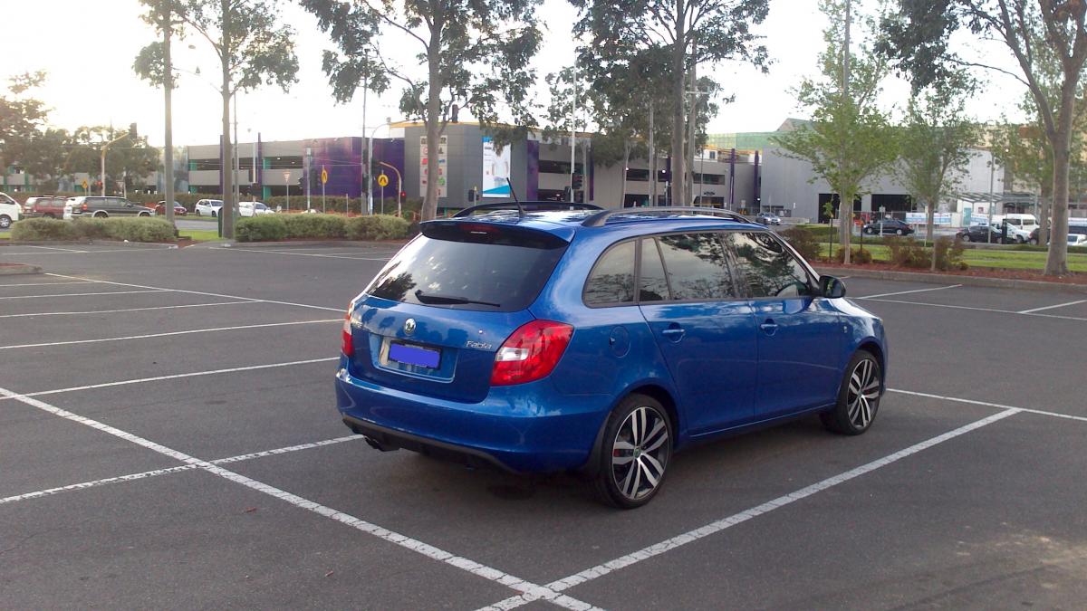

hey fellas,
I have just had my engine replaced (long engine) - picked up the car a few days ago. So far so good other than an engine rattle on the right hand side but will get that looked into at the next service. I also have to fix one of the doors which is not flush from original delivery.
Will post a few pics with more to come. As u can see my RS has tinted windows and rear guards. Will eventually get the monte carlo black lights and grill for the front as well.
good car and very rare over here which I like!
Edited by Luke Fabia VRS
more pics...I think will look hot with monte carlo grill and lights. stand by..
And some blue Osram repeaters  :happy:
1275934_10201423322157765_1913380216_o.j
Dexter - looks awesome! hot as hell!
