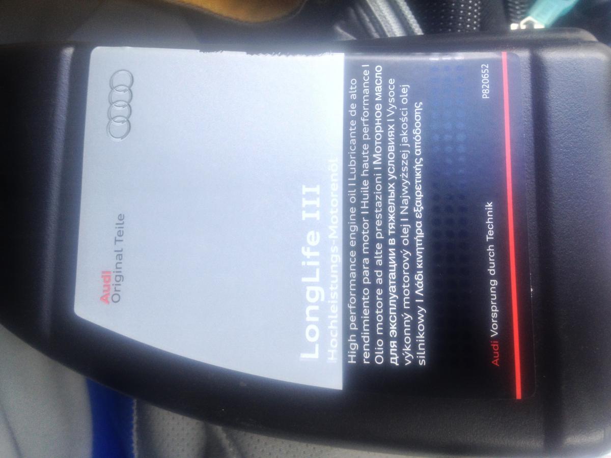

Hi guys type of oil required in our cars depends on the service interverals. I was told not to negotiate at all with the specified oil. Apparently it has been developed and designed for VW . I buy it from Audi which is in an Audi plastic bottle it is the Castrol
Edge. Anyone using the shell brand oil in Australia is not abiding by the directions of Skoda Australia. I got told an hour ago that it must be using oil recommended from Skoda and she'll helix is not recommended for fabia Vrs mk11
Got to go ! dealing with another ****.
Well the Castrol recommendation is good enough for me: I'll use that for top-ups in future.
A bit of digging around on the Castrol Australia website found this, which is recommended for our car and is VW 504/507.
Castrol EDGE Professional Longlife III 5W-30
For overseas Briskies, be a little careful, as I believe there are Castrol products with a similar name but are NOT the same equivalent.
Doesn't matter what brand you use as long as it has VW 504 00 spec on it. All oils with that spec I managed to find are 5W30 SAE rated.
In Victoria it is impossible to by a suitable oil of the shelf in a auto store. It is also a worry when Skoda assist don't carry the that specific oil. Went through all this with the mechanic and he refused to put Nything else but 5 w 30 . The only way you can get it is to order it through a supplier or by it straight form Skoda VW Audi service departments. Funny that , greedy ....
