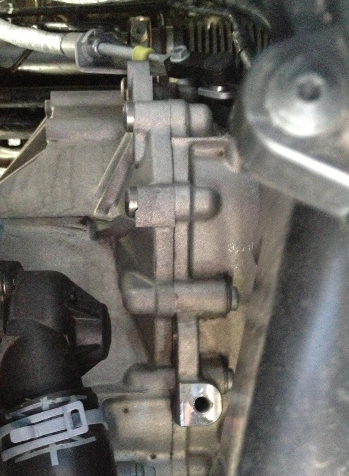

Sorry George can u please clarify for me what u mean about the mpg/100 in regards to engine replacement. Also anyone with the breather mod seen build up oil residue inside engine bay I steam clean it once a fortnight and have noticed this . Also can atone tell me what the go is I this photo in Lyman terms and mechanical
Sorry on iPhone this photo

Hijab anyone help me with photo above ?
