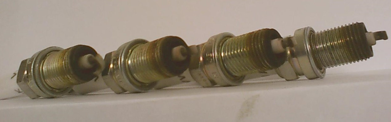

The service records indicate no plug changes before I purchased. I changed at 5.5 years 38k miles. Photo attached - they all looked pretty good, thew were Bosch Genuine VAG items.  I thought my Skoda service manual says something like 60k miles. Didn't fancy risking that!  They were double platinum so I suppose might last 50k miles.. I'd want to inspect though and by the time you've done that thought a new set wouldn't hurt.
I believe the fixed interval and correct VW 502.00 is what helps to keep your engine it that good condition. What I would check is the ACEA specification, even VW502.00 can have only Cx, what is not good for those EA888 as those need the "cleaning" power of "Full SAPS" oil. By the way, in Russia no LL service allowed, they must use only 0W30 VW502.00 and they especially highlighted it must be ACEA A3/B4. Isn´t it curious when VAG has its own norms? https://www.briskoda.net/forums/topic/419089-yeti-burning-oil-should-pistons-and-rods-be-replaced-as-well-as-piston-rings/?do=findComment&comment=4771837 Is sad that not all follow that ...
Your spark plugs looks in perfect condition, absolutely no oil in threads, no carbon on insulator/electrodes, perfectly clean. That must stay so for next thousands miles :cool:
I forgot to tell you, I changed mine on 1.8 TSI at 88kkm/54,6k miles and were still in a good shape, genuine NGK for VAG. Just sorry for the quality of the photo, must make better one soon.

Photo of plugs is reasonable. They all look good really, electrodes and insulators a little hard to see in detail of photo due to some blurring.  But with your attention and detail knowledge, I'm sure you examined closely on removal!
