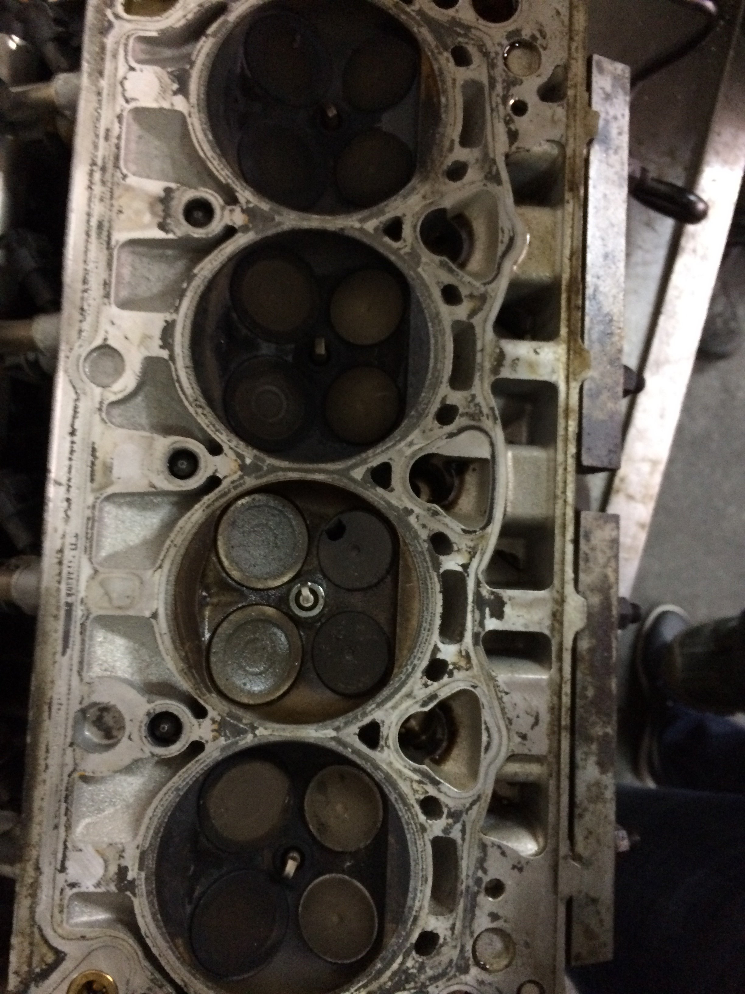

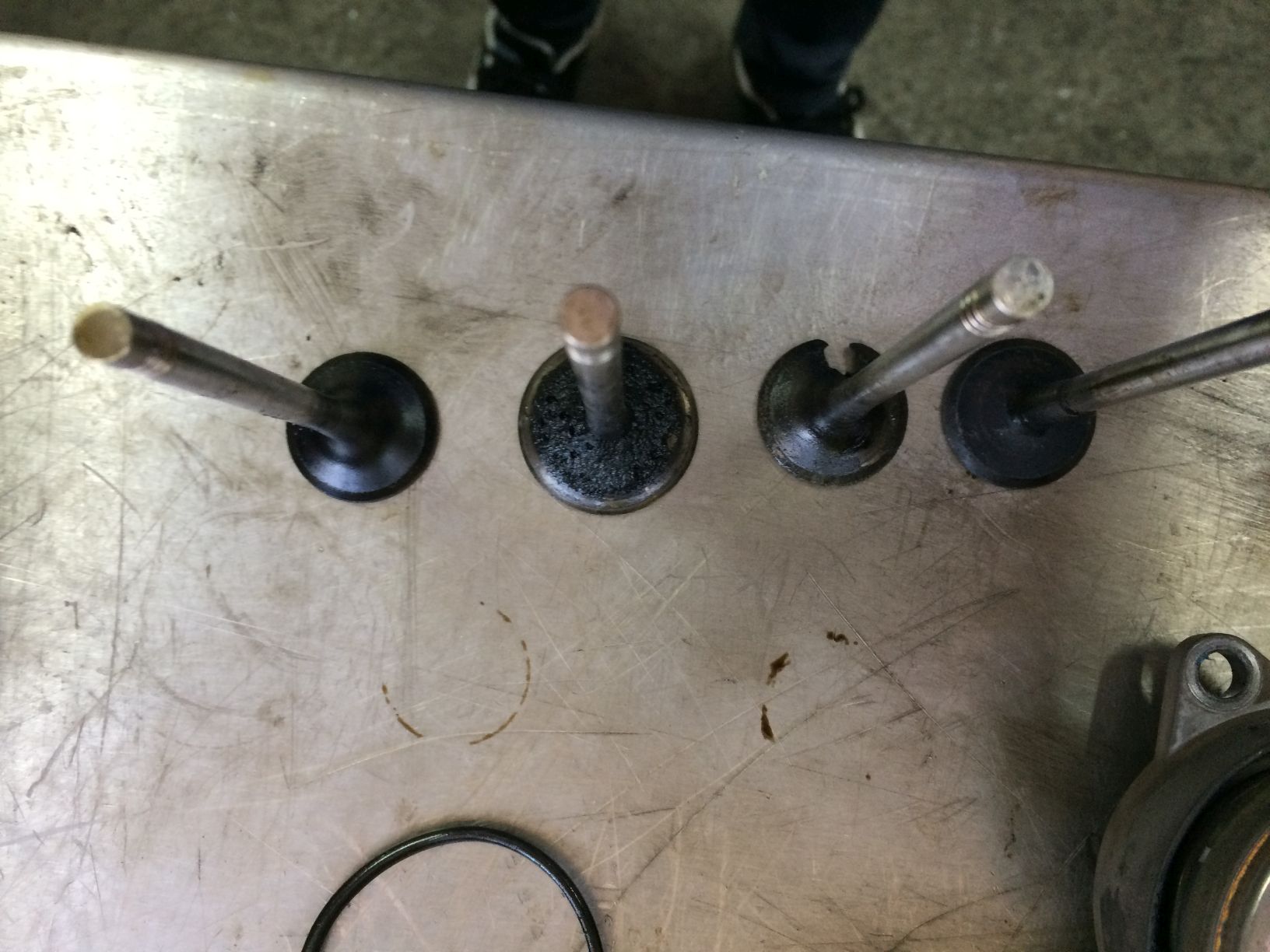

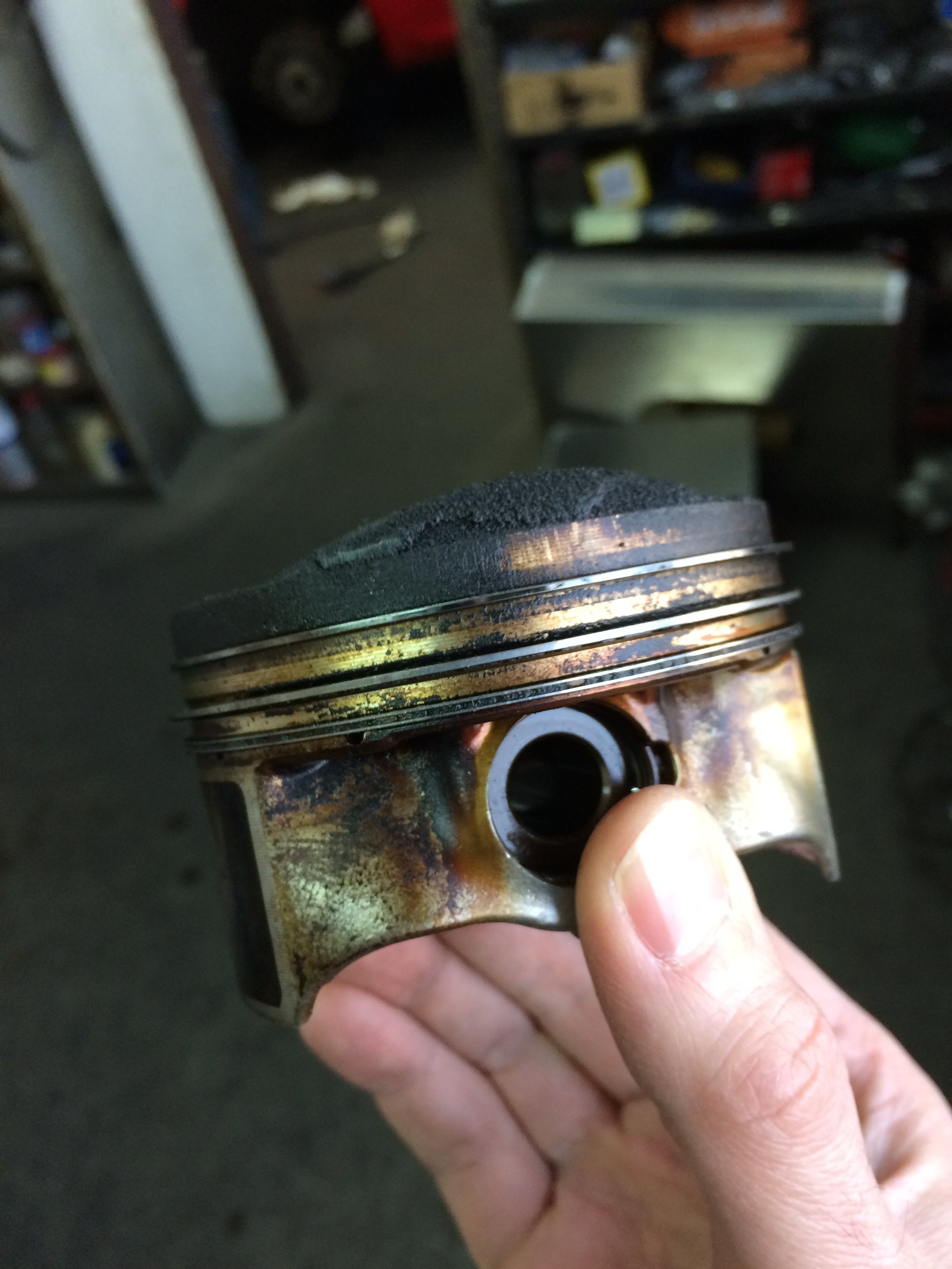

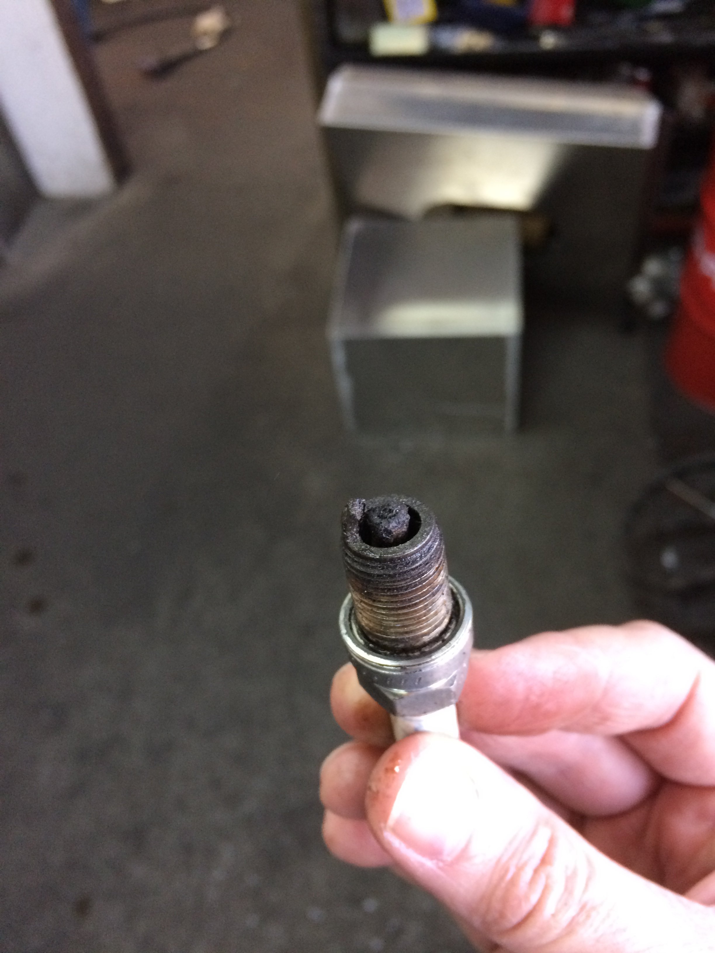

1,8 TSI (10/2009), cdaa engine, currently at 130.000 km (all standard)... Excessive oil consumption from 100.000 km and at 130.000 engine faliure.. broken valve, melted spark plug and piston... Currently in repair... Rebuild cost should be approx 3500 €.
Nice photo. The third cylinder down looks like the valve has a hole in it. The plug looks ok though maybe replaced initially?  Good luck, let us know how the rebuild goes.
Yep, spark plug on pic is new one.. Old one was melted.. Rebuild is progressing... Headwork already done.. Exhaust valves are replaced (were destroyed due to carbon deposits, which was most likely the cause for the hole in one of the valves), two new intake valves, everything else was cleaned and checked.. Then we got a repair kit from Tornau Motoren (GER; excellent service) consisting from all gaskets, all three chains and related tensioners, 4 pistons (with new spec rings and 21 mm connecting bolt), bearings (1150 €)... Now we have to put the bottom part of the engine together, then we need to check injectors and ECU to see what was happening.. Hope to be back on the road next week..
Sounds like the full works. Handy tip for supplier Tornau Motoren, never heard of them before.  I understand why you would want to check injectors, what are you looking at with the ECU?
ECU check is just to make sure everything works as it should and that all maps and sensor readings are ok...
Engine repaired (2500 €) and everything works ok so far (400 km). One of the exhaust valves broke due to bad material which done most of the damage.. And oil consuption issue is directly linked to DI and carbon buildup in the engine, blocking oil canals in pistons (especially ring no. 3; you can see the sooth in pic bellow)... Some new TSI engines are getting double injection (DI and manifold) with 8 injectors which solves the cause of all this..
Good luck to everyone with all those TSI engines..
Edited by KoJoTe
And carbon buildup on intake valves (130.000 km; and it's not actually that bad as some are experiencing)...
+ faulty exhaust valve..
The valve might not have been faulty. The carbon build up could have caused a hot spot on that part of the valve. Either way it hasn't helped.
True.. but we found some black spots and cracks within material.. And exhaust valves (at least in my case) haven't suffered so much from carbon buildup.. But yes.. we know where problems are..
I guess the exhaust valve got damaged by the electrode from the melted spark plug. Got in between valve and valve seat and ... Yes, only intake valves suffer from the carbon deposits because of DI as the first reason and retarded timing functioning as EGR as the second reason.
Edited by rayx

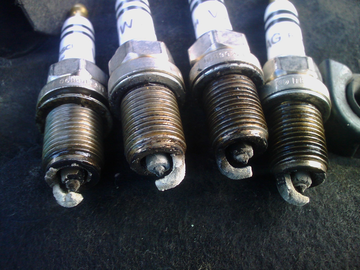

What causes the Spark Plug (edit: ground) electrode to melt or break off like that in the first place? Piston hot spot? Detonation from oil consumption? All or any combination of those?
Edited by TheClient
In the case of EA888 with higher than normal oil consumption I would say too much of oil in the chamber, that means higher temperature and longer burn than with petrol only. Trouble is that VAG limit of 0,5l oil per 1000km is too much already, I believe safe limit should be only up to 0,2l /1000 or 621. In fact, your mentioned reasons play surely a role too, but all begins with the oil. Temps can be that high that even middle electrode and insulator give up ... Few photos below collected over net

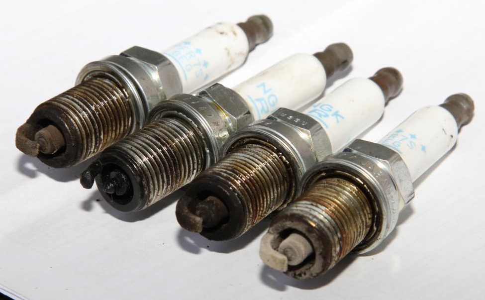

Not just with the 1.8 & 2.0 TSI's Plugs.
These are also often the cause the damage with 1.4TSI Twincharger engines with Oil Users.
Bottom plugs are OEM with 25,000 miles, top DENSO from the same engine with over 30,000 miles covered.
(VW changed the Plug Spec and the gap and never bothered changing the 40,000 miles Service Schedule / guidelines for changing spark plugs.)
The engine they came from is still fine at 70,000 miles on 3rd set of Spark Plugs now.
APR Stage 1 map and 99 ron having sorted out the crap Skoda Map / Engine Management.
& 5w 40 FS but not Castrol / Quantum Long life 5w 30 crap.

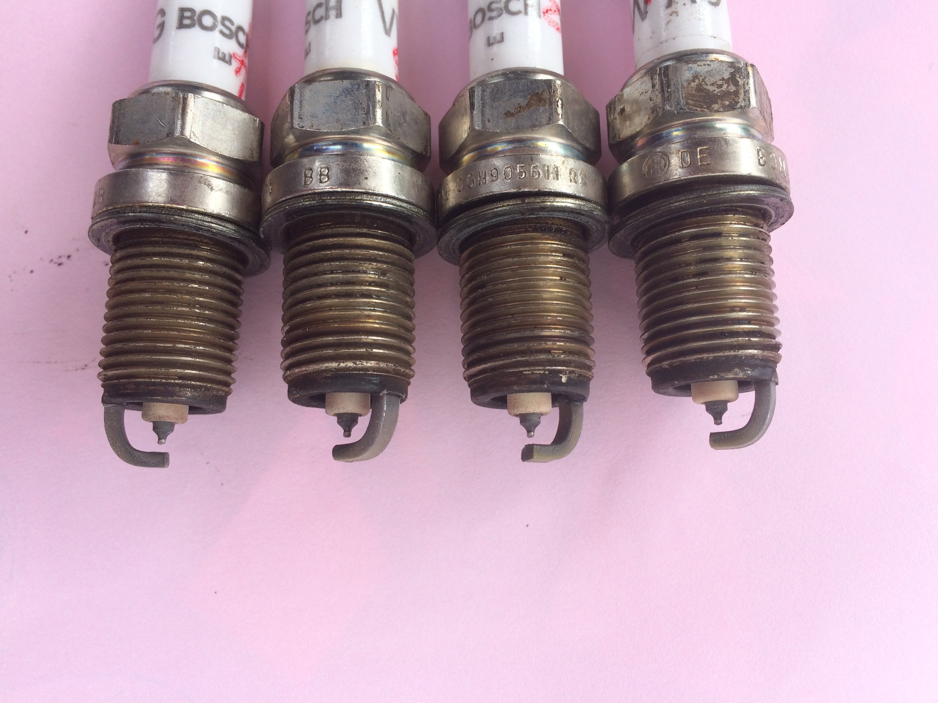

I've have had an EA888 2.0TSI in a vRS for 12 months. It's at 41k miles now. It doesn't use any oil between fixed interval oil changes. It has always been on fixed interval from new. I was running Quantum long life III 5W30 initially but now just go with Platinum 5W40 to  VW502.00. Mostly due to the fact the engine runs pretty hot, commonly (edit: oil temp) 100-105C on motorway and my thought process is the 30W viscocity could make oil usage and carbon build up worse at those temps due to thinning.
The service records indicate no plug changes before I purchased. I changed at 5.5 years 38k miles. Photo attached - they all looked pretty good, thew were Bosch Genuine VAG items.  I thought my Skoda service manual says something like 60k miles. Didn't fancy risking that!  They were double platinum so I suppose might last 50k miles.. I'd want to inspect though and by the time you've done that thought a new set wouldn't hurt.
