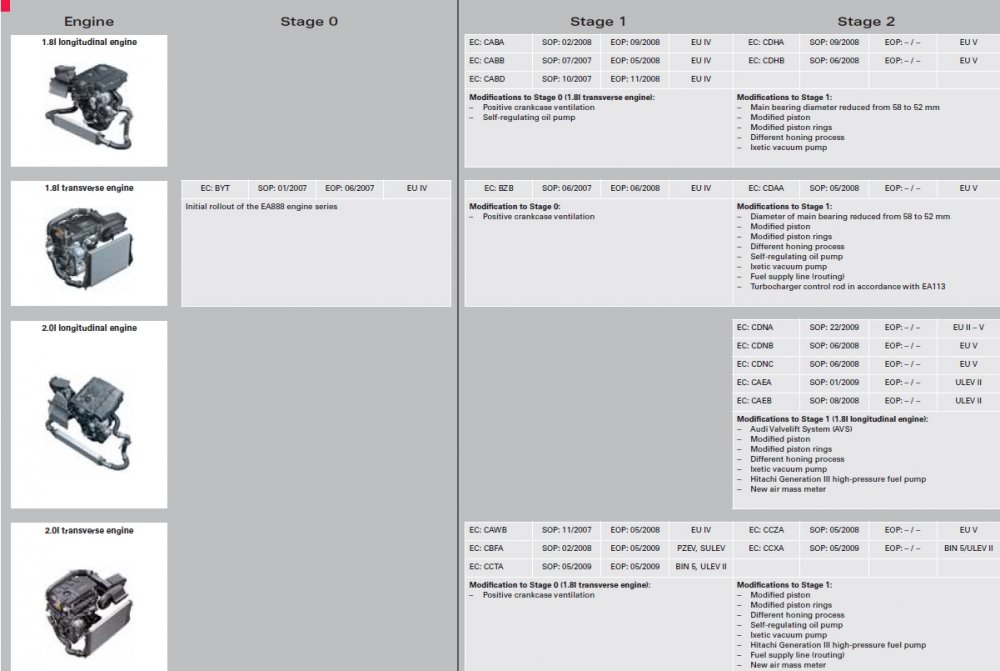

This thread is mainly about EA888 1.8Tsi and 2.0TSi engine failures, predominantly from timing chain / tensioner failures or oil usage from scraper ring failures.
You may want to ask a moderator to move your post to a thread in the main Octavia Mk2 section with a thread title of it's own to get better coverage.
I'm not familiar with the BZB is it a EA888 generation engine?  If it runs a two position intake runner that is what the intake fault maybe but you need to give more information on the faults recorded.
The intake runner often moves position in the high 2k to low 3k rpm range.  If yours does run the intake runner, you could remove / clamp the vacuum line or solenoid control wire and tie it up in one fixed position and see if it makes any difference.
Like I say, I'm talking as if it is an EA888 but not too sure it actually is.
Edited by TheClient
BZB is first generation, see attachment. But can´t see or hear anything wrong, too bad sound from inside the car. Get someone with diagnostics and check on iddle with bonnet opened for any rattle. The flaps could be the issue, stay closed till 3000revs, then must open.

Very interesting, from the attachment I notice that I have other segments and other types of pistons, maybe that's why not consume oil at all?

Yes, BZB are OK, no oil issues as with later CDAA. Surrely get solved the flaps, could be just their sensor, but it still needs to take intake manifold off the engine, not a simple job as injectors get off too.
