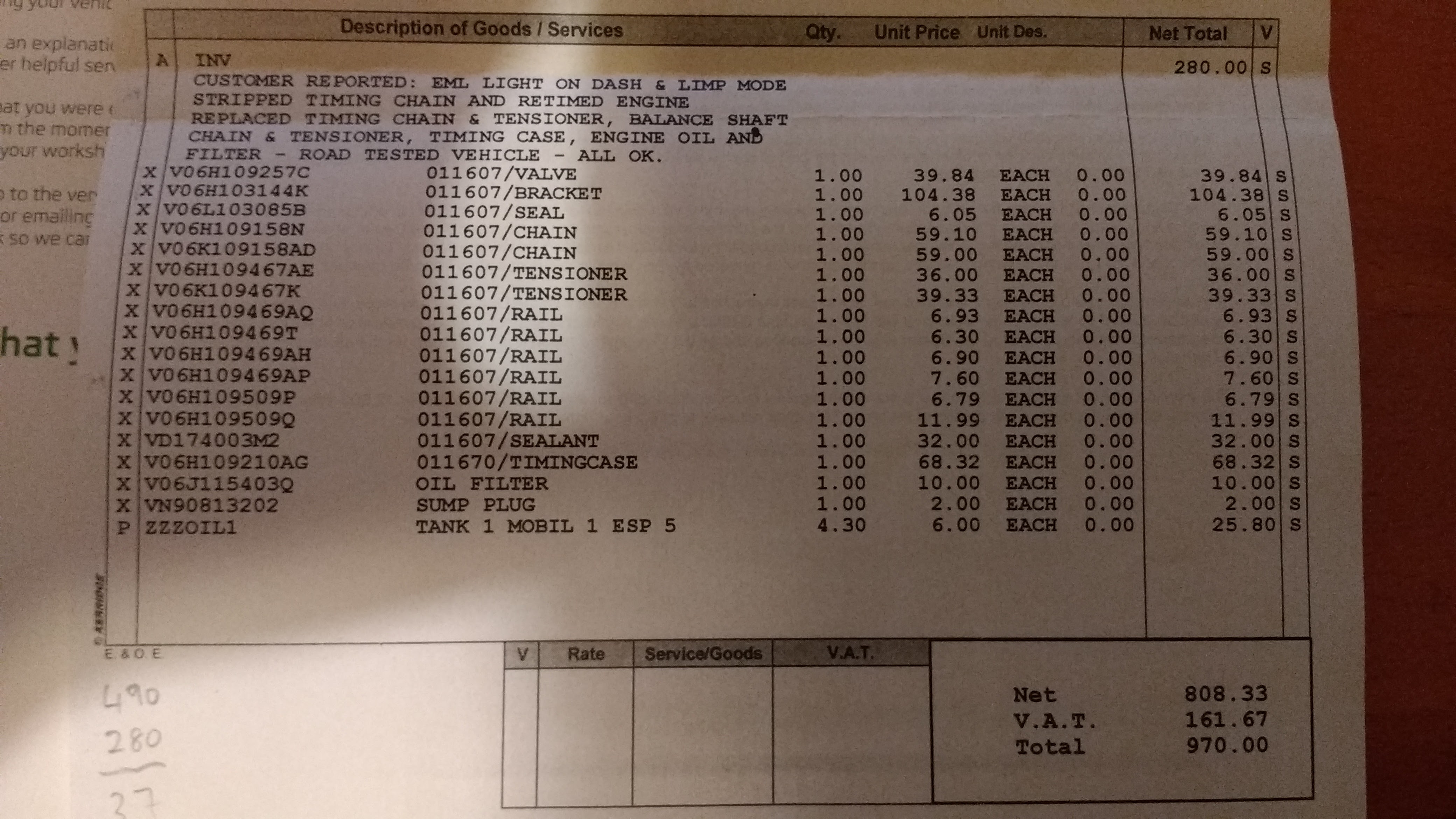

I have just recently also experienced a slipped timing chain on my 2011 VRS @70,000 miles, FSH with dealership, the car was with the dealer for about 4 weeks while repairs were completed. To be fair to the dealership they have been ok other than the time it took. They have charged £970 as it would appear I was lucky with no other damage. Is this reasonable? they say they have added a element of good will in to the invoice for labour, parts etc.  I have been in touch with Skoda UK and they have a case but they keep stating any good will is for the dealership to honor.
Well that is a little curious. I would say £970 is about normal Skoda prices for a Tensioner and Timing Chain replacement with rails, guides, seals and a new lower cover. The parts are a little over £300 inc vat. And labour time about 5 - 5.5 hours. so for skoda dealer probably £700, total £1000.
Not sure what goodwill they (the dealer) have included. Maybe ask them for a bit more detail on what extra work they did. Did they do more than what I've mentioned?
4 weeks seems a very very long amount of time for a job that can be done in a day, or 2/3 days at the outside if awaiting parts.  Did they have a problem with parts not being available or did they have a lot of trouble diagnosing the problem and that is why they took so long and also why the charge would of been higher?  That would not be a very good explanation of a higher charge or to apply the goodwill against IMO.   If you don't know, probably questions to put to them in a nice way of course.
As for Skoda goodwill, that is a slightly unusual response. Not the usual no.  They seem to not be willing to indicate whether they have provided goodwill support on the repair or not, and have basically said, if they had the dealer has to present it to you.  Lots of smoke and mirrors there. You need some answers from the dealer then.   It has been mentioned before that on here in some circumstances where Skoda meet goodwill they cover parts and the dealer covers labour but I am not sure if that is always or even often the case how Skoda UK manage it. Sometimes Skoda UK seem to take control of the entire repair and goodwill themselves with the dealer just carrying out the work and re-charging.
Worth a  few more questions with your repairing dealer I think to explain exactly what goodwill support you've been given here and what extra work was carried on. Presumably they've already explained to you the 4 weeks?  Is there an invoice with breakdown and goodwill deduction?
Hi, Thanks for the information.
I have checked the invoice and it breaks down to £280 for labour, £490 for parts for the fixed + sundries £37.00 all less VAT. Certainly there has been no discount on the oil, filter and sump plug as the individual items are more than i was charged for my service in Sept 2016.
I was probably a little unfavourable to say 4 weeks! i was without the car for this time but the dealer did have the car for at least 3, a bit slow in the diagnostic and deciding what to do,  waiting for equipment, parts etc . I would rather they took the time but i wasn't confident initially they knew what was best course of action.
Skoda UK have been very guarded and measured in the discussions we have had so i don't think they have as yet agreed anything with the dealer.
I am due a call from the dealer / Skoda tomorrow.
I certainly feel something is not quite right with what has been invoiced and i feel more confident to continue to challenge the cost with the information you have provided. I also think there is still more issues with this type of engine in general which Skoda have not admitted to me yet.
Lets see where tomorrows conversation(s) lead. :)
Yes, a little guarded for sure and slightly unusual this. Certainly that is cheap labour charge for a dealer. But the parts are more than a genuine cam chain, cam chain tensioner, seals, guides, rails and lower cover, so they must have replaced some extra parts (the £300-£330 I suggested include a new oil filter and 4.7 Litres of Oil), you should be able to see on the invoice what they have replaced. Did they do the oil pump chain and tensioner or balance shafts or something else as well?
Normally, if applying goodwill it would be reasonable to expect a total invoice with a goodwill credit visible or at least an explanation of what they have deducted from it on the phone before pick up and payment.
It sounds like they faffed around with the diagnosis a bit which ought not to be your problem or IMO consume any of your goodwill credit. See how you go. Be nice it costs nothing, usually works better.
Edited by TheClient
I have managed to copy invoice IMG_20170713_221516904.thumb.jpg.46ceeee76c3a92ab0d8c90858f669812.jpg
Goodwill is perhaps a reduced labour rate. That's what my dealer did for me when replacing my engine.
Yep, well that breakdown is clear. They have given you 50% or more goodwill on labour, probably amounting to ~£400.
The job is a bit more expensive than the indication I gave because they have done one balance shaft chain and tensioner and camshaft control valve. They don't normally need doing. There are two balance shafts. They must have seen a problem.
In you discussion, your focus should be on the parts cost as there is no goodwill in there and it is now the majority of the invoice.
If nothing is forthcoming I'd move on, you've come out of the situation with mild bruising when others have been admitted with trauma.  In full engine failures from the same fault many have got not a penny. You are actually lucky, even though you may not feel like it.

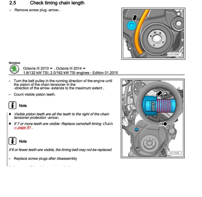

My local Skoda service centre said it is easy to check the earlier tensioner to see if impending problems or the latest. He also said the 7-speed DSG in my 2011 Octi needed no oil change.
^^^ Did he mention the World Wide Recall on the 7 Speed DSG / DQ200 which included Australia and might include yours as it is from 2009-2012
Synthetic Oil Changed to Mineral & a Software update?
Was yours done or needing done.
This was Skoda New Zealand's 'Service Campaign / Recall Action'.
http://skoda.co.nz/news/dsg-service-campaign
I see that checking timing chain length is for  Octavia 3, 1.8/2.0 tsi engines  for years 2013 and 2014. I presume this method does not apply to Octavia2 1.8/2.0 tsi FLs.
Yes, the images a few posts ago refer to the Mk3 TSI.  Not sure why they were specifically linked. The mk2 EA888 is similar though.  There is still has an inspection plug on the lower cover and you can count the teeth extended on the tensioner probably with an enlarged inspection mirror.. I can't remember off hand the number of teeth acceptable, I'm guessing 4 or 5.... There are some posts linking to the TPI's in this very thread, it's a very long thread to wade through though. Set aside 5 mins or so - maybe more!

Just an update to my original post from July, I have now agreed to a refund of £400.00 to be made by the dealer from my posted invoice. This money has been provided by Skoda UK and dealt with as a warranty claim payment. It has been a long draw out affair mainly with problems of communication between Skoda UK and the dealership. No real explanation or than as above although Skoda UK said that the dealership should have liased with them more before the repair was costed, done  and invoiced.  The car is running fine but i feel i have come to the end with this vehicle so intend to sell.
