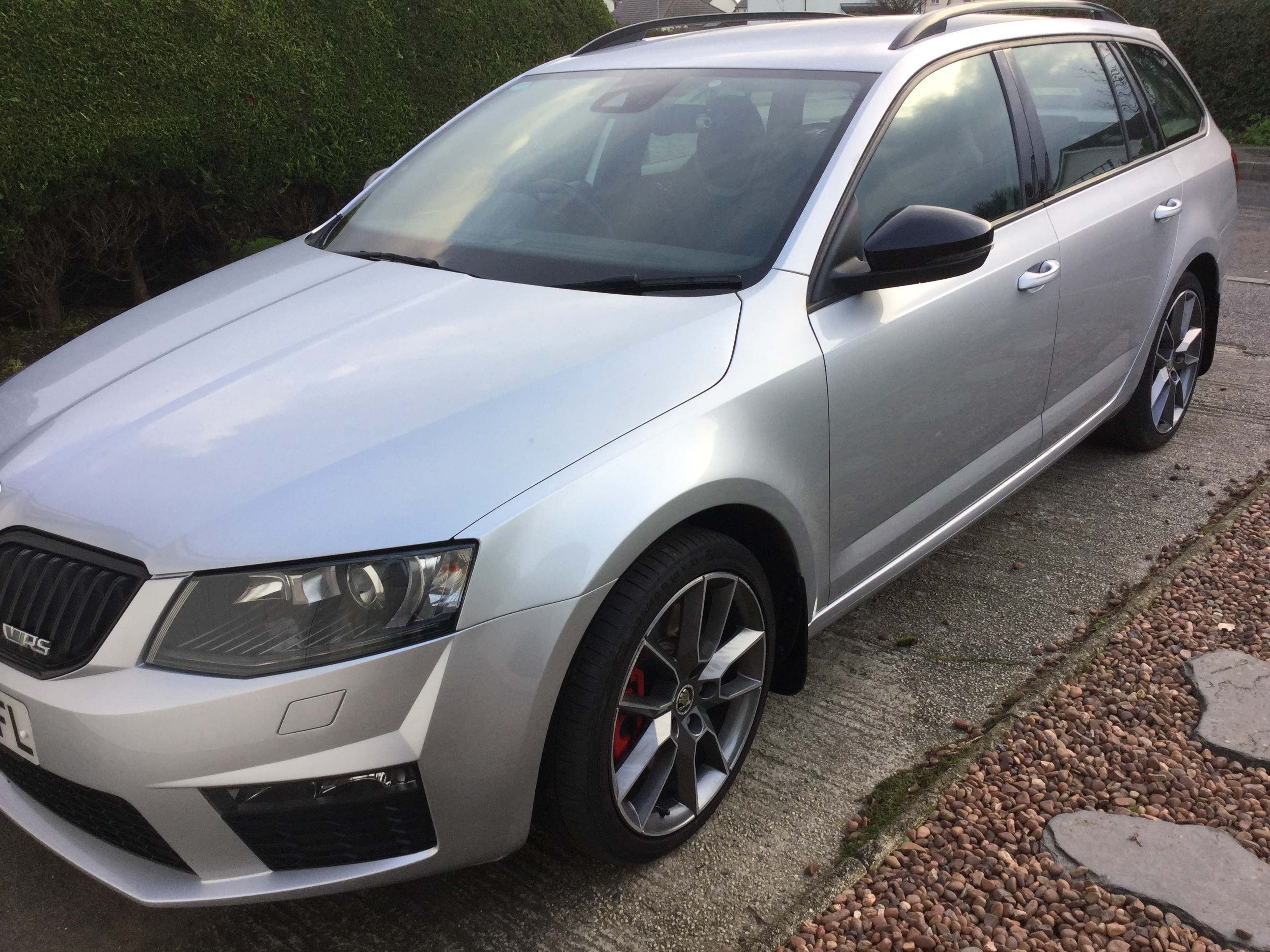

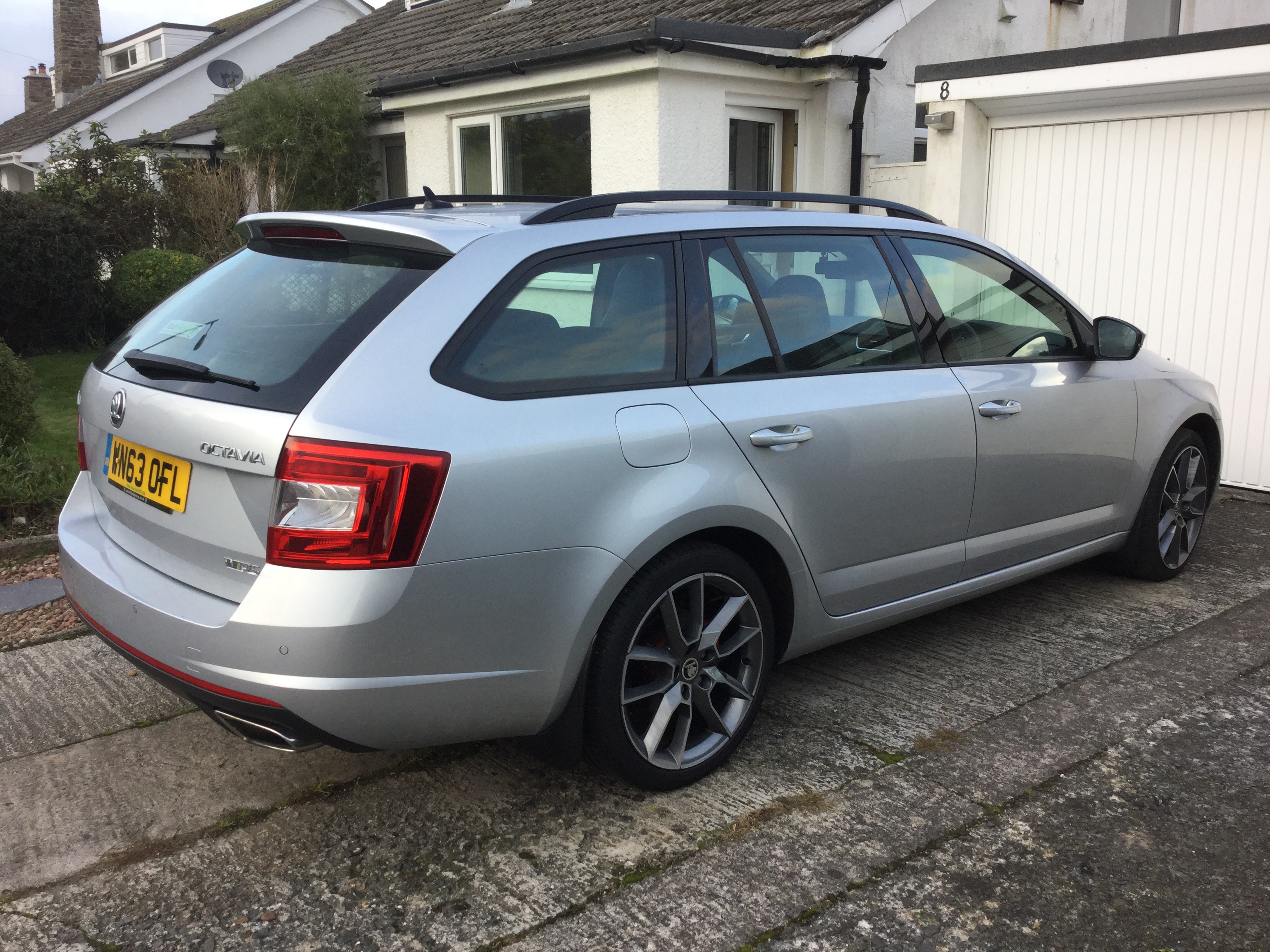

I bought the Skoda Parts Ireland Octavia III Winter Protection Pack a few weeks ago. Came to  €100.88 (€18.45 delivery). It’s taken about 1:45 to fit all four mud flaps and they fit well and look decent.
With the amount of debris we get on the roads in our agricultural area (intense veg and daffodil growing) left by tractors and trucks I’ll be glad of the protection this winter.
I took the front wheels off as I needed access to drill one 7mm hole in the wheel arch liner but managed the rears with the wheels on. I couldn’t locate the metal clips for the additional fastener on the inner part of the rears so I just put them behind the wheel arch liner and used the metal screw. Good to finally find a bit of DIY that I can do on this car and I’m happy with the look of the finished job.
