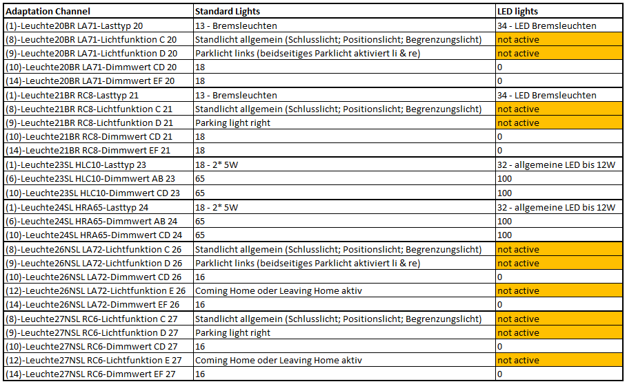

Courtesy of Flo - LED number plate light coding.
Original thread here.
When the w5w bulb in rear plate is replaced with a led bulb (even if it's canbus error free) an error is displayed in the Infotainment. It's possible to use VCDS for using led bulbs:
-> Controller 09 - Central Electronics
-> 16 - Security Access - enter 31347
-> 10 - Adaptations
Change the 2 channels listed below
(1)-Leuchte25KZL HA59-Lasttyp 25  -  set to: 43 - allgemeine LED
STG09_Bordnetz_Anpassung_1-Leuchte25kzl-
(6) Leuchte25KZL HA59 - Dimmwert AB 25  -  set to 127

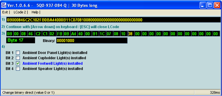

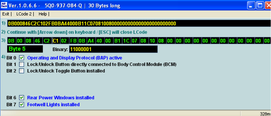

Coding – Long coding (I used the latest vcds Beta 14.5.3 as this shows the labels for the Bytes – the 12.12 version just show tick boxes).
Go to Byte 5 and ensure Bit 7 is ticked – Footwell lights installed.
Go to Byte 17 and ensure Bit 3 is ticked – Ambient footwell lights(s) installed.
Hit Exit, allow the coding to be changed and that should be that.

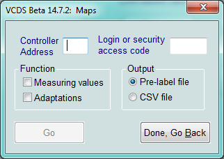

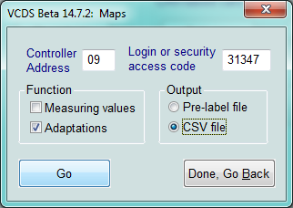

How to capture an Adaptation Channel map
As there are many variations in spec, and different controllers appearing in MY2015 cars, I am receiving a number of requests for assistance as Adaptation Channels may be different than the ones posted. One example is DRLs between cars equipped with Xenons and those without.
To find the correct channels, grabbing an Adaptation Map is the way to go. This is most useful on Controller 09 - BCM (or CECM).
Before you start make sure that your laptop battery is fully charged as it can take 10-20 minutes and you are using the latest Beta of VCDS, which is 14.7.2 as of 28/08/2014.
So, how to grab an adaptation map of Controller 09
As usual, with ignition on and engine not running.

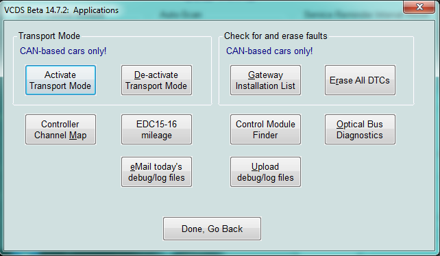

On the VCDS main screen select Applications
Then select Controller Channel Map
Enter the below details:
Controller Address (in this case 09)
Security Access code for the controller to enable adaptation access (in this case 31347)
Select Adaptations
Select CSV file (not essential, it will create a CSV file anyway)
Then click Go and wait .....
When it has completed you will have a spreadsheet in your c:\Ross-Tech\VCDS-Beta\Logs folder named something like adpmap-09-5Q0-937-084-Q.csv
This can be opened with any spreadsheet program to have a look at the values. Your German needs to be up to scratch!
I would highly recommend doing this on any controller you are going to make changes to before you start!
Also, if you do an autoscan first, save it and keep the log file open before making any changes, every change you make is documented so you can back-track.
And as a last resort, in your VCDS-Beta folder there is a Debug folder with a CodingLog file in it that details every change you have ever made in a less user friendly manner.

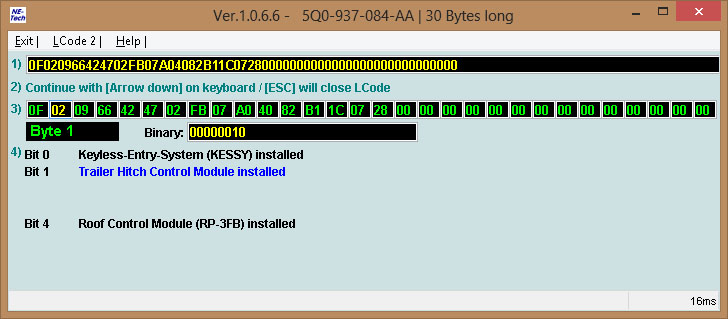

How to code official towbar electrics
Courtesy of pncarrerars
Original post here.

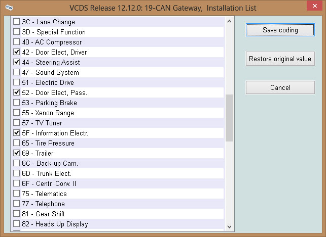

CAN gateway - Enable 69-Trailer
post-107742-0-34919100-1409668666_thumb.
BCM - Controller 09 - Enable Byte 1 Bit 1 - Trailer Hitch control module installed
post-107742-0-94097900-1409668710_thumb.

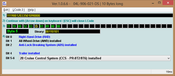

Engine - this may vary between engine types - Enable Byte 5 Bit 4 - Trailer installed
post-107742-0-12754300-1409668717_thumb.

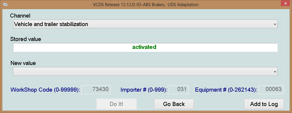

ABS - Adaptations - change Vehicle & Trailer Stabilisation to Activated
post-107742-0-99507700-1409668706_thumb.

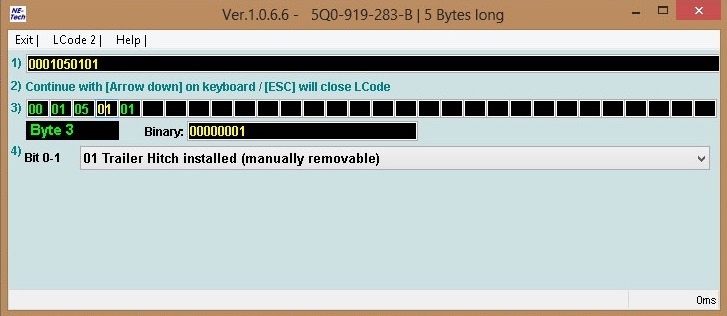

Park Assist - Byte 3 - Change to 01 Trailer Hitch Installed (manually removable)
post-107742-0-59260400-1409668719_thumb.

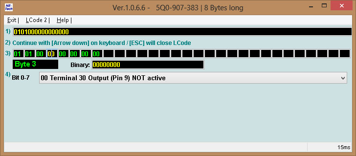

Trailer - Byte 3 - Choose the appropriate option
Byte 1 - Set to 01 - Trailer connector diagnosis active
post-107742-0-12196800-1409668722_thumb.
post-107742-0-49964200-1409668724_thumb.

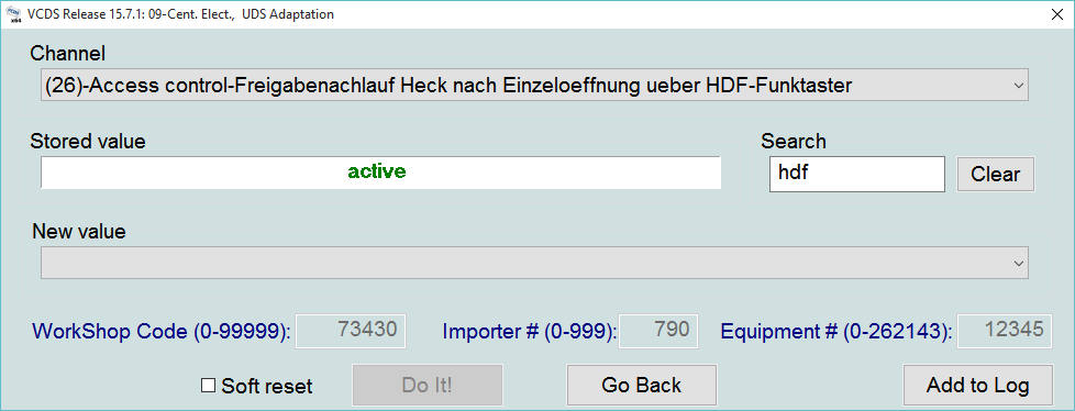

Enable trunk lid lock delay
This will enable the delay on locking the trunk lid when opened from the remote when the car is locked. So, if you shut the trunk and then realise you have left the keys in the boot it doesn't lock straight away, you have about 27 seconds (thanks @mberger for timing it) to open it again before it locks.
Controller 09
10 - Adaptations
Change (26)-Access control-Freigabenachlauf Heck nach Einzeloeffnung ueber HDF-Funktaster to active
  • Like 4
