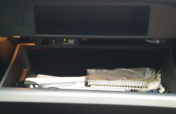

My dash cam is the Blackvue DR650 so it has two cameras that record front and rear. I've also got a Power Magic Pro to handle the power side of things. Those are the two bits of kit I'll show you how to fit here, but please do your own research and choose what's right for you.
d5d24436-6b7f-418f-9358-f9c47bb687d6_zps
The Power Magic Pro is already stuck to the car, but it looks like this
The purpose of the power magic pro is to keep your camera running while you're away from the car without running your battery flat. It has a series of jumpers which allow you to set either the battery voltage it will turn the camera off at, or the amount of time to run the camera after you've turned off the ignition. I have mine set to turn off once the battery voltage drops to 11.8v and that seems to work fine for me. You don't need one of these to run a dashcam as they all come with cigarette lighter sockets, it's just for the added benefit of battery safety.
You'll also need a pair of these Add A Circuit Fuse Taps.
I got the pair for less than £4 from eBay. Be sure to get full size ones and not the mini version. You'll need two 5 amp blade fuses to go in them. I also got a plastic panel removal set so as not to damage the panel you need to take off to access the fuse box. A screwdriver may do just as good a job but I didn't want to take any chances with damaging my trim.
First step is to fit both cameras where you want them. I found that with mine I could mount the holder for the front camera at the very bottom of the black bobbles to the side of the rear view mirror, which kept it hidden behind the mirror from the driver and also meant the windscreen wipers cleared the glass in front of it when it was raining.
Next, remove this panel from the passenger side (on U.K. cars) of the dashboard.
Which will reveal this cavity
Here you can see why I didn't photograph my Power Magic Pro, as it's already stuck to the inside of this recess. I used a piece of double sided adhesive that came with it to attach it, and it stops it from rattling around in there. Should be easy to remove when I change cars. Now you need to remove your glove box. There are instructions at the back of the owners manual with a diagram of how to do it. It's in the "Fuses" section of the book. Essentially you need to unhook a little arm from the back to the glovebox by poking a screwdriver through a hole which you can't really see in the picture above. Then it's a case of pulling the glovebox upwards to dislodge it. Be brave.
Once the glovebox is out your fusebox will be revealed.
You may have more or less fuses depending on the options you have fitted to your car.
The Power Magic Pro has three wires that you need to hook up.
(BATT +) Yellow wire - Needs to be connected to an always on fuse.
(ACC) Red wire - Needs a fuse that is only live when the ignition is on (also known as a switched live).
Black wire - Needs to be earthed.
In the photo of the Power Magic Pro above I have loosened the bottom of the three bolts to the left of the recess and attached the black earth cable underneath it. I've checked the whole area with a multimeter and you can't really go wrong there wherever you put it as the whole metal plate, and therefore the three nuts are all earthed. The Yellow and Red wires, as you can see, are fed over the top of the metal plate and through a small hole there that drops down to just above and to the left of the fuse box. You'll easily find it with your fingers.
Once you've got your wires through feed the bare ends into the ends of your Fuse Taps and squash the metal ends to lock them in place.
If you glance back at the picture of the fuse box, we're going to use fuse 47 for the switched live (red wire). Fuse 47 is the blue one on the bottom row and is the fuse for your rear wiper. For the always on current (yellow wire) we'll use fuse 40 which in the picture is the yellow fuse on the row above. Fuse 40 is for the cigarette lighter socket.
The first step is to remove both of those fuses. Next, put one 5 amp fuse into each of the fuse taps in the slot directly above the wire. Then put the fuses you've just removed into the spare slot on each tap, which should be the closest slot to the metal pins on the end of the tap. The tap on the red (BATT+) wire should now look like this.
And the yellow (ACC) wire should look like this.
It's very important you get these the right way around.
Once that's done plug the fuse taps into the slots in the fuse box where you removed the fuses from earlier. Red wire (which now has a blue fuse in the tap) into slot 47, and yellow wire (with yellow fuse) into slot 40. It should look like this.
The fuse numbers are embossed into the plastic of the fuse box if you look closely, so that makes things a little easier.
Now, so long as you have your earth wire connected to one of the bolts mentioned earlier you are good to go. It's simply a matter of plugging the power cable from the camera into the cigarette plug on the Power Magic Pro and you should have power. Note that there is an On/Off style switch on the power magic. If it is set in the On position it will provide power to the camera whether the ignition is switched on or off. If, however, you have it in the Off position it will only provide power to the camera when the ignition is turned on. I haven't mentioned how to set the jumpers for voltage or time limits, but there are too many permutations to cover so I advise you to look in the instructions. It's very simple.
All that remains for you to do now is route the power cable and the connecting cable for the rear camera. Both of these can be tucked into the roof lining along the top of the windscreen quite easily. From there I ran mine tucked into the top of the A pillar, and brought the power cable down the door side of the A piller into the recess where the power magic is. The cable for the rear camera I just carried on around the edge of the roof lining all the way to the back of the car.
Once your glovebox is back in place and you've put the plastic panel back on it's job done. Make yourself a cup of tea.

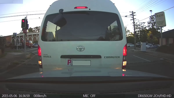

The dashcam paid for itself 2 weeks ago when a Toyota mini bus decided it needed to reverse when stationary at a red light. Luckily he stomped on the brakes after hearing me leaning very hard on the horn, so impact ended up being small, with just a small crack in the grille surround near the bonnet catch.
Any harder it would have been an insurance job and he could have easily claimed I ran into the back of him and I was in the wrong. Once I pointed out that I had a dashcam running, it took that option away from him so it ended up amicably. In Australia, the rear car in a nose to tail accident is automatically in the wrong unless you can prove otherwise.
I can imagine which way an insurer would usually tend to go without hard evidence the vehicle in front reversed from a stationary position at a red light - the reversing lights are very incriminating in this case, not to mention my indicated speed of 000kmh.
