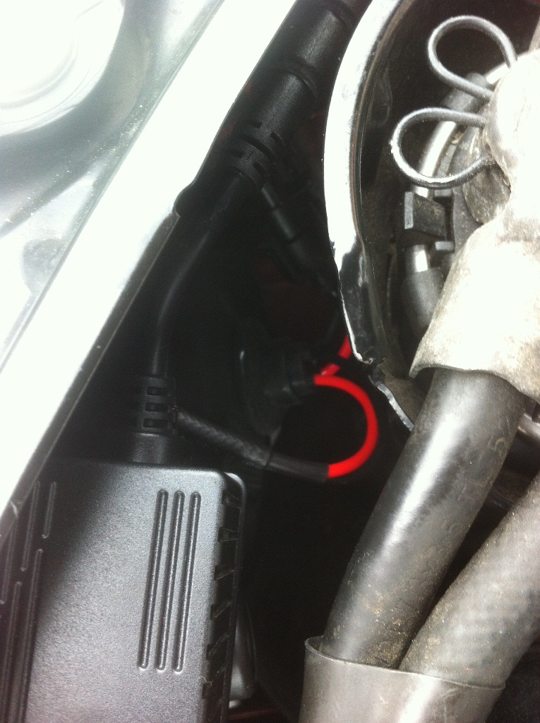

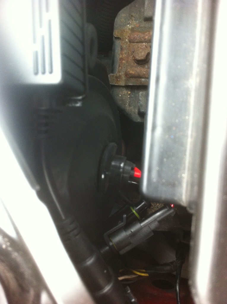

  • This should help clear up a few confusions about "how hard it looks" or "where does this wire go".   My kit arrived a moment ago, and in this pic I've laid it all out nice and neat. You have the 2x
  • It's not the ballast that is the problem, like I said they were both sides secure on the slam panel already at this stage. It's the bulb. For some reason I just can't get these new holders to twist in

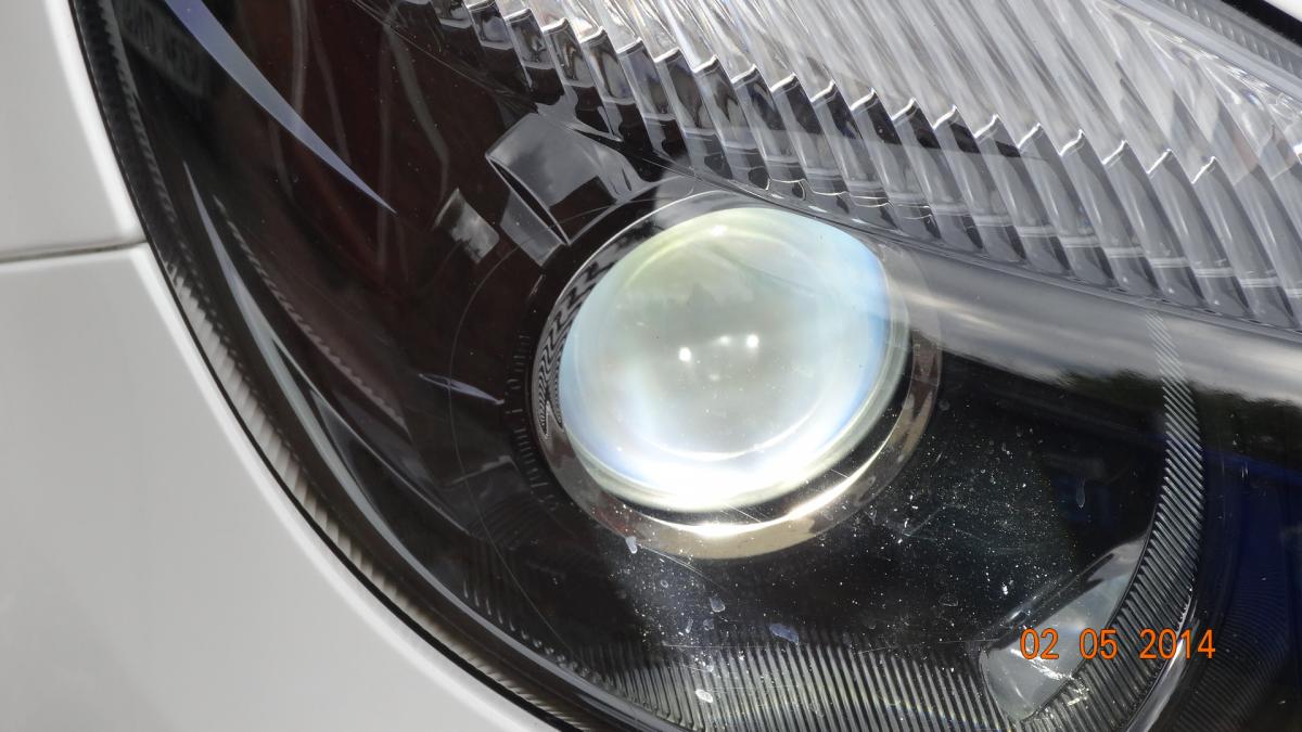

We fitted 6000k for Matty tonight, nice and white, surprisingly so.
Side by side they were noticeably whiter than my 4300k set up in the same projector lamp units.

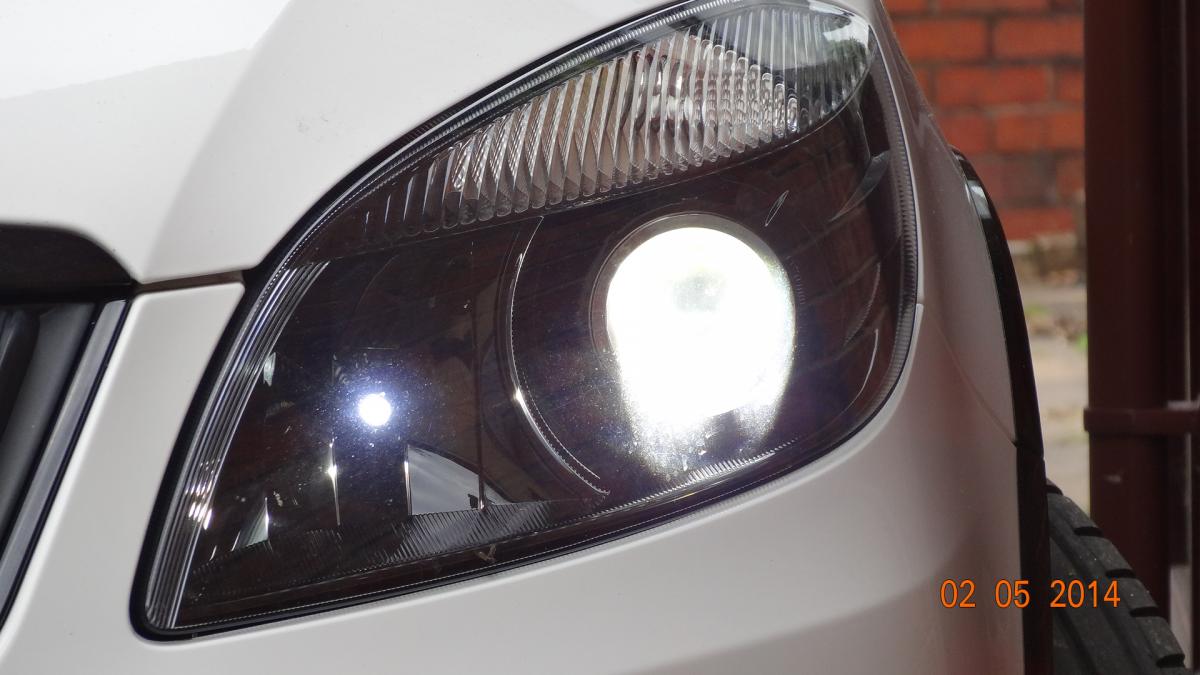

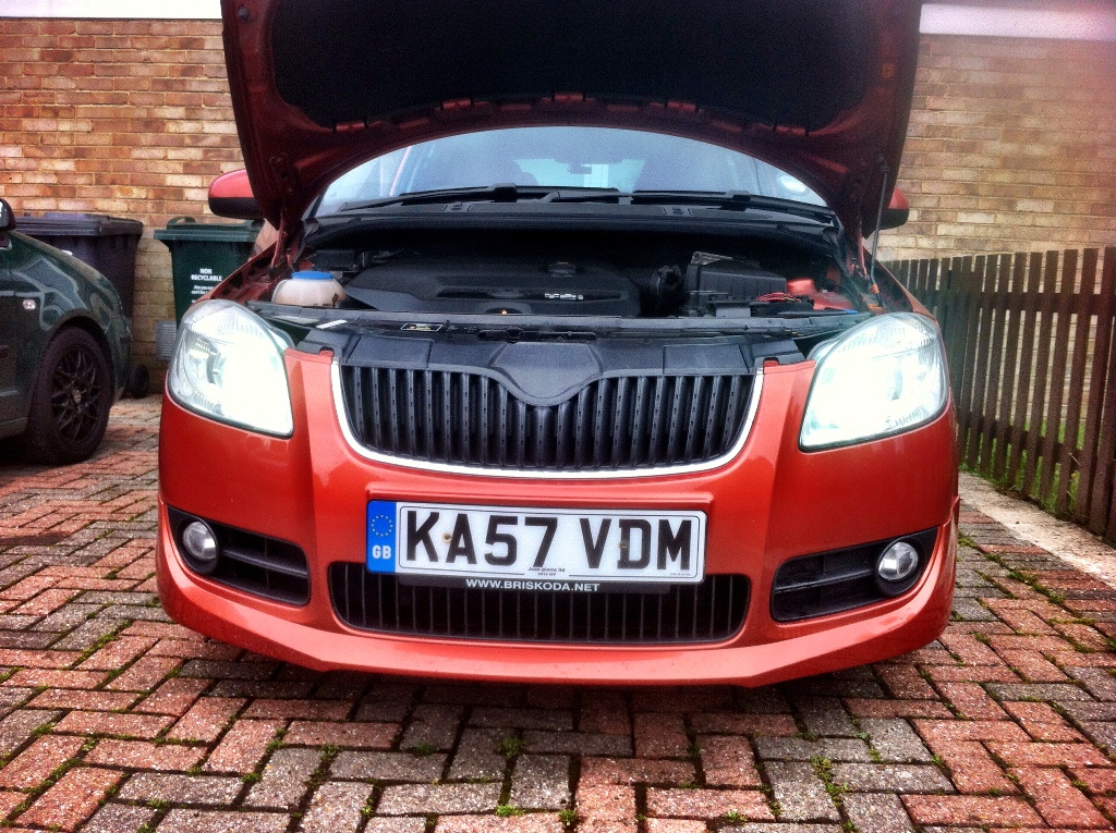

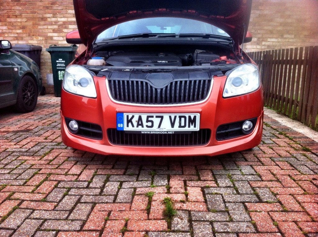

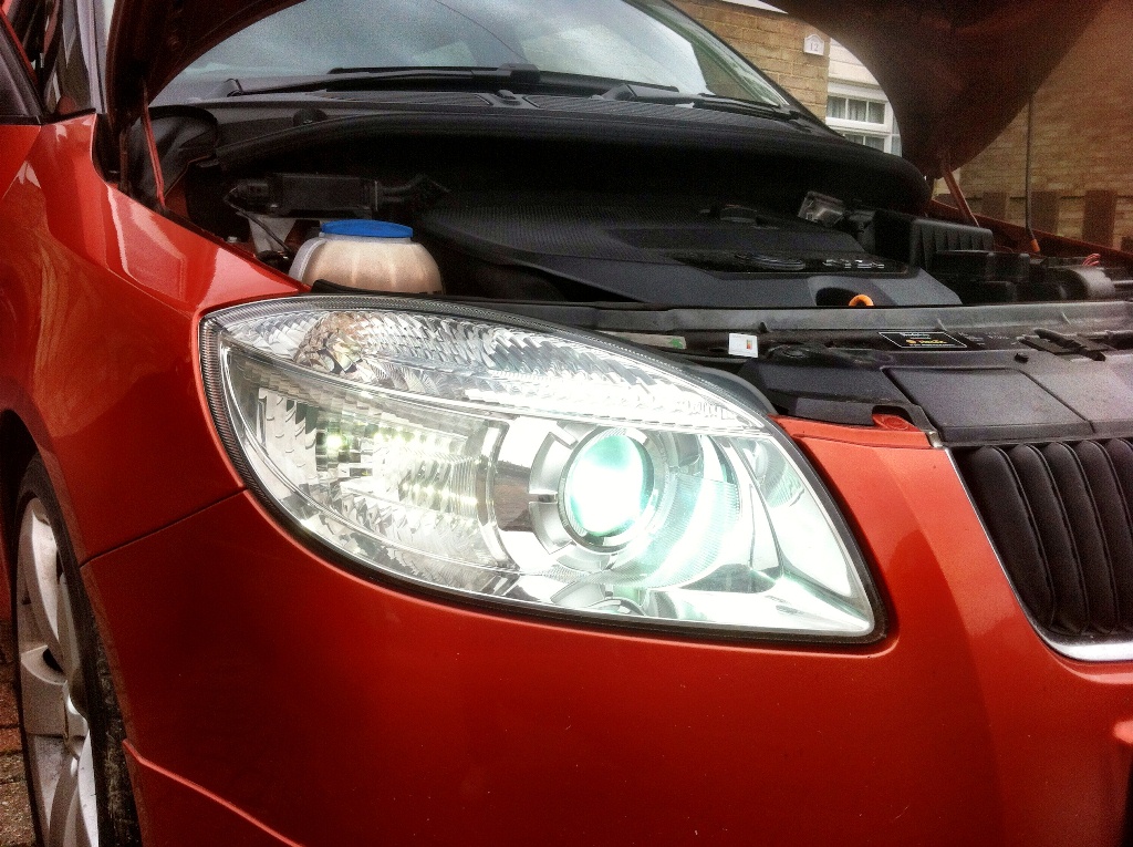

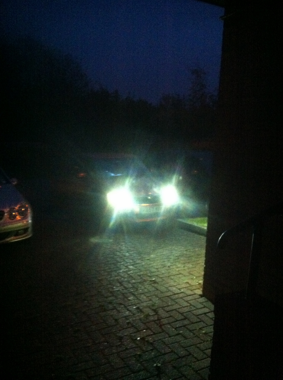

Some pics here but these were taken by my phone so not soo good. They don't do the justice. The light output is really nice and white.
Not some "chavy" blue even though you might think that's the case looking at these pics:

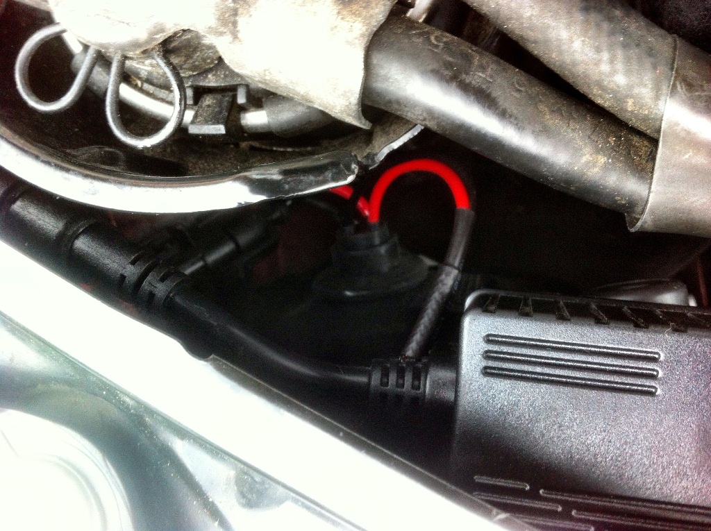

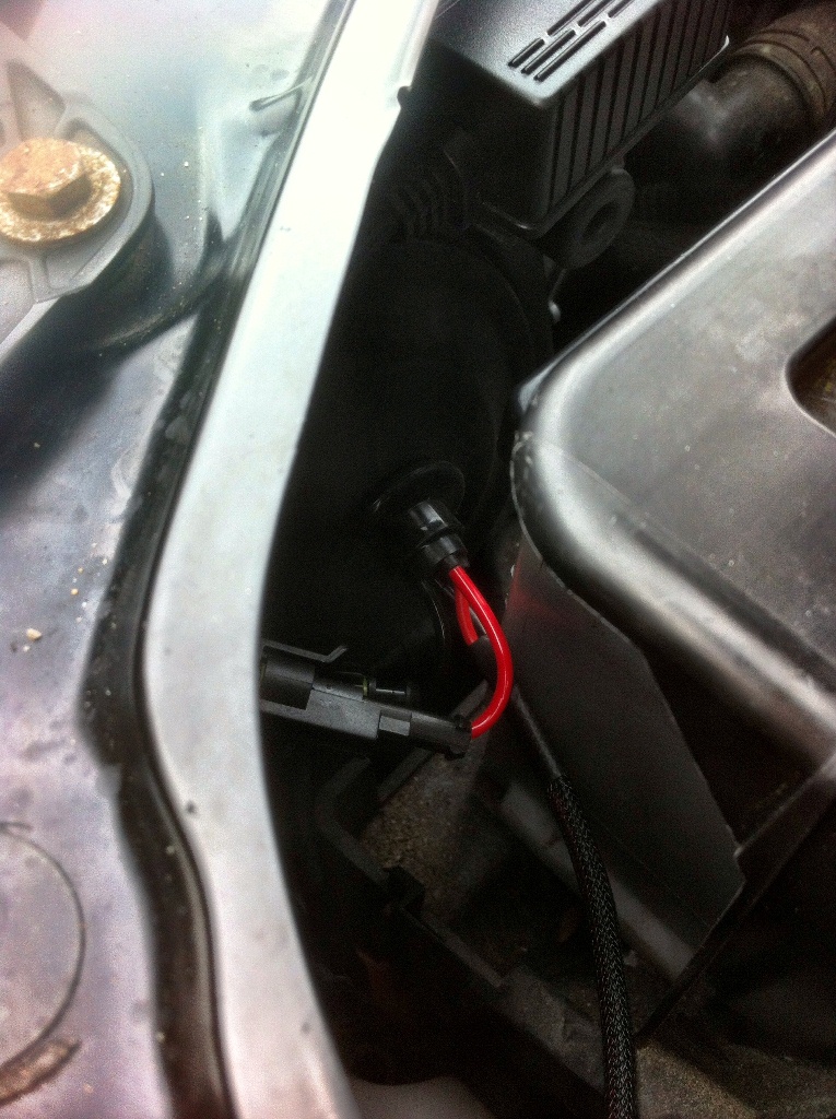

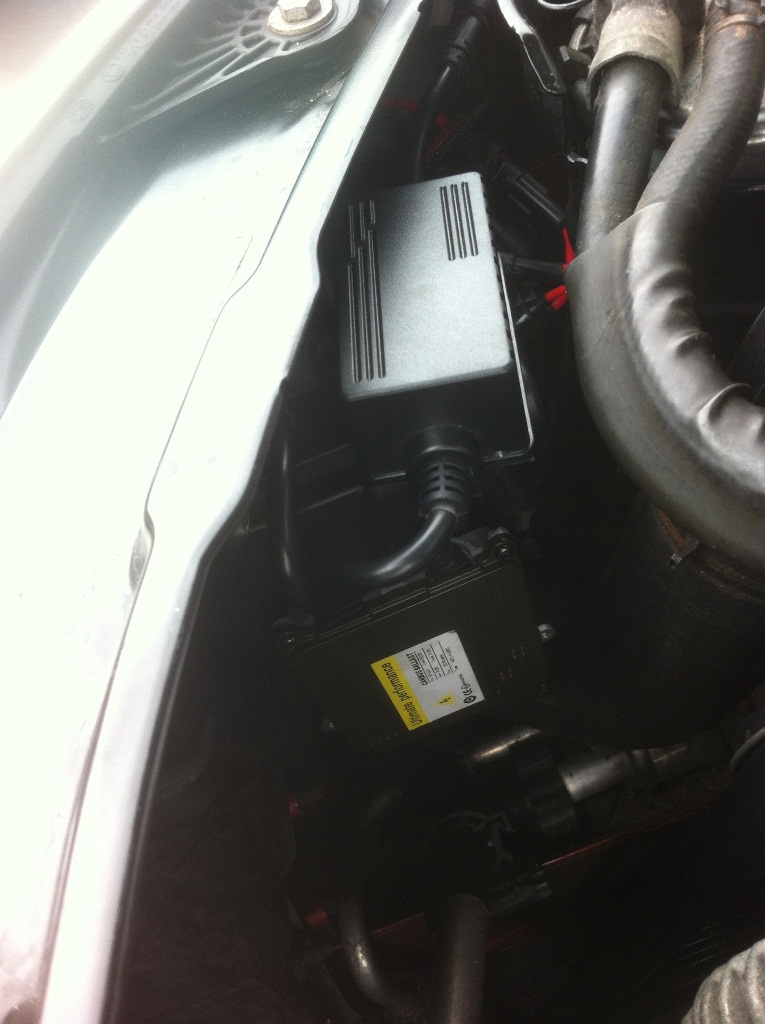

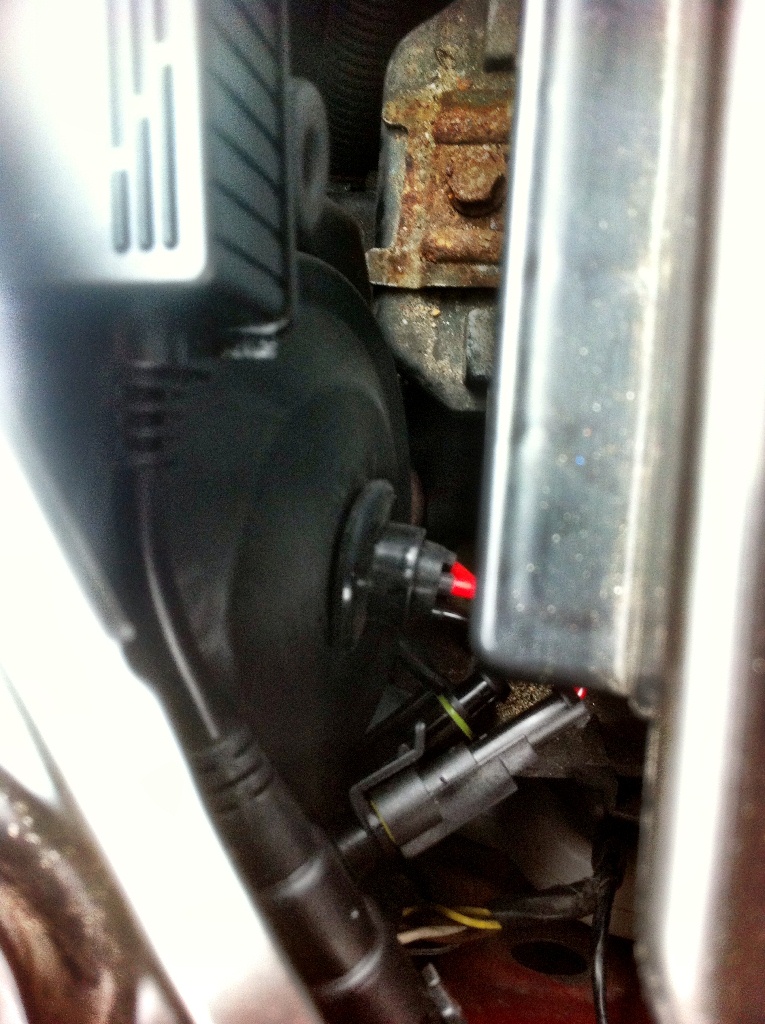

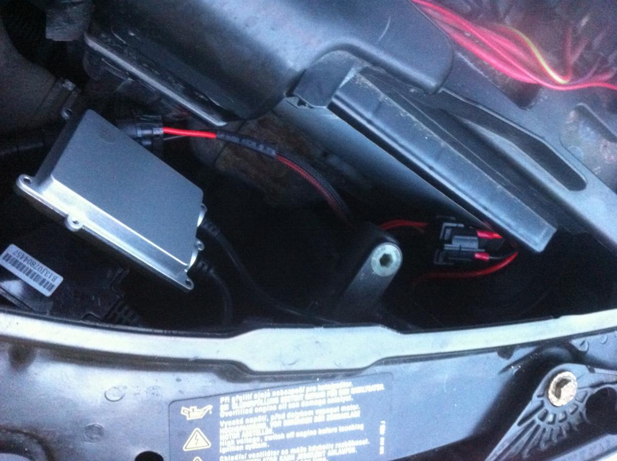

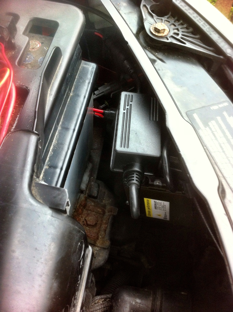

I'll take some pics of where my ballasts and everything else are placed but thanks to Johny5ive these are fitted very professionally and look really good under the bonnet. We used some Number Plate Tape from Halfords and it looks like this does the trick

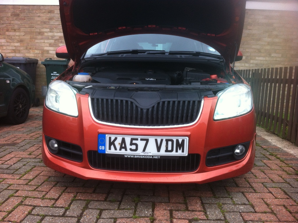

Here are the pics with the side ones and HID kit on:
post-80790-0-42547300-1399024369_thumb.jpgpost-80790-0-17465700-1399024377_thumb.jpgpost-80790-0-23173000-1399024430_thumb.jpgpost-80790-0-87860500-1399024441_thumb.jpgpost-80790-0-42643800-1399024449_thumb.jpgpost-80790-0-66696700-1399024459_thumb.jpgpost-80790-0-86485400-1399024468_thumb.jpg
I hope above helps. Matty

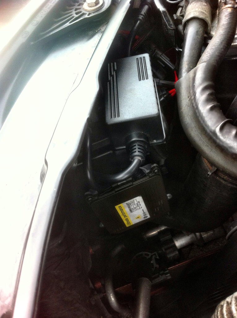

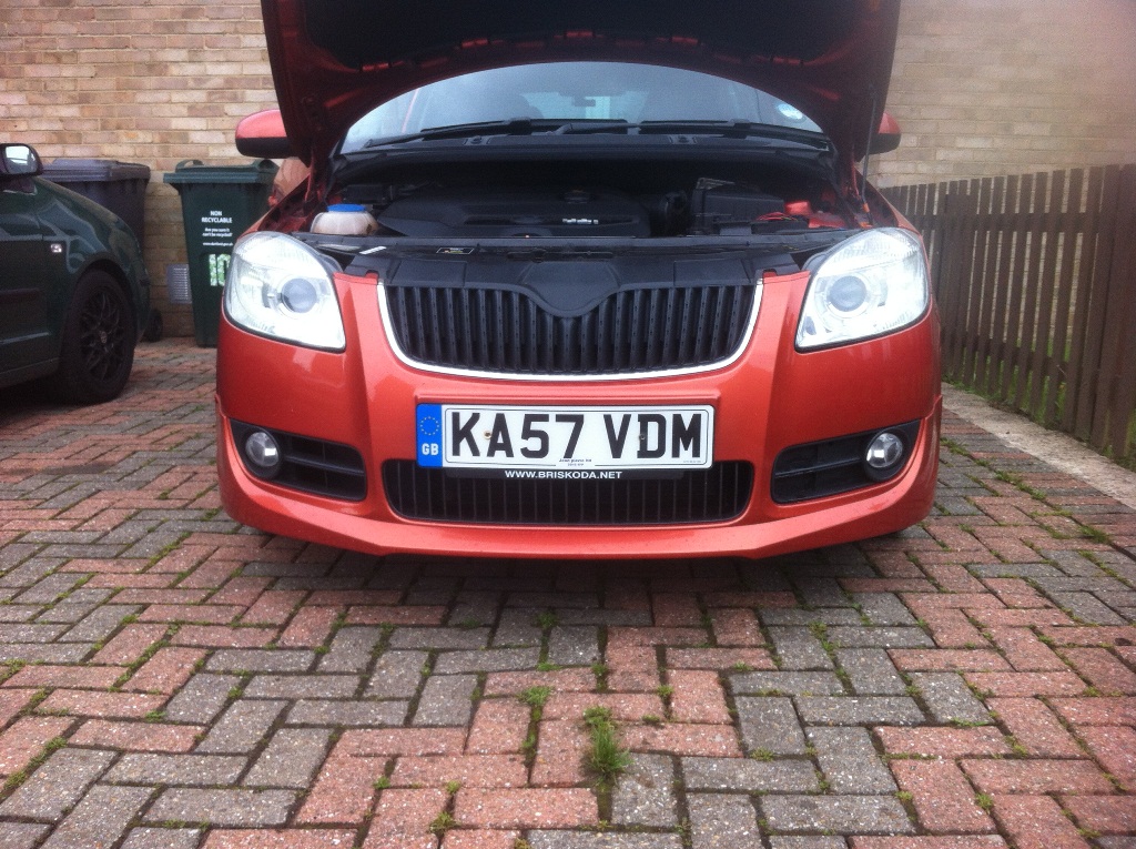

As prmissed some pics of my installed kit:
post-80790-0-45579900-1399024133_thumb.jpgpost-80790-0-61137400-1399024138_thumb.jpgpost-80790-0-75802700-1399024144_thumb.jpgpost-80790-0-27469100-1399024153_thumb.jpgpost-80790-0-15035900-1399024163_thumb.jpgpost-80790-0-44143400-1399024173_thumb.jpgpost-80790-0-02590400-1399024183_thumb.jpgpost-80790-0-47930600-1399024191_thumb.jpgpost-80790-0-34560700-1399024200_thumb.jpg
We have used the Number Plate Double Sided Tape to mount the ballasts and so far everything looks good and secure. I drove straight after I fitted these and to work today with no issues at all... :thumbup:
And HID kit on:
I'm really happy with these not sure why I waited sooooo long to install the kit... :happy:
