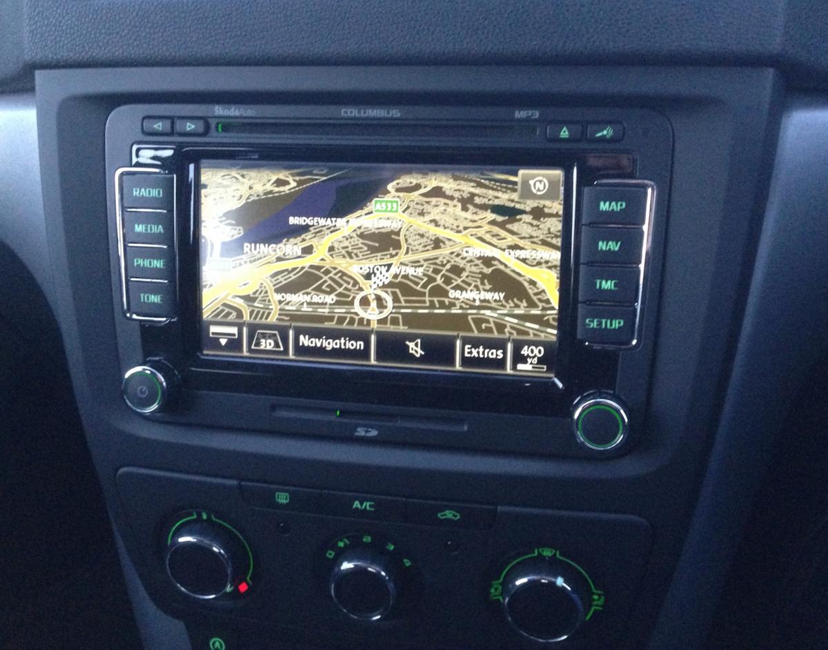

Ive also installed the Columbus, ill get some pics up later but it looks great and the install with coding was a breeze with a little help from fluffmeister  :nerd:

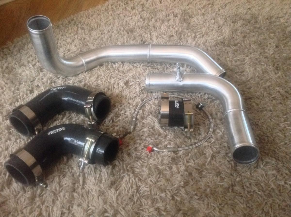

Will that pipework fit?
The yeti engine bay is more spaced out than the Fabia etc
I think you are right.
May be wrong, but I believe the Golf based vehicles have the engines in a slightly different place to the Polo based ones.
Possibly a little further back.
I hope so, I double checked with the guys at DarkSide who seemed to think it was the right one?

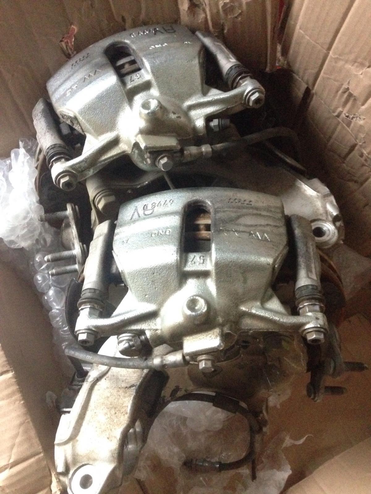

The goodies have started to arrive :)
The front set up from a 2014 Leon FR, hubs, callipers, carriers, discs, pads. I'm chuffed with the condition, I was told it had 1000 miles on and the discs/pads seem to tell the same story as they look unused!!

Once again Briskoda to the rescue, it was the wrong kit, they have recalled the other kit and sending the new one out, thanks for the help :)

Glad you got the pipework sorted :)

Look what's just arrived :) speedy delivery from DarkSide Developments!
One hard Pipework Kit and a braided oil feed pipe, the quality of the kit is fantastic, I do get excited by a tidy weld :)

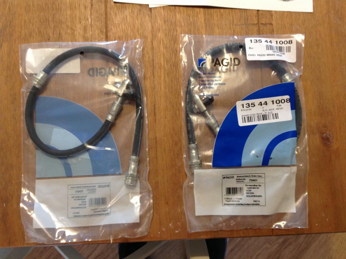

Not a very exciting update, but the brake lines have turned up for the 312mm upgrade, only ordered it last night from Euro Car Parts, very quick delivery!
Columbus and trim pic's you slacker :) :)
oops, wife out in it at the mo, get one later, along as its back in one piece  :peek:
Check the bumpers ;)
Already had it to the body shop after Christmas!! she's lethal  :wall:
as promised, the Columbus upgrade installed and working perfectly, now updated with the latest firmware and V12 Maps thanks to fluffmeister  :)
