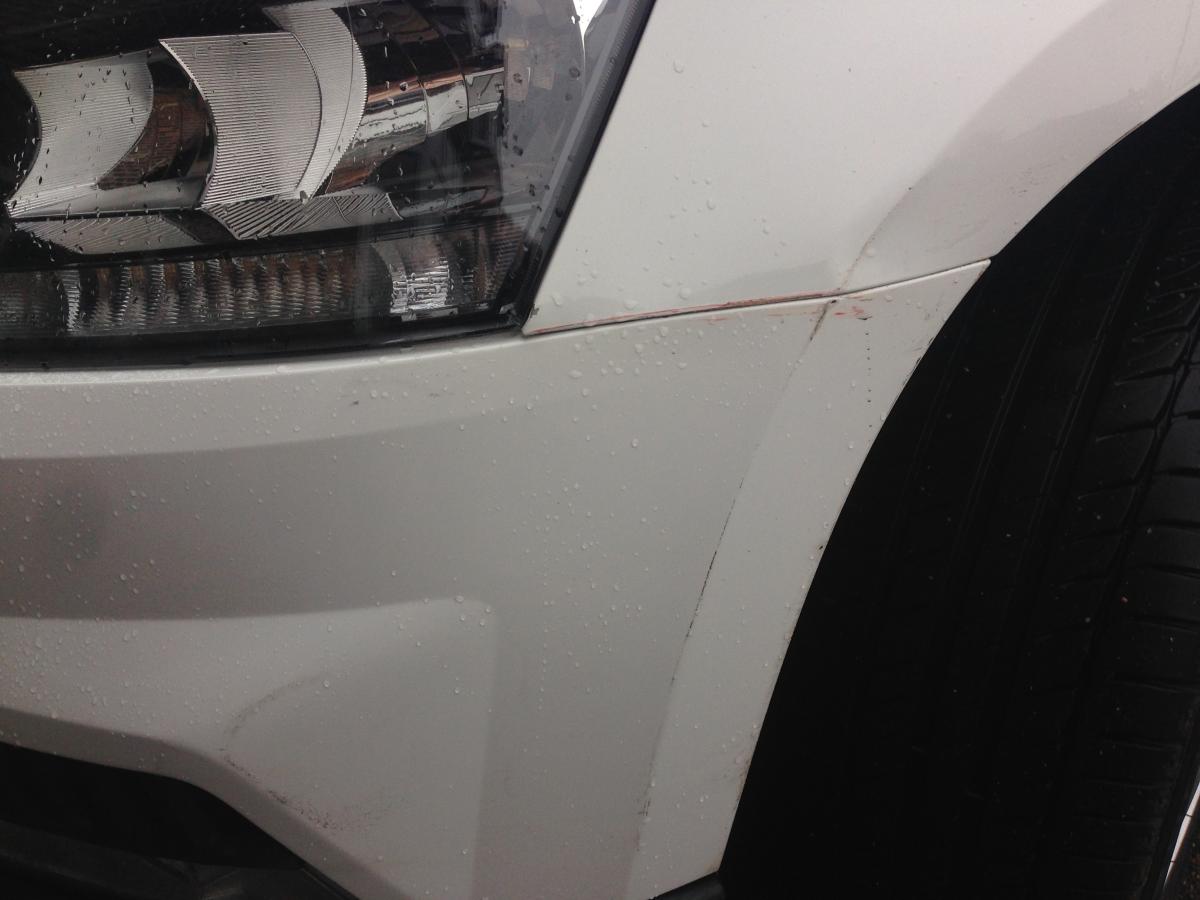

Latest modification has come curtesy of someone hitting the front of Sharky in a car park!!
Quick call to Skoda Ensurance and its all being sorted, bit of a pain in the backside though!!

Photos required Darrell!
Here you go, its not huge, just annoying!
That's really annoying. Hope it gets sorted quickly
Annoying, but glad it's not major!
Insurance have approved the repairs so it's booked in the week after Shark have finished turning into a super sleeper :)
