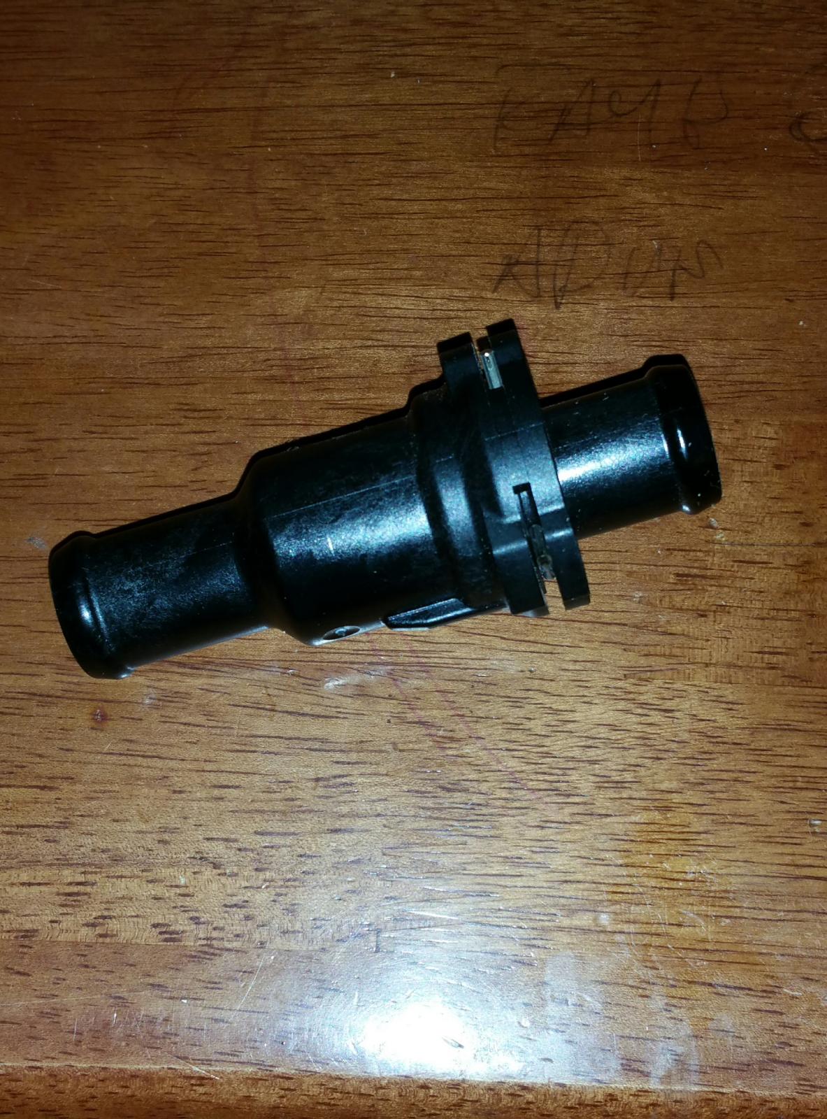

I have had same issue. Just bought the car last week from VW dealership. 2012 combi 170bhp DSG 6. Went into Skoda garage under warranty. First they changed the engine thermostat but with no luck. Now they say Skoda have told them theirs a second thermostat going back to the DSG box for an oil cooler in the box. The garage said this was stuck open. Anyone hear of such a thing?

As it is quiet out there, I will answer my own questions!
Yes the VW part number is correct
The thermostat is actually in-line in one of the hoses leading to the oil cooler on top of the DSG Box
if you have cooling problems try this one first, £15 and 15 mins to fit.
Mine failed after some high speed towing in southern germany, likely prolonged high temperatures.

Hi John,
I understand that the additional stat is only on DSG models.
to change it, all you need to do (on the Superb 2011) is to remove the air intake pipe between the engine and the battery.
The stat sits on top of the gearbox at the joint between the box and the engine.  you should clearly see the oil/water heat exchanger on top of the box.  follow one of the pipes and you will see the stat in-line on one of the pipes.
i completely removed the pipe and plugged the open ports. then changed the stat on the bench - lost about 1 litre of coolant.
took about 20 mins to change,  all access from the top of the engine.
good luck.
And yes, it solved the problem!!

Yes it will. I have just fitted it to my 2.0 140
Hello Viperfreak
About your problem with the unstable temp..i think you changed only 1 thermostat.:).it has 2 .indont know wich one youve changed but i think you didnt changed the one benief the battery.
I had the same problem.i went to dealer but the kept it for 2 days and still nothing.after that i read the manual and i saw that it has 2 thermostats
i received the "dsg" thermostat today, i previously changed the thermostat all the "mecanics" know about with no positive results, i will see when i have time tomorrow to change it, and I will keep you posted.
Finally got the stat changed today everything back together took it a 40 mile blast down the M74, temp needle bang on middle again and stays there.
