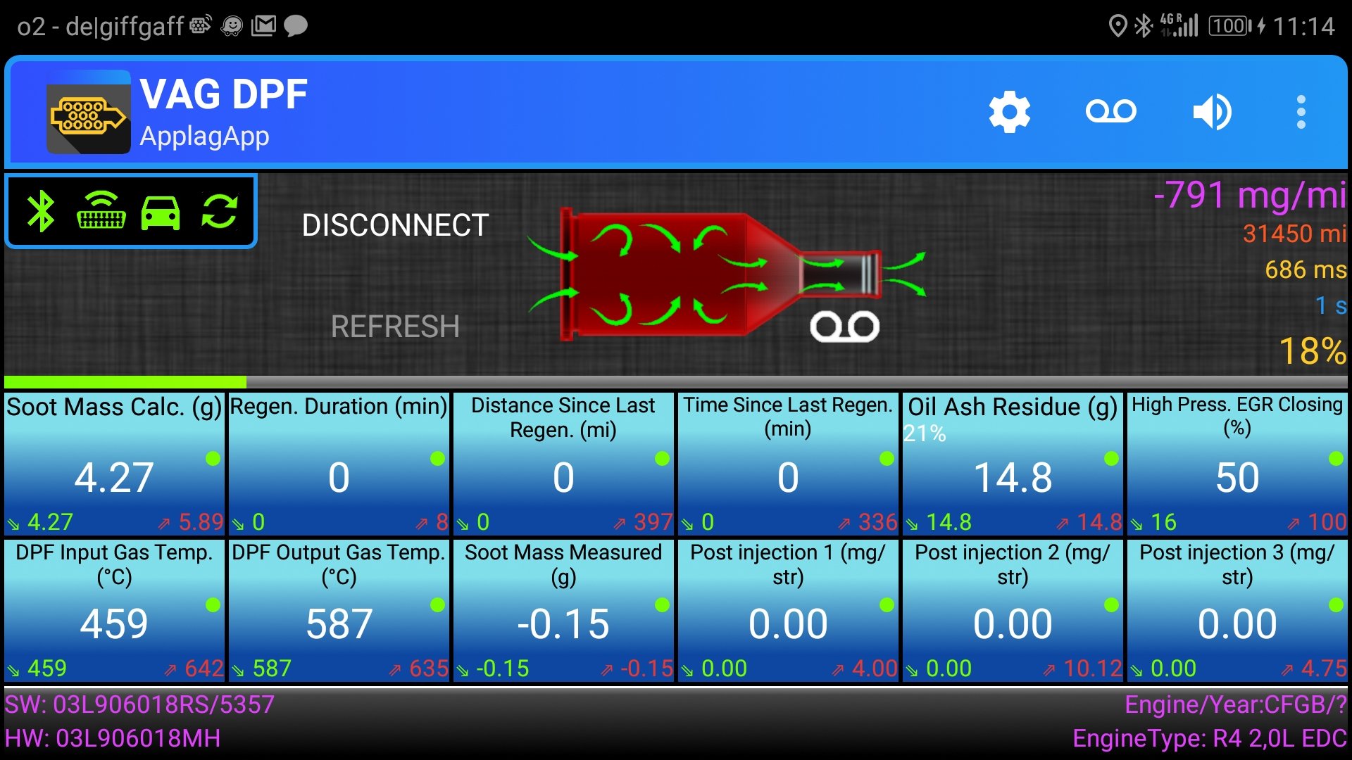

Install VAG DPF (free) and you'll know - one of the fields shows mileage from last regen.

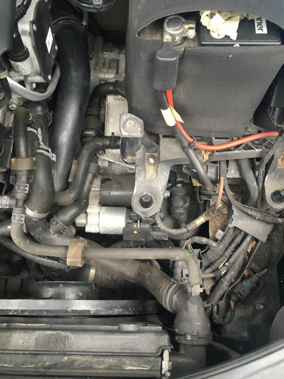

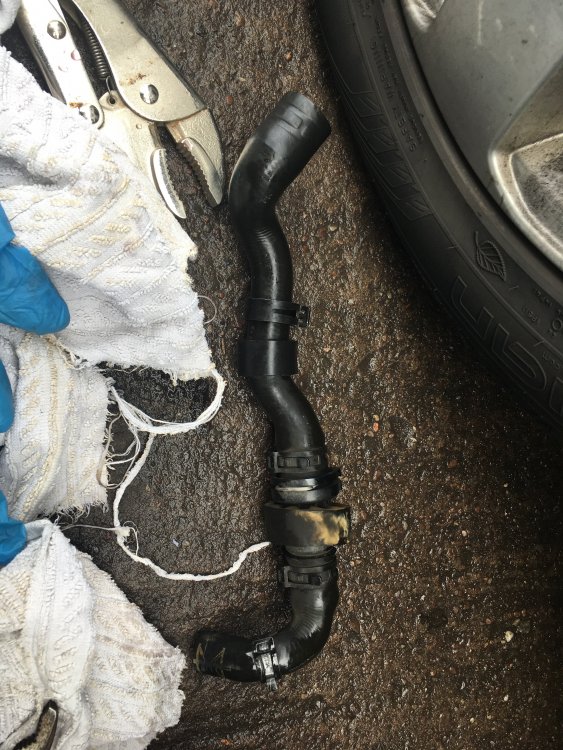

  • Found some of my old pictures and other members stuff I kept.  Pict 3 and 4 are my own car. I never used the special tool to remove those jubilee type clips. I used long nose pliers with a lot of

Thanks Jack - didnt know such app existed! Downloaded and ran it - it indicated a regen at roughly the time i was at the Pertrol station.
Did a 230 mile journey and again, the fan ran after switch off later in the evening - the app told me a regen was taking place.
Its quite addictive actually, im debating wether to fork out for the full version?
Rich
I think it's worth it :) there is an logging option - unfortunately it doesn't work when app is in background :sadsmile:
One more thing - I ALWAYS check idle rpm before switching engine off - and if it's higher than normal - I run app and go on a motorway to speed things up ;)
After a while you'll be able to "feel" regen ;) even when doing 70mph ;) just from a different engine sound ;)
Also, full app shows output temp - which can be more than 650°C - a bit too high for my liking ;) so I do few extra miles to let it cool down ;)
When the car needs help from the driver to regen, it'll put a warning light on.
Otherwise, assuming the engine is in good condition and frequently gets to operating temperature, the DPF should just look after itself.
The engine is designed to cope with shutting down mid regen or shortly after, if it's needs to cool down the fans will continue to run. There is no need to continue driving to let it complete a regen or let it cool down afterwards. All you're doing is wasting your own time and money...

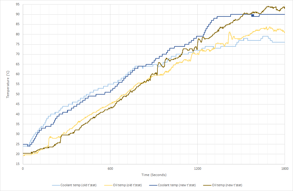

Did some logging tonight using VCDS, highest coolant/oil temperatures were 79'C and 85'C respectively.
That's at ~6'C ambient over a 75 minute drive, mostly at 70 or 50-60mph. Very much looks like the car is over-cooling so I'll get a new thermostat fitted given it's a manual not a DSG.

@MarkTB - New main thermostat has fixed the cool running for me. Coolant temperature now hits 90'C and stays within a couple of degrees. The oil is generally above 90'C and I saw a high of 97'C.
Below is a graph showing the coolant/oil temperatures on my evening commute before and after the thermostat was replaced with similar ambient temperatures/routes/traffic.
Depending if you believe that 75'C counts as operating temperature (based on gauge showing 90'C at 75-105'C) or not:
- Coolant to 75'C is 19 minutes rather than 25
- Coolant to 90'C is 24 minutes rather than never ;)
@langers2k I had mine changed Friday and has sorted mine too. My experience mirrored yours, coolant only getting between 75-80, and oil the same -  on my way home in traffic after it was replaced the coolant held solid at 90, and oil was up to ~93 again - success! :thumbup: Driving to Denmark the end of next week so didn't want to risk not sorting beforehand.

Changed the inline stat today - what a ball ache! I had to take off the whole pipe as others did and changed the stat off the car.
