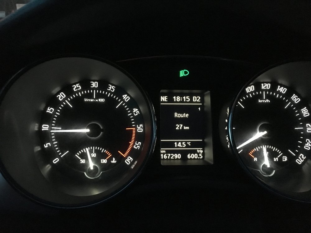

So am i in the right topic with this picture? :)
happened today , and all info shown...

14.5 ? It's the outside temp - not water/oil :)
Travelled 27km with an ambient temp in the teens and coolant indicating not up to 90*oC i think the picture is showing...
What was the oil temperature?
Awayoffski is right;) oil temp was around 77C after a longer ride with 120-130kmh.
Around 90 is a more normal oil temperature figure (Past 100 if you're pushing the car hard) - thermostat failed open maybe? Running the engine overcooled is harder on the oil AFAIK, so I'd definitely get it checked.
That's a failed thermostat - they're designed to fail open so the engine doesn't get cooked. If you want to verify, try blocking off the radiator with a piece of cardboard and go for a drive - you should see temperatures closer to normal. Beware blocking the aircon radiator or the intercooler though.

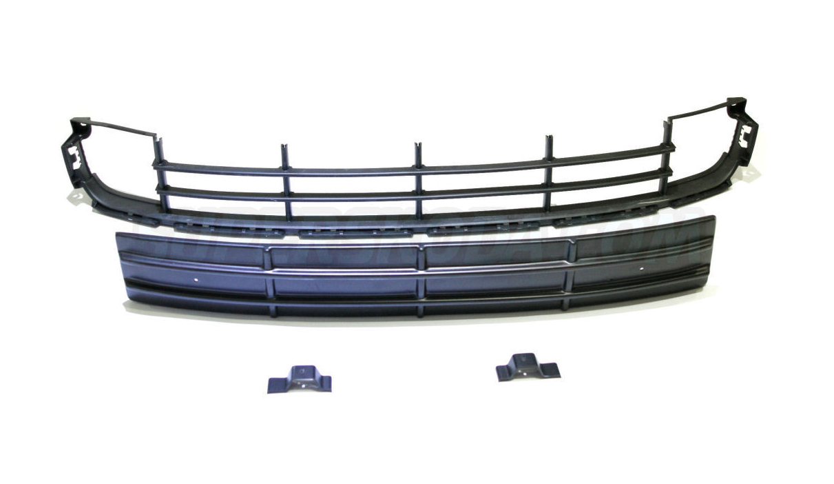

Had the thermostat replaced on my 1.6 recently. Warms up significantly quicker, both coolant and oil. Stays warm as well. Even so, it takes a while to warm up and to stay toasty. Superskoda sells a winter grille cover. My car is missing the engine undertray, so it might be getting some extra unintended air from underneath, but it shouldn't make a dramatic difference.
Since I have 0 intention of paying 44.99€ plus shipping for a piece of plastic and some mounting hardware, I'll find a DIY solution on a lazy weekend.

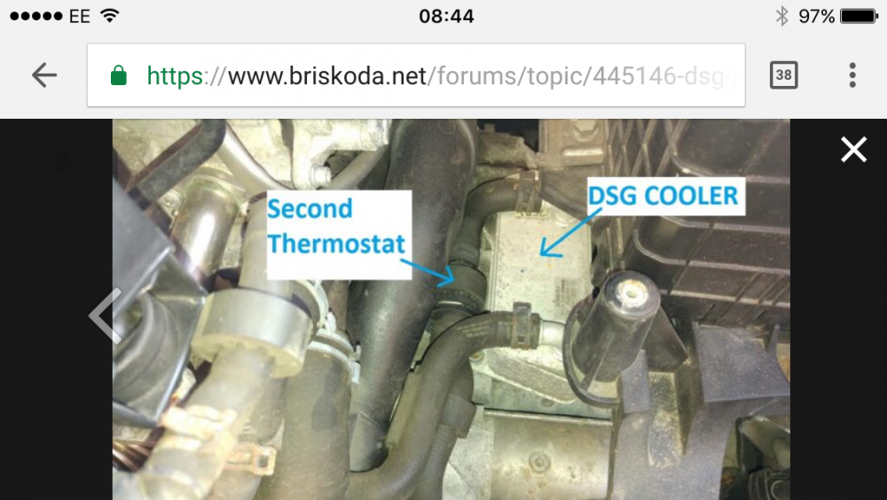

Hi Richtung,
there was some debate whether mine had the additional stat, but it did.  Easiest way to check is to use a Mk1 eyeball.  You may need to remove the ait intake pipe which runs above the gearbox, but then look for the coolant pipes which sit on top of the g/box.  One of them should have the stat inline.  Looks like this:

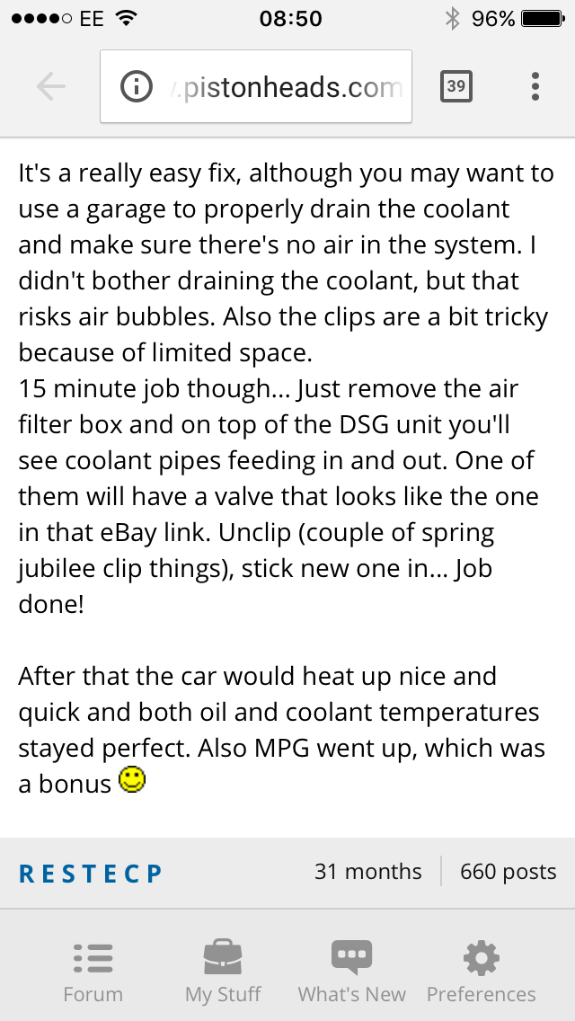

Found some of my old pictures and other members stuff I kept.
Pict 3 and 4 are my own car. I never used the special tool to remove those jubilee type clips. I used long nose pliers with a lot of patience.  I only needed about 1 litre of coolant after losing this around the stat special G12/13 stuff. I just put it in neat.

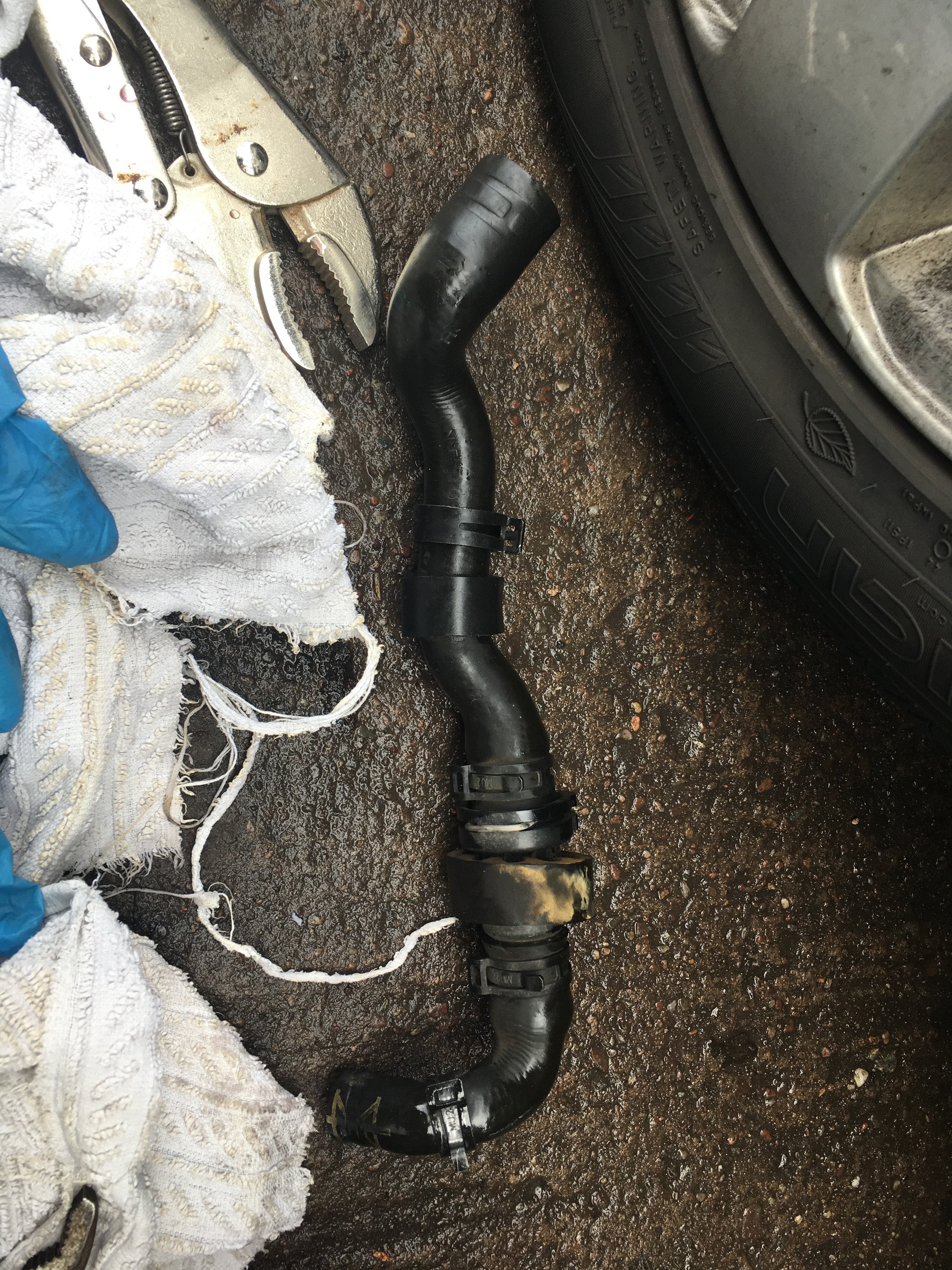

Just as a way of an update.
Changed the inline stat today - what a ball ache! I had to take off the whole pipe as others did and changed the stat off the car.
Started the car, ran it for a bit and then topped up coolant again.
Took it for a drive and water temp hit 90 (on the gauge) within a couple of miles and oil temp reached 90 soon after (both temps stayed stable).  Seems like problem solved!
Thanks for everyone;s advice on this!
I ran water into the old stat and water just poured straight through which indicates its open.
