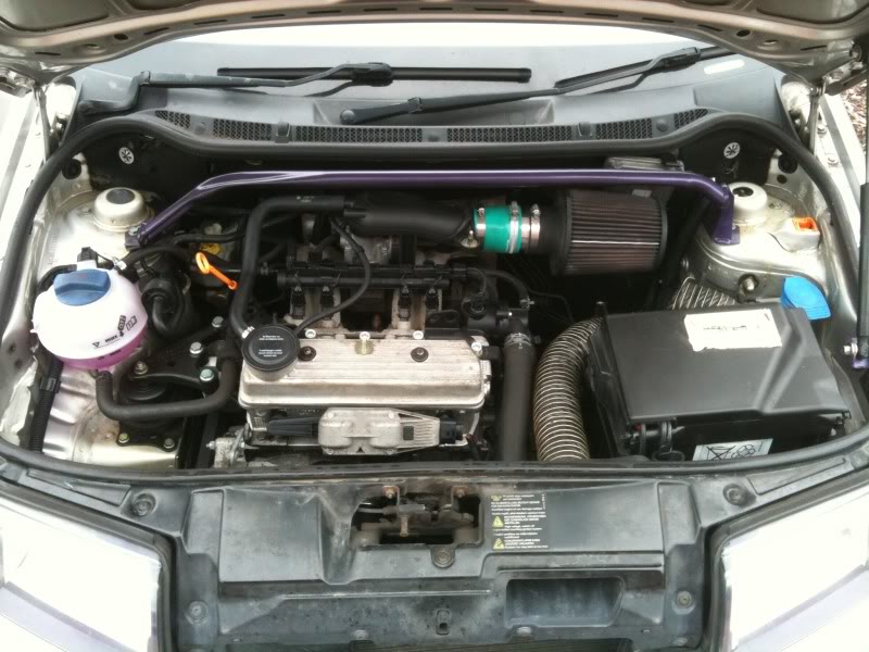

  • Took a pic of mine for you Alex...

I checked mine, where exactly should it say TEMAC ? Can you upload a picture with it ?
You mean like the one in post 7?

   I've looked at that spot but couldn't see anything. I mean, the gasket isn't visible at all in my case. I was referring to a closer peek if it would be possible. :)
Then its a non genuine gasket or not a TEMAC one.

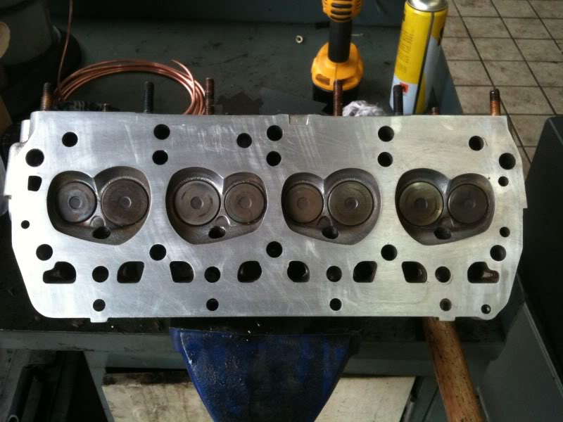

Changing the head gasket without resurfacing the cylinder head is useless IMHO.
I checked my head and it was within tolerance. Changed the head gasket (along with plenty of others at the dealer) and had no further issues.
Thank you, TMB! My gasket doesn't cover that 'corner'. I will upload a picture a bit later.

Oh, looks like yours is non-standard or isn't the TEMAC one as Tech1e said.
