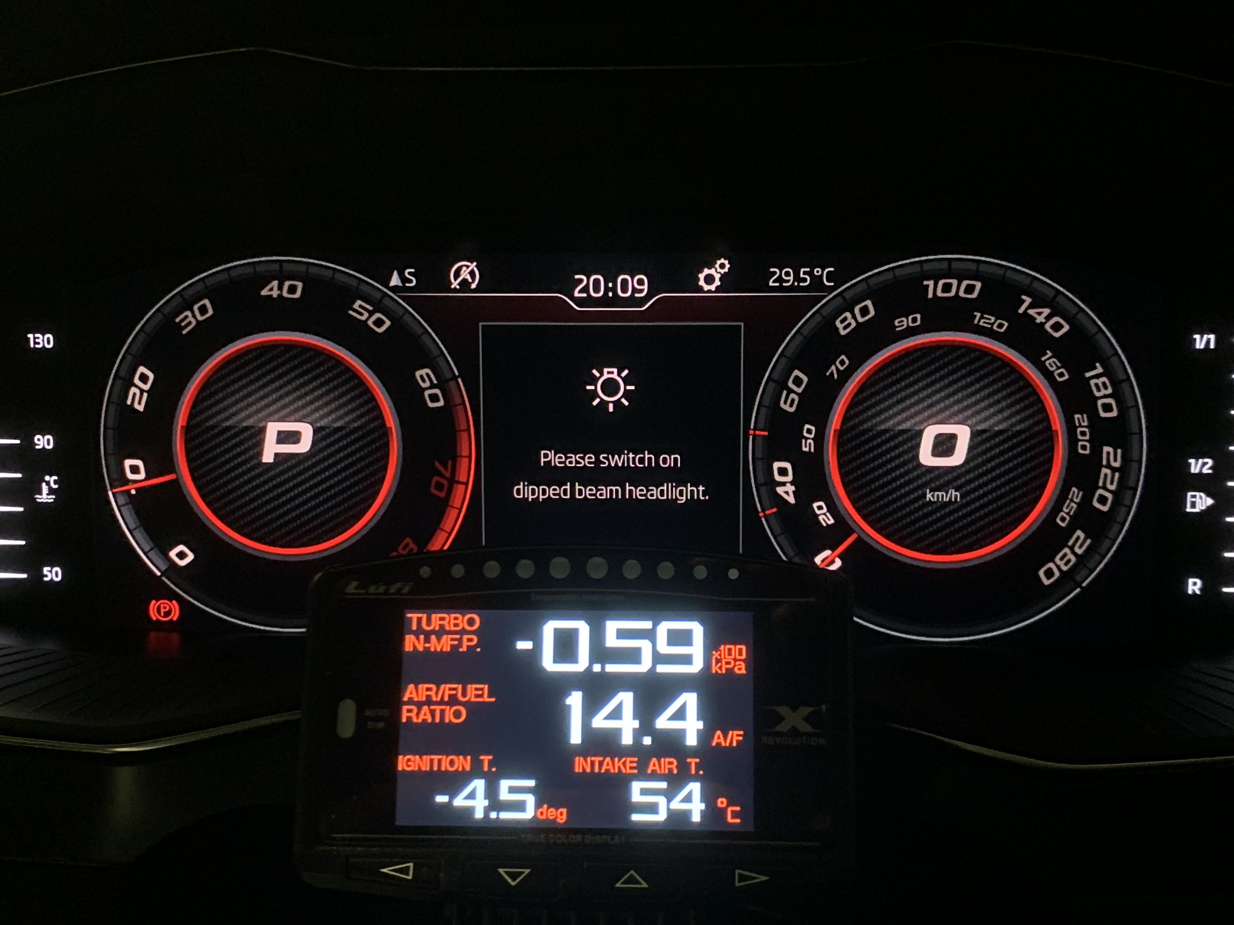

I have an MY19 Superb and the old code was 00084D. I have changed it to 3CA8D2 and it seems to be turning the lights on later. But it’s especially noticeable as when the headlights are not switched to auto the headlight warning doesn’t come up on the dash so early.
haven't had ever notification "Turn On The Lights",
to activate it have tried all of these, without success 😞

11 hours ago, JR RS said:
+1
I've never had the notification to turn on the headlights.
It comes up on Virtual cockpit.

Because you have light switch on AUTO.
this notification comes up only if you do not have lights turned on and go into dark space.

3 hours ago, JR RS said:
still no notifications
i'm guessing, this message depends on type of dashboard -
AID(Virtual Panel) has while Maxidots haven't

Yes, because if you go into dark with analog cluster without your lights turned on, the cluster backlight will dim ;), which is enough warning to turn on the headlights.
