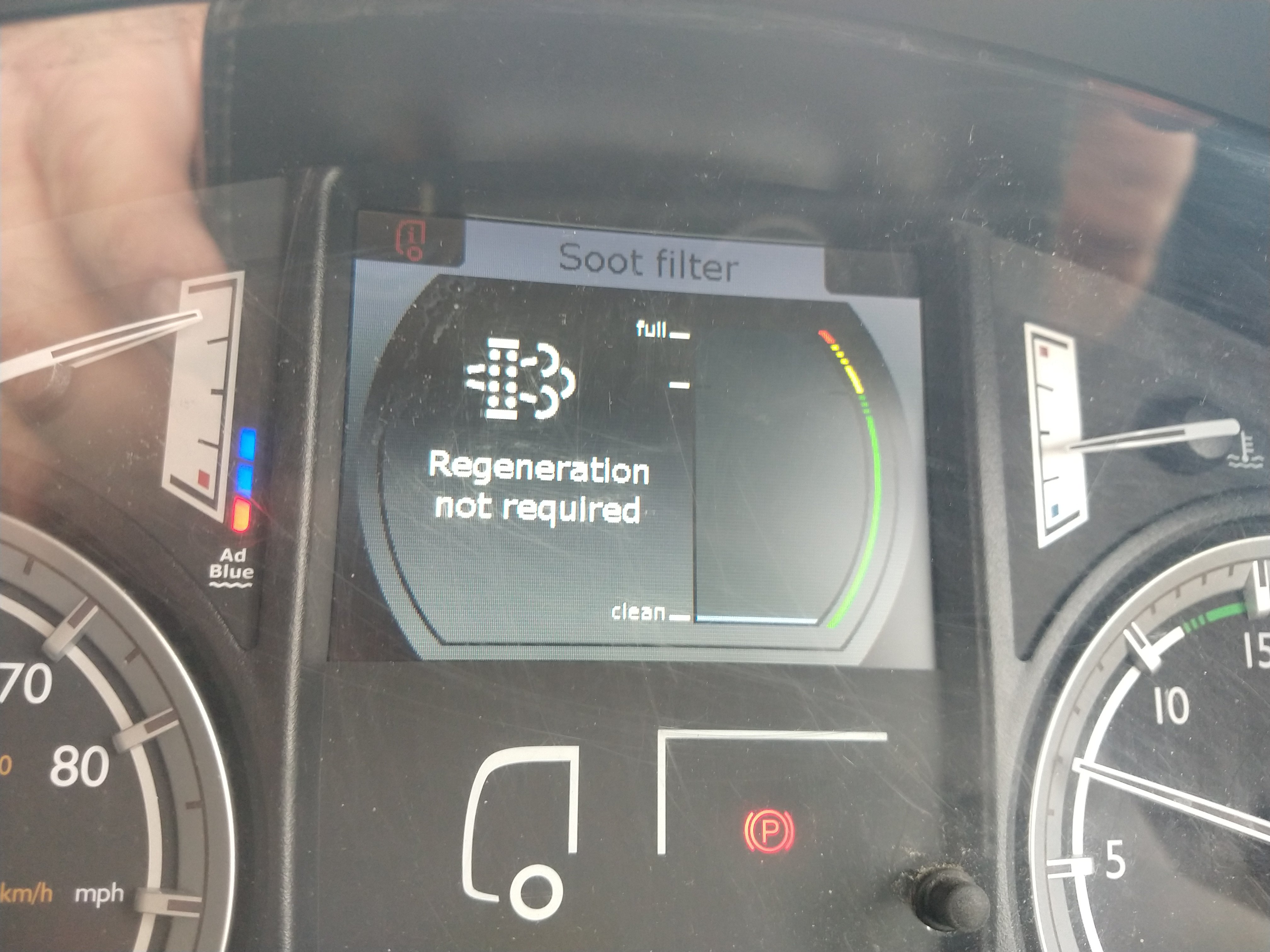

The van I drive has this, and a button to regen. Is there anything we can do to see how much soot there is or to regen when I want without plugging in vcds?

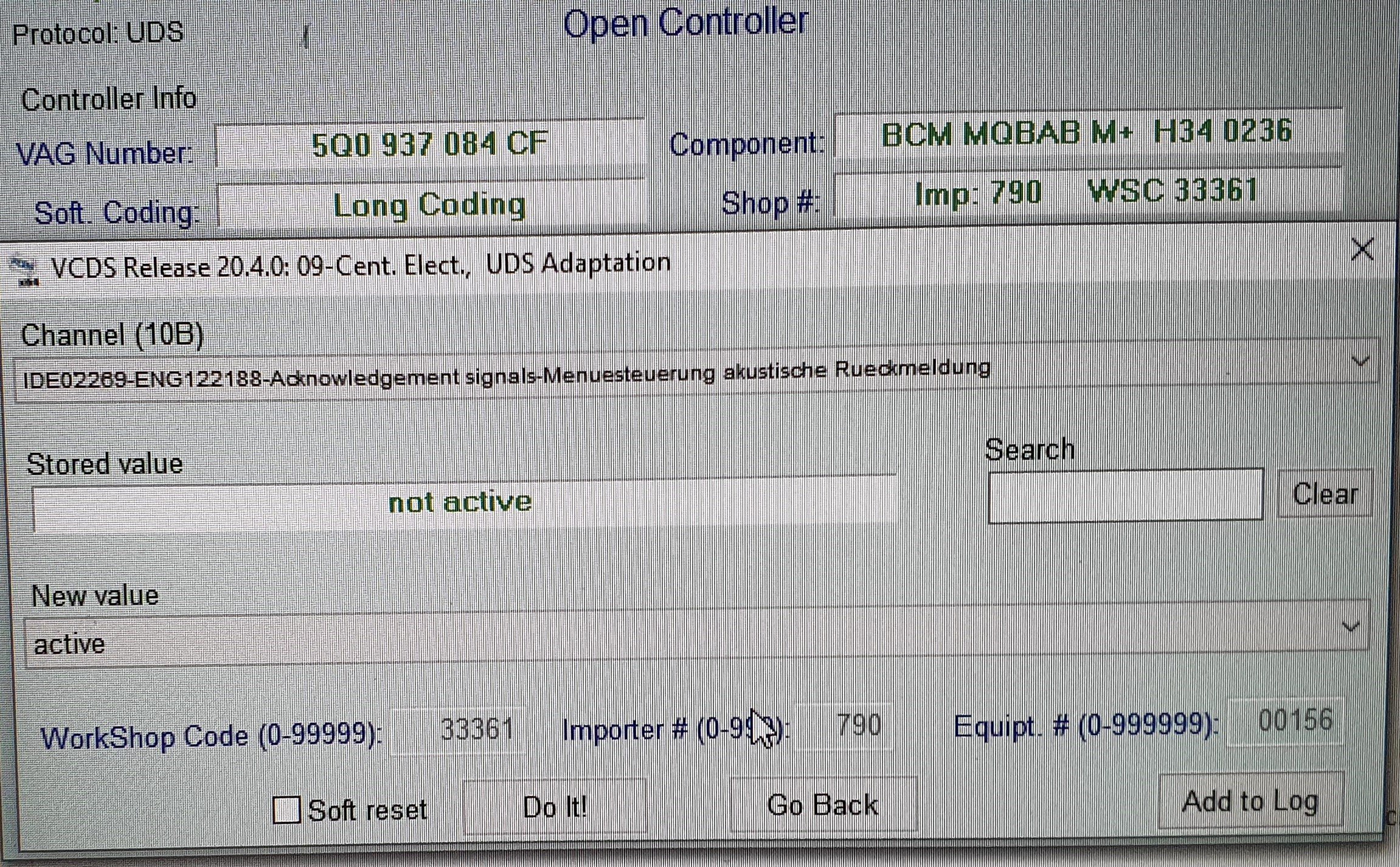

@Gizmo I also tried to activate No. 2 (alarm chirps) on my MY17 Superb but don't get an option on the infotainment under the opening and closing menu? The only replies to this issue i can find relate to a clone lead. Photo below of option prior to clicking 'save', after reading controller afterwards it showed as 'active' (forgive the poor quality, i only took to save a log of any changes i made and wasn't intended for sharing :) ). I'm running genuine HEX v2 with VCDS v20.4.0 - all other options i've activated have been accepted and worked fine (fog lights as coming home lights, fan speed showing on AUTO, DRL option on infotainment, driving mode on maxi-dot, refuel quantity, heated seat memory level for passenger, Audi throttle, etc.). Any ideas what i might be doing wrong or do i need to activate some of the other associated options?

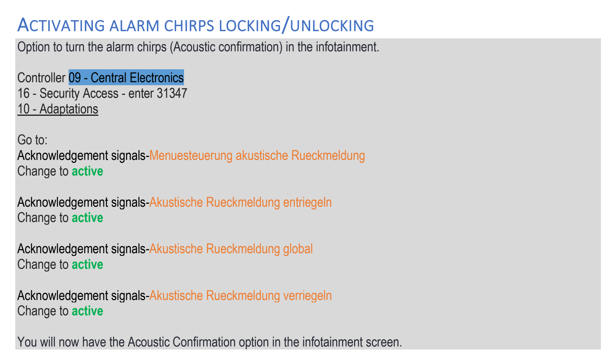

There is an extra step required for the alarm chirping.  See screenshot below of wat I did.
Works on mine (MY17) all good.
Edited by JR RS
@JR RS Thanks for that, i'll give it a go tonight. :thumbup: I did wonder if some of those options needed changing as well. :)
Yes on some of the later ones you also have to turn them on with VCDS before the option appears in the infotainment
Thanks guys, all sorted now. 😁👌
