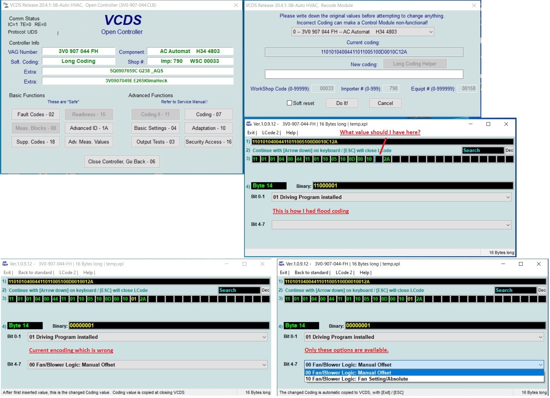

Guys can anyone send me the long code of the unit 08-Auto HVAC unit 3V0 907 044 FH - AC Automat - H34 4803
Hi,
Are looking for a specific Byte? Because, It may be different from a car to another...
Edited by Bap33
5 hours ago, Bap33 said:
Ahoj,
Hľadáte konkrétny bajt? Pretože sa môže líšiť od auta k inému ...
I didn't save the flood coding and now I don't know what the value should be there. Check image. Thanks for help.
On mine, the long code ends with 112A instead of the 012A that you have.
This should be 00010001 in binary coding...
Anyway, if you have only 2 proposals in the drop down menu and if one of them doesn't work, you don't have many options left... 🤔

On 2. 6. 2020 at 18:37, Bap33 said:
V mojej banke končí dlhý kód 11 2A namiesto 01 2A, ktoré máte.
Toto by malo byť v binárnom kódovaní 00010001 ...
Ak však máte v rozbaľovacej ponuke iba dva návrhy a ak jeden z nich nefunguje, nezostáva vám veľa možností ...  🤔
And now I don't know what encoding was there. And now I don't know what encoding was there. It must be with the letter.
It must be with the letter. https://ibb.co/3F7nmvp
Just try to tick the boxes until you get the right combination with 11. ;)  Only 4 possibilities, it shouldn't take long... :)
