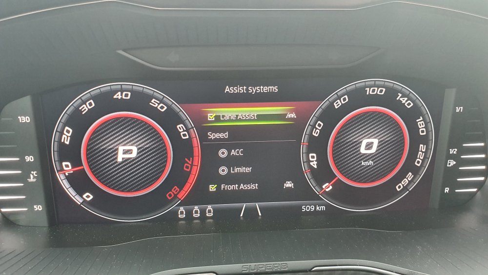

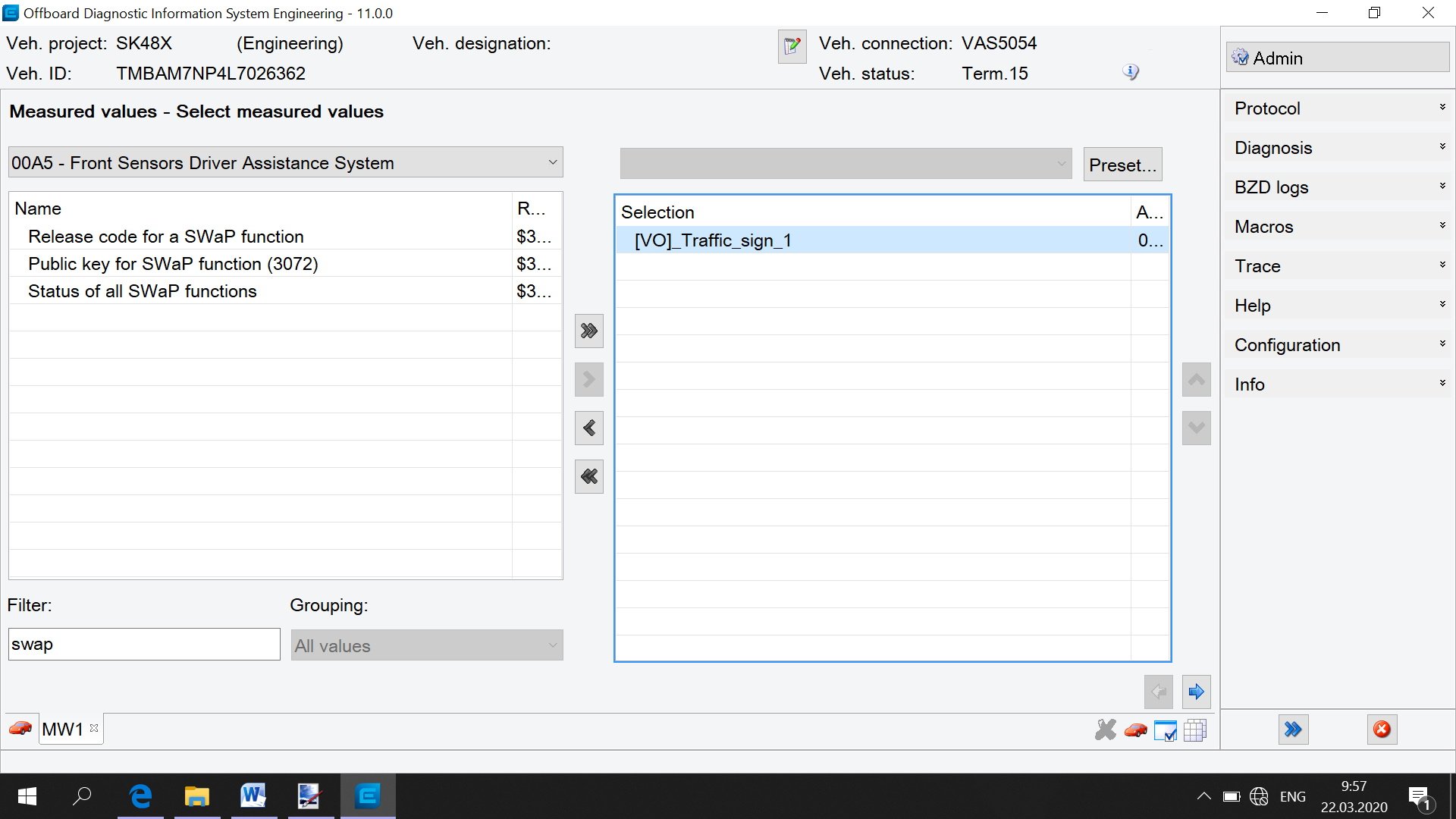

On 20/06/2020 at 15:31, fergard said:
I've activated Lane Assist on the 2020 Superb with new camera!
Could you say how you did it?
ELM bluetooth adapter + android app.
https://www.drive2.ru/l/562924115971802149/ use google chrome built-in translator if you need english text.
Can You please let me know if the prcedure enables traffic jam assist as well? I mean, below 60 km/h (with ACC active), the lane assist remains active?
Edited by Enriquez
No, I don't have this feature.
Let me know if you find a way to enable it on M.Y. 2020+.
