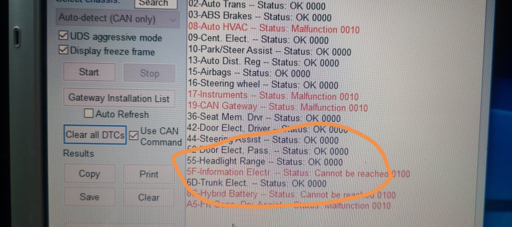

Hi all,
I have a problem with the can 5F.
I ve change my radio with something new (aftermarket aliexpress :)) )
After that the can 5f doesn't respond on vcds is not found. Do you know where is locate that can bus 5f? Does anyone has a service manual. I forget to tell the car is skoda superb 2016 2.0 tdi 150hp.thanks a lot
Best Regards
If it does not respond, that means that there is a problem with phisical cable connection or the aftermarket radio does not support the Skoda communication protocol.
Which interface do you use?
It may come from your hardware, e.g.: VCDS MIcro CAN cannot access to all control modules.
It's an aftermarket vcds... China :)
I also suspect the cable because whoever took the DVD out of the glove compartment pulled it, not knowing how to disassemble it, but I would like to know where this 5f module is located to see how much I have to unwind, thanks in advance
In the passenger storage compartment.
