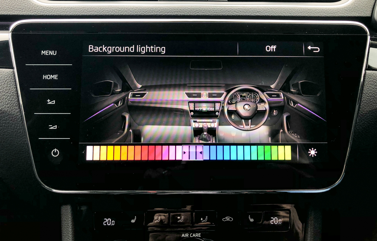

  • if anyone is interested, below is a PDF I created of the various code changes I've made to my Superb (MY17) over the years. whilst some instructions r done with VCDS, and others with OBDEleven, t
  • I'm aware the mod for 30 colour pallet in the ambient lighting screen has been mentioned several times on the forum. TLDR: The RGB values used on available in the table at the bottom on my post.

Interesting! Nice job!
Could you remind the "spte-by-step" process, to "add" the 20 other colors please?
Thanks!

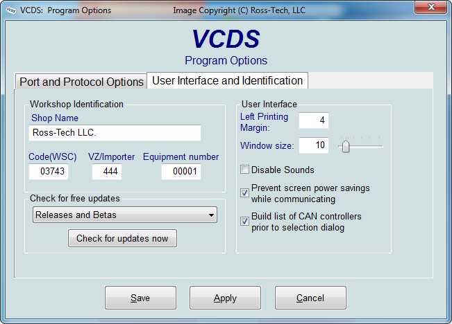

Other than that, you might need to set a WSC and importer and equipment number on this screen if you haven't already.

Which 30 colour pallet did you use?
The latest one provided by Ivan above

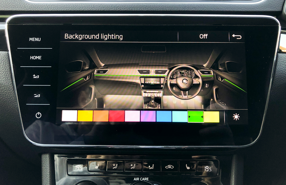

I'm going to write a description of how to get 30 colours with OBD11 once I've entered the correct numbers for the LED-strip
(the description I was working with didn't take into account that the values need to be different from the screen values, most of the LED strip colours got very pale and strange :) )

If you use the colour values I posted above in the table, you'll find they should match the screen colour very well, feels pretty OEM too!

Yes, this was very helpful. Thank you!
Yesterday I thought I had failed, but then I remembered seeing your picture:
I also noticed some differences in the screen values, your list makes it look more OEM than the list I used yesterday.

Strange how the LED strip isn't RGB, with the green value appearing on the far left appearing white on the strip.
There are quite a few RGB values floating around I think, but I wanted to go for an OEM feel. Once I'd got the stock values, I then mapped the 30, for both screen & strip. Currently using a teal green at the moment, but rarely drive it at night so don't get chance to appreciate the handy work!
