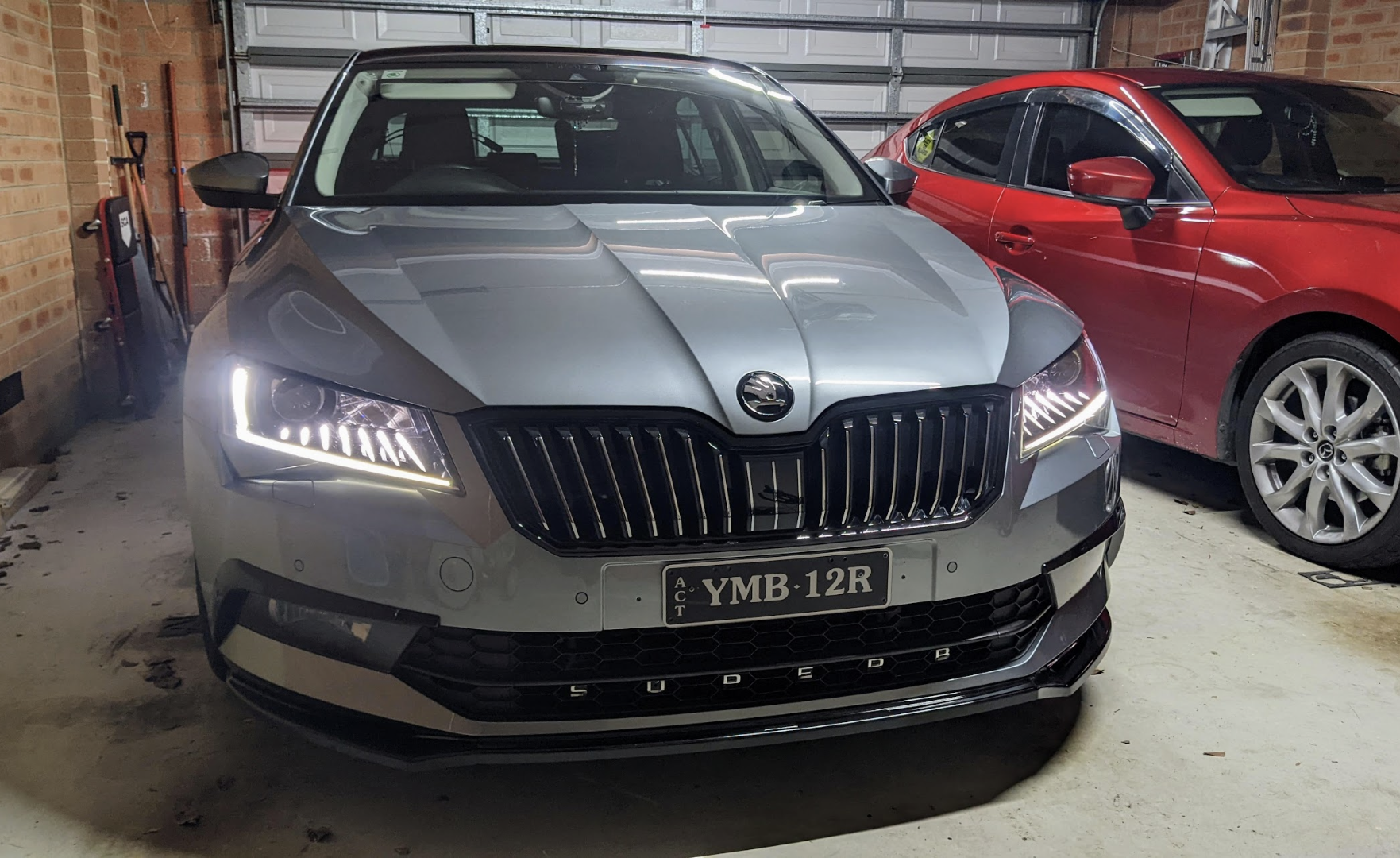

Oh okay. I was under the impression that the IDs were specific light modules lol. I am basically trying to find what I can do to trigger the needle lights to turn on with the DRL, I already tried the methods from the pre-fl superb 3 which do not work, it just gives me foglight errors
That is not controlled by any of the leuchte channels.
it is done using canbus at the module.
The only way this can be done is something called Scandinavia mode and it turns all interior lights on when the headlights are in any position but 0.
it also turns your taillights on with drl if they aren’t already.
Ah okay. Doesn't that turn on the dipped beam? I just want the needles on with the drl lol if that's even possible on the matrix headlights
Scandinavian mode will not activate the headlight DRL eyelashes / whiskers.
The facelift Superb has a completely different headlight setup and electronics compared to the pre-facelift Superb - hence there is no point following VCDS or OBDEleven steps/apps for a pre-facelift.
U'll just end up stuffing things up.
Unfortunately I have no idea about how this can b activated on the facelift Superbs.
I have it activated on my pre-facelift and I Iove the look of the eyelashes/whiskers.
Edited by JR RS
Encoding eyelashes as with a vFL is no longer possible with the FL because the channel is missing.
Eyelashes only work with vFL with DLA.
