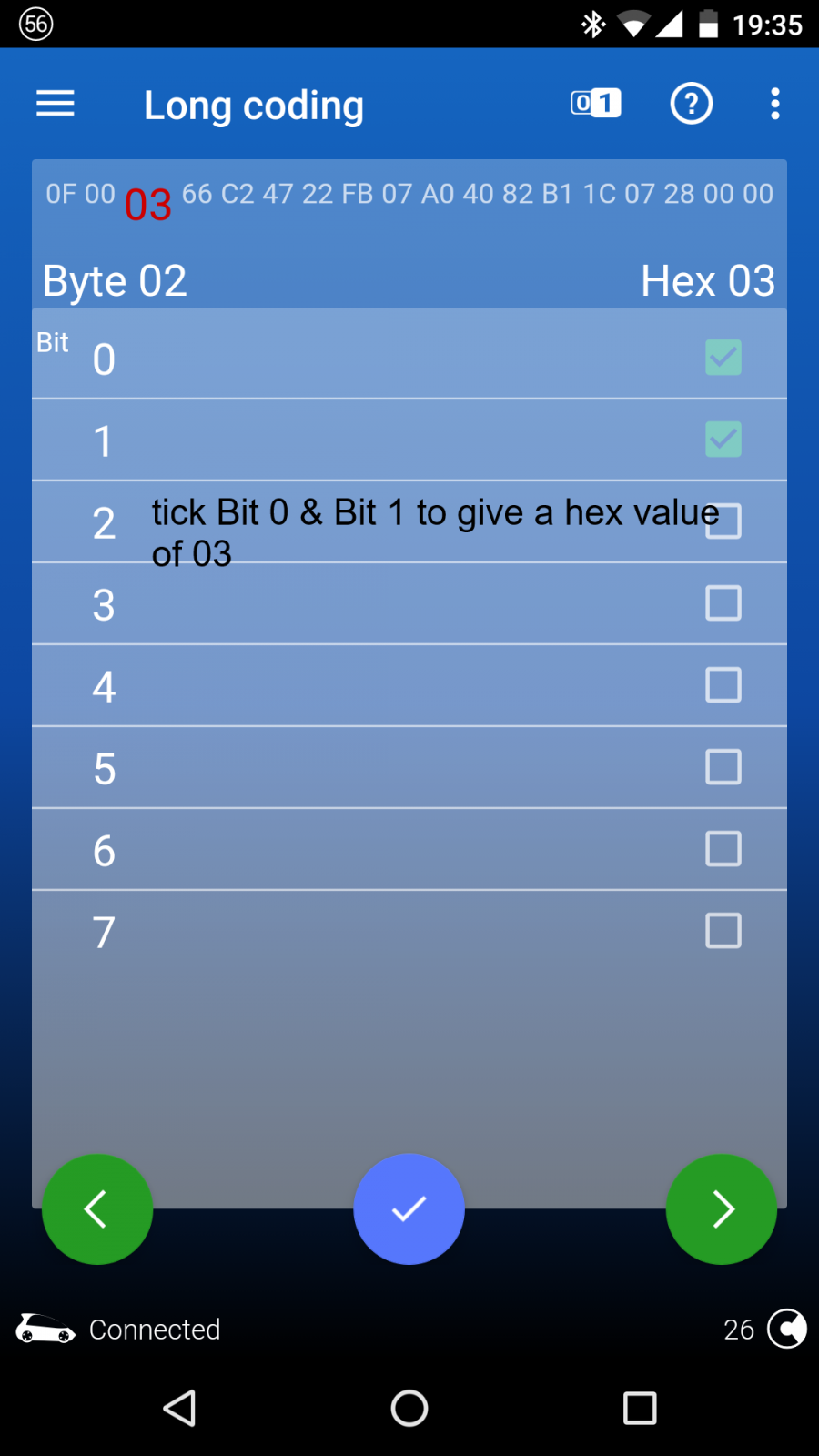

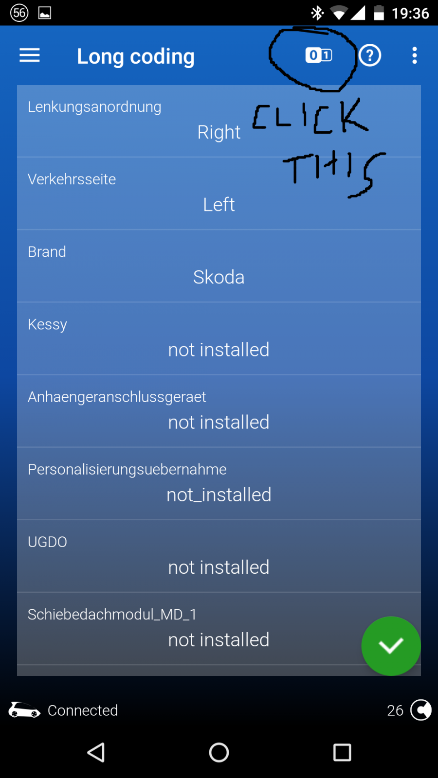

hopefully this will help - follow the instructions exactly in the VCDS howto thread then in OBDeleven do the bits below that are slightly different to the vcds layout (with same end result)
i did all the coding with ignition on and drivers door closed
i have managed to enable high beam assist as well using the OBDeleven
the tricky bit is the instruction for the 2nd part
"Goto Controller 09 - long coding - change byte2 bit 0-2 to a value of 03 using the dropdown menu for models with xenons"
there is no dropdown menu for this dongle and i had to click on long coding, toggle the 0/1 icon to switch from descriptive text to the coding layout,clicked across to byte 2, clicked the hex value heading, entered '03' and it ticked the relevant bit boxes
here are a couple of screenshots of what to do after selecting controller 09 followed by clicking on coding so you can compare to your own
