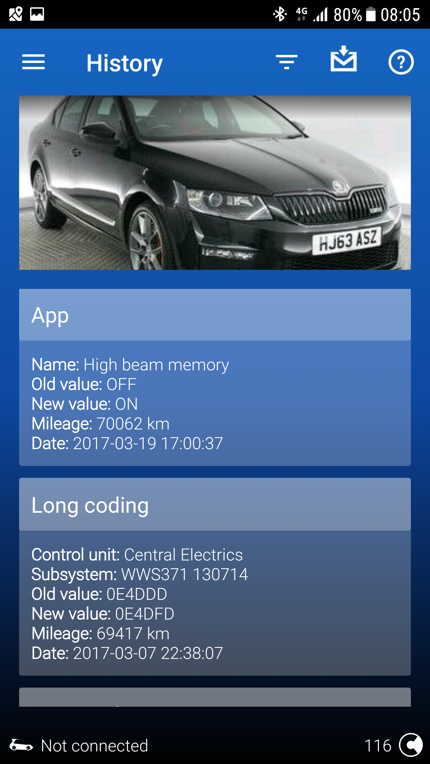

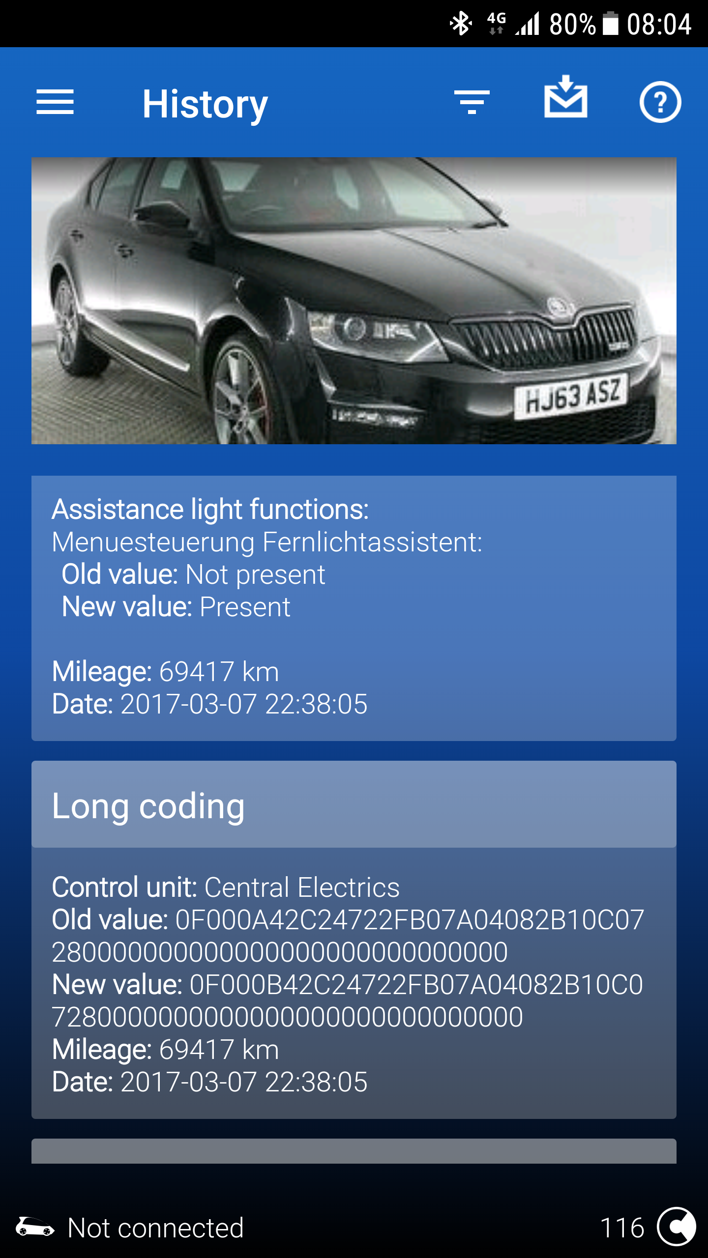

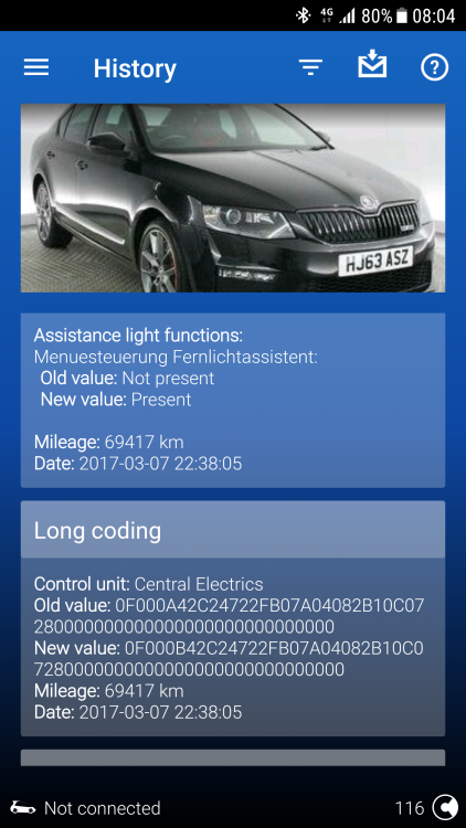

I've done HBA with obdeleven and also made it remember last used position when  restarting the car, I'll look back over it later and post what I done
Long coding for HBA on my vRS
Also change in light function to present and then I think it's this 1 but not in car to confirm
I'll look later if I get time and make a how 2 for obdeleven
That looks to be the correct changes for the Central Electrics 09 controller, byte 2 was changed from 0A to 0B, so you must have manual transmission. If it's an auto byte 2 needs to be changed from 1A to 1B in the coding :)
@ExSEAT does that help clarify the change I mentioned in the first part of my previous post?
Edited by ahenners
Hi gents, thanks so much for the information. Ive been out to have a look now and see what my codes look like.
@Boundy123 I see from your first picture you have turned on the high bean assist adaptation, then done the long coding. The OBD elevn page below asks for a second adaptation, which roughly translates as 'menu control light beam assistance factory setting' is this what is being turned on using the coding do you think?
