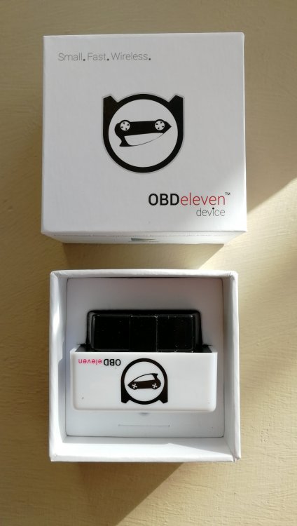

Ok guys I got mine, turned on some features. But after playing a bit with it I got a "low battery" warning. :sadsmile: I mentioned this in my review.
But if I don't drive the car for a day and sit in it I get a warning again for battery.
I had battery replaced year ago, its still in warranty, I will go and ask them to mesure charg and ask to recharg it. When I check status in maxi dot it's SOC 80%.
Before I played with OBDeleven I was on service battery was ok. Anyone else had this problem?

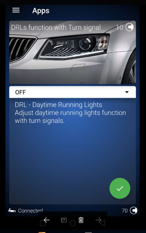

Hi! Me and my friend bought a pair of OBDeleven's. He's got an 2018 Scout, and we want the whiskers to blink in paralell to the turn signal. I got like that on my Superb and it looks awsome. Anyone knows how to do this?
When i tried the same settings as my Superb got, it only worked on the warninglights and not on the turnsignal.
