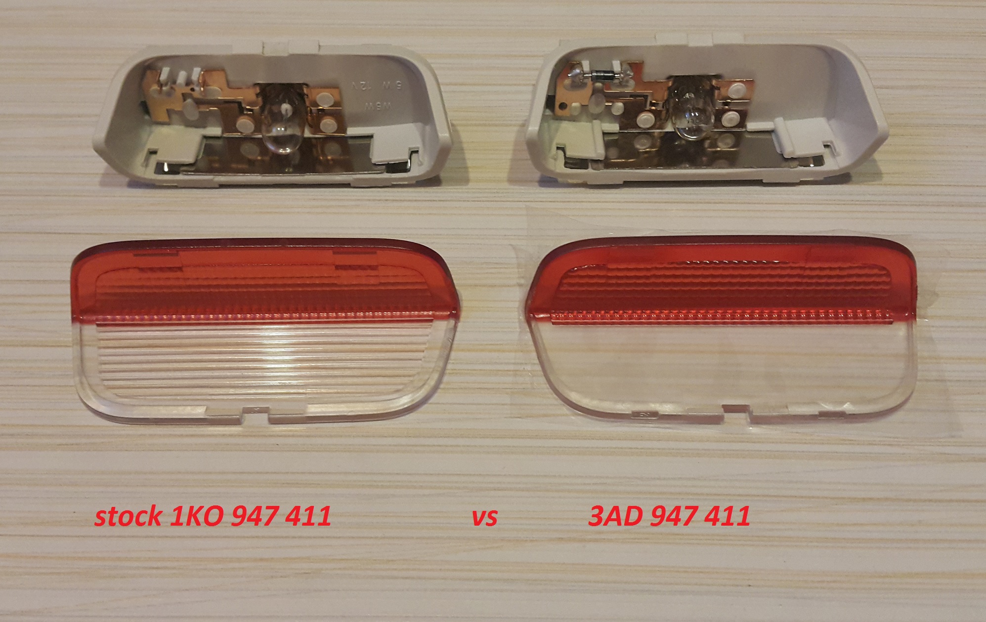

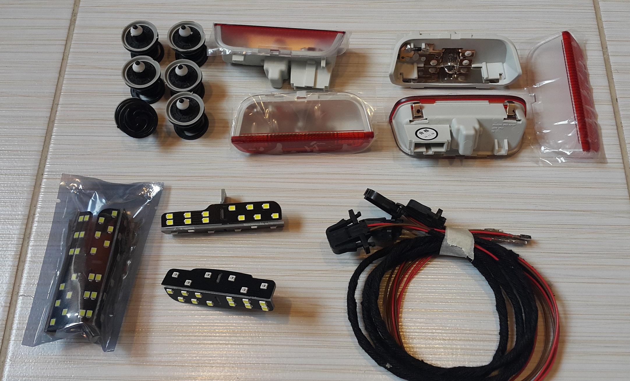

adopter cables weren't necessary in trunk,
but pass in Glove box, but there holes are 1-2mm too short(outside dimensions are equal).
two extra pieces were ordered to somehow install them in cargo to able have some light from the top,
not done yet

I bought the led lights for the bottom of doors on my SE L Executive and receive set of 4 and went to fit and only realised the back doors don't have lights :-(
can they be fitted easy enough???
@Flogdnaloop
follow the link in previous post, each rear door need controller - 2* 100+€ :angry:

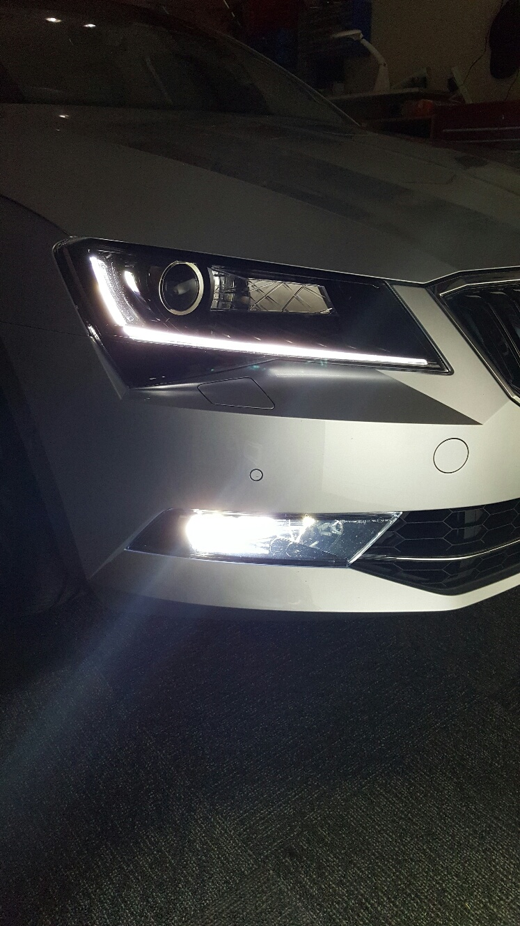

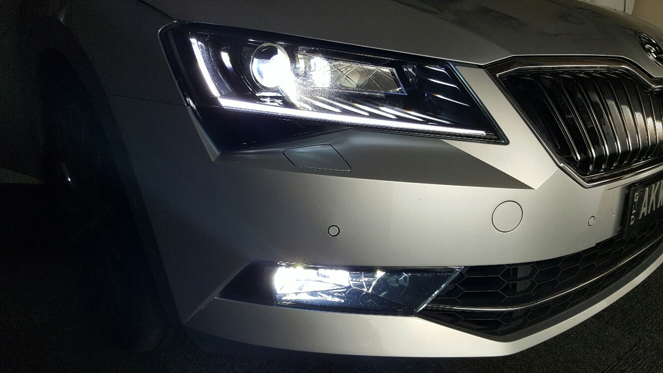

Hi Prykey, I used these ones.
https://nl.aliexpress.com/item/2x-H8-H11-30W-CREE-LED-High-Power-Pure-White-6000K-Fog-Tail-Headlight-Bulbs-Auto/32566731161.html
They fit directly into the 280 without any issues. They fit past the intercooler with ease and only took around 10 mins to replace both sides. They do throw as much light if not more than the originals, but they are much crisper.
The photos are one with the HID headlights on and one with the DRL's only. They aren't that "blue". That match the colour  of the HID. Will get better photos over the next few days.

Thank you :)

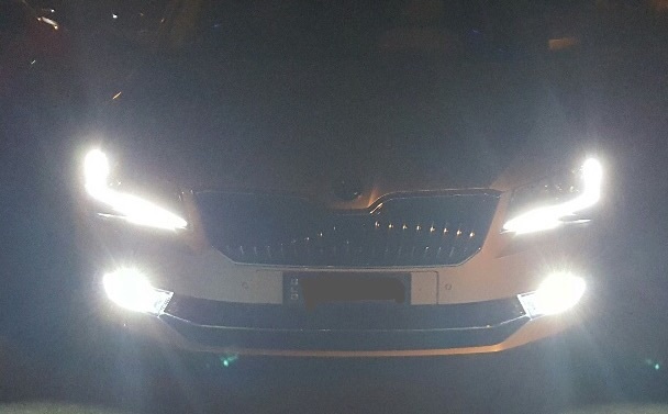

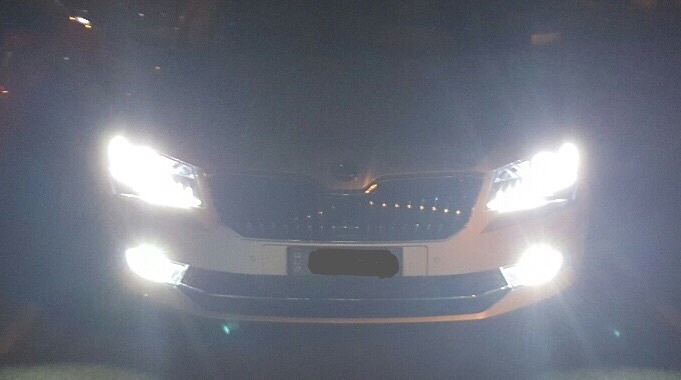

@Prykey here are some photos of the flog lights at night. As you can see, they match the colour of the HID & DRLs
Do you put the 'flog' lights on when you are hammering the car along?  :D:D
Nice match, thanks for posting.
When I do 60km mountain runs at the back of the Gold Coast at night, they are on the whole time. :biggrin:

Nice find that. Can you tell me if you ordered 30, 50 or 80watt bulbs and also are the fittings H8, H11 or H16?
Cheers.
I ordered H8 80w units.
Thanks very much Andysuew, I'll be ordering them ASAP.:thumbup::thumbup:
